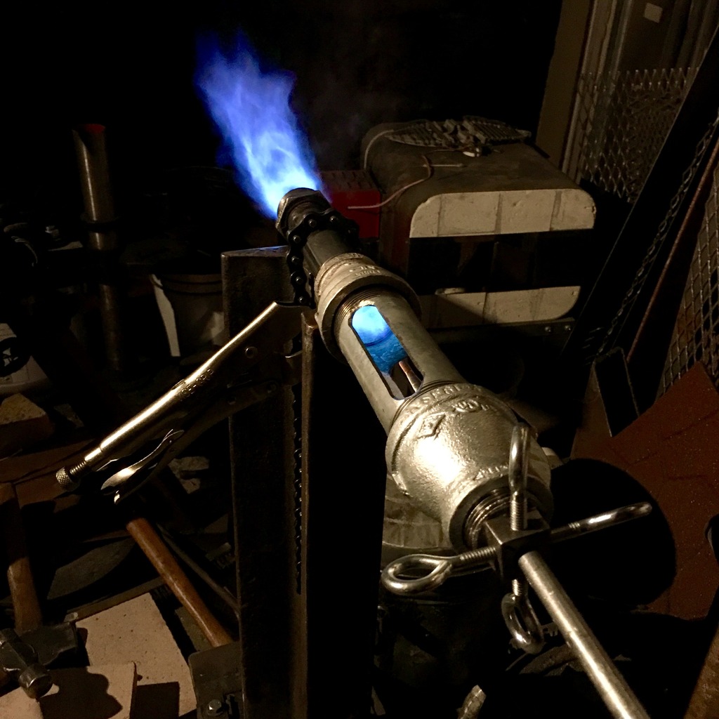

  1. The orifice size on the MIG Tip in the first pictures was way-oversize (like ~ #50 over-sized) which of course was why the flame kept lighting in the tube...WAY TOO MUCH PROPANE moving TOO SLOW out of a orifice that was TOO LARGE resulting in much REDUCED VENTURI PERFORMANCE...I knew it was too big but my curiosity got the better of me and made for a pretty cool picture but the configuration was useless for any forge. First Forge Trial: Broached out a new MIG Tip to about a #76 and smoothed out both ends of the pipe along with the inside of the FRONT 1 1/2" - 1" Reducer. It would not stay lit in open-air and I took that as a good sign and then set it up in the forge and began. Compared to the 3/4" Mako-Style burner I was using, THERE REALLY WASN'T A COMPARISON TO BE MADE: Using the same size orifice, the "Trailer Park" Hybrid was able to exceed it in every way cutting the "room temp-to-forge temp time" literally in half while running at 30 PSI. It was able to IDLE down to almost 3 PSI and I briefly pushed it up to 40 PSI but beyond about 30 PSI it's just a waste of propane. I tried a lot of different angles and lighting to capture the inside of the forge but as can be seen, the light was just too bright & intense. So how did it do? This is a solid 1" X 1" piece of 1018 taken from room temperature to beyond critical in just under 10 minutes. I stopped the forge just after seeing the sparks coming out the exhaust and that the steel had started to melt.
