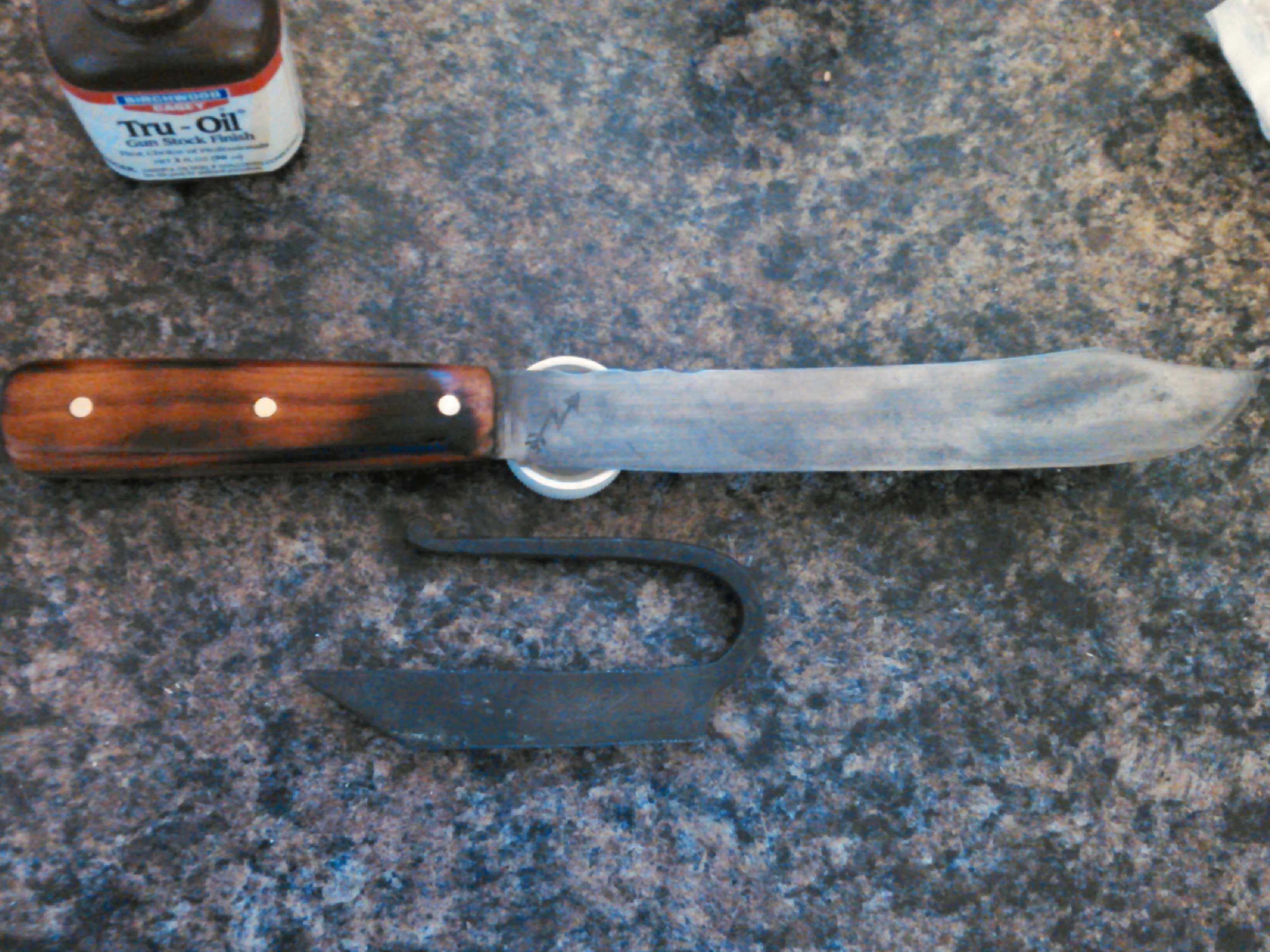

  2. Here are a few knives I've completed, Just learning and working with minimal tooling.. Most of my stuff is directed toward the fur trade era, but I just make to have fun.. Thanks for looking.. God Bless, Joe
