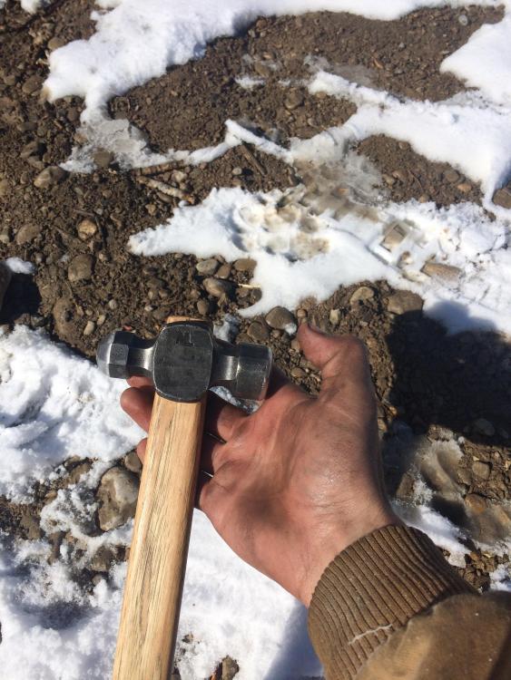

  4. Got back from my trip to Montana with the Chaingang. I don’t have too many pictures of what we made, but you can see most of it on the anvil in front of us in the group picture. I think we forged 8 or so sledges, hammers, hammer eye punches, an axe, and many other tools. One of my favorite trips, should be a YouTube video coming out soon showing it. FB95D63E-BCE8-4F30-8CE3-401E3C999999.MOV

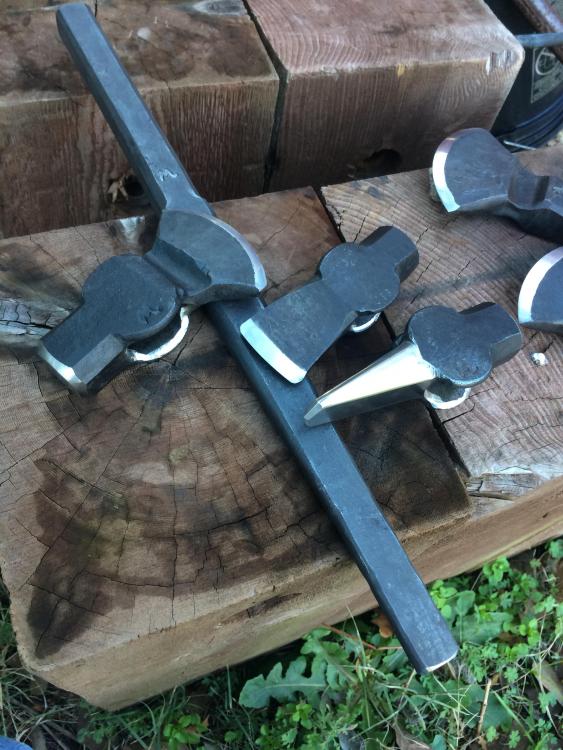

  9. Got a couple brake drum forges mostly finished this morning (I really like the one with wheels), and then after lunch CTG came over and we got some tools made. Made 3 Brazeal style tapered hot cuts, two top hot cuts of different styles, two hammer eye punches, and a hammer eye drift. Did pretty good, a little over 5 hours of forging. Better pictures to come

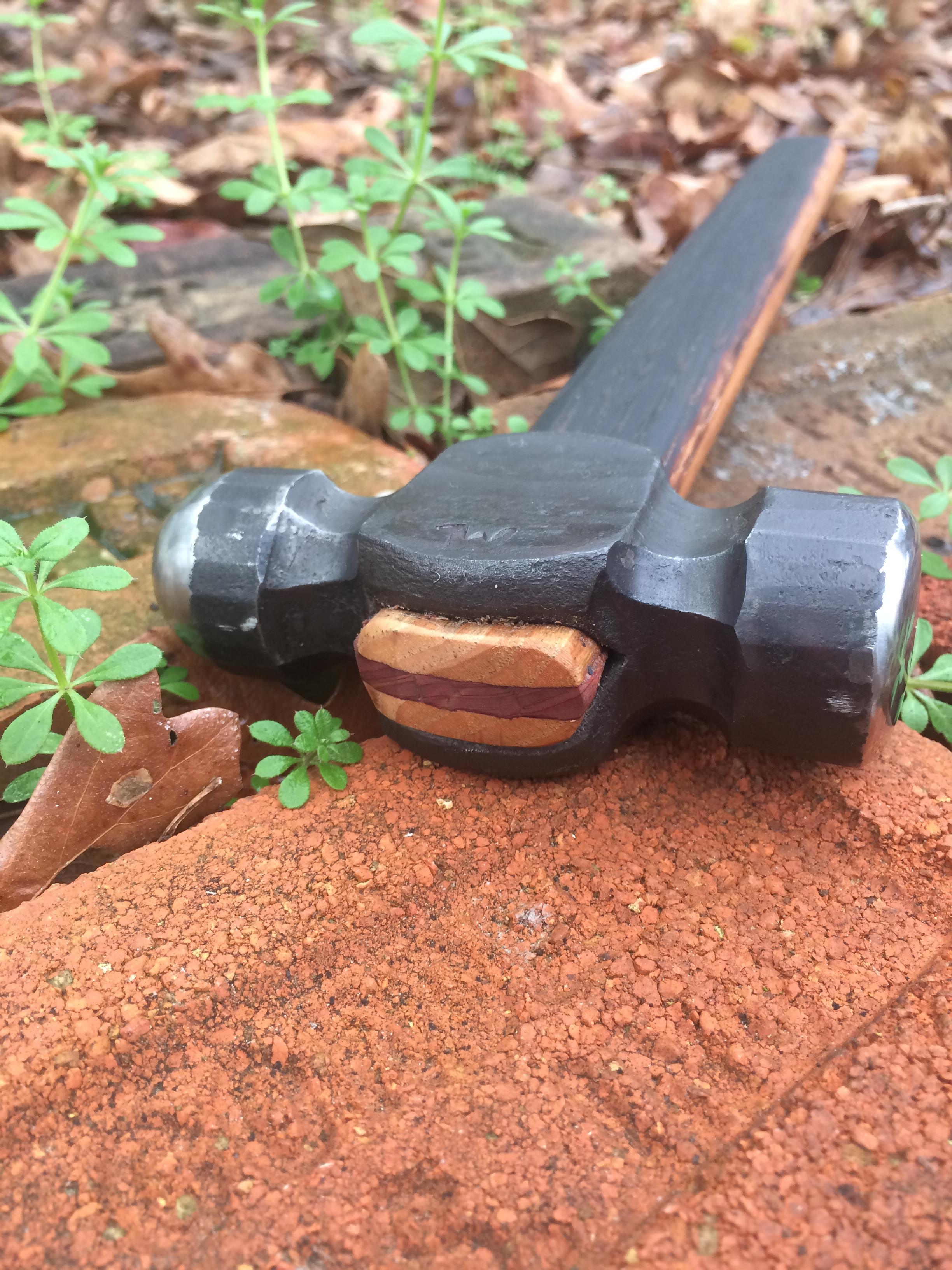

  12. I used the method described, punching with a round punch and flattening the sides when I made this cross pein. I liked it. There’s a picture of it next to old one I took as inspiration.

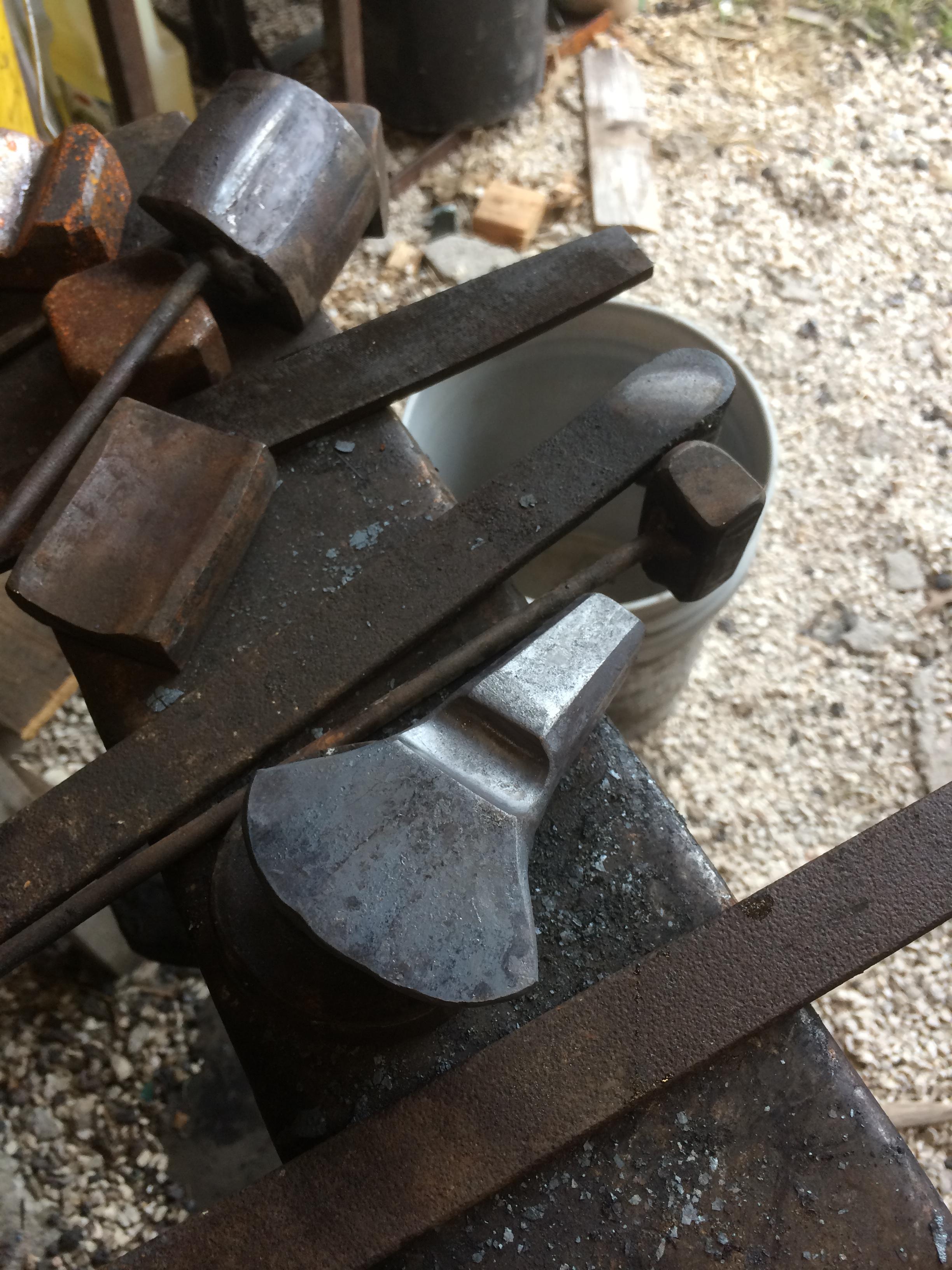

  15. Thanks everyone. Got a few more pictures today. While she was here I made a hot cut and pair of tongs.
  16. Thanks everyone. Thank you Jennifer for the compliment of proportions, that’s something me and other young Smith’s spend hours conversing about. Yes, pick up tongs, hammer making tongs, etc. style of Brian Brazeal. Small contact surface, allows to manipulate and flip billets around very easily once you become comfortable with them. Had a girl from school come out and she took some nice pictures. I won’t bore y’all with all of them but here’s some.

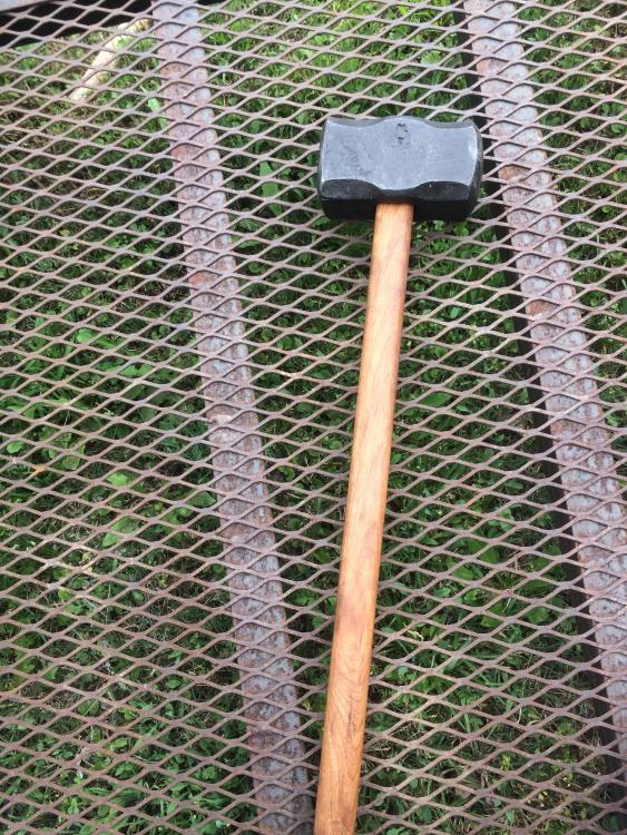

  17. Maybe if I had some bronze. Heres sone better pictures of the 20oz ball pein and 10-1/2lb sledge.

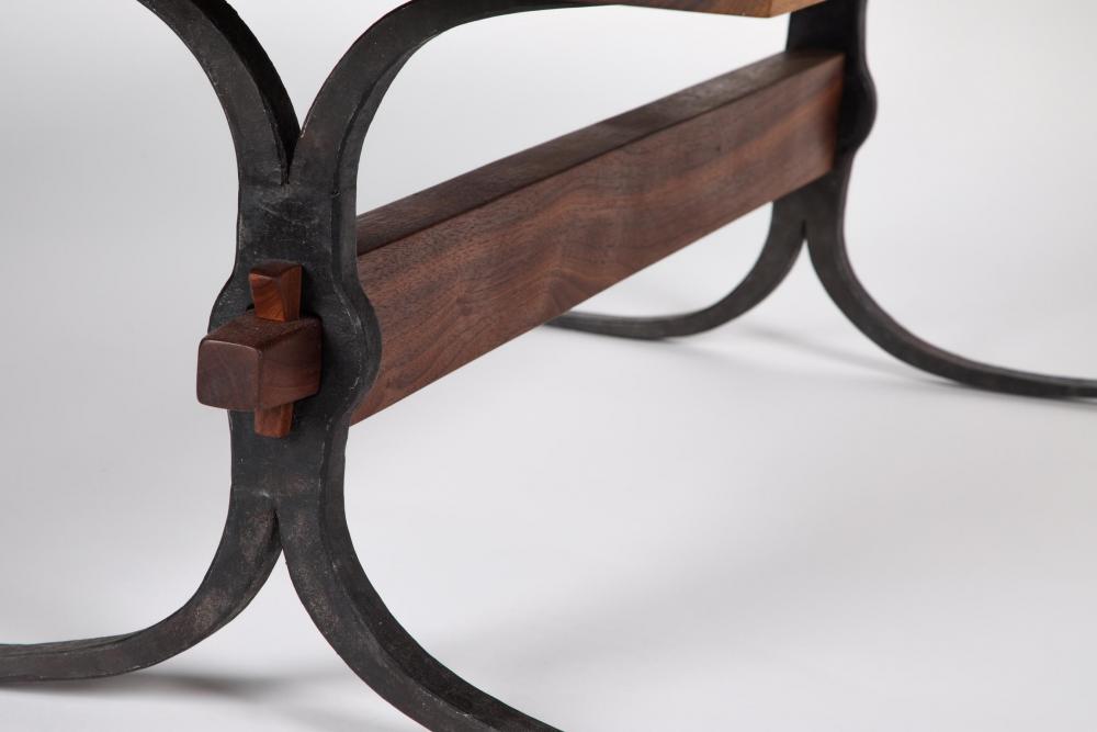

  18. I had thought about doing a maple wedge to contrast the black walnut, but I think it will look cleaner with walnut wedges. The table top and middle beam are black walnut. Started the fit up of the tennons. Lots of filling left.
  19. Yes, it will have a walnut beam that goes through the square hole as a tennis, and then will have a mortise and wedge holding it in.

  21. Here’s a picture that might help demonstrate the table legs I made and give a better idea of them. Everybody before seeing them with the table was a bit confused for some reason.
  22. Also finished that 20oz ball pein I forged the other day, heat treated it polished and handled, and ground polished heat treated and handled a 10-1/2lb sledge I forged a while back. I included a picture of it next to a factory made 10lb sledge, showing the stubbiness of it.

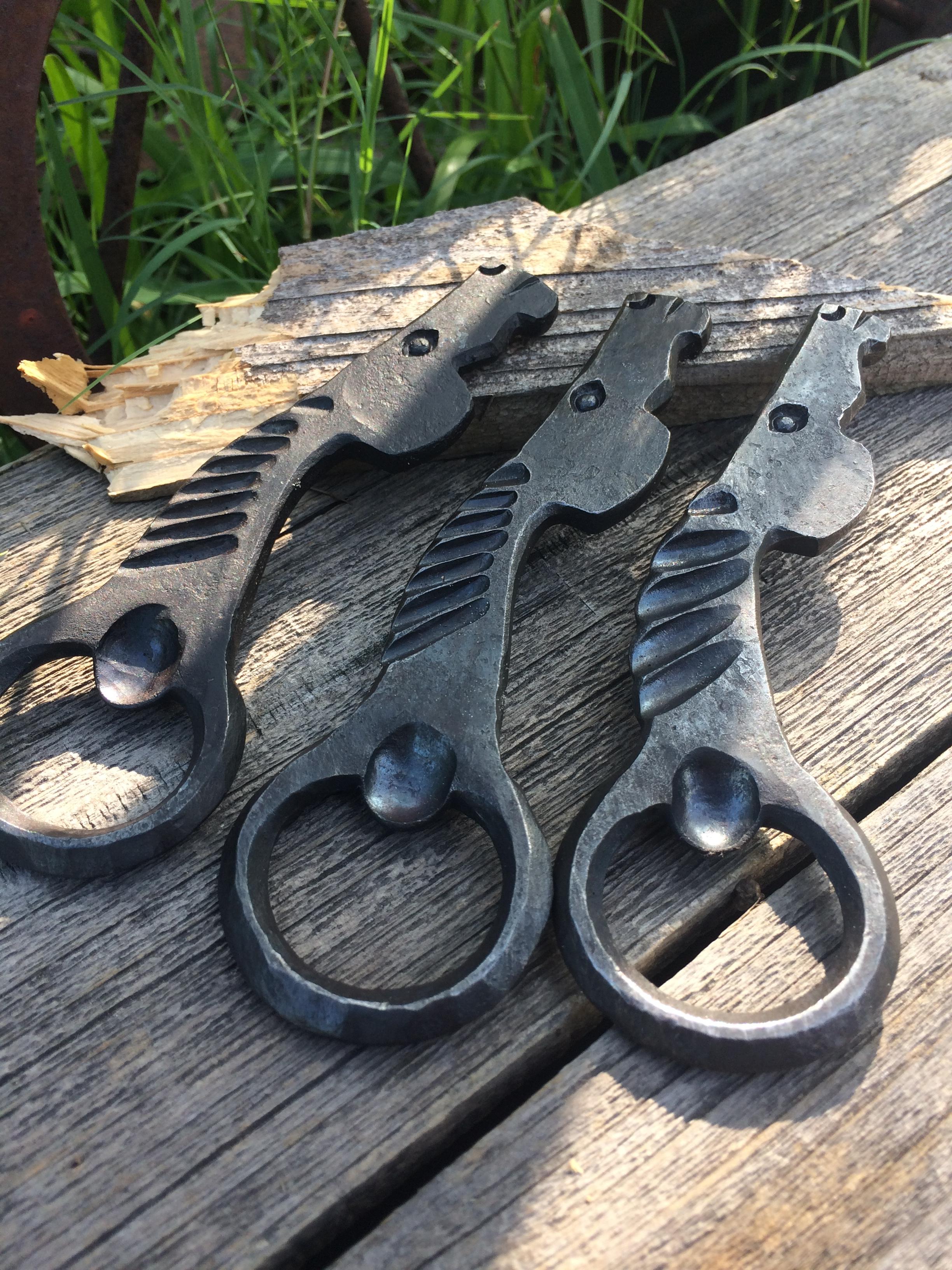

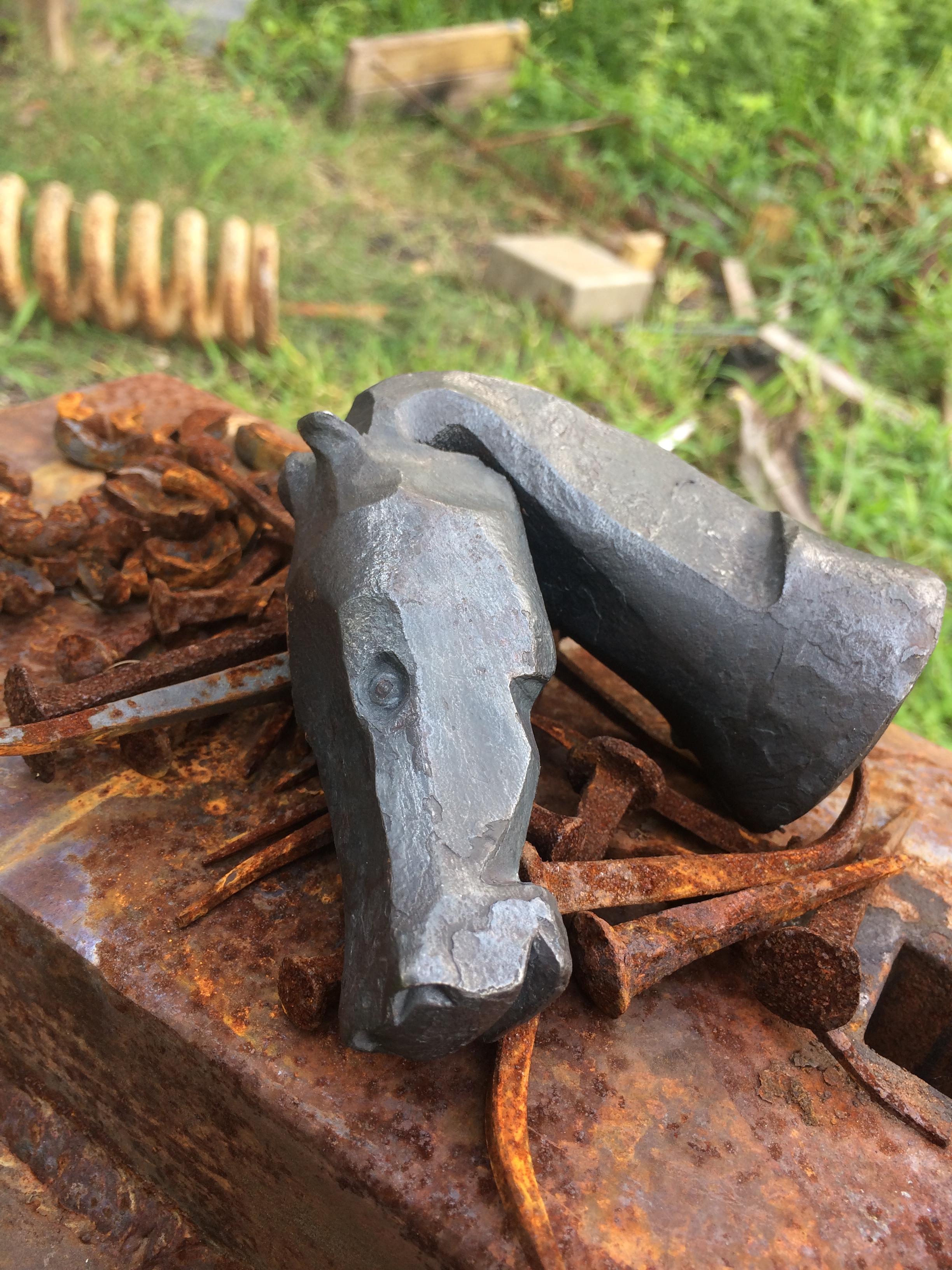

  24. Yes das, the hammer was made with the power hammer. I like it a lot. As you said it has good control. CrazyGoatLady, good first horse, it will change the look and make it look much cleaner if you take the corners off on the angles of the jaw. Just gives more depth to them I think. Included a picture so you can get a better idea.
