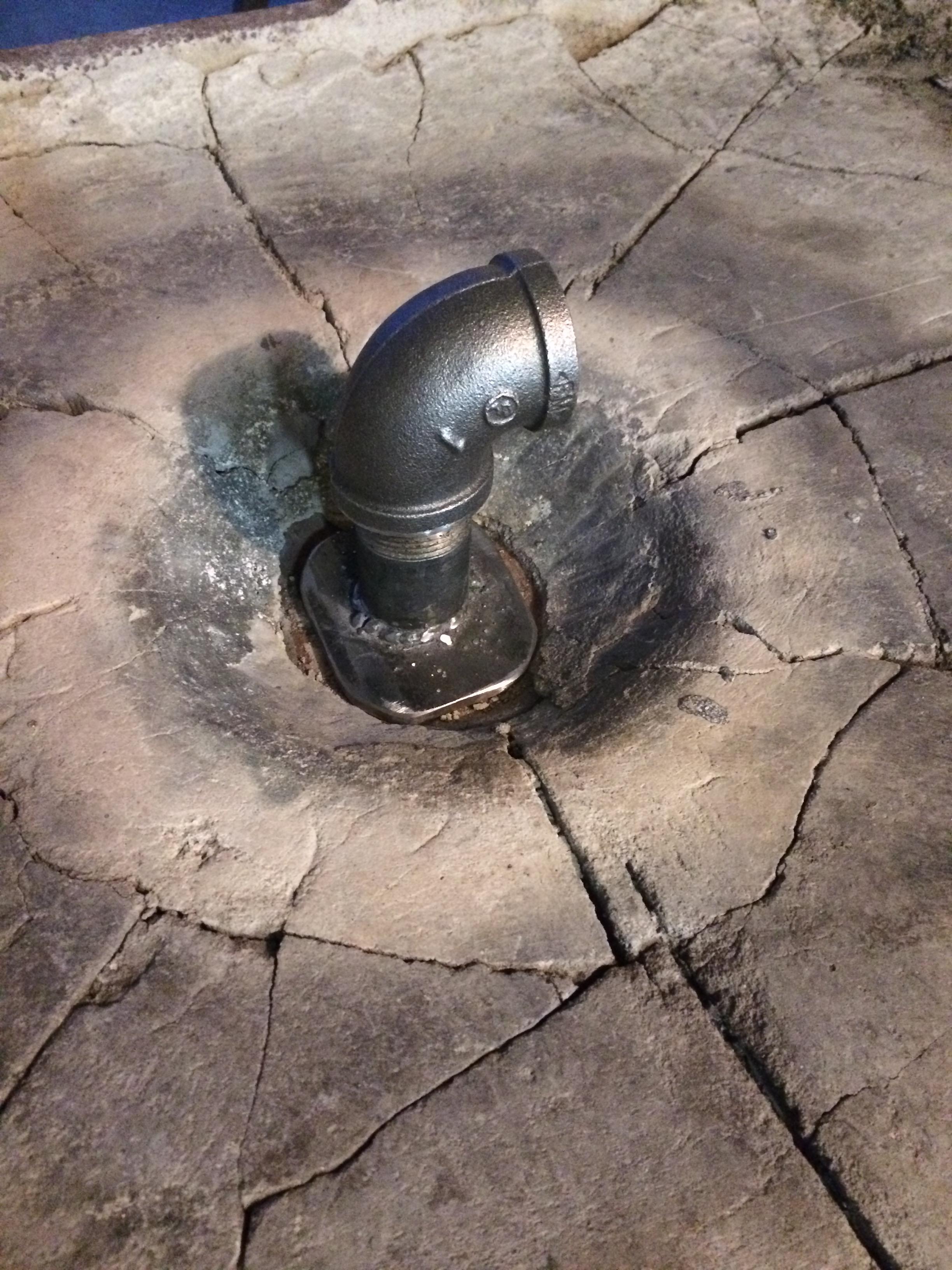

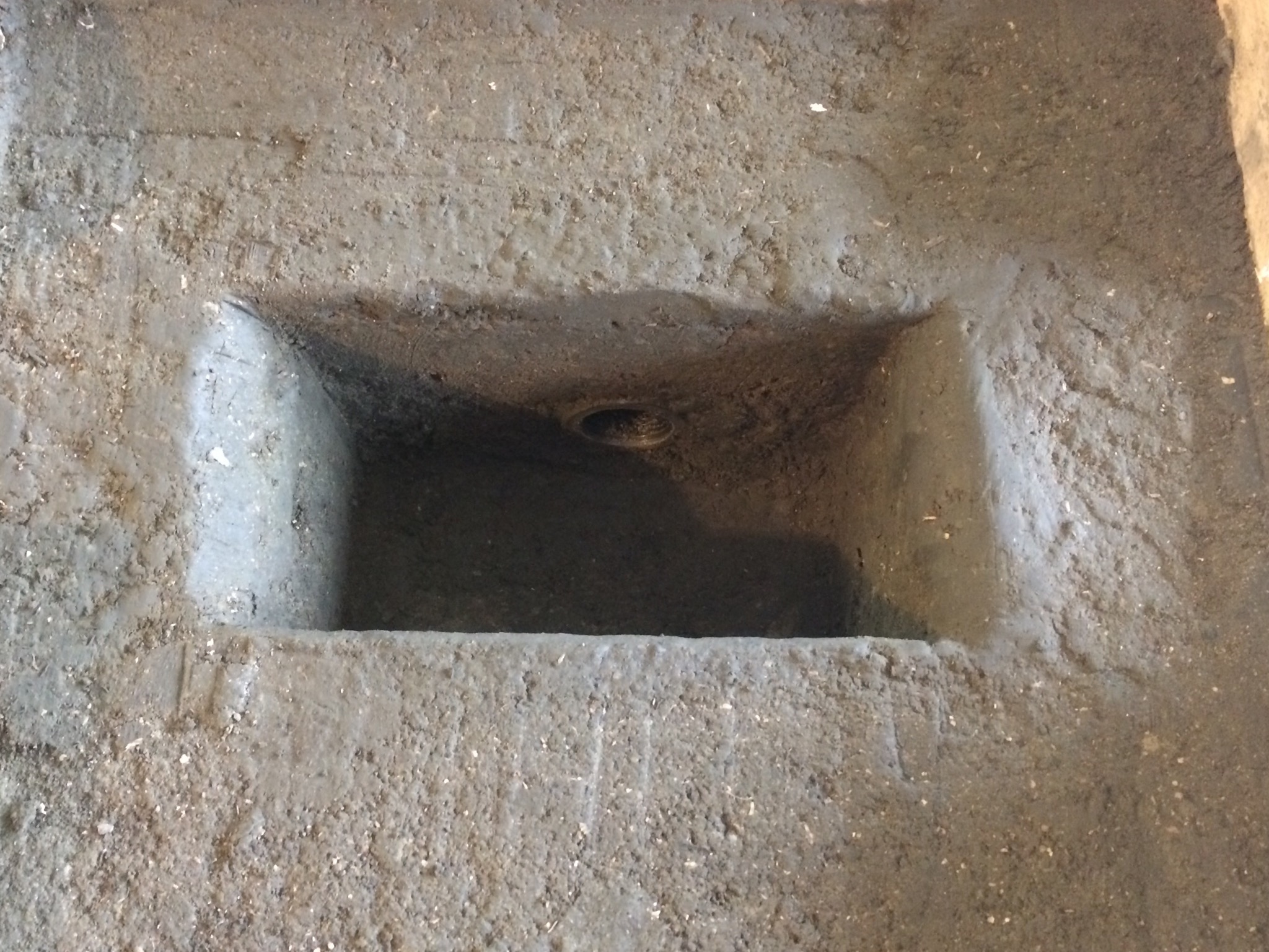

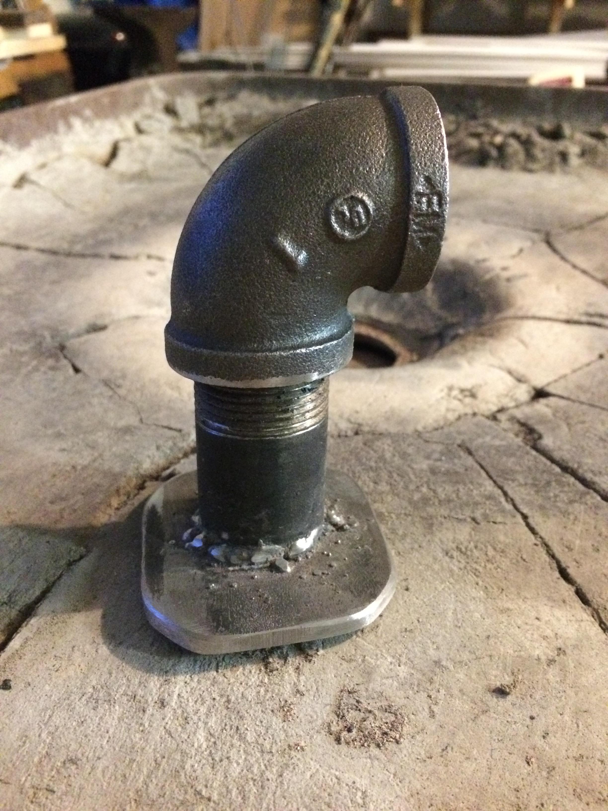

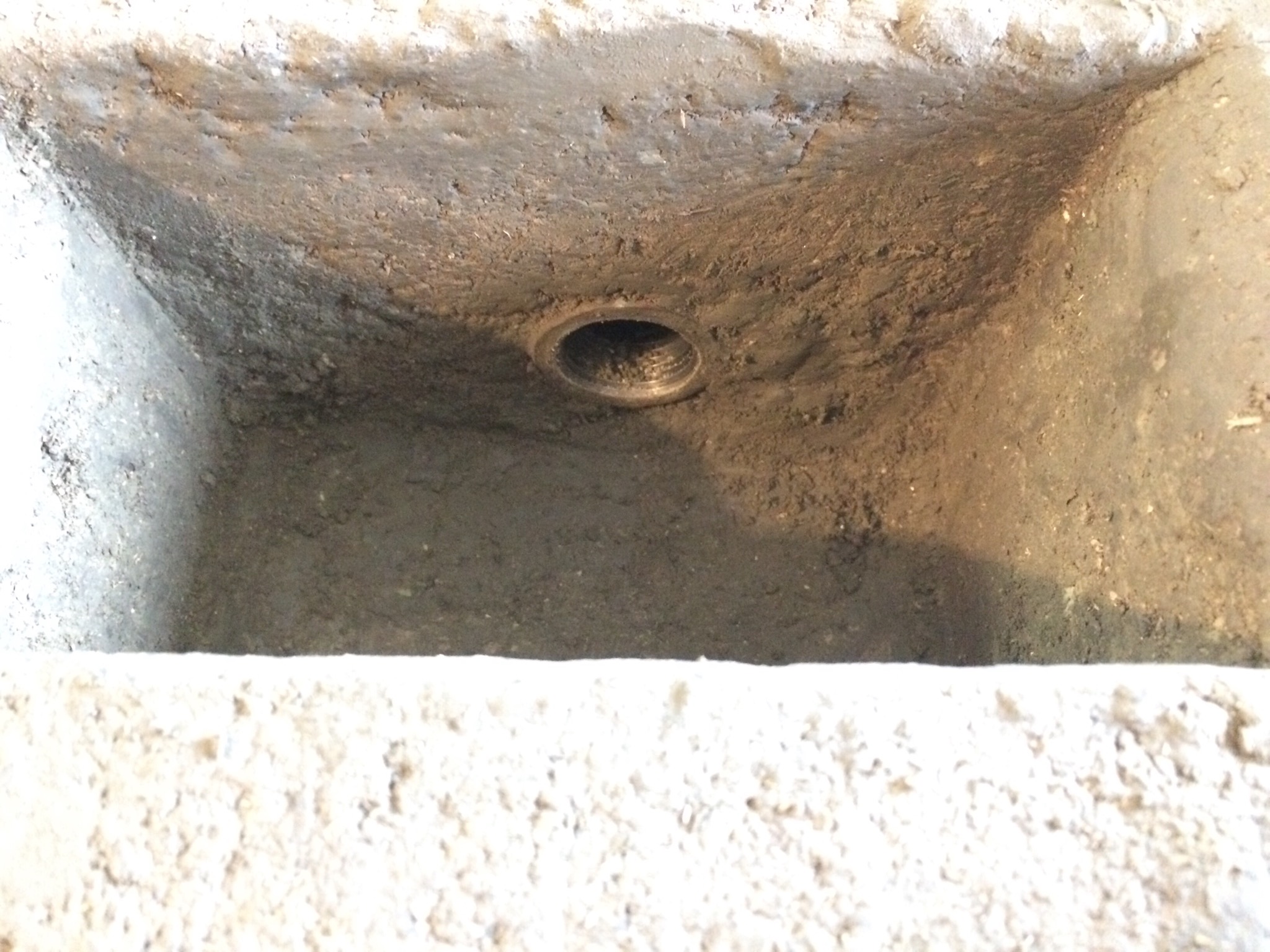

  2. Hi everyone, so armed with some great advice and the research by Charles, I converted my pan forge and blower to a side blast JABOD since I’ve been using only charcoal for forging. This is the forge with the original rammed clay in the pan-about 2 inches worth. I welded (term used loosely) up a “tuyere” to redirect the flow of air from the bottom of the ducks nest through the side of the forge. I then built a box from scrap and filled it with rammed earth consisting of kitty litter, wood ash and sawdust. I made my firepot a trench about 8 inches long and 4 inches wide. The 1 inch tuyere is about an inch from the floor and there’s 3 inches of earth above. This cost me roughly $4 for kitty litter and $1 for the elbow. Everything else was scrap. I’ll probably add a firebrick on the tuyere side to bank charcoal against above the hearth. Let me know what you think or if there’s something I can improve. Thanks!

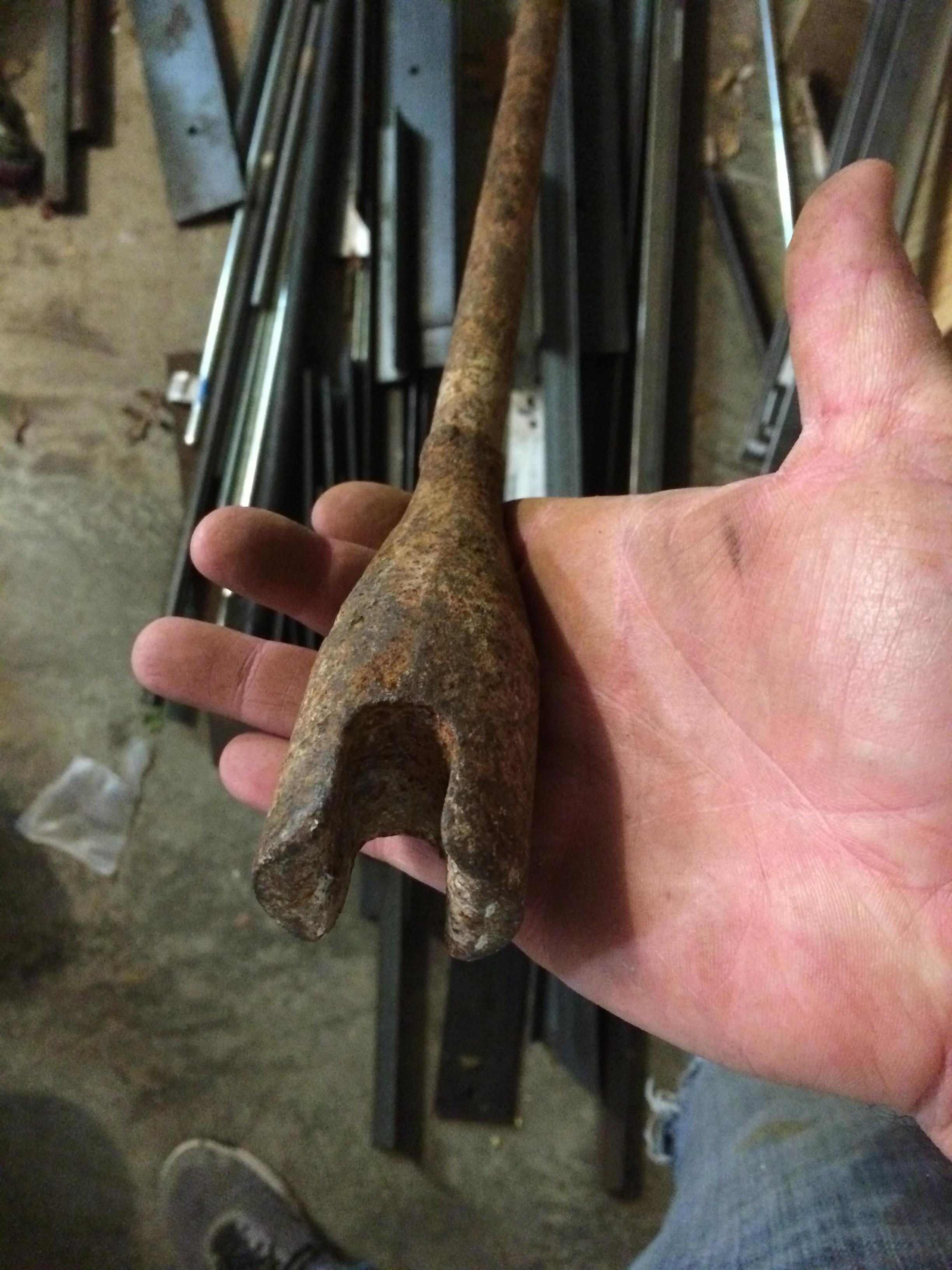

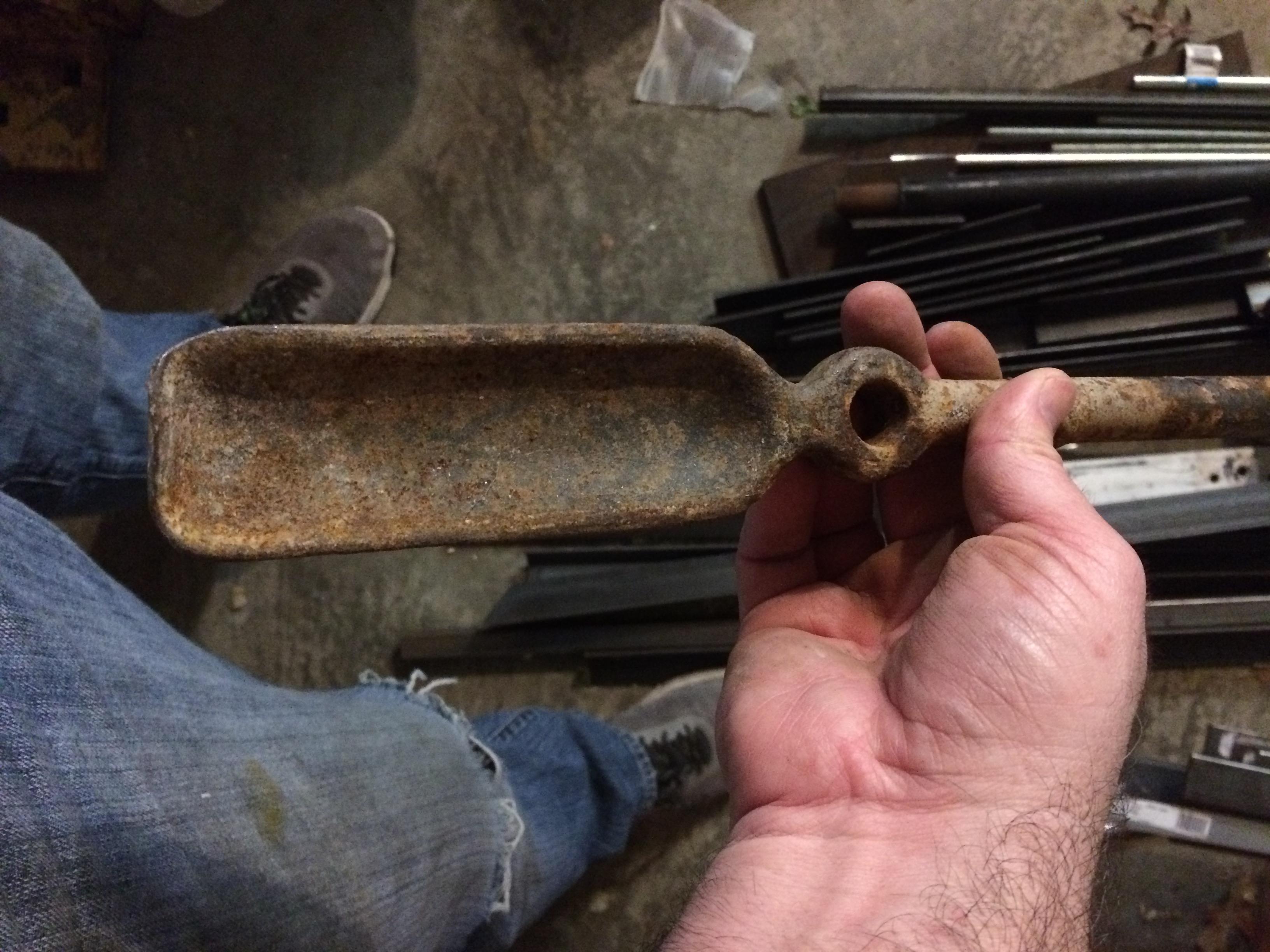

  9. I’m not sure if there’s a better spot for this question, but can anyone tell me what this is/what it’s used for? What kind of steel? These are on opposite ends of the rod and it’s 5-6 ft long. Thanks!

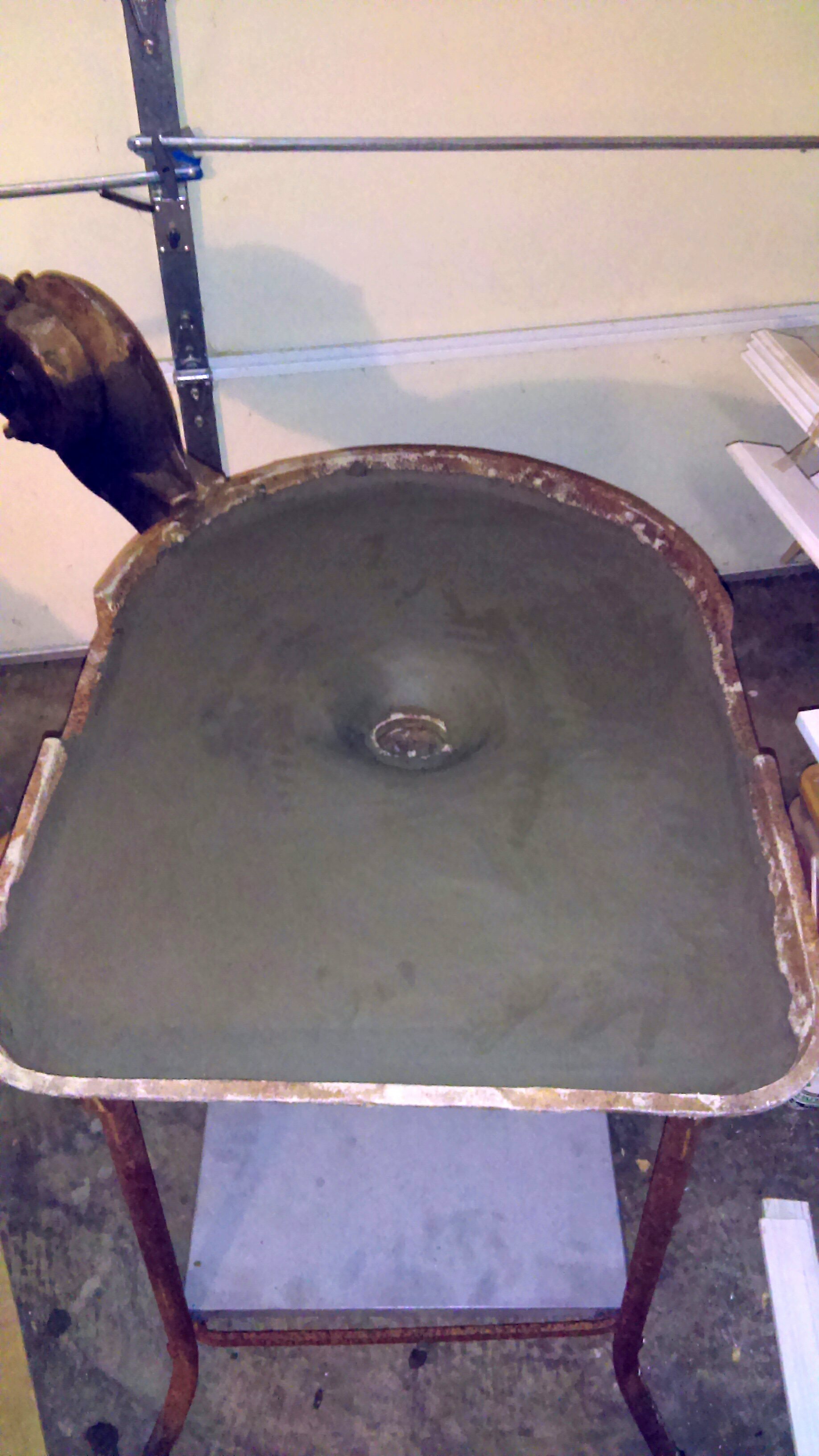

  11. OK, so my clay was a little more damp than I thought because when I tried to ram it, my mallet kept catching instead of bouncing off so I just tried punching it all down by hand then I smoothed it. I got the whole thing clayed to a depth of about an inch and the "duck's nest" is about 1.75" deep and 6 inches across at the top. How does this look? Is there anything else I should do? I was thinking of letting it dry overnight and trying to ram it again, should I do that? Thanks for the help and sorry for all the questions!

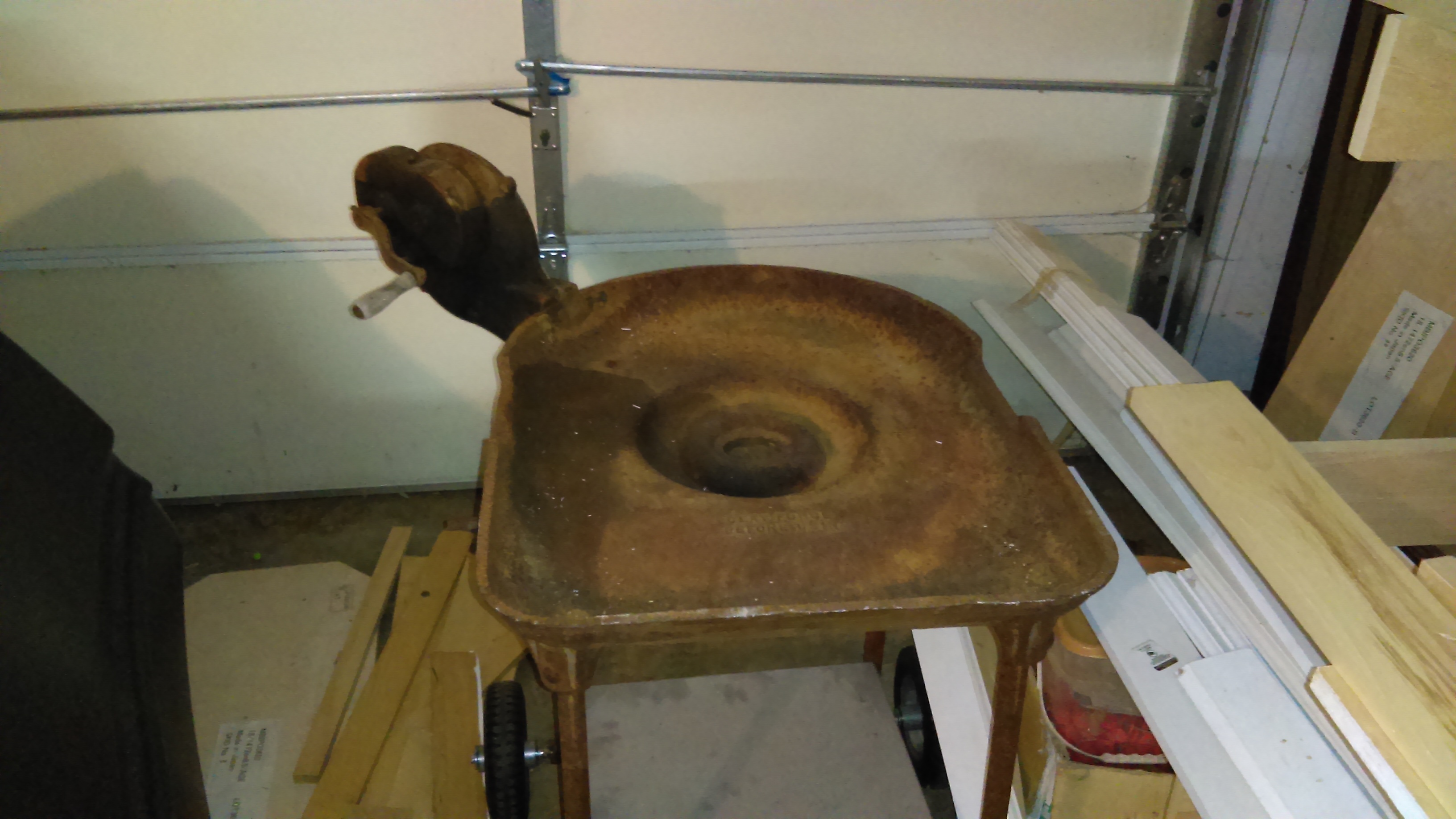

  13. Hi everybody, I've been a knifemaker for a couple of years and I decided to try my hand at forging plus my daughter is interested in learning as well. I got this forge from my uncle and I was wondering if I should remove the rust from the pan before claying it. It seems like the right thing to do but I didn't know if it was necessary. Thanks!
