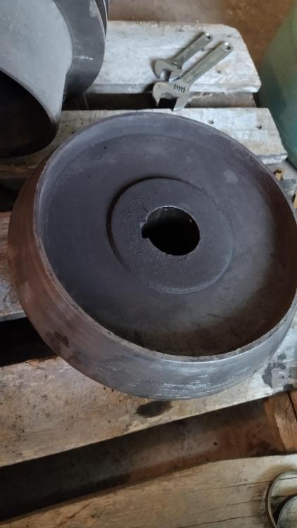

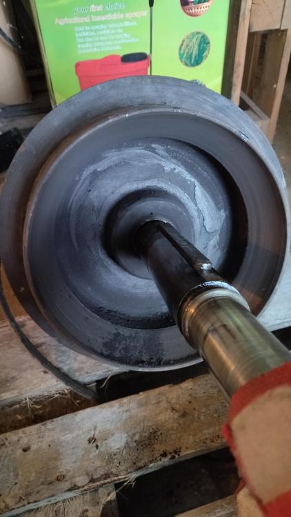

  1. The company, where I took it, makes truck clutches. They did a great job and I couldn't wait to assemble it and try it. Now it works great and I have to decide where it will be, so that I can start poring the base.
  2. They glued it somehow, but I was so anxious to assemble the hammer and forgot to take some pictures.
  3. I am sure. When I got it, there was too many dark dust falling from between the disks. A few days ago I took it to a machine shop, where they put some ferodo on the smaller disk and now I have to make a new set(s) of dies and pour some concrete for a foundation. The hammer works like this now -
