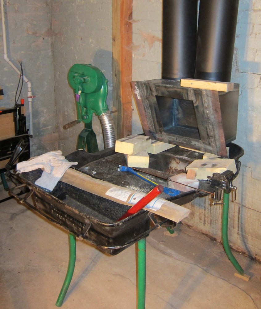

I'm with Frosty, tho on side-draft. Note: make the opening no bigger than the cross section of your ducting. You've got about 113 sq in to play with. Something about 10"x10" would work well. The reason for this is that you want a high velocity here to "pull in" the smoke.

I like the shift to side cut outs.
Think about mounts for a hood. I use a "Super Sucker" side-draft hood. (google that, you'll find it). Even if you use this outside, having a hood with a 5' stack will help keep you from breathing nasty stuff. And, it means you don't have to be as concerned about being on the upwind side. Might save your life if you accidentally burn zinc off of something (galvanized stuff can kill).
You'll like the slide out supports. You can always build some stand-alone ones later if you work with long / heavy stuff.
Eric
Legs: 2"x2"x1/8" would be plenty (and go with just four legs, if the table needs more support just use the extra angle running along the underside of the table to stiffen it)
cutouts: mine has cutouts on the side so I run long stock from side to side, not front to back. I have a hood at the back which would interfere. Remember that you don't just heat the ends of long stock. So, you need a cutout in the back or go to side cutouts. (Side cutouts are more common, since forges often back up to the wall or have a hood at the back.)

I think the widened opening of your hood is really cutting down on the ability of your setup to draw the smoke. This is what the draw on mine looks like:
(This is approximately the super sucker hood design.) The flat flange around the edge forces all draw to be from the "front" concentrating the draw over the fire. Your cupped flange does that but it also makes the opening much bigger than the pipe dramatically slowing down the air velocity exactly where you want high velocity. I think you'd get better much better smoke draw if you just had the pipe longer. Unfortunately, that would probably make things too hot for your pipe gauge. The hood (16 ga w/ 3/16" for the flange) allows mixing so the peak temps hitting my pipe aren't too bad. Pipe probably never gets above 300° F in my setup.
