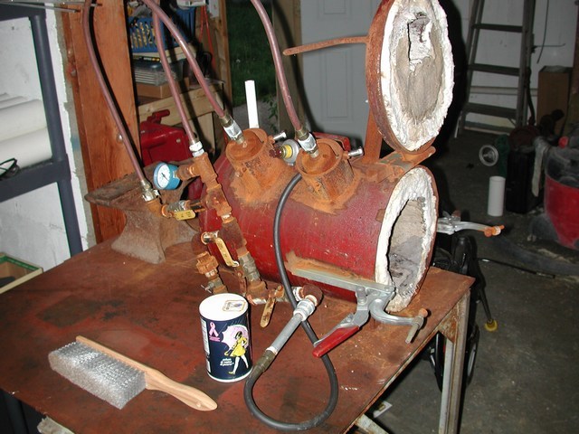

dual venturi burner setup, with 2" kaowool lining and coated with satinite(sp?) refractory with a 1" thick hard kiln shelf cut into the bottom. with bung for a pyrometer, would reach 2000f and maintain it on 3-5lbs of propane pressure, with idle valve and shutoff valve for the rear burner,
