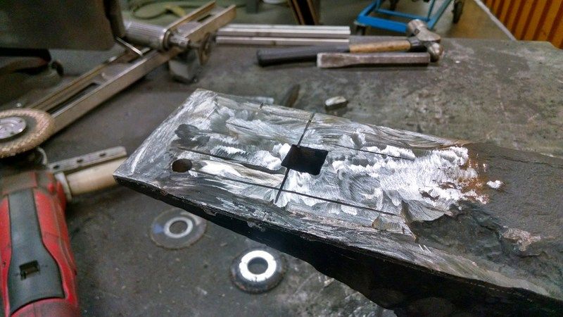

Yeah, a professional welder I am not. I was running 160 amps for the interior welds between the plate and body about 110 amps for the exterior welds. I swirled my bead to try taking up more of the 1/2in gap that had to be filled. If I had it to do over I would reduce the gap to 3/8. The next phase is to grind everything even and pretty it up. If the face pops off I would be suprised, but it will probably hold me over until I find a better anvil now, it isn't officially a door-stop yet.
Got it done, there are most definitely slag inclusion aplenty but that tine is not coming off. I left it out to cool and will collect it in a day or two from the folks house as time allows. Pre-heated to about 350 and started welding. After chipping what I could of the slag from the recent weld I'd flip it for the next pass. 7018 rod might not be the best for this operation as the slag was pretty tenacious. I'll report back on if it rings or not, I think rebound is good because it bounced a hammer pretty satisfyingly when it was allowed to fall 8-10in driven by only its weight.

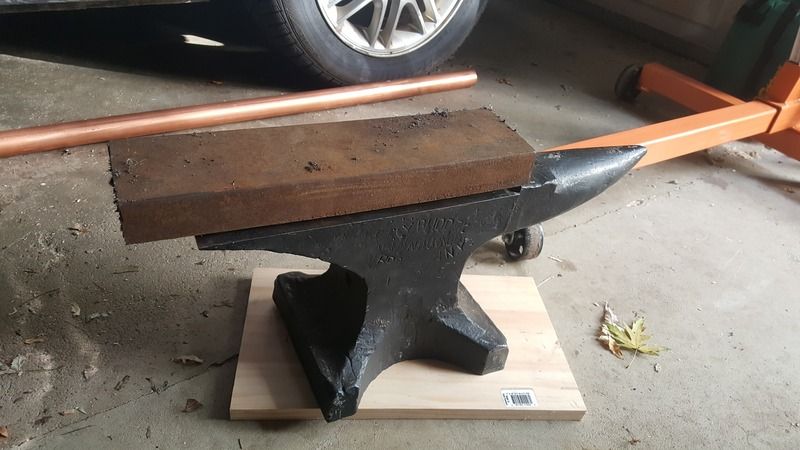

I have a gerry rigged the anvil to an engine stand. The batting material is insulation for a furnace door to try limiting heat migration into the engine stand. So here is the plan:
-Lay stand on its back and orient the anvil in the upright position and lay the tine piece on it.
-heat prodigeously with a large wand torch, bringing the tine to a minimum of 500 degrees, then tack weld the plate in place.
-lay engine stand back down, now that the anvil is horizontal simply stand over it and going from rear to front lay successive beads of weld. After a bead or two I will rotate the anvil to prevent any warpage from asymetrical heating. During this phase I'll monitor the temp of the tine and try keeping it below 800deg F.
-Upon complete filling of the gap I'll try ignoring it for several hours until it is cool enough to handle, once it is cool I'll set the anvil on some fire brick and re-heat the top to between 700-800 deg to relieve some stress and then it's time to start grinding and shaping.

I am planning on tack welding the tine to the body as it is, mounting it in an engine stand, and for each successive pas weld down in between the gap of the body and new top and build it out to the edge. It is either going to work great or end in disastor.

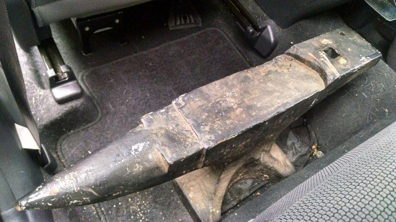

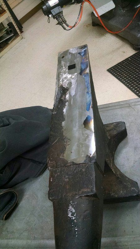

I got this anvil in haste a few years back before I knew what I was looking for. As you can see from the pics it has seen a lot of use.

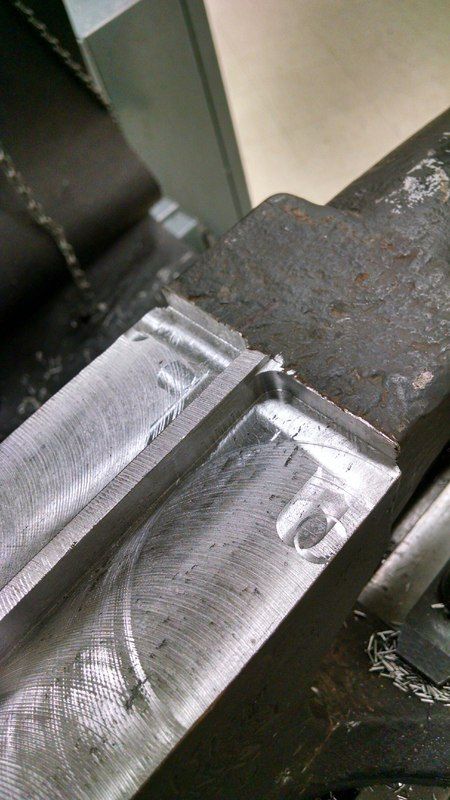

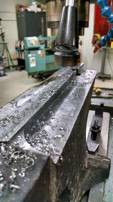

My brother has access to some hefty machines and was good enough to perform the following tasks by my direction. He cut a roughly .25in web about .5in tall the length of the body.
So now my forklift tine new top is about to be made one with the body. It has a lot of work ahead to get it to be sort of aesthetically pleasing, it won't look like it did the day if left NY, but it will sure take a beating as long as welding goes well. More pics to come as developments are made.

Here is a picture of the offending surface, I'll gladly accept any help anyone is willing to offer.
Learning experience I suppose, guess its time to get some filler rod and hard face
I committed sight unseen to a 105lb Hay Budden anvil for $150, got it and found that about 2/3 of the tool steel face was mussing. There are some pitts but otherwise the iron wasn't beaten on too bad. The hardee holes are good too. I am now looking into how to repair the face as this is my first anvil. So how did I do? Pics to come
