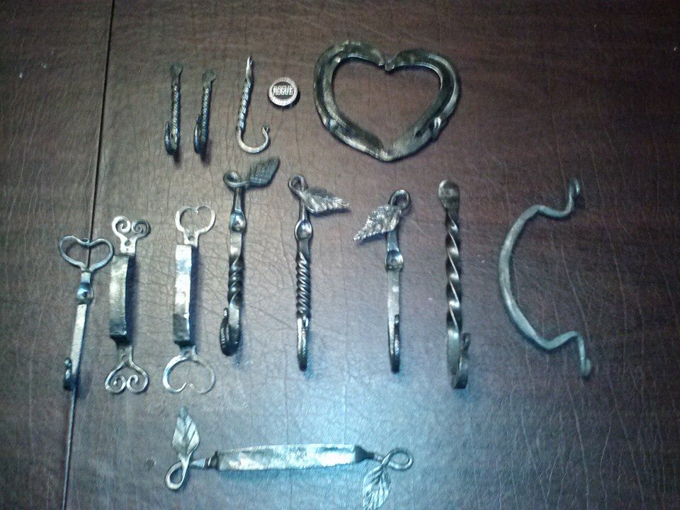

misc 1 odds and ends Share https://www.iforgeiron.com/gallery/image/37877-misc-1/ Share on LinkedIn Share on X Share on Facebook {lang="reddit_text" Share via email Share on Pinterest More sharing options... Followers A couple of projects that I've been working on.
dosullivan Members December 18, 201312 yr Author stats Hi there, really nice work. Any advise on how to keep the steel this shiny and clean for as long as possible?
scoobshagg Members December 18, 201312 yr Author stats I use a wire wheel to knock off as much slag as possible. Then I use a clear gloss spray paint. I like the Krylon brand of clear gloss. That seems to last quite a while. I know some guys also use linseed oil also.
