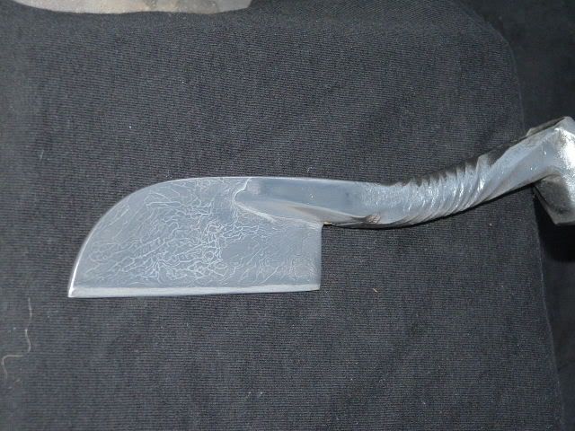

This is the start - a fire rake tool. Three spikes welded together, twisted full length, one spike head intact, the second shaped for the rake, the third drawn and welded into the middle for the length. Of course painted appropriate to find on a pile of coal. RR%20Spike%20Fire%20Rake.JPGhttp://webpages.charter.net/richardthibeau/RR%20Spike%20Fire%20Rake%203.JPGRR%20Spike%20Fire%20Rake%204.JPG
