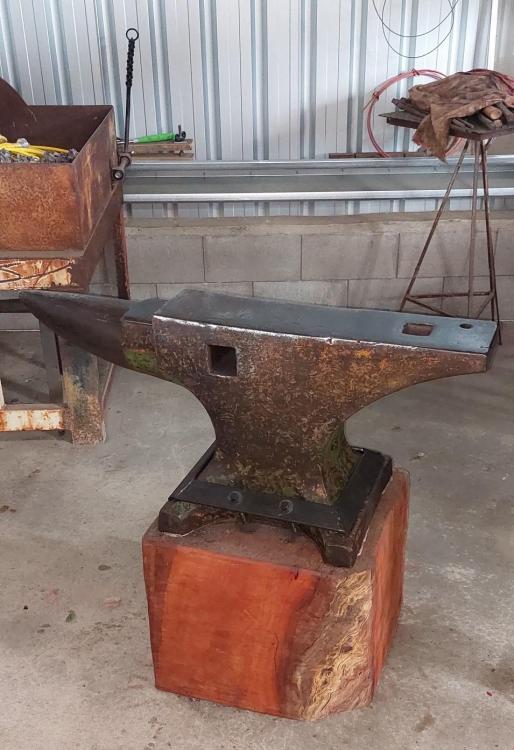

warthog02 Posted September 30 Share Posted September 30 Recently acquired this 90 lb Chain Makers anvil. Its of the old english style and is pretty corroded so i havent found any markings. The surface is in good condition though, having been rewelded after lacking a large chunk of the faceplate. Getting this as well as seeing some old videos of chainmakers at work has gotten me fascinated with forge welded chain making recently. I plan to make a chain making mandrel for this anvil at some point so if anyone has pictures of such tooling that'd be awesome. Or if anyone has other chain makers anvils I'd love to see them Quote Link to comment Share on other sites More sharing options...
Rojo Pedro Posted October 4 Share Posted October 4 Nice anvil. What did they use the side hole for? Quote Link to comment Share on other sites More sharing options...
Frosty Posted October 4 Share Posted October 4 It's to mount chain making tools. There are a number, and different sizes, bending forks, hardies, fullers, etc. I tried to find a video how to but all I got in searches were minecraft and jewelry. I know there are folk on IFI who have and use chain maker's anvils, hopefully someone has a video bookmarked too. Frosty The Lucky. Quote Link to comment Share on other sites More sharing options...
JHCC Posted October 4 Share Posted October 4 The hole in the side is for a bar with the hook on the end that's used as a mandrel when shaping the links. Here's a clip from a video that shows one in use (from the Black Country Living Museum in Dudley, UK): And here's a clip from one of Rowan Taylor's videos, showing him using a hardy-hole version of the same thing: The advantage of the version that mounts in the transverse hole is that once wedged in place, it connects strongly to the mass of the anvil, and can also be adjusted with different sized of hook and at different distances from the side of the anvil to suit the smith. Quote Link to comment Share on other sites More sharing options...
