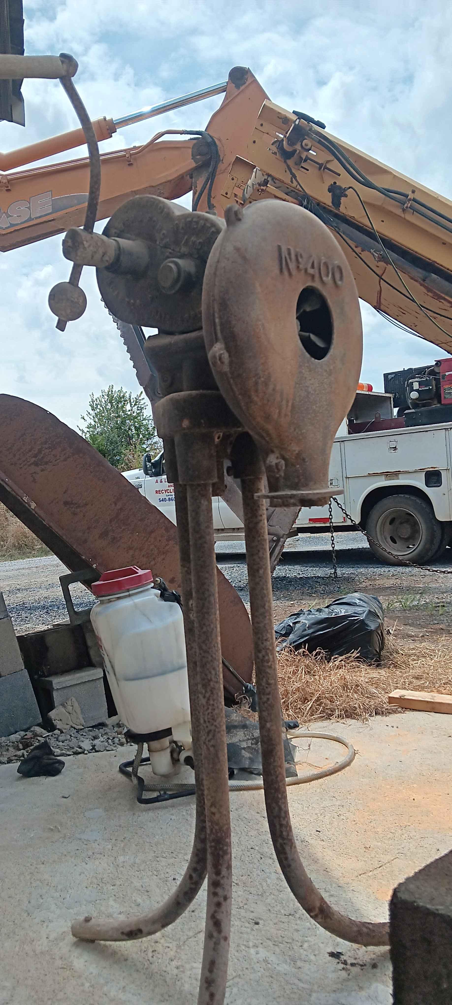

Pie Posted September 1 Author Share Posted September 1 Heres some photos of some cool stuff I found The blower Quote Link to comment Share on other sites More sharing options...

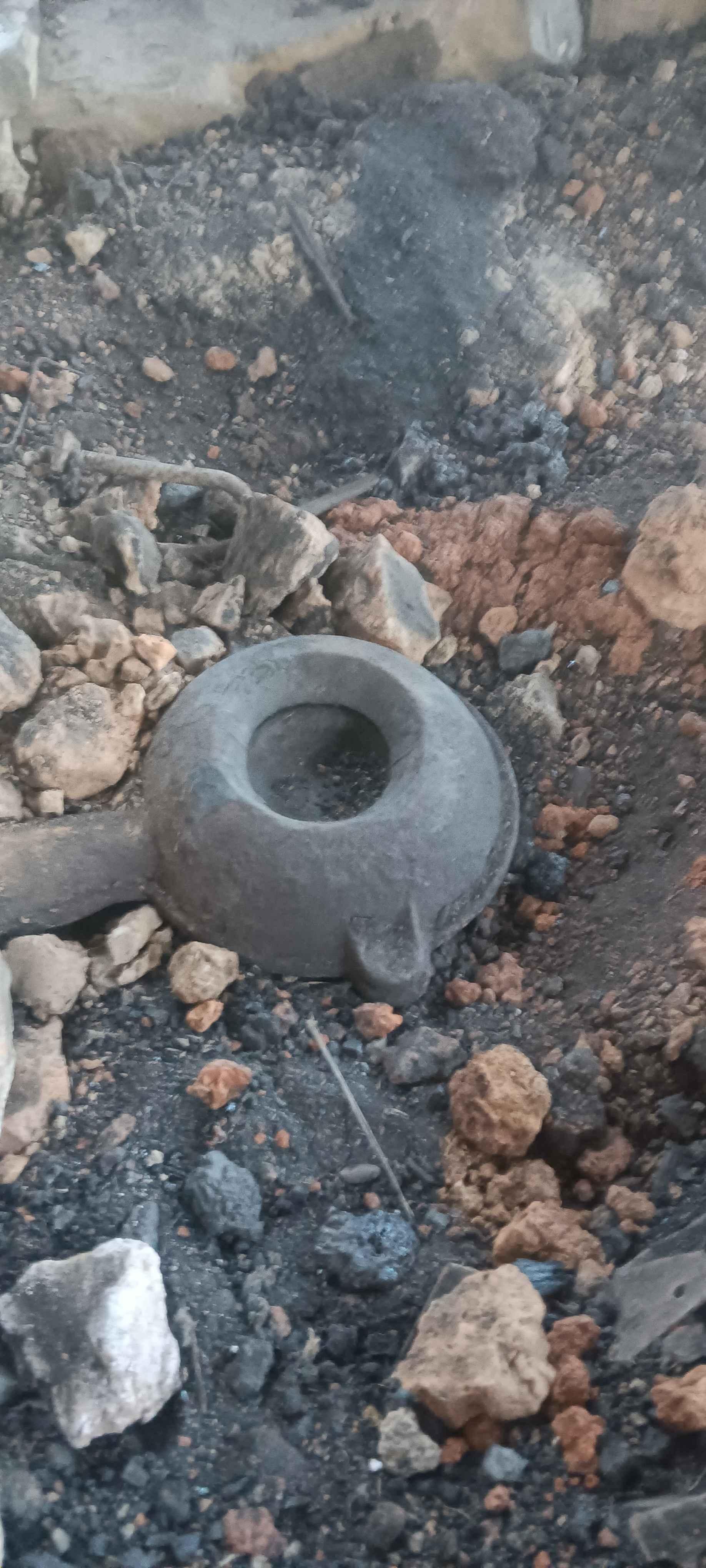

Pie Posted September 2 Author Share Posted September 2 4 hours ago, Frosty said: Uh. . . Pie. You posted the addresses of pictures on YOUR computer and seeing as you are the only one connected to it all I see are links to nowhere instead of pictures. Oops sorry about that frosty here is atempt 2 I'm putting this one as separate so that it jumps out more but this at the end of the blower pipe and seems too small to be a fire pot but it the only thing I can think of. air blows though it around that lip of the inner part there Quote Link to comment Share on other sites More sharing options...

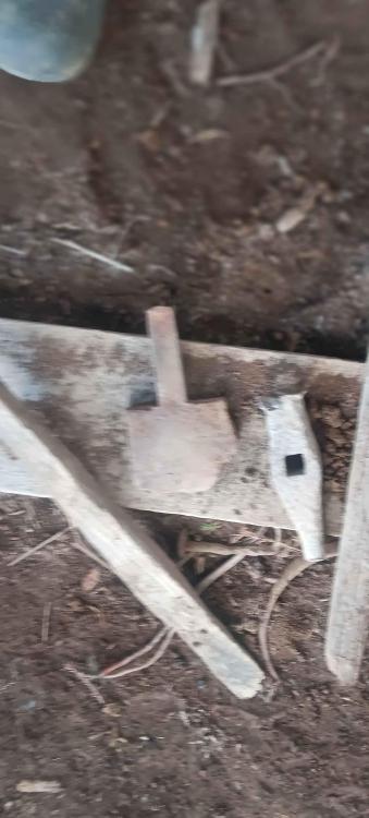

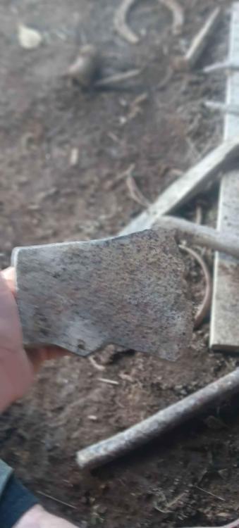

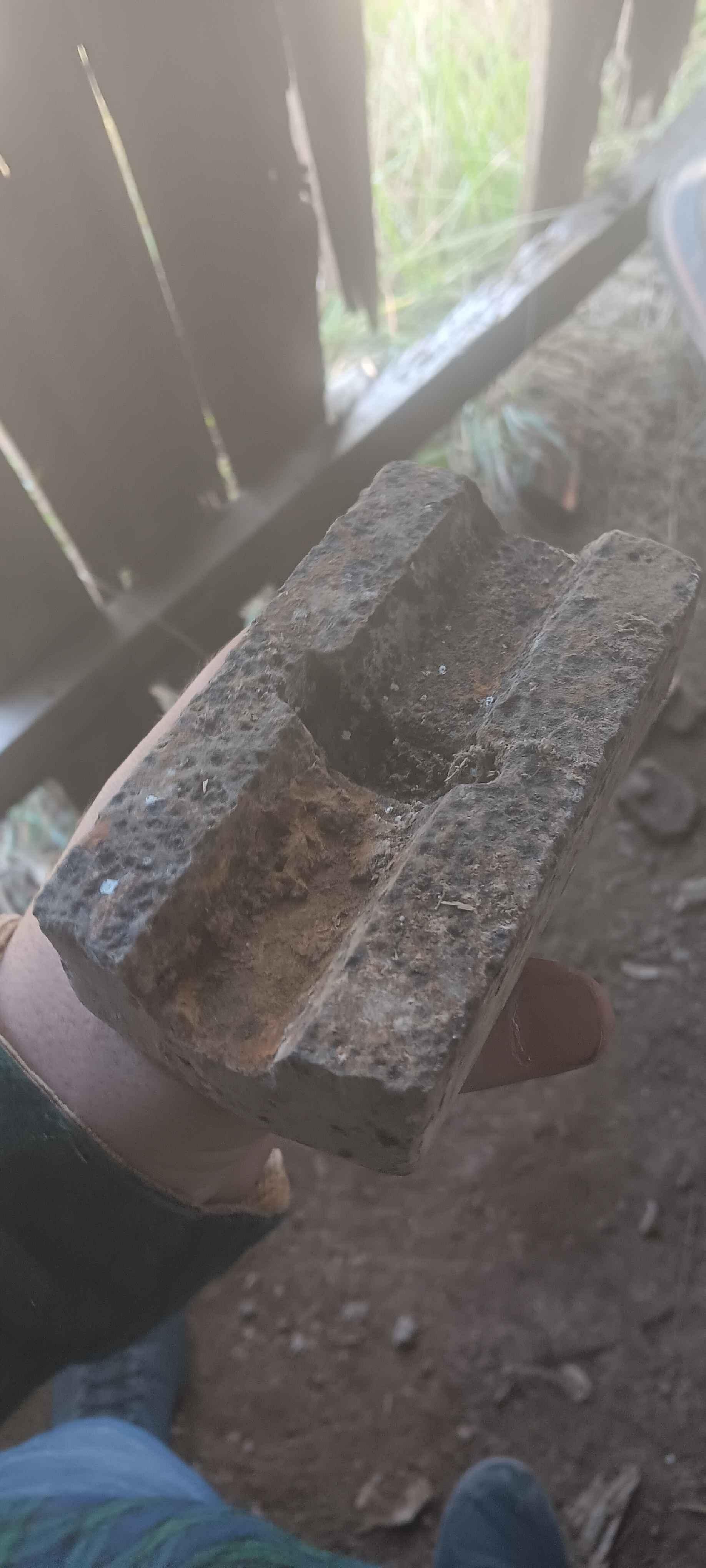

Frosty Posted September 3 Share Posted September 3 No sweat Pie, it's just part of the forum's learning curve. No idea what the first pic is. What's it made of? It looks like concrete of some sort but . . . ? Nice blower, avoid taking it apart at all costs, putting them back together makes PITA an understatement. Expect it to make occasional scraping noises, the fan blades tend to do that. Just a few drops of oil at the beginning of a session is plenty. I don't know if this model has a case with what appear to be level plugs but if it does do NOT fill it! Then tend to leak oil till almost dry if you do. The short round object with the handle eye in the next pic is a punch. I don't know what the blade looking thing on the square shank it. It might be a bottom tool if the shank fits the hardy hole in the anvil but that's just a WAG. Next down on the left might have been a hatchet or maybe a tack hammer. The one to the right might have been an axe blade but that guess is based on the apparent curve to the edge on the right and what might be a lug. The bottom pic is a type of air blast, usually seen in larger forges. I've seen pics and folk on this forum have described how they work but it's been years and I don't recall how they deal with clinker. Frosty The Lucky. Quote Link to comment Share on other sites More sharing options...
Pie Posted September 3 Author Share Posted September 3 1 hour ago, Frosty said: No idea what the first pic is. What's it made of? It looks like concrete of some sort but . . . ? avoid taking it apart at all costs, putting them back together makes PITA an understatement. The bottom pic is a type of air blast, usually seen in larger forges. I've seen pics and folk on this forum have described how they work but it's been years and I don't recall how they deal with clinker. Its made out of something cast and has a shank that fits the hardie hole I made that misatake luckly we all on this farm are half a mechanic half the time Well now i know ehat to look for geuss ill be checking air blasts Quote Link to comment Share on other sites More sharing options...
David Einhorn Posted September 16 Share Posted September 16 On 9/2/2024 at 10:10 PM, Pie said: Its made out of something cast and has a shank that fits the hardie hole In my humble opinion, the bottom tool for possible forming tenons. That said, my personal preference is that a properly built, balanced, and installed grand bellow is much more enjoyable and less strain on my poor shoulder than cranking a blower. Plus, the click click of a grand bellows, to me, is the calming sound of the heart and lungs of the blacksmith shop.... Just my opinion. Quote Link to comment Share on other sites More sharing options...
