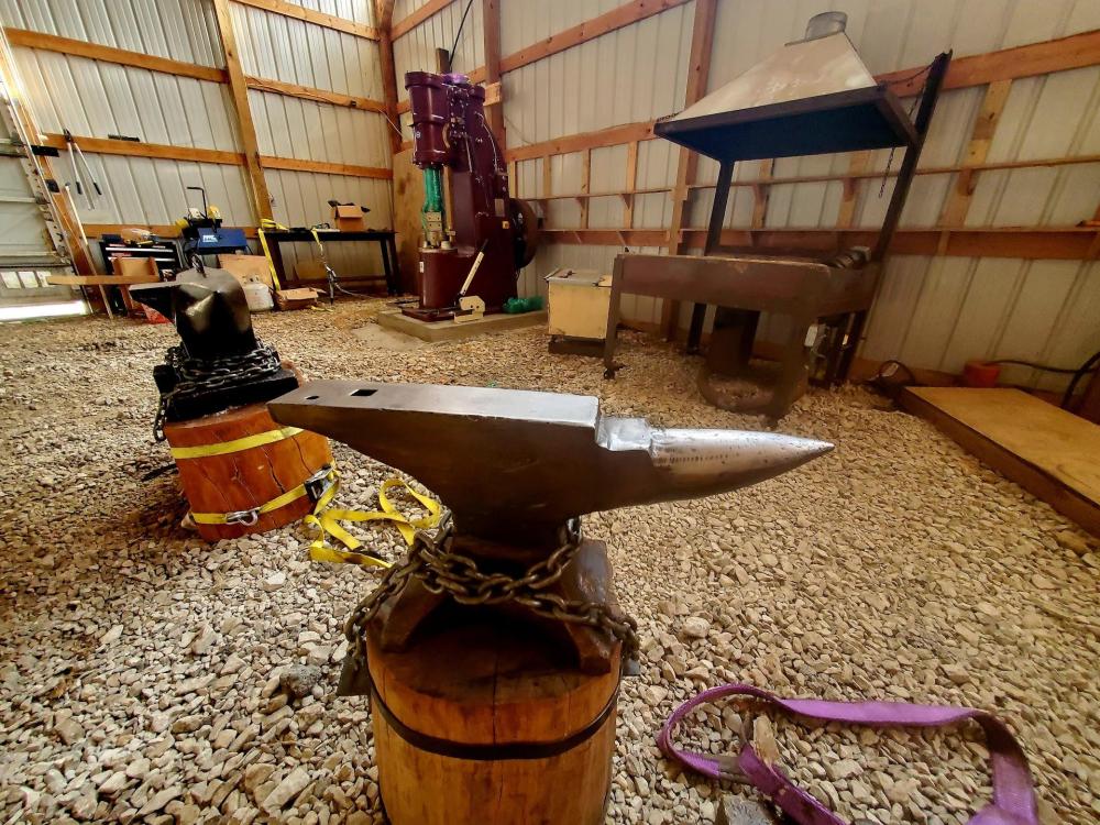

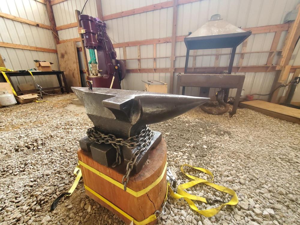

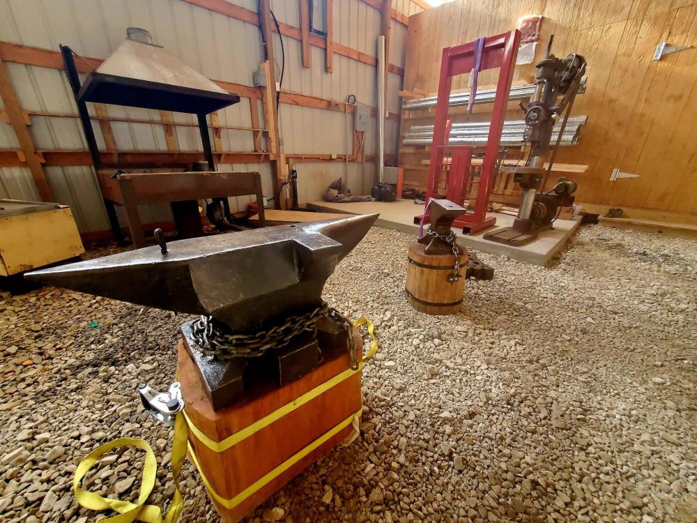

BrennantheNavigator Posted August 18 Share Posted August 18 Hello all, I'm in the process of setting up my smithy. I'd love to hear any comments/ideas/suggestions. One thing I'm finding annoying is the crusher stone floors. While initially thinking this would be great for a forge, it makes moving stuff around, leveling it, and having it stable a pain. Things also don't slide so much as dig a trench. Any advice on dealing with this that does not involve pouring a slab? I'm thinking maybe some sort of fill and sealer? Quote Link to comment Share on other sites More sharing options...
lary Posted August 18 Share Posted August 18 The rock you have looks pretty course/big to me so I'm not sure how this would work. Perhaps try a small spot in a corner out of the way. Tamp down the rocks, sprinkle some cement and spray some water. This works with asphalt grindings. But that is a much smaller aggregate. Thats some nice looking equipment. Quote Link to comment Share on other sites More sharing options...

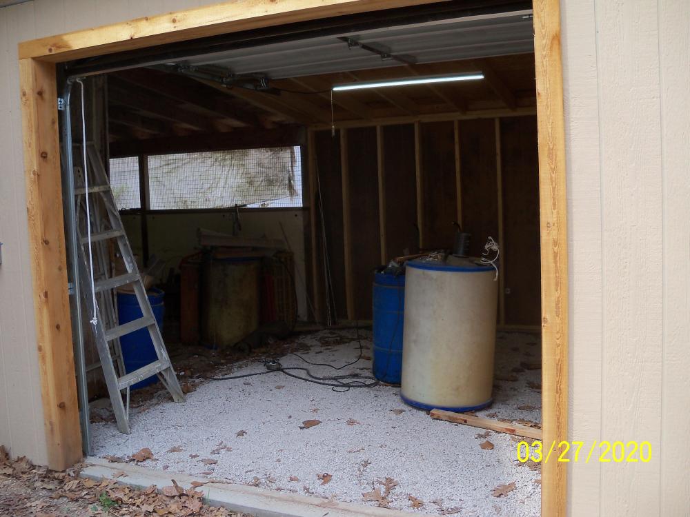

Irondragon Forge ClayWorks Posted August 18 Share Posted August 18 Like lary said a finer aggregate will help. In our area we used crushed limestone and it packs pretty well so wheeled equipment like our propane forge on an old BBQ cart and the A/O welding tanks on a hand truck can be moved easily without digging in. For really heavy equipment we put down sheets of plywood to spread out the load, then put the sheets away when the job is done. You can see the size of the crushed limestone on the outside pad we put in to use the propane forge outside the shop, that same stone is inside. Also used it in the shop addition when I rolled those heavy barrels while standing upright into it. I can't control the wind, all I can do is adjust my sail’s.~ Semper Paratus Quote Link to comment Share on other sites More sharing options...
George N. M. Posted August 19 Share Posted August 19 If you can find it you might try fly ash which is kind of a poor man's concrete. If you have a coal fired power plants anywhere nearby it is the by product of coal burning. I'd try a test section, maybe 3'x3', put enough fly ash on it to fill up all the gaps between the rock pieces, wet it down to get all of the fly ash wet, and then let it dry. If it is strong enough it will prevent the individual bits of rock from moving against eash other. Cement would work also but be more expensive. "By hammer and hand all arts do stand." Quote Link to comment Share on other sites More sharing options...
George N. M. Posted August 19 Share Posted August 19 PS It's a little hard to tell from the photos but it looks to me like your anvils are, IMO, too far from your forge. You want your work triangle of forge, anvil and vise to be just a step or two apart so that you don't waste any time or energy moving between them. If there is too much distance from the forge the metal is cooling before you ever hit it and you are expending more energy walking between the work stations. Other tools like your bench and a power or treadle hammer can be a bit further away with out much of an issue but keep the primary work triangle fairly tight. I'd say 5-6' on each leg would work well. Others may chime in. Quote Link to comment Share on other sites More sharing options...
BrennantheNavigator Posted August 19 Author Share Posted August 19 Sounds like some finer aggregate and/or fly ash will be the way to go. I'm in East KY (profile recently updated) so shouldn't be too hard to find either. The wide angle lens definitely makes things look a little farther apart, maybe 8 feet from the forge but I'll probably end up tightening things up once I get a little farther along; there's still a ton to do, but I can putz around on my little propane forge set up wherever I need it in the mean time. Still on the list: source and build a chimney out of used double wall pipe, get the hammer bolted down and wire the RPC up, assemble the press and belt grinder, mount a few vises, get the big anvil stump properly strapped, build a stand for the 200 lbs swage block, install better over head lighting... it's a slow process but headway is being made. Quote Link to comment Share on other sites More sharing options...

Frosty Posted August 22 Share Posted August 22 Welcome aboard Brennan, glad to have you. The aggregate on your floor is a lousy gradation, it's all coarse. I'd have to get a live look at it to be specific but whatever you do you'll need to mix it EVENLY to depth. You want particle sizes that decrease in such a way they fill the voids in the next larger size, etc. Ideally a good hard packing fill will only have a few % fines. Just adding cement, or sand, or whatever won't be nearly as effective as mixing in a mixture of smaller material. One % silt or clay makes a good binder if your ground isn't prone to turning to mud. Adding Portland cement works IF there is sand and fines available. Heck, you might get away with mixing about 1pt. Pea gravel and 1pt sand and about 1/4pt portland cement. You'll want to remove everything so you can mix and compact it. Do NOT over-wet it! Mud is a B A D thing to make when compacting soils! Frosty The Lucky. Quote Link to comment Share on other sites More sharing options...
