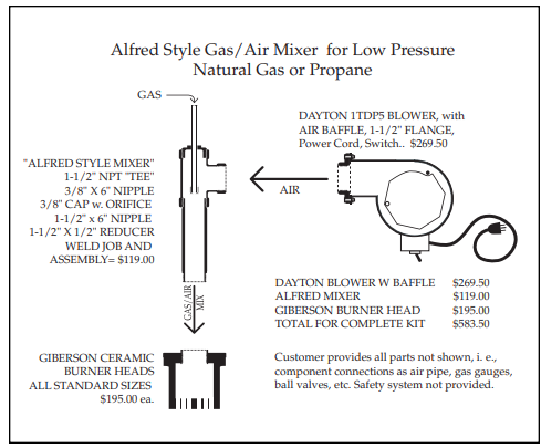

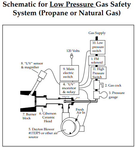

Latticino Posted July 1 Share Posted July 1 Options for blown burners from Giberson's site: Quote Link to comment Share on other sites More sharing options...
Mikey98118 Posted July 1 Share Posted July 1 Latticino, back in 2000 I stumbled across Giberson, and bought his excellent little book. The only reason why I didn't buy his burners, was because he was into hot glass work, with much longer heating cycles. I had some doubts about how well his burner heads would hold up with repeated fast thermal cycling. However, Kast-O-lite ribbon burners seem to be doing okay in forges. Eventually, I think something very like his burner heads will end up as the standard burner in forges. Perhaps, with a little tweaking of what refractory is used to make them. Quote Link to comment Share on other sites More sharing options...
Latticino Posted July 1 Share Posted July 1 Mike, I used his high alumina ceramic multi-port burner heads in hot glass glory holes (no joke intended) for years without any problems. These warm up quickly from room temperature in the morning and ran typically for around 4-6 hours (until I ran out of steam) then were allowed to cool to room temperature. Of course with blown burners I always ran air through them both in the pre-fire cycle and afterwards, during shutdown, so they may not have experienced the same level of thermal shock. Quote Link to comment Share on other sites More sharing options...
