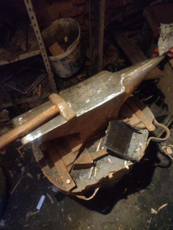

natkova Posted January 18, 2023 Share Posted January 18, 2023 Can working cold on anvil dent anvil damage it a bit. i wanted to straighten one plate it had some curve, and i noticed like tiny dent from it. And i stopped will do it again in forge some other time. Reason i wanted to do this is becasue i want plate that will protect anvil from chiseling drifting etc while you could go trough hot steel and damage anvil. Ironicaly i think i damaged a bit, like hair thickness. Now i see its called hardy plate , but iam plaing to make it U shape so you can move it across anvil. Link to comment Share on other sites More sharing options...
JHCC Posted January 18, 2023 Share Posted January 18, 2023 What you describe is usually called a saddle plate or something like that. I use one all the time, especially when chiseling under the treadle hammer. In response to the general question, it all depends on how hard your anvil face is and how hard you hit it (and with what). Some anvils are harder than others; the softer ones will dent more easily. Link to comment Share on other sites More sharing options...
Frosty Posted January 18, 2023 Share Posted January 18, 2023 That depends on what kind of steel the plate is made of and how good your anvil is. I see John and I are replying at the same time. We call what you describe as a saddle or chisel plate, one for punching holes is a bolster plate. I have a piece of 5/16" mild steel plate I keep within reach if I'm using a top cut or chisel, if it finally gets too warped to stay put I might lay it crown up and smack it with a hammer to flatten it but I'm more likely to replace it with. If it warps too much too quickly I'd use thicker plate for the next one. Frosty The Lucky. Link to comment Share on other sites More sharing options...

anvil Posted January 19, 2023 Share Posted January 19, 2023 Yup, thats how it works, and a good habit to have. When straightening or taking the bow out is different than cutting. You don't need a plate underneath. Hit the high point hard enough to straighten it but not hard enough to forge it. Straightening takes out the bow, forging changes the crossection meaning the thickness changes. When punching holes hot, punch from one side with only your anvil underneath til it bottoms out, then turn it over and you can see where you punched. Center this over the pritchel hole or a plate with different sized holes, as was described above and back punch to remove the "button". Link to comment Share on other sites More sharing options...
Shainarue Posted January 19, 2023 Share Posted January 19, 2023 Others have already answered but I'll tack on to suggest you might be able to straighten that plate by putting it in the vice and squeezing it straight. Depends on how thick it is and what kind of steel. Like Frosty, I use a piece of mild steel for my cutting plate - although mine is only 1/4" (6-7mm). Link to comment Share on other sites More sharing options...
natkova Posted January 19, 2023 Author Share Posted January 19, 2023 Well I made it it's still kinda jumpy but when you work with hot chisel and some holdfast I hope it won't jump that much. This new fuller helped a lot to bend it in vise. I didn't had sharp corner on bend so I used fuller to bend it more . I sandes a little bit face of anvil and horn Link to comment Share on other sites More sharing options...
Glenn Posted January 19, 2023 Share Posted January 19, 2023 A chain, secured on one end and with a weight on the other, thrown across the work piece will help some. Sharp corners are improved with the metal heated or HOT. The metal bends a lot easier that way. Follow that with a hammer to improve the sharpness. Link to comment Share on other sites More sharing options...

natkova Posted January 24, 2023 Author Share Posted January 24, 2023 Can dent in steel and some humps (saddle part) damage anvil? Link to comment Share on other sites More sharing options...
Goods Posted January 25, 2023 Share Posted January 25, 2023 The softer material will deform first. So, as long as you saddle is mild steel, you should have nothing to worry about. Keep it fun, David Link to comment Share on other sites More sharing options...
natkova Posted January 26, 2023 Author Share Posted January 26, 2023 On 1/25/2023 at 1:23 AM, Goods said: The softer material will deform first. So, as long as you saddle is mild steel, you should have nothing to worry about. Keep it fun, David Ian not sure if it is mild steel because it's is old stove plate . Link to comment Share on other sites More sharing options...
Goods Posted January 26, 2023 Share Posted January 26, 2023 You could always anneal it. It would work harden over time, but by then the underside should match the surface of the anvil… Keep it fun, David Link to comment Share on other sites More sharing options...
George N. M. Posted January 26, 2023 Share Posted January 26, 2023 Nat, if it is what we would call a "stove lid", round with a recess to use a stove lifter to remove it when hot, it is likely cast iron rather than steel. Try a spark test. GNM Link to comment Share on other sites More sharing options...
Frosty Posted January 27, 2023 Share Posted January 27, 2023 Post a picture Nat, stove parts aren't usually good blacksmithing tools or stock. Frosty The Lucky. Link to comment Share on other sites More sharing options...
natkova Posted January 28, 2023 Author Share Posted January 28, 2023 On 1/26/2023 at 7:59 PM, Frosty said: Post a picture Nat, stove parts aren't usually good blacksmithing tools or stock. This plate under chain Link to comment Share on other sites More sharing options...
