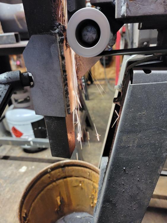

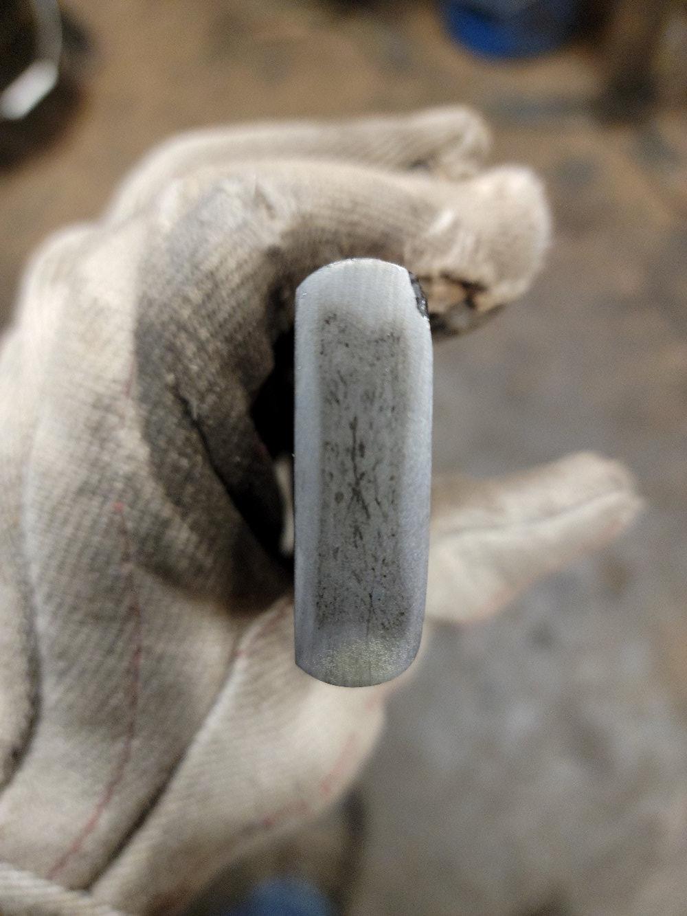

M3F Posted January 17, 2023 Share Posted January 17, 2023 Hello. Looking at some pieces from other makers, some wrought items have a distinct layered pattern when etched. Does the WI need to be cut, stacked and welded to achieve that look or will working/drawing it out do it? That's pretty much it. I've read through the forum about everything WI and think I have a better understanding of what I have. It seems to be more refined to me. It works at lower temps without splitting and the tear test showed a tight string cheese look. Here is a few pics of what mine looks like as is for g-whiz. Any observations are welcomed. Quote Link to comment Share on other sites More sharing options...
ThomasPowers Posted January 17, 2023 Share Posted January 17, 2023 Old bloomery wrought iron starts out as a bloom that is a pretty nasty mix of iron, slag, ore, furnace wall, fuel, etc. You take that and consolidate it as "Muck Bar". (It can be very mucky---the worst blooms we have worked were consolidated on a wooden stump with a wooden mallet to keep it from "splashing" when hit.) Take several muck bars and forge weld them together and forge them down and you get Merchant Bar; which was what was commonly sold. If you take several Merchant Bars and stack and forge weld them together and forge out into a bar you get "Singly Refined Wrought Iron" repeat for Doubly Refined and repeat again for Triply Refined Wrought Iron. I've noticed that every culture that used the bloomery method seems to have come up with pattern welding. Also a lot of scrap Wrought Iron was "busheled" stacked and welded into a recycled bar. Now later processes didn't do as much "stack and weld" stuff and so doesn't show as much pattern. Quote Link to comment Share on other sites More sharing options...
George N. M. Posted January 17, 2023 Share Posted January 17, 2023 Yes, wrought iron has a "wood grainy" structure because of layers of silicates in the iron. You can often see this structure in rusting patterns or when broken by bending it will look like a piece of broken green wood. I am sure that is what you are seeing in your samples. Wrought iron will also give a distictive spark pattern on a grinding or cut off wheel, straight spark lines with little or no secondary or tretiary bursts. No stacking and welding needed. Also, wrought iron is rather easier to weld because the silicates make it sort of self fluxing. BTW, where in the Buffalo area are you? My in laws lived in East Amherst and I spent a lot of time in the area, mainly up and down Transit Rd. "By hammer and hand all arts do stand." PS Thomas has described the process by which the silicates get layered in the metal. So, the "stacking and welding" occurs in the manufacturing process. The more "refined" a piece the finer the grain of the silicates. Quote Link to comment Share on other sites More sharing options...
M3F Posted January 17, 2023 Author Share Posted January 17, 2023 Thanks for the input, yes I read what Thomas wrote in an older thread. Very helpful. I'll work what I have as is then and see how it comes out. I am in Clarence, a baseball throw away from Transit. Small world... Quote Link to comment Share on other sites More sharing options...
M3F Posted January 20, 2023 Author Share Posted January 20, 2023 UPDATE. Here are more pics of an untouched sample after a long etch. I'm also having a full spectro analysis done. The PMI gone showed the following. Zn 1.22%, Pb 0.37%, Fe 94.97% +/- 1.55 I'll update again after I get the spectro analysis. Just curious what you guys think. Thanks! Quote Link to comment Share on other sites More sharing options...
Goods Posted January 20, 2023 Share Posted January 20, 2023 It certainly looks like wrought iron, but much more refined than any that I’ve worked… Keep it fun, David Quote Link to comment Share on other sites More sharing options...
