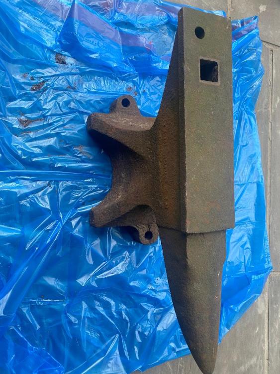

Texas99 Posted November 28, 2022 Share Posted November 28, 2022 Have this anvil and not sure what it is? There is a mark but it is very rusted hard to make out? Quote Link to comment Share on other sites More sharing options...
JHCC Posted November 28, 2022 Share Posted November 28, 2022 Hi, Texas99! Welcome to IFI! As you say, it's kind of hard to read. Do you have photos of the whole anvil? That can often be revealing. (Just so you know, my first guess is that this may be a solid cast-iron anvil-shaped-object and therefore not much good for anything other than as a doorstop, a boat anchor. I could be wrong, though. When you tap it lightly with a hammer, does it go BING or thud?) (Also, if you haven't yet, please READ THIS FIRST.) Quote Link to comment Share on other sites More sharing options...
Irondragon Forge ClayWorks Posted November 28, 2022 Share Posted November 28, 2022 Welcome from the Ozark mountains. I figure from your sign on name you may be in Texas. If so there are several anvil makers in Mexico that copy anvils made in the U.S. but are poor quality cast iron anvils without a hardened face. Not to discourage you and I may be way off on that. As JHCC said more pictures from all sides and the bottom of the base may shed more light on the maker. Also if you have a 41/2 in angle grinder with a wire wheel that will usually clean off the rust better and other markings like a serial number on the front foot under the horn or weight markings may show up. What does it weigh? If it has good ring and rebound it really doesn't matter who made it it's a good anvil. Quote Link to comment Share on other sites More sharing options...
Texas99 Posted November 28, 2022 Author Share Posted November 28, 2022 It makes a very high pitch ping and resonates when you hit it. Not sure about weight have not weighed it yet, the length is 20 inches front to back. Quote Link to comment Share on other sites More sharing options...

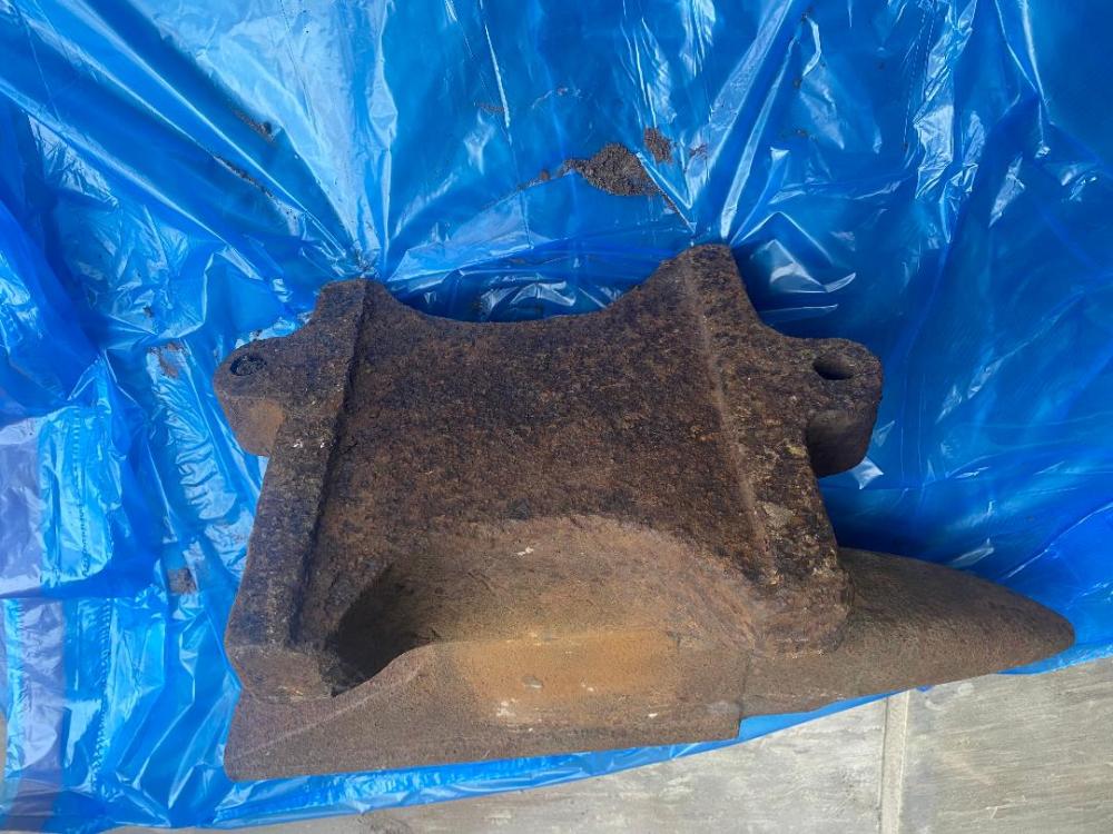

Texas99 Posted November 28, 2022 Author Share Posted November 28, 2022 There are no mouse holes so assuming cast, feet look like fisher? Definitely makes a very nice high pitch ping that resonates. Thanks Actually located in New York, Texas was my home town. Quote Link to comment Share on other sites More sharing options...
JHCC Posted November 28, 2022 Share Posted November 28, 2022 The feet definitely look like Fisher, but that top really does look cast to my eye. One would expect the face and body to corrode differently if they were different metals. The hardy hole is also really big. Odd. Could you take another photo of the inscription, with the light at a very low angle to the side? That might throw up some shadow lines that could make the inscription easier to read. 52 minutes ago, Texas99 said: no mouse holes I think you mean "handling holes", the holes that would receive the porter bars used to move the anvil around the factory. "Mouse Hole Forge" was an anvilmaker in Sheffield, England. Where in NY? Quote Link to comment Share on other sites More sharing options...

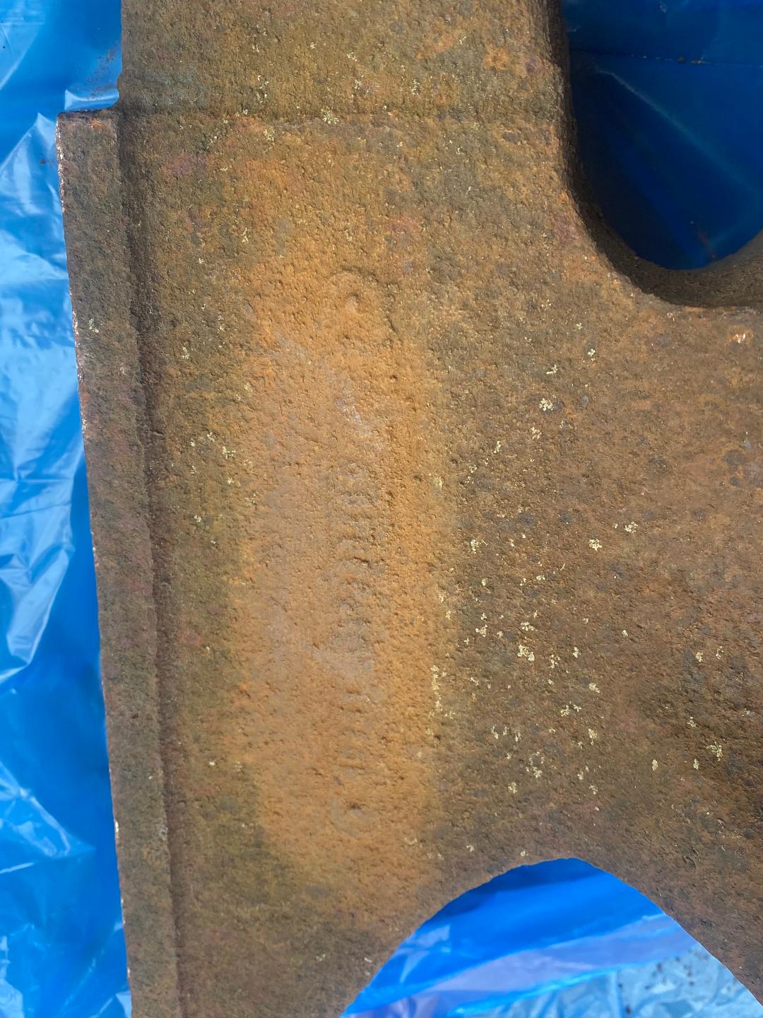

Texas99 Posted November 29, 2022 Author Share Posted November 29, 2022 I am a newbie but the anvil gives off a high pitched nice ping or ring no matter where you hit it? Side, legs... Can this be a forged anvil? Below is another pic did some gentle steel wire but still can't make it out? Quote Link to comment Share on other sites More sharing options...
George N. M. Posted November 29, 2022 Share Posted November 29, 2022 Tex, welcome aboard from 7500' in SE Wyoming. Glad to have you. Try dusting the logo with flour or talcum powder or corn starch and it may bring some detail out after you apply it and lightly brush of the high spots. It may not work but it may be worth a try. Generally, forged anvils tend to ring more than cast ones, IIRC. "By hammer and hand all arts do stand." Quote Link to comment Share on other sites More sharing options...
Texas99 Posted November 29, 2022 Author Share Posted November 29, 2022 I am starting to think its cast steel it sings if i hit it anywhere. Quote Link to comment Share on other sites More sharing options...
Daswulf Posted November 29, 2022 Share Posted November 29, 2022 If it rings like you say it is most likely cast steel. Quote Link to comment Share on other sites More sharing options...
JHCC Posted November 29, 2022 Share Posted November 29, 2022 Certainly a strong possibility. Quite a puzzler. Quote Link to comment Share on other sites More sharing options...
Texas99 Posted November 29, 2022 Author Share Posted November 29, 2022 Thanks everyone i will try to do some more light brushing and use flour or powder to see if i can bring out the text. Looking at it now it looks like just numbers? almost like a serial number. Quote Link to comment Share on other sites More sharing options...
Frosty Posted November 29, 2022 Share Posted November 29, 2022 Shine the light from a low angle to the side and take a pic. Direct flash fills the texture making it hard to see, compare the center of the full moon to the edges for example. Don't worry about taking a twisted wire cup brush on an angle grinder to the body to remove the rust or electrolysis to convert it back to iron/steel. Unless you like rust that is. Frosty The Lucky. Quote Link to comment Share on other sites More sharing options...
njanvilman Posted December 4, 2022 Share Posted December 4, 2022 The above anvil was NOT made by Fisher. There is no way to know who made it until the "label" is cleaned off. Quote Link to comment Share on other sites More sharing options...
Texas99 Posted December 5, 2022 Author Share Posted December 5, 2022 I tried to clean off with wire brush but I am scared to wear down the letters / numbers. What is the best way to remove the rust while keeping the name or numbers intact? The attached photos is the best I could get. Its a wild guess but looks like a year 4 numbers, than a space and another series of numbers like serial numbers. Seem like a plate attached to the anvil? The anvil is definitely cast steel. Quote Link to comment Share on other sites More sharing options...
Daswulf Posted December 5, 2022 Share Posted December 5, 2022 Or it was a plate attached to the die to make the mold I've seen wood pieces shaped to whatever shape they would want with metal plates with info on them used to make molds to be poured with cast iron or cast steel. I don't know what to tell you on trying to figure that out further, but I would say to go with the least destructive (maybe wipe it with flour to raise the definition) to something else less destructive to (only if you are desperate and it could possibly not work and is irriversable) flat sand or grind a little off the face of the letters/numbers to take away the corroded portion and see if it raises the definition of what is there. I personally would be less worried about who made it and more concerned with using it. (Unless you are trying to sell it and think a maker might help. But the main thing is with any anvil is, there are good ones, and not so good ones, and a maker stamp typically doesn't determine that but the rebound and condition do. Just saying. If you are patient enough maybe someone will find this thread that has one similar that is more legible and can shed light on it. (Could be days, weeks or years). Quote Link to comment Share on other sites More sharing options...

Bud in PA Posted December 6, 2022 Share Posted December 6, 2022 How about rubbing like they do with grave stones? Get some white paper and some artist charcoal, lay the paper over it and rub on the high spots. Quote Link to comment Share on other sites More sharing options...
