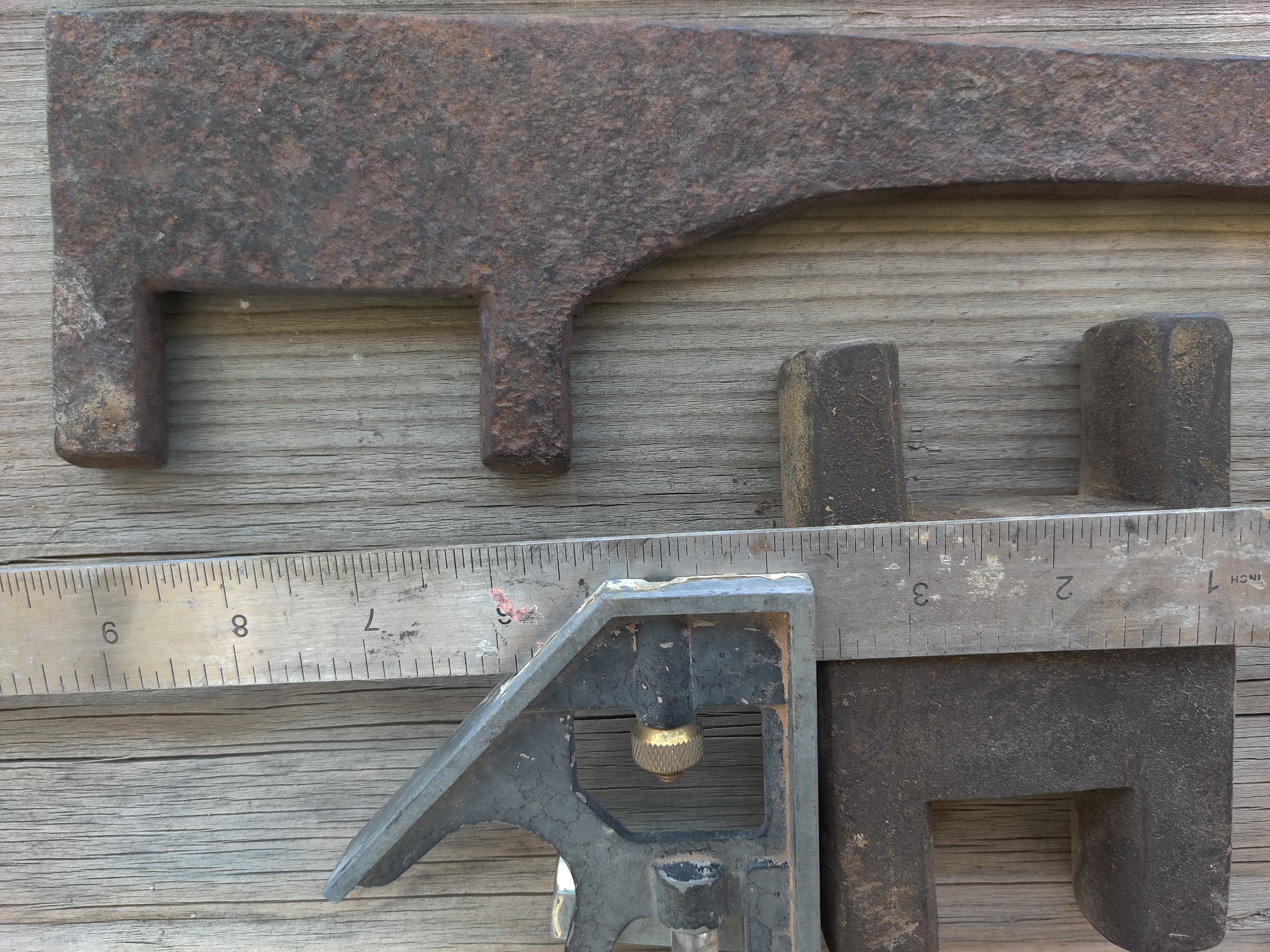

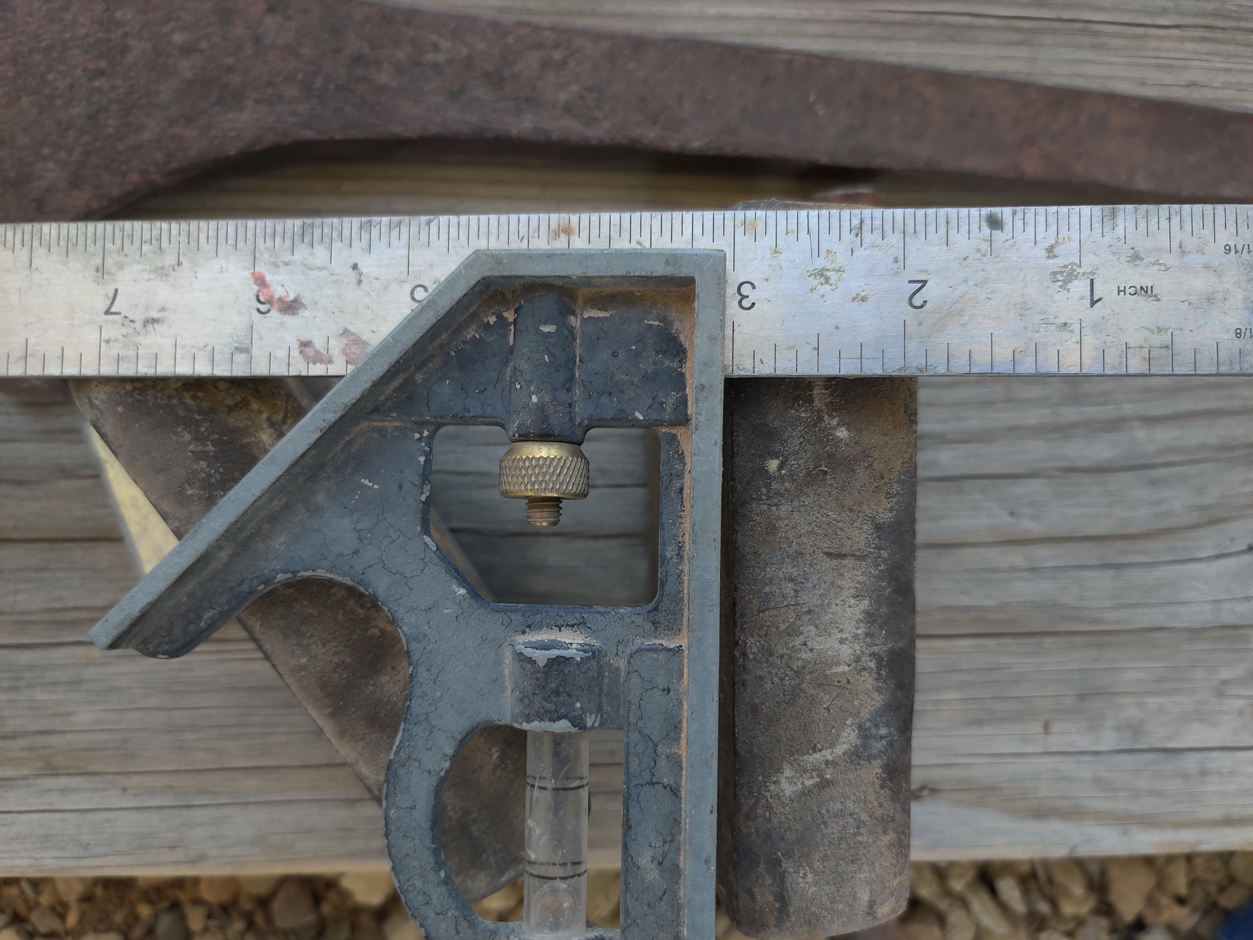

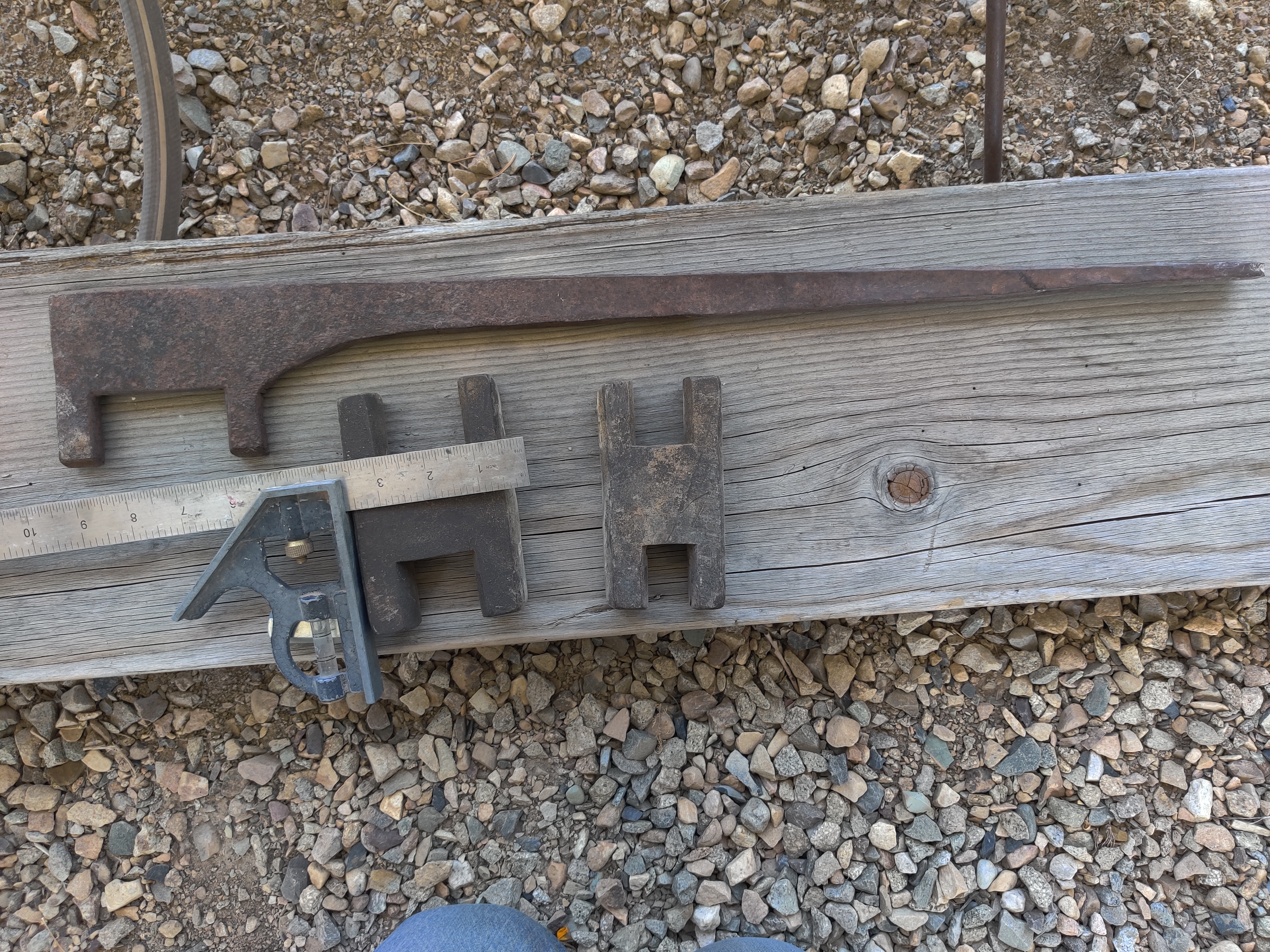

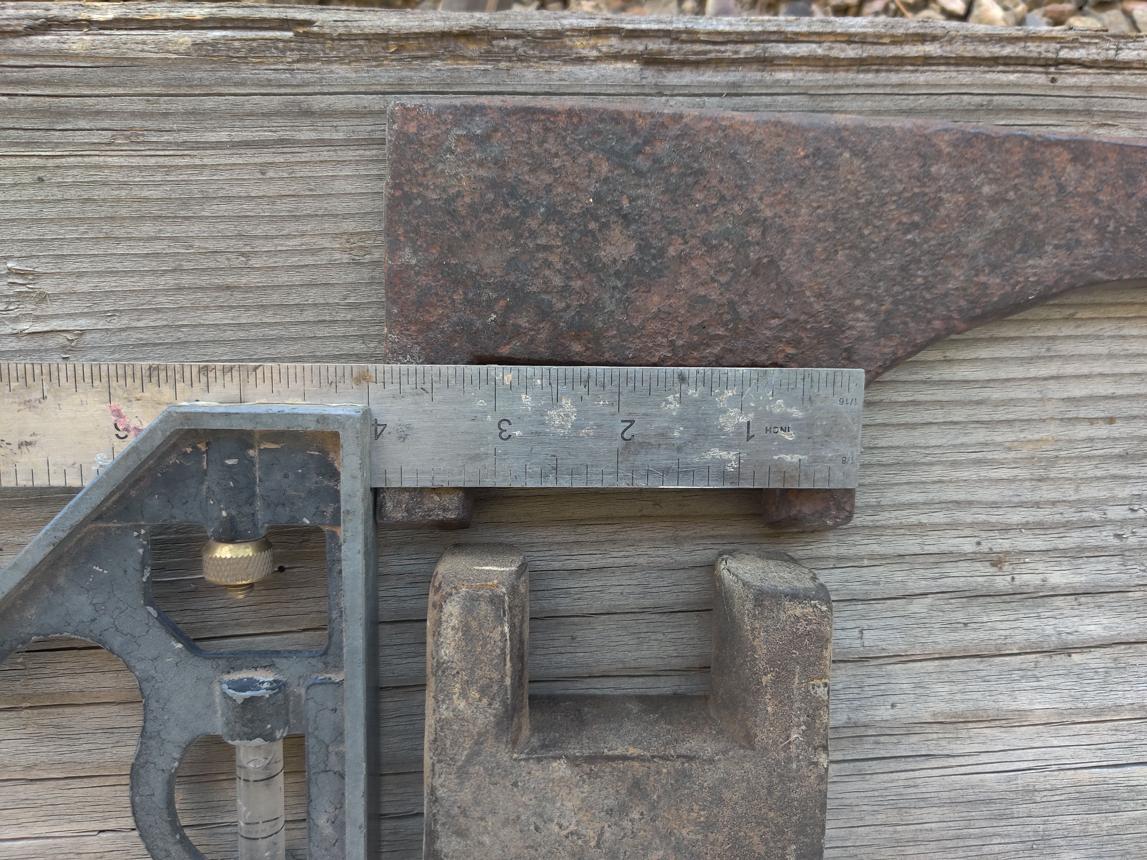

anvil Posted September 7, 2022 Share Posted September 7, 2022 I use my post vice, buried 3' into the ground and large bending forks with a 2"+ opening and a matching scrolling jig. I make these out of large grader blade. Use a cheater on the forks and get your material to a good yellow heat. Heres some pics with dimensions. The scrolling wrench is the first I ever made 30+ years ago and has no problem bending large stock to the day. Make the openings a little larger than the width of your stock. This will enable you to do tight radius'. With a good set of adjustable roller stands, one man can do the job with no sag. The bottom pic shows the thickness. I make "J" bolts like this in one heat in my coal forge. Link to comment Share on other sites More sharing options...
