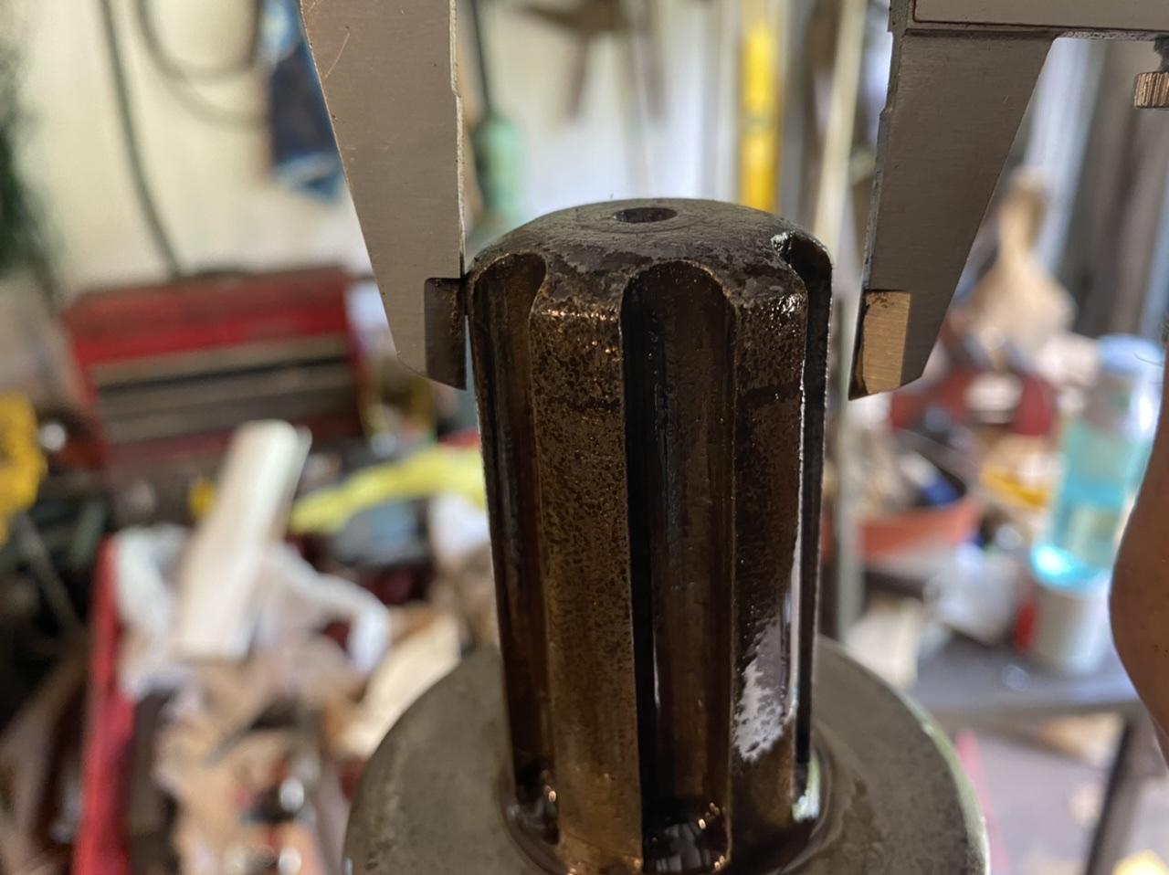

JHCC Posted August 7, 2022 Share Posted August 7, 2022 I have a couple of issues with my new-to-me fly press on which I’d appreciate some advice. The first is that the depth stop is missing. Unlike some older presses and the modern Indian presses where the main screw itself is threaded to take a stop that comes to rest on the top of the frame (as on Anachronist59’s press in THIS COMMENT), mine has a threaded piece attached to the frame, that appears to take a threaded collar of some sort that limits the screw's downward travel. (ADDENDUM: the threaded piece atop the frame appears to be 2-1/4" dia. x 10 tpi x 2-1/2" tall.) I suspect that the stop was originally a very heavy split nut locked in position with a pair of bolts of some variety, one on either side of the main screw. I’m also guessing that the two halves were removed at some point and later lost. There is no easy way to remove the screw (at least, I haven’t figured it out yet), so unless the stop broke off and was never replaced, the two-removable-halves theory seems to me like a more realistic scenario. Any thoughts about how I might go about replacing such a stop? I’ve got a couple of crazy ideas myself*, but I’m open to more realistic ones. The second problem is with changing the position of the handle. I’ve seen a couple of different arrangements for this on other presses, including one where one loosens a setscrew, removes a pin (which normally acts as a key to keep the arm from rotating on the screw), rotates the arm to the proper position, drops the pin back in, and tightens the setscrew. Mine is most like that, at least insofar as it is clearly designed to be positionable at six different angles around the screw: However, not only is the pin a super-tight fit in the arm (slightly less in the screw), the top of the screw and the corresponding bore in the arm are actually tapered by a good 1/16”. This means that in order to remove the arm, you have to remove the weights first, tap sharply on the underside of the arm, lift it off, rotate it to the desired position, drop it back down, and out the weights back on. It seems to me that the simplest solution here would be to make a spacer (about 15/32”) that would keep the arm from dropping down far enough to lock in place; this would fill the space between the underside of the arm and the top of the solid collar at the top of the screw. I'd then make a replacement pin (incrementally thinner than the existing one, but longer so that it can be grabbed onto for easy removal and replacement), and perhaps drill and tap the arm for a setscrew to lock the pin in place. Any thoughts? * And one a bit less-crazy: a series of stackable spacers, with a central hole large enough to fit over the threaded piece on the frame, but with a piece cut out that’s big enough to clear the straight section of the screw shaft. Quote Link to comment Share on other sites More sharing options...

JHCC Posted August 8, 2022 Author Share Posted August 8, 2022 23 hours ago, JHCC said: make a spacer Found an eye bolt whose opening is just a hair too small and whose thickness is just a hair too fat. A little die grinder work, and it should be perfect. 23 hours ago, JHCC said: a replacement pin I have some square stock that would work for this, but a question: does such a key need to be hardened? My existing square bar is A36 or the like, but I could certainly forge or grind some 5160, 4140, or O1 to shape. Thoughts? Quote Link to comment Share on other sites More sharing options...
JHCC Posted August 8, 2022 Author Share Posted August 8, 2022 Update: a half-round file for the inside and a belt grinder for the flats, but all appears well. The fit between the shaft and the arm has the tiniest bit of movement but is otherwise quite snug. The key fits tightly in the keyway in the arm, but moves easily in those cut in the shaft. Lifting and rotating the arm is reasonably easy (especially if I take the weights off first), but a removable key would be easier still. Quote Link to comment Share on other sites More sharing options...
Latticino Posted August 8, 2022 Share Posted August 8, 2022 My pin appears to be mild steel, but I haven't spark tested it. I can certainly see the logic for making out of at least 4140 or the like, but I don't know that I would harden it. Some day you might have to drill it out... If nothing else it is good to have the pin project up out of the locator slot at least an inch or so. This will allow use of a vice grip to help pull it out. Actually my pin is cylindrical, rather than "D" shaped, so it can be rotated to help free it if jammed. Quote Link to comment Share on other sites More sharing options...
JHCC Posted August 8, 2022 Author Share Posted August 8, 2022 Noted; thank you. Quote Link to comment Share on other sites More sharing options...
Latticino Posted August 8, 2022 Share Posted August 8, 2022 If I were forging my own, I might be tempted to forge it like a tennon with a larger diameter top that protruded above the socket. That way you could slide a purpose made claw tool under it to lift the pin if it ever got jammed. Kind of hard to describe, but easy to sketch if you need. Quote Link to comment Share on other sites More sharing options...
JHCC Posted August 8, 2022 Author Share Posted August 8, 2022 I was thinking of a finger loop. Actually, now that I think of it, I wonder if any of the other ring bolts in my supply are big enough to grind down to the proper size. Quote Link to comment Share on other sites More sharing options...
JHCC Posted August 8, 2022 Author Share Posted August 8, 2022 Update: an interesting possibility. Thick enough to grind down to the desired size and shape, easy to grab barehanded, and if it gets stuck, a bar through the eye would give plenty of leverage to muscle it out. Quote Link to comment Share on other sites More sharing options...

JHCC Posted August 9, 2022 Author Share Posted August 9, 2022 The bolt ground down to a properly sized D-shaped cross section: Which, by some pure miracle, worked perfectly the first time. Quote Link to comment Share on other sites More sharing options...
