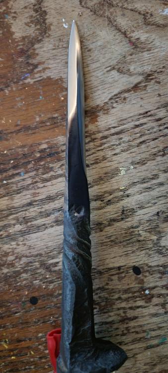

I have just started forging steel.  I decided to try making rail spike knives to begin with and have had reasonable success.  I decided to try to make a blade out of a 1/2" Allen wrench.  It was going well enough then it just broke in the forge.  Any advice?    I am using a propane forge.

Too hot?  Did it "cottage cheese"  on you or burn?  Stop by tomorrow after lunch and we can go over what you are doing and what can be improved.
Your set up looks quite inefficient to me with that long a forge---about twice as long as a good swordmaker's forge! (Unless you have a power hammer, heating more steel than you can work before it cools results in carbon loss, scale loss and grain growth.) The anvil stand has crisscrossed cribbing instead of vertical supports. (Each interface looses some energy so vertical supports has 2: anvil to stand, stand to ground; that one has 10!)  Spending a bit of time at other smiths' forges can really speed up getting started right.  Here in the USA we advise folks to visit a local ABANA affiliate, (NMABA has their next meeting Aug 6 in Albuquerque NM)
The allen wrench might be a high carbon steel. HC steel forges differently than low carbon steel does; why railroad spikes are not good practice for forging knives, even the HC spikes are right at the low/mid carbon steel boundary.
Yep, turn off two of those burners and if you have a cupple of soft insulating fire bricks reduce the size of that beast.
higher the carbon content the lower the max forging temp. Bright orange for 100 point steels, lemon yellow for 60 point and bright yellow for mild steels. White hot for wrought.
Usually it’s coal forges that eat steel but charcoal and gas will  as well.
I have only been using the forward burner since the work is so small.   The allen wrench just came apart when I was removing it from the forge. Right at the base of the blade.  The forge has fire bricks as the base.  The anvil was a gift and is at least 150 years old.  It is 80lbs.  I have considered getting a brand new anvil.
Based on what I see here I probably have it too hot. The heat worked good for the spikes but was probably more than the high carbon steel needed.
Here are some of my spikes.

I've made a lot of RR spike knives and sold a bunch when we had our business. The thing about them when giving or selling one is to inform who ever is getting it, about it's not the best steel for knives. Most of the knives I made were leaf style throwing knives. They were good for that, holding an edge for cutting not so much.
Yea. I view them as novelties for the most part.  I have some old tie plates also. They are cast so can't do much with them.  Thought I might make them a sort of display plaque for some of the fancier looking blades.
