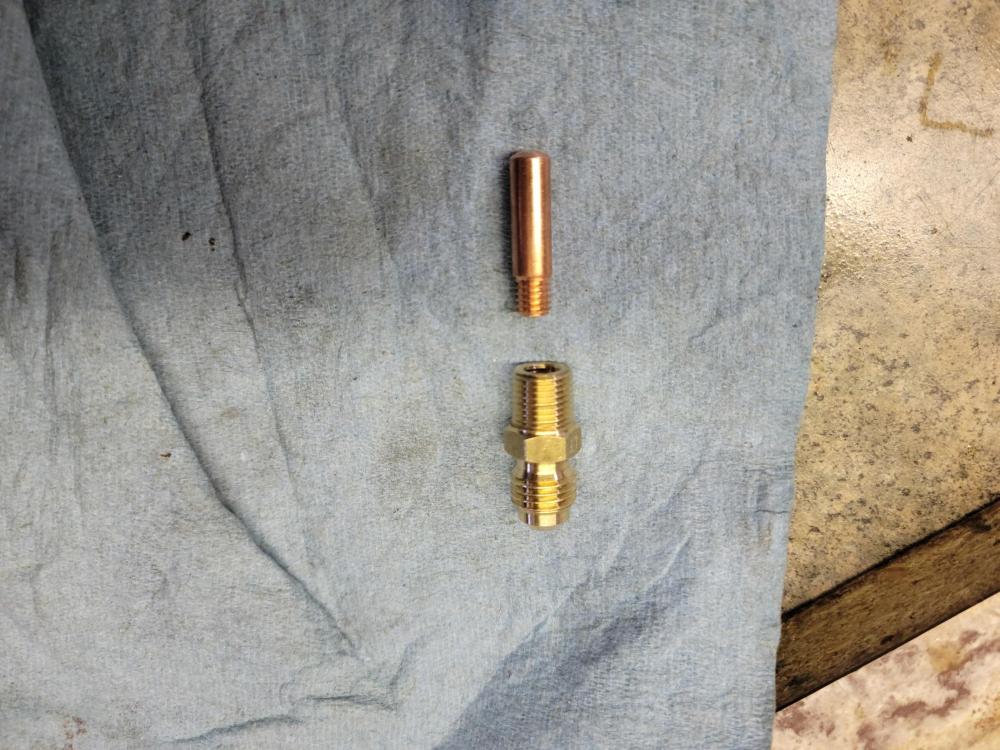

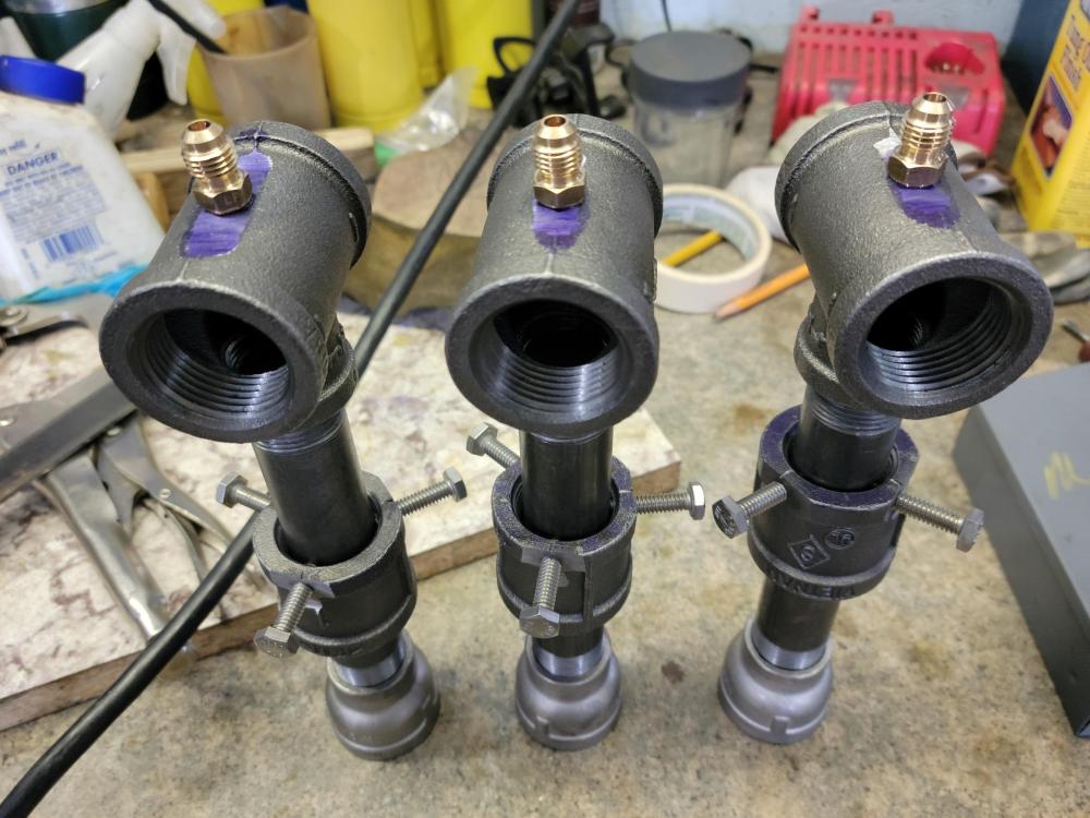

Tooln Posted June 26, 2022 Author Share Posted June 26, 2022 (edited) I do plan on putting a door on the other end also, just haven't gotten that far. Wife's projects you know. Worked on burners today. I don't think I need to explain to you guys, here are some pics. Edited June 26, 2022 by Mod30 Excessive quoting & resize photos Link to comment Share on other sites More sharing options...
Tooln Posted June 26, 2022 Author Share Posted June 26, 2022 I plan to put the burners in the forge body soon. I want to put it off center so I get a swirl out of the flame. Looking for suggestion on how many degrees off center . Thanks in advance. Link to comment Share on other sites More sharing options...
Mikey98118 Posted June 27, 2022 Share Posted June 27, 2022 At least one of those burners has a MIG tip that is out of axial alignment with the mixing tube; you might want to bend it a little bit to adjust that. There are two burner positions that do well; just beyond right angles facing down at the near edge of the floor, and about 45 degrees facing down toward the far edge of the floor. I would suggest the later position with those burners. Link to comment Share on other sites More sharing options...
Frosty Posted June 27, 2022 Share Posted June 27, 2022 Once you have them in the forge and the forge lined you'll need to tune them, they're going to run pretty rich with the mig tip jets so close to the mixing tubes. With the bell reducers as burner nozzles how do you remove the burner to tune it, unscrew the T or the brass fitting? That's okay, don't worry just be careful if you remove the brass fitting that you don't cross thread it putting it back. What size mig tip are you using? Frosty The Lucky. Link to comment Share on other sites More sharing options...
Tooln Posted June 27, 2022 Author Share Posted June 27, 2022 I'm not sure if I'll use the bell reducer. I may just flare out the liner to form the nozzle. I'd be able to unscrew either the T or brass fitting. I have a .035 mig tip. I'm open to suggestions for anything. Link to comment Share on other sites More sharing options...
Tooln Posted June 27, 2022 Author Share Posted June 27, 2022 Mickey98118 good catch on the one might tip not in good alignment. Sharp eye to catch it on the pics. Link to comment Share on other sites More sharing options...

Mikey98118 Posted June 27, 2022 Share Posted June 27, 2022 We have all seen it many times before; I just spoke up first. Frosty would have got it if I'd missed. Link to comment Share on other sites More sharing options...
Frosty Posted June 27, 2022 Share Posted June 27, 2022 I'm not a fan of bell reducers for nozzle flares. Lots of guys make them work but they have to be tuned to work well. You have to tune them anyway but tuned for a bell reducer is not as optimum as for a proper flare. Trimming the liner to form the terminal flare is my favorite, it lets a proper refractory deal with being in direct contact with the flame. Your burner tube will last longer and with the mount you're using you can adjust the depth of the mixing tube in relation to the terminal flare to help tune the flame. I often just glance at pics like those above, camera angle into the air intakes can make the jet alignment look off or good when it's not. You will be trimming the mig tips to make a neutral flame but don't worry till you have them mounted in a lined forge. ALWAYS tune a burner where you're going to use it. Getting it tuned perfectly clamped in a vise doesn't mean doodly when in the forge so don't bother unless you're going to use it as a torch. Frosty The Lucky. Link to comment Share on other sites More sharing options...
