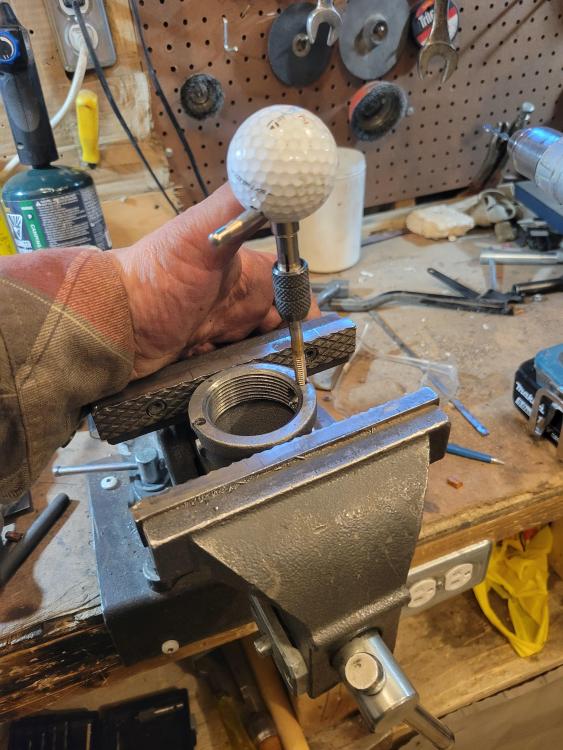

This is the conduit reducer bushing, note the rolled edge where the throat would be. The tip of the contact tip is 1/2" from the initial rolled edge of the bushing, so 1/2" from orifice to throat/narrowest part.

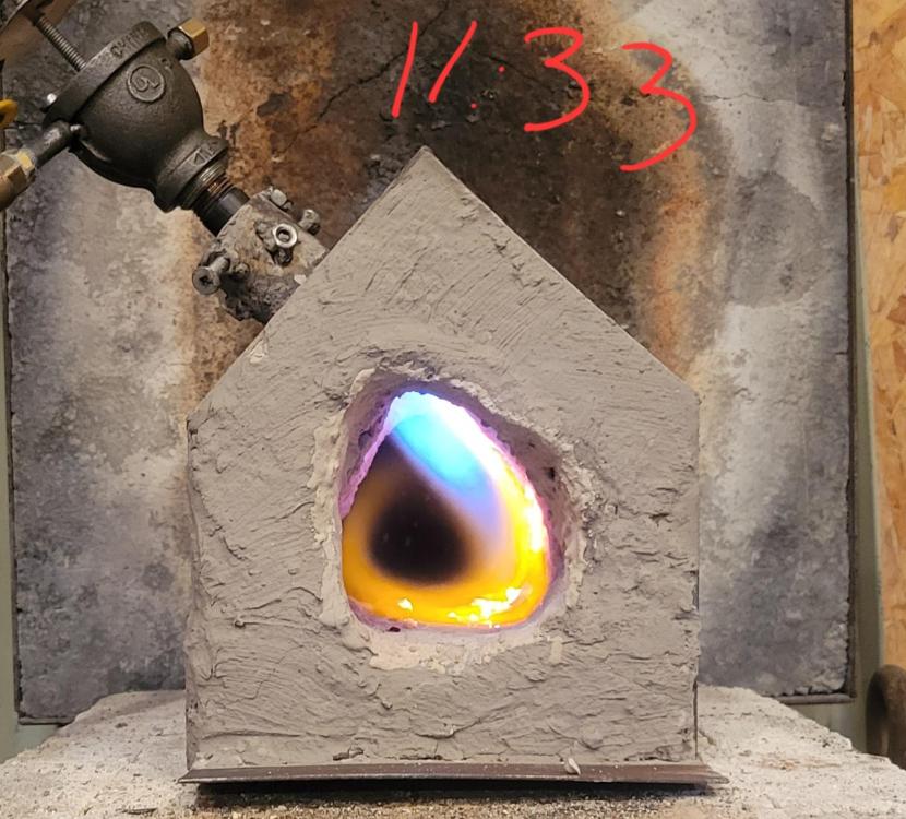

This is with on 1/2 " burner

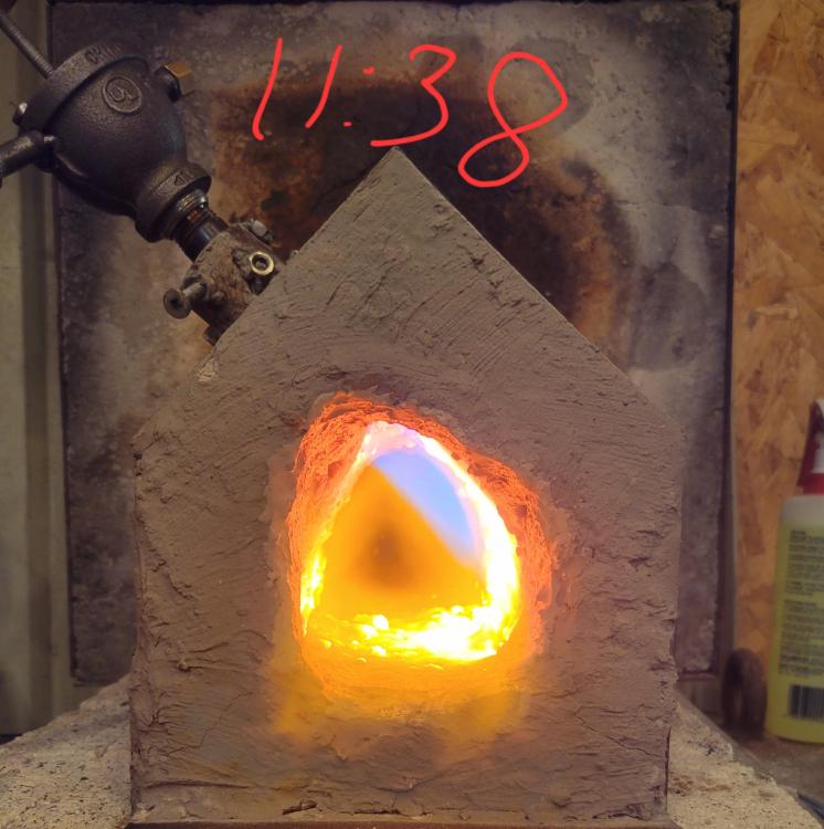

The last pic is with the two 1/2" burner's and there is just too much flame with two of these especially with the 0.8mm instead of the 0.023 I had in originaly. I may go back to the 0.023 depending on the forge they are going into.
This double burner forge will be getting two of my micro burners hopefully in the next week here.
The school house forge has the 0.023 (0.6mm) orifice .

½" x 6" pipe nipple, I presume.  Please post image detail of this element with nozzle, unless I have simply missed it.  Fine presentation, and good to know that the Blue People are looking out for you...

Maybe an easier way to say it would be:
Screw the 1/2"x6" pipe nipple into the rigid conduit reducer bushing, then measure from the end/top of the bushing down 4" and cut off nice and smooth. The bushing and the pipe nipple together should be consider "mixing tube". So if you separate the two your pipe nipple will be less than 4" by a scooch.
The top side of the bushing is the throat.... The measurement from the tip of the contact tip to the throat  on mine is 1/2".

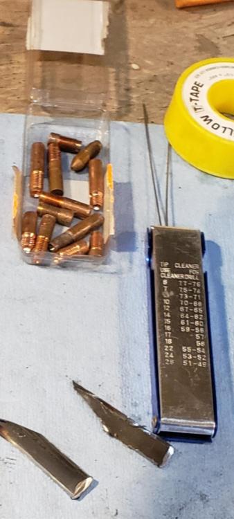

I've got a few different brands of contact tips some quite different I  size others seem to be quite close to the advertised size at least according to the torch tip cleaners. I have used the torch tip cleaners closest by the thousands and end up with 0.025, 0.031, 0.035. Now I could be wrong because I'm using $30 digital vernier calipers but I figure if the caliper says the tip cleaners a certain size and I can't get the next size up into the hole ie the torch tip cleaner that I've measured at 0.030 won't fit in the 0.023 contact tip.
Ughh it sounds like I'm arguing I think..... I'm only sharing observations.... The 0.8mm and the 0.023 contact tips were el'cheepos so for me they're great that they're accurate on the flip side they'd probably jam like crazy at the slightest build up when used for welding
Is there a better way to verify the actual orifice diameter?
Again I used the vernier to confirm the thickness of the torch tip cleaner then tried sliding the cleaner into the contact tips using a drilling motion and calling its diameter whatever the largest tip cleaner fit. (clear as mud right)
Sitting here re reading your comment about orifices Mikey and looking at my pictures and drinking coffee and making sure the cat doesn't start running or going upstairs....
Anyway the last two burners I made I used the 0.8mm contact tips like in these picture's above, I tried tge two together inside that forge that was belching fire. There was too much air and fuel for the chamber so I ran with one of the burners.
I start this thread, write out instructions, post pictures and seen the original burners with the great flames used the 0.023 tips so I deleted those photos and continued posting pics. Not clueing into the mix up I just made I respond to Mike to confirm the size of the hole in the contact tip...... It doesn't matter whether I measured an accurate 0.8mm and it was actually 0.8mm or 0.85mm both are way too big for a half inch mixing tube (insert face palm)
The 0.025 torch tip cleaner will slip into the 0.023 contact tip smoothly without much wiggle at all. Soooo I'll turn these burner heads into simple "3/4" burners" and ditch the fancy reducer bushing.
No ditch the reducer!!! You're on the right path there. What you do want to do is add a nut to the threaded gas tube, to keep it at right angles. Don't worry about air flow; that is all happening closer to the outer regions of the reducer. I am watching you do several things I did, which all worked out just fine. Keep on keeping on. You're doing well.

Describing how you check orifice sizes and calibrate your gauges isn't arguing. Using calipers to check the dia. of the torch files you have is common sense IF you want precise numbers. You're doing the same thing Mike and I did and occasionally still do.
I have to agree with Mike. Trying to adapt a 3/4" burner to operate as a 1/2" burner isn't a good use of your time. Sure it can be done, as you've shown but why? Making a 1/2" burner from the start means you can skip manufacturing the parts necessary to convert something that was perfectly happy before. Not to mention having to tune the less than ideal conversion.

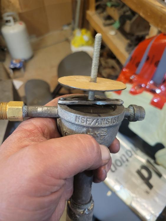

 I may be missing something in my description or I labeled the diagram incorrectly I'm thinking...... There is no lamp rod, the threaded rod at the top of the sketch is jut there to hold the choke plate, what I am calling the fuel rail is still the classic 1/8" nipple that mounts in the opening of the intake horizontally. Made sure they were dead straight then tac welded in place after using jbweld to seal the mig contact tip in place. So downside the fuel delivery is locked in place, upside the fuel deliver is locked..... The only thing I can adjust is the depth of the bushing "throat".
I am happy with the alignment of the jets in these two but if the 0.8mm flows too much fuel for the half inch pipes I'm kind of limited on options for adjustments. If I swap out the half inch nipple / bushing for a 6"x3/4" it should mix a bit better and reduce that dragon breathe.
(the last pic that is really nice is a burner like these but using the. 0.023.... The pic of the forge with heavy dragon breathe is using burners that have the 0.8mm tip)

Maybe this shows how the choke plate and fuel rail are mounted in these burners

No; I was missing something. You're right; the threaded rod is a separate part. Your next step, will be to thread a Schedule #80 1/8" pipe nipple with 1/4-28 thread for the MIG tip, and some of its exterior with 1/8" straight (not tapered) pipe thread. Why a pipe nipple? So that you can leave tapered pipe thread on one end of it for gas fittings, such as needle valves, to be connected with.
No; I was confusing what you did with one of my burner construction schemes. Here it is from my book notes. You may wander why I don't create a simple cross brace like yours. The answer is that I intended for the choke plate to completely close off all air after the burner is shut down.
One method of mounting a gas assembly on small linear burners
