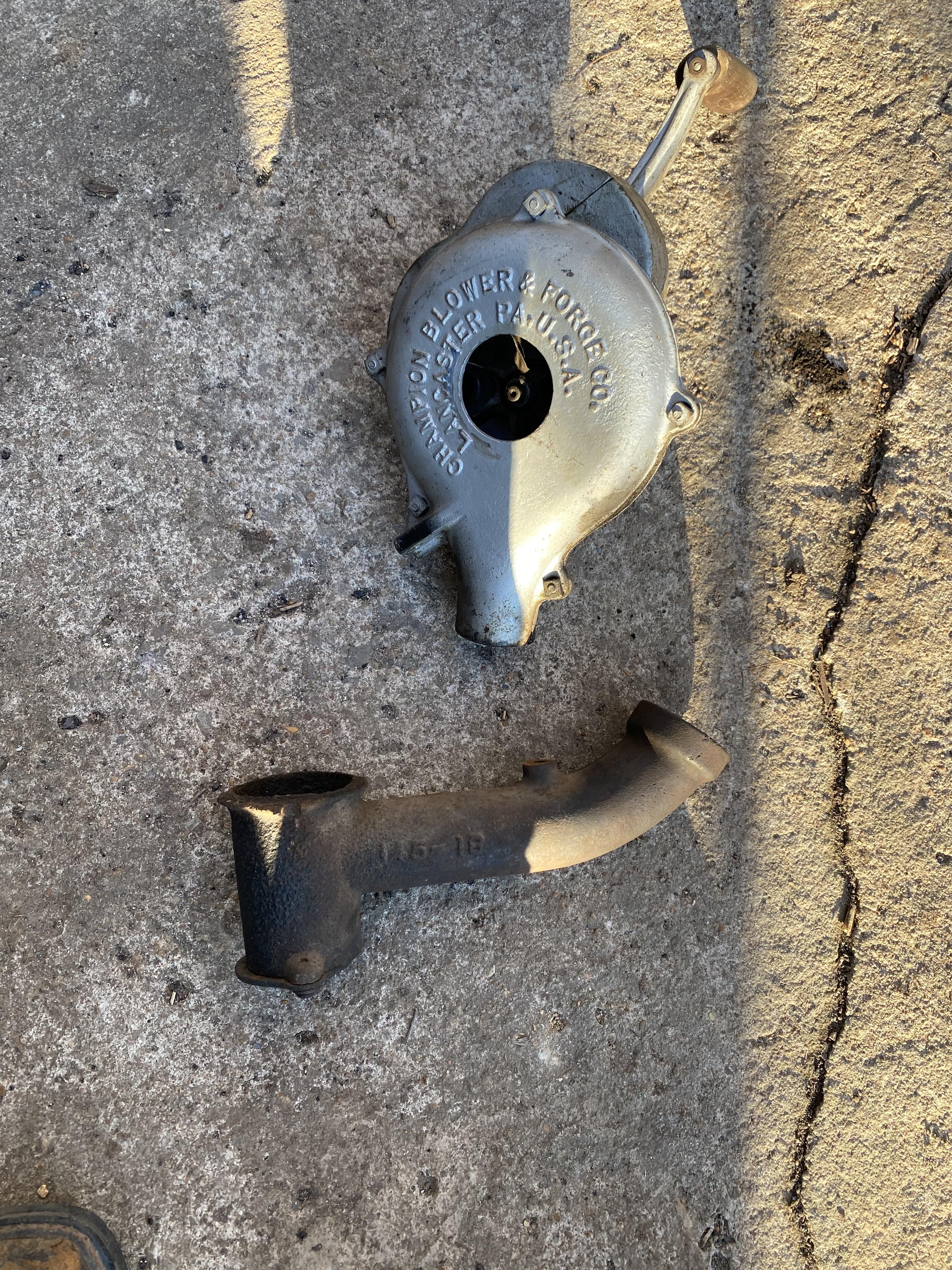

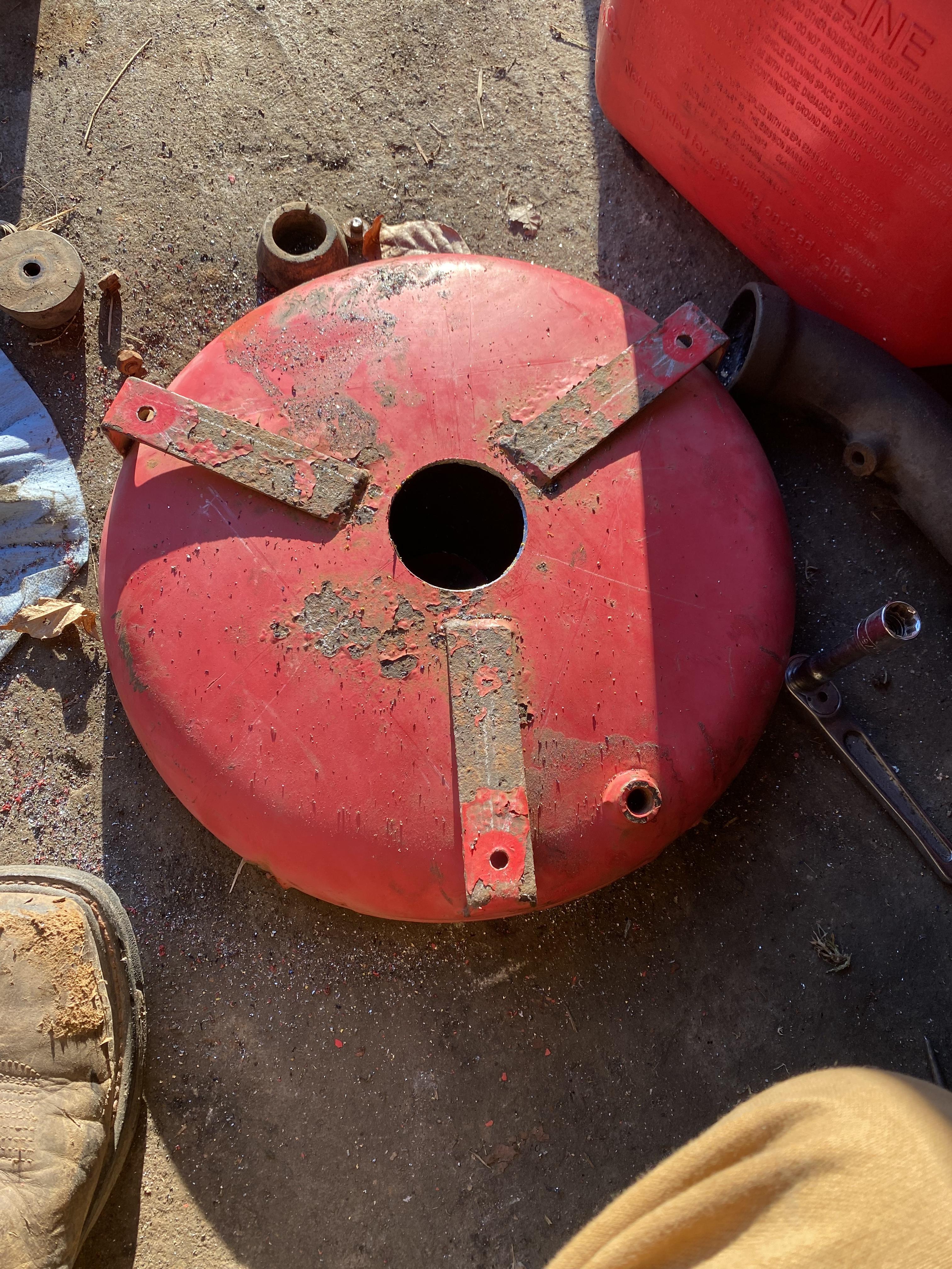

TWISTEDWILLOW Posted February 20, 2022 Share Posted February 20, 2022 Alright y’all, I’ve found another little blower and tuyere pipe this time champion made, just a little bigger the the tiny Buffalo, I’ve decided to use it to build another portable pancake forge! For those who don’t know Ive built a few of these before and learn something new each time I build a new one! this one I’ll be changing up a little of the design and adding some extra features, a special thanks goes out to Frosty, JHCC an Irondragon!!! For y’all’s helpful tips and tricks I used on the last build and this current one! so I started using junk pancake air compressors several years ago to make light little portable forges and the first few were functional but not perfect but with each new one they get better! I started with a salvage cheapo pancake tank, cut the handle off using a 4” angle grinder with cutting wheel, then split the tank above the welded seam it makes for a ruffly 3” deep pan, Give or take on the particular tanks you mess with this one is 3” deep an 15” diameter, depending on if I’m using an old tuyere pipe or fabbing one out of steel pipe changes the center hole size, but I use hole saws an a power drill to cut the center out, this forge im using a champion cast iron tuyere pipe with a 2-1/2” opening, an then had to drill holes for the bolts to go through, there’s also a third hole that was a little tricky, to put a bolt into to other end of the pipe for extra support, I just used some odd washers for spacers to take up the space between the pipe and the pan, This as as far as I’ve got on the pan so far, yesterday I picked up some 7/8” sucker rod short leftovers from a coral that had just got built, I’ll be using some of this for the legs, I want this forge to set lower then the previous forge does so I looked over some antique rivet forges I have setting around to get an idea of the leg height, stupid me didn’t take into count needing extra for the bend and cut a couple pieces to short lol, so this afternoon I’m going to start work on a second set of legs but here’s what I got so far with this forge, Quote Link to comment Share on other sites More sharing options...
TWISTEDWILLOW Posted February 20, 2022 Author Share Posted February 20, 2022 Okay got the new legs cut and bent, it’s so windy today I barely need the blower! Quote Link to comment Share on other sites More sharing options...
FatBadger Posted February 20, 2022 Share Posted February 20, 2022 What did you cut the primary hole with, if I may? Quote Link to comment Share on other sites More sharing options...
TWISTEDWILLOW Posted February 20, 2022 Author Share Posted February 20, 2022 A hole saw, or at least that’s what I call them lol, i use different sizes depending on what tuyere I’m hooking up Quote Link to comment Share on other sites More sharing options...

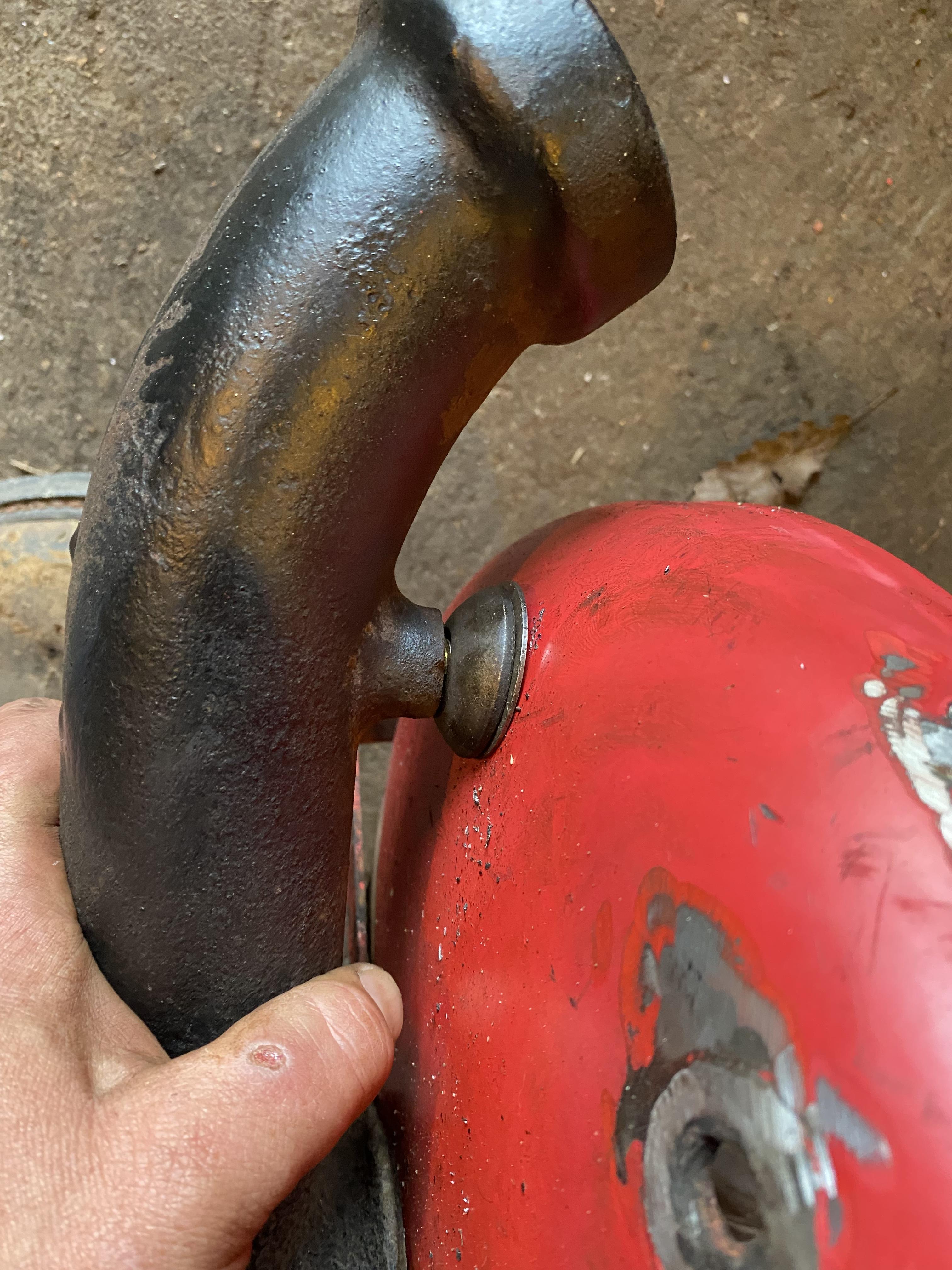

TWISTEDWILLOW Posted February 20, 2022 Author Share Posted February 20, 2022 18 minutes ago, FatBadger said: I'll try to catch up, thanks. Lol, not much to catch up on I’ve only just started on this one! If your interested there’s a thread I did last year building one of these using a blower an tuyere off a Buffalo grill like the one you have, Scott, to bad you live so far away in the land of pines, if you was closer I’d load you up with some junk to build one or two of these! im always on the lookout for these pancake tanks people throw away! here’s a picture of the odd ball spacer I used for the third bolt hole, Quote Link to comment Share on other sites More sharing options...

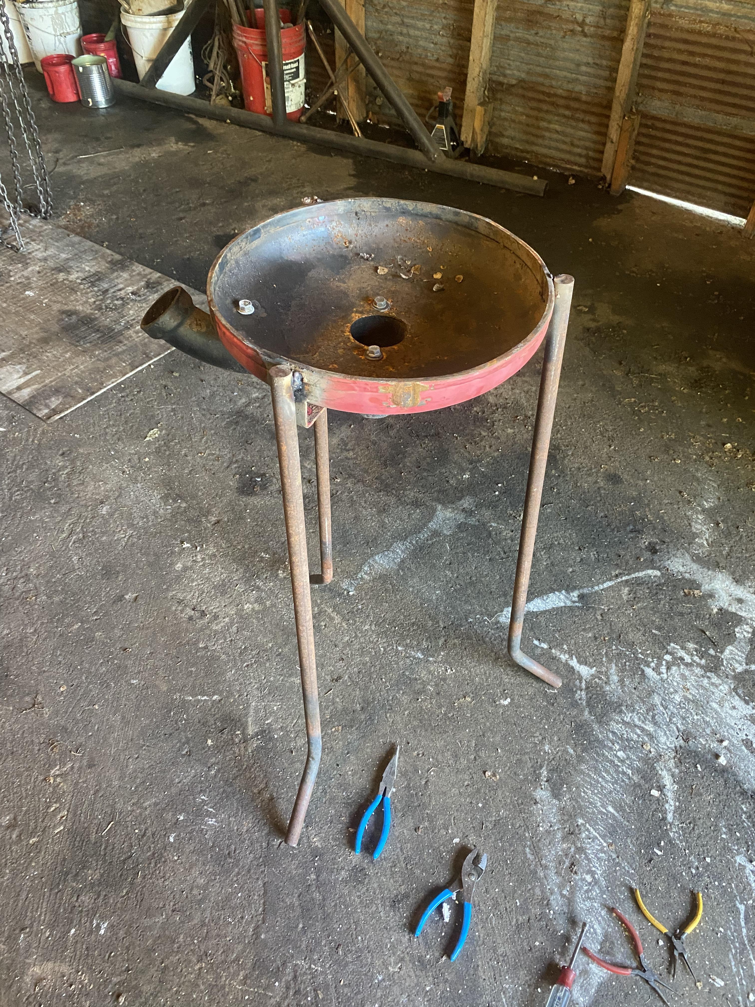

JHCC Posted February 21, 2022 Share Posted February 21, 2022 Nice! The angled bend on the feet is fine for solid legs, but for anyone using pipe, I'd strongly recommend bending a longer curve. That angle would create a weak spot in the pipe, and you don't want it to collapse and send hot coals across the ground. Quote Link to comment Share on other sites More sharing options...
TWISTEDWILLOW Posted February 21, 2022 Author Share Posted February 21, 2022 Thanks JHCC, yes I agree, I’ve looked at the old rivet forges I have an their pipe legs have a a much longer curve! And Almost 8” horizontal to the ground these 7/8” sucker rod legs that I’ve been using are quite heavier then pipe and I was gonna try and mimic the old style legs but I was struggling trying to hold them over the swage I was using an hammer them, I really needed an extra person to hold it for me so I could shape them like that, so I went back to what I’ve done previously and just bent them in a vise, I haven't had any trouble from the previous legs I’ve made that way and it’s nice to have all that weight under the pan so it’s not top heavy, but your right if I was gonna use pipe I’d most definitely make a much longer curve! Quote Link to comment Share on other sites More sharing options...

TWISTEDWILLOW Posted May 8, 2022 Author Share Posted May 8, 2022 Busy season hit so I’ve had a lot of projects on the back burner, I just got the legs tacked on, gonna finish them up today and weld on a bracket for the blower, It’s supposed to be hot this week so I’ll throw the clay mix in there and let it bake all week in the sun Quote Link to comment Share on other sites More sharing options...
Scott NC Posted May 12, 2022 Share Posted May 12, 2022 I'm following you on this. A gentleman at the recycle center saved me back a compressor. I can't help but ask, is it the camera angle or is that one leg bent oddly. I suppose this will require clay so I'll have to drive to the next county? We have sand here and I don't want to use cat litter. Quote Link to comment Share on other sites More sharing options...
