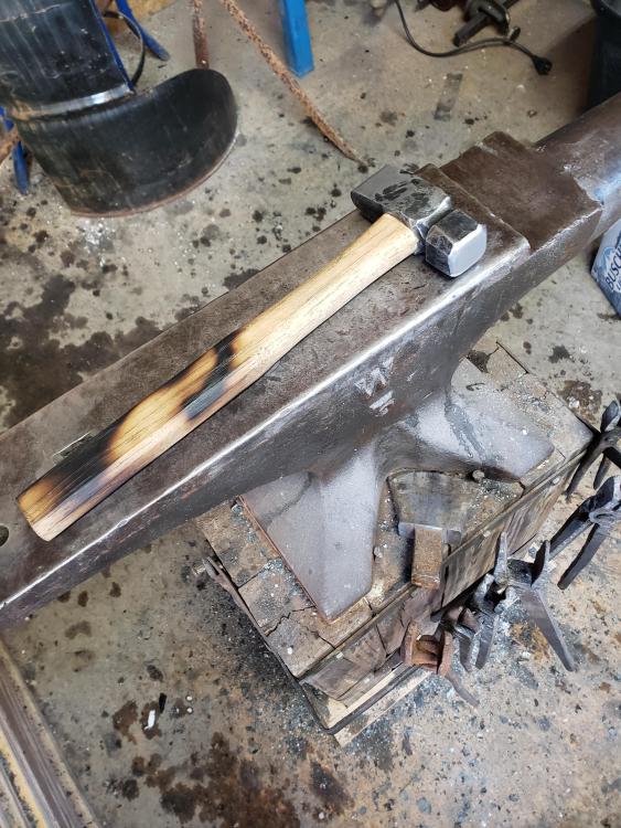

Just finished up this straight peen. Its made from the cap of a rr track. I cut a slab of track about 1.5" thick, then cut the cap from the webbing. The cap was turned into a hammer, and the webbing/foot I upset to about an inch thick and it is becoming a little stake anvil. Spark test definitely showed good carbon content and it quenched fairly well in motor oil. File test still bit, but could definitely tell it hardened up. Probably could have went with water given its mass, but I'd rather have a hammer that is a touch soft, than one that is cracked lol. I tempered to a golden color on the face and peen, heating up the eye first. Given that the file still bit after the quench, I figured not much tempering was really needed. More of a slight stress relief. I'm going to gift it to my friend that gave me the rr track, as the track was given to him by his great uncle who has passed away.

Nice job, it looks like a fine hammer. Just be aware that RR rail is nominally 1085 range steel and can get WAY TOO HARD and brittle for a safe hammer. Be careful with the heat treatment.
I figured the slower quench in oil and the fact that the file still bit a little after quench, means it didn't reach full harness so I'm not too concerned about it being brittle. But very good point.
