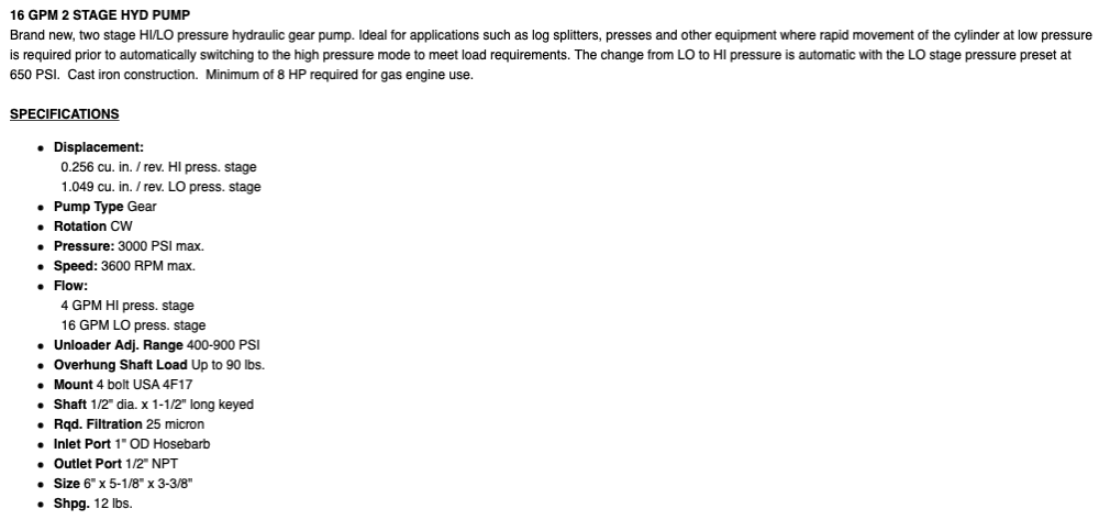

I can tell you that your math works out to over three times the amount of power the pump manufacturer states is needed. (see attached pic).  This pump (and most all 16gpm log splitter pumps I have looked at) require 8hp min of GAS engine which is equivalent to around 5hp of electric power if you use the 3/5 rule of thumb from electric to gas.  In fact to confirm this I can also tell you my friend is running the same pump with 5hp electric with a 40ton cylinder and its a very capable press at 2500 psi.  So if anything, I have more power than I need for this pump.
Unless I am missing something?  Not trying to argue and the information is appreciated.  But I do know that these pumps are used all over in forging presses and do not have anything close to a 25 hp motor.

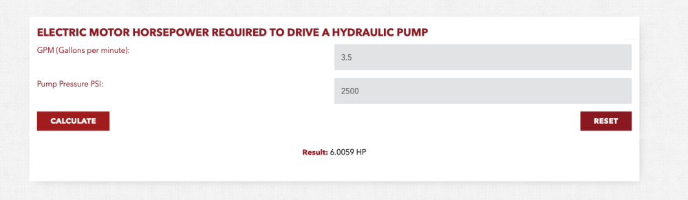

So I figured out your math error (I believe) and why they are rated the way they are.  The two stage pump kicks into high gear at around 700 psi and the gpm at that rate is approx 3.5 gallons.  If you look at the attached screenshot you'll see that 3.6gpm at 2500 requires only 6hp.  So its not my motor and I'm open to suggestions :)
