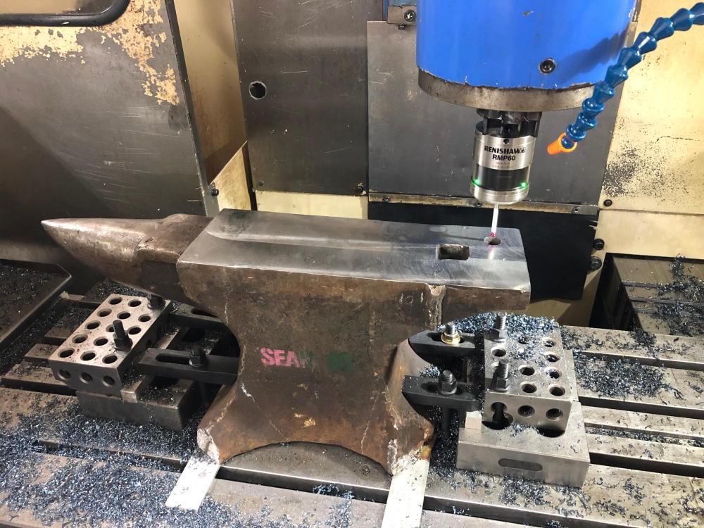

Hey all,
I'm very lucky to have a friend with an industrial mill. My anvil is an old one from a junk yard that had been very badly treated, no makers marks but it's wrought iron with most of the top face ground down. The top face was actually convex which meant that any time I tried to use a punch the piece I was working on would spin around. I'll be refacing it with a 3/4" D2 plate, and if all goes well it should be good for another few hundred years
Brace yourselves, this may be the sexiest thing I've ever seen.
Cheers,
Sean

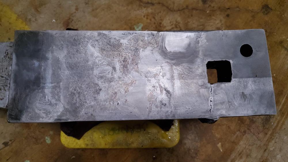

To be clear, the anvil I had milled had lost nearly all of its face and was down to the wrought iron, which is why I didn't go with welding on hard facing initially. Also this project isn't about getting sharp corners, it's about have a working surface on the anvil in the first place.
I'm going to continue with this method of replacing the face as it was explained to me, with the d2 plate welded around the sides with very flat surfaces in contact. I'll post updates as I go, so at least if this is a complete bust I can give a clear description of why it didn't work.

I only see the crack on the near side of the face, and it doesn't look like the vertical bead has penetrated very far. That would certainly be a candidate for cutting a deep V into the crack and welding it back out before doing anything about adding a new face.
Common location for a heel crack, I wonder if it penetrated to the hardy hole and if it did; if that was welded up too.
Before it was milled did it show any trace of being a multi-piece face?  If a plate seam and the heel forge weld line up they tend to be a bit more prone to cracking.  My 1828 William Foster lost it's heel there; but so much of the face is missing that I can't see if it had that alignment.  My Powell lost it's heel there and it does show traces of that alignment---but the rest of face is flat and hard!  I use that one for students who hammer like lightening...

Update, I have the anvil back and I'm very happy with my decision to have the face milled. From what he said, I was right that there was virtually no steel on the anvil face, apart from just before the horn. I cleaned and polished the face, then etched it with ferric chloride to show the structure of the face. The wrought iron in the body has a lot of slag and it's grain structure is huge. I also see a crack near the horn and the extent of the crack in the heel. I've known for a long time this anvil was in bad shape, but I'm happy to learn what I've learned through the process. I'm still working out how I will reface it, but I'll post when I do.

I'm also considering leaving it as is. The average rebound is 50-60% (no real change from before milling), and it's about the same as a mousehole I have that is still a great anvil. For how I use it having the face flat was more important to me than how hard the face is, worst case scenario I save it for detail work instead of heavy forging.
