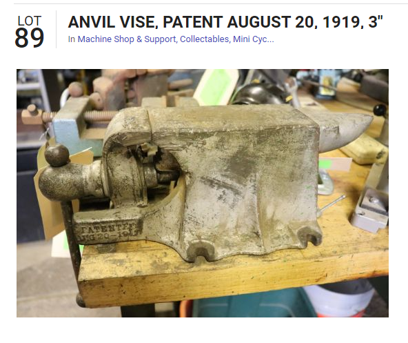

LeeJustice Posted August 10, 2021 Share Posted August 10, 2021 Just by coincidence I came across this just moments ago. I guess it is not a new thing. Quote Link to comment Share on other sites More sharing options...
