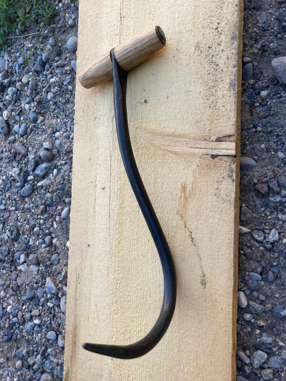

gmbobnick Posted July 4, 2021 Author Share Posted July 4, 2021 Made a hook that I think follows Frosty's description. I used a 15" long piece of 1/2" round mild, 1/4"x1"x10" of flat bar, and 1-1/8"x4" oak dowel. The chisel divot is a good idea. Hadn't heard that one before. I used a tapered square punch instead, driven in just far enough to leave four good notches. The hot peened end of the tenon got a bit wonky. Next time I will probably use a 3/8" rod to hold the handle, peened at both ends, or maybe something with a little more old-style look than hex nuts. So some improvements are in order, but otherwise, I think this meets all my goals. Thanks Frosty and the others who chimed in with ideas. 23 hours ago, Frosty said: You're REALLY over thinking hay hooks.. Well at least this time I asked for input. Link to comment Share on other sites More sharing options...
Frosty Posted July 4, 2021 Share Posted July 4, 2021 By GEORGE I think you've got it! I don't understand the why you bent the hook shaft back like that. It seams to me it puts the balance almost on the tip of the hook. I made them with a straight shaft so when you lifted a bale the balance pulled the hook tight into the bale and the strain was a straight pull on your hand and wrist. Arkie: If you straighten the shaft and tweak the hook a little closed, the above pic is about what I was selling in (middle) jr. high school. Frosty The Lucky. Link to comment Share on other sites More sharing options...
arkie Posted July 5, 2021 Share Posted July 5, 2021 gmbobnick, that's a nice looking hay hook. I might copy that. I wouldn't worry about the bolt and nut being a distraction. Blacksmiths made bolts and nuts; besides it's easier to replace the handle should it get damaged. There are sources on the entrynet for square headed bolts and nuts for a more "authentic" old timey look. Good idea with the square punch to keep the hook in place. Frosty, (and gmbobnick) thanks for using his picture to explain what you were describing on the construction of your hay hook. Link to comment Share on other sites More sharing options...
Frosty Posted July 5, 2021 Share Posted July 5, 2021 I lucked into some long carriage bolts for the handles They were nice and smooth. Yes you want the handle attached with nuts so you can replace the wood handle easily every 20-25 years. Usually they'd get forgotten outside and the wood would weather and get rough. Darn kids never put anything away. A square punch, chisel cut, just something to make the mortise out of round so the hook can't rotate on the handle. They're all good. Frosty The Lucky. Link to comment Share on other sites More sharing options...

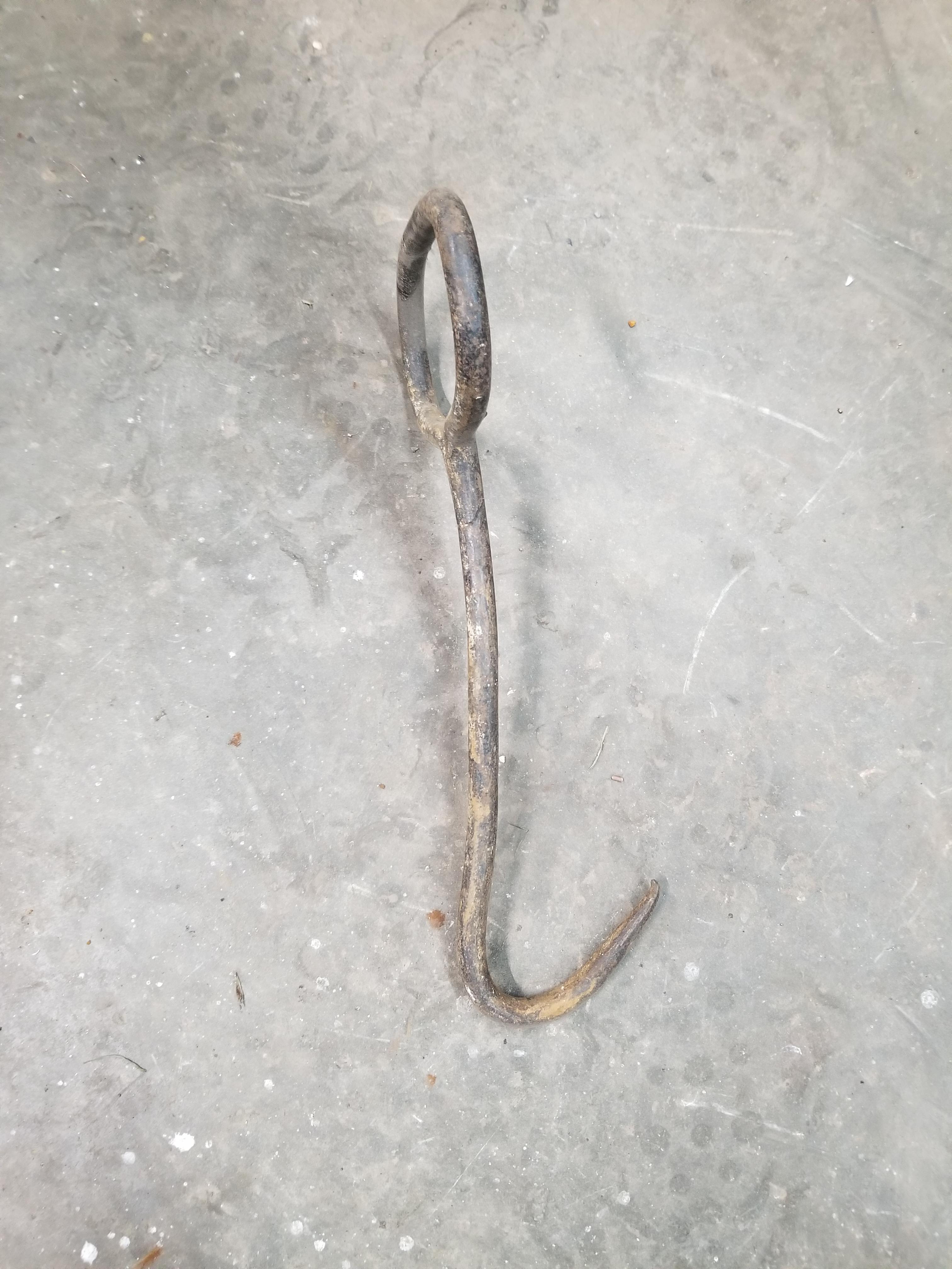

Daswulf Posted July 8, 2021 Share Posted July 8, 2021 I'm debating if the new search function is better or worse lol. Also it was saying busy uploading media when I hadn't yet. Had to edit to add pictures. Anyway, I'm up in my shop and thought about this as I have a few old bale hooks hanging around. Some are like mentioned already. One is forge welded at the shaft after the handle. I have another couple hooks I believe are harness hooks that are forge welded at the actual hook. Just some other ideas and possibilities. Link to comment Share on other sites More sharing options...
