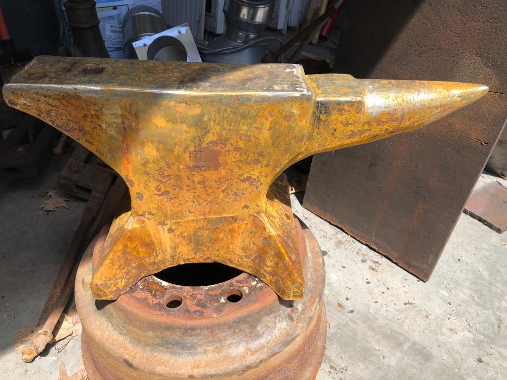

Flynn Posted May 10, 2021 Share Posted May 10, 2021 Ok, here's the situation. I have a 197# Isaac Hill anvil that has been welded and ground on and now the face won't bounce a super-ball, much less a ball bearing. Here's what I'm thinking of doing... I have a tractor, a chain, an oxy-acetylene torch, and a creek. Is there any reason NOT to heat the face up to cherry red and dunk it in the creek? I'm just bouncing ideas around, no need to get anyone too excited. Thanks! -Flynn Link to comment Share on other sites More sharing options...
Frosty Posted May 10, 2021 Share Posted May 10, 2021 There sure are: What alloy and carbon content is the weld deposition? Cherry red is WAY too cool even if the steel in the face can be hardened. Know how much oxy acet it'll take to bring 197 lbs of steel to critical temp? You MIGHT be able to isolate the face and not have to heat the entire anvil to critical but the temp differential won't be a lot. The technique you propose will work but it's not a trivial job. You can't "just dunk" the anvil and expect good results. There MUST be a strong enough flow of water across it to break the steam barrier that forms on the surface. It MUST remain in the quench until the entire face below tempering temperature. IF you're going to use the residual heat in the anvil's body to temper the face. If so you'll need to keep the anvil hanging over the creek while you sand the face clean enough to see the color run and return it to the creek when it's right. It'll need to stay in the creek until you're SURE there isn't enough residual heat in the anvil's heart to run the temper farther when you remove it. Do you know what the correct temperature is for the alloy you're dealing with? The temper color (temperature)? It can be done, has been for centuries but by people who knew their materials and resource. Some of the major anvil makers used a flume and timed the quench according to the weight of the anvil and again when the temper had run properly. A creek can be made to work like a flume but we don't know how much flow it'll take to quench whatever the alloy is at a proper rate. Too fast and it'll be brittle, too slow and you could end up starting over. The thing that makes a flume a better tool than a creek is it can be directed on the face so the body doesn't "quench" it cools below the quench rate. This leaves enough residual heat to make running the temper quick enough you don't fall asleep waiting. I know about some of these things but have never done them and I'm too old to experiment on a bunch of other guy's anvils and figure it out. I've come up with a method I believe has an excellent chance of working without having to build a water tower or flume. Regardless we're talking having a little beach party while the fire brings a couple hundred lbs of steel and iron to critical. Then break it out of the fire position the flume and fire up the pump. The good thing is we'd be able to shut the pump off and check the temperature quickly and restart it. Once I liked the temper color shove it into the lake and start the pump flowing on it again. Once tempered you need to get the anvil's core chilled below temper heat or lose hardness in the face. We're talking probably 4+ guys keeping a fire watch over night and a gang effort with the quench and temper. Like I say it would NOT be a trivial job. Sending one out to a heat treater will cost close to buying a new anvil. Frosty The Lucky. Link to comment Share on other sites More sharing options...

Flynn Posted May 11, 2021 Author Share Posted May 11, 2021 The pics won’t be real helpful... the previous owner ground it all over to ‘clean it up’, and the edges show some weld marks. The welds appear to be done by a decent welder, but there’s no rebound to the face. So right now I have an extremely effective doorstop. I have no idea what steel the face is, nor do I know what steel the welder used. I honestly don’t need this anvil, and I told the previous owner about the issues before I bought it for under a dollar/pound. Worst case, I can put it out as a yard decoration. Just thought it might be worth trying to harden it rather than let it go to waste. Link to comment Share on other sites More sharing options...
ThomasPowers Posted May 11, 2021 Share Posted May 11, 2021 The only person I know that did a full heat treat on a repaired anvil used the high pressure hose from the local Volunteer Fire Department for the quenching to be able to blast through the Leidenfrost effect. Described it in "Country Blacksmithing" Charles McRaven. IF the "decent welder" didn't do a proper preheat and use the correct alloy rod for it then they were NOT a decent welder! Just one that was trying to do stuff beyond their knowledge base! Even expert welders can really mess up an anvil just because they don't know the details on how anvils are made and heat treated. Link to comment Share on other sites More sharing options...

Flynn Posted May 11, 2021 Author Share Posted May 11, 2021 Thanks for all the info, everyone. FYI, the rebound is about 35% with my really good ball bearing. Here are some photos, it's not pretty. Link to comment Share on other sites More sharing options...
ThomasPowers Posted May 11, 2021 Share Posted May 11, 2021 That low seems to indicate a complete lack of hardening; perhaps it was in a fire? Link to comment Share on other sites More sharing options...

BIGGUNDOCTOR Posted May 11, 2021 Share Posted May 11, 2021 Here are my thoughts. See if there is anyone in the area with an induction furnace. A pancake type coil could heat just the top, and quickly enough that the body should quench it fast enough. Or just hardface the top. Link to comment Share on other sites More sharing options...
anvil Posted May 11, 2021 Share Posted May 11, 2021 Interesting. It doesn't look that bad to me. It looks like only the edge was arc welded. If it went thru a fire, check the hardness with a file. If it's hard, then low bounce indicates a bad weld between the hc face and the wrought body. A sound(ring) check would help with that too. Also, check for bounce and ring at various places to see if it's the whole face or localized. If it's a good weld, then the Gunther method would solve the hardness problem altho doing it "by hammer in hand" would be fun to try. Remember, a bounce test checks two things. Hardness and a good weld between steel and wrought. If you can't ding the face with a normal hammer blow. I wouldn't worry about it. I'd just use it and call the low rebound be due to hehe ,, old age. Thomas, I have two projects on my bucket list. One is to be involved in a smelt, preferably here at my new place. The other is to be involved with forge welding a new faceplate onto an old wrought anvil. If you were to organize either, I'd be tickled silly to be a part of either at your place or wherever. Link to comment Share on other sites More sharing options...
