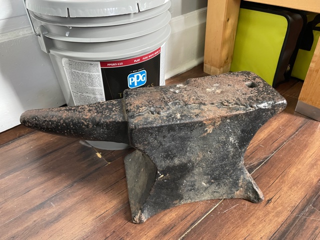

Looking for Identification of this Anvil
I recently came into possession of this ole anvil, and was looking for some other opinions on manufacturer, age, etc. It's in pretty rough shape, and I could not decipher any markings on it. Weighed in at 116 lbs. Based on this thread, it looks like it might be a colonial Alsop.  I'm only starting to get into this field so I don't have the knowledge base to know for sure. Any input would be great!
I think Anvil Fire has it right. Definitely prior to 1830 because of the lack of a pritchel  hole. If you are thinking of restoring the hardened face, I suggest reading this. If you clean the sides with a wire wheel, some remnants of the name may appear. Early Mouse Hole anvils look a lot like that one and there were many other forges in England making copies of the Mouse Hole, some with no name on them.
