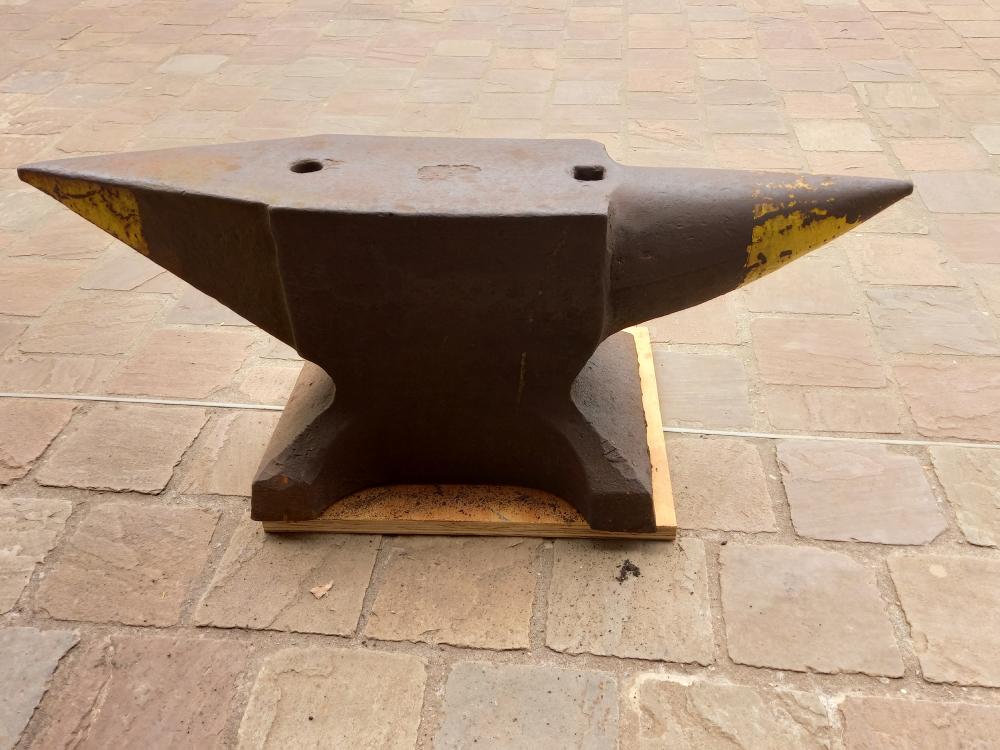

Sandersr Posted April 25, 2021 Share Posted April 25, 2021 hello, i have an anvil in my possession. I would have liked to have known its origin, age and value. length: 78 cm width: 17 cm height: 29 cm Attached photos many thanks in advance. Sander. Quote Link to comment Share on other sites More sharing options...
Irondragon Forge ClayWorks Posted April 25, 2021 Share Posted April 25, 2021 Welcome aboard... As far as I know D L C anvils are/were made in Germany and are good anvils. As far as value that will depend upon how much it weighs and where in the world it is located. Most anvils are sold by the pound. If you do a google search like this d l c anvil site:www.iforgeiron.com there are a few threads about/mention of them. Quote Link to comment Share on other sites More sharing options...
