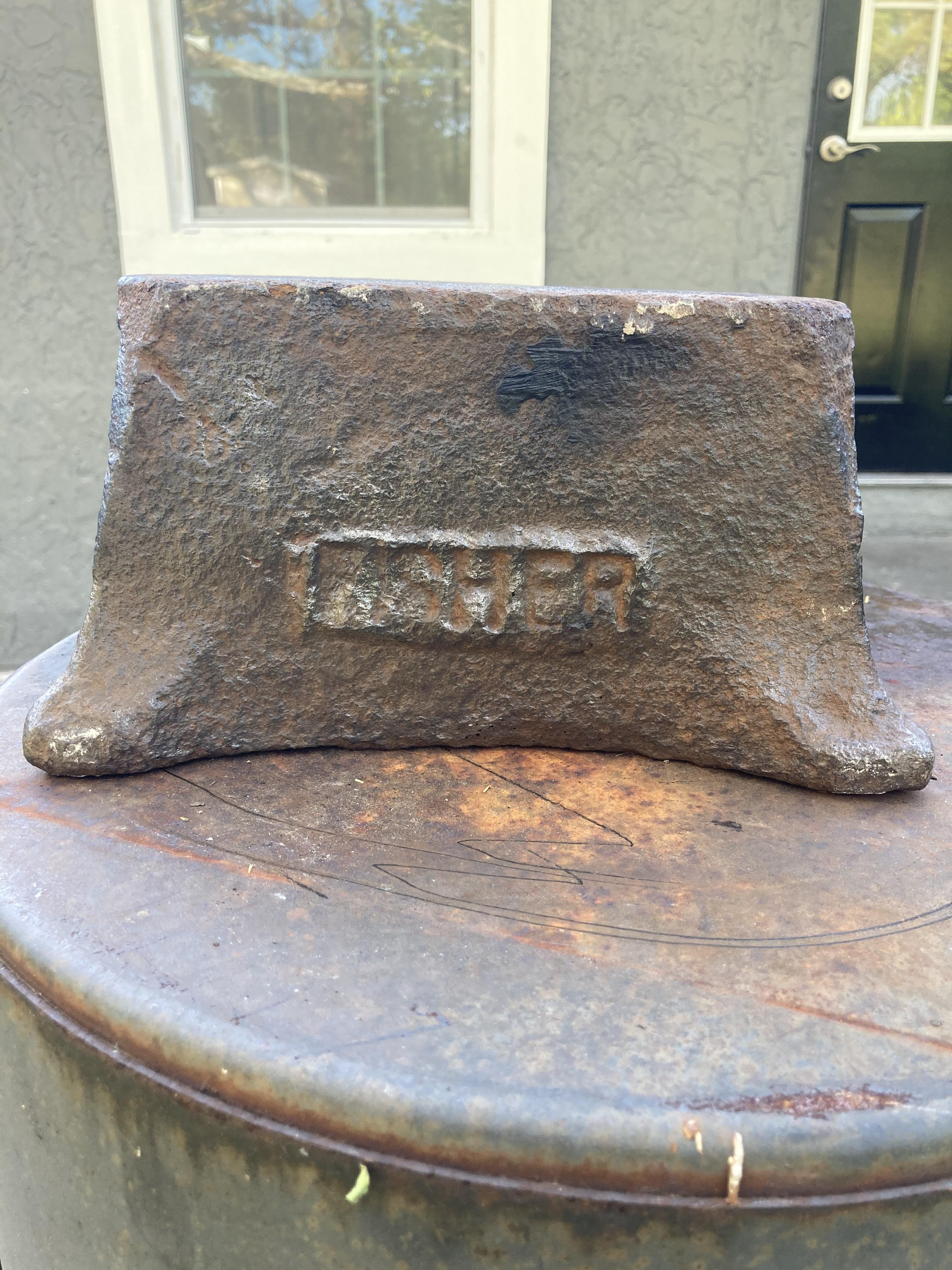

Bo Diddley here,  I demo houses in Jacksonville Florida I found a small anvil the name FISHER is on one side the other side looks like passion.
There's a number 8 on the end about half way on the side and number 6 at the bottom. there is no horn it's small in size. The weight is 65 pounds.
Just trying to find some information on it.  Thanks in advance Bo Diddley.

Can we see some photos? One from all 6 sides please. Not super close, get the whole anvil in the shop if you can. Lighting it from the side will make details easier to see.

All I can say is that it's a Sawyer or Saw makers anvil. It was used for truing up saw blades and not for forging work. That doesn't mean it couldn't be used for that now, but it's my understanding that that wasn't it's original purpose.

Fisher sawmaker's anvils were never intended to be hit with a hammer, or be used with hot metal.  Their use was under a circular saw blade, used when the saw master was tuning the blade, done cold.  Their faces were hardened when made, but never had to be as hard as a regular anvil.  However, in time, the face did work harden.  I have some saw anvils that have faces that are around Rockwell 58.

Fisher saw anvils were designed to be use with a cold circular saw blade.  The technician would tune the blade according to many factors: hp driving the saw, left or right, # teeth, and type of wood usually sawing.  The blade was always between the anvil and the hammer.  You can use hot metal on the anvil.  It will not affect it.  Just remember that the face of the anvil is usually very hard, somewhere around Rockwell 60, and can be prone the chipping or cracking.  Be sure to aim you blows carefully.
What you read as "Passion" is actually "Disston". The Disston Saw works was founded in Philadelphia in the 19th century, not far from where the Fisher anvils were made in Trenton, NJ. My guess (and Josh can confirm or deny) is that this anvil was a custom order for Disston.

The anvil is a small saw maker's anvil, made for Disston by Fisher & Norris Anvil Works in Trenton, NJ.  The face looks to have gotten extremely corroded at some point, but looks to still be flat.  This anvil was intended to be use to tune Sawmill blades.  The faces were extremely hard, and flat.  They were never hit with a hammer, there was always a blade in-between.

Bo, not all anvils have a horn. It depends on what they are used for. As mentioned above, these were used to tune circular saw blades so they ran straight and true. This was done on a COLD blade, not one heated in a forge. No need for a horn when all you work on is flat saw blades.  Look up sawyer's anvil for more info.
