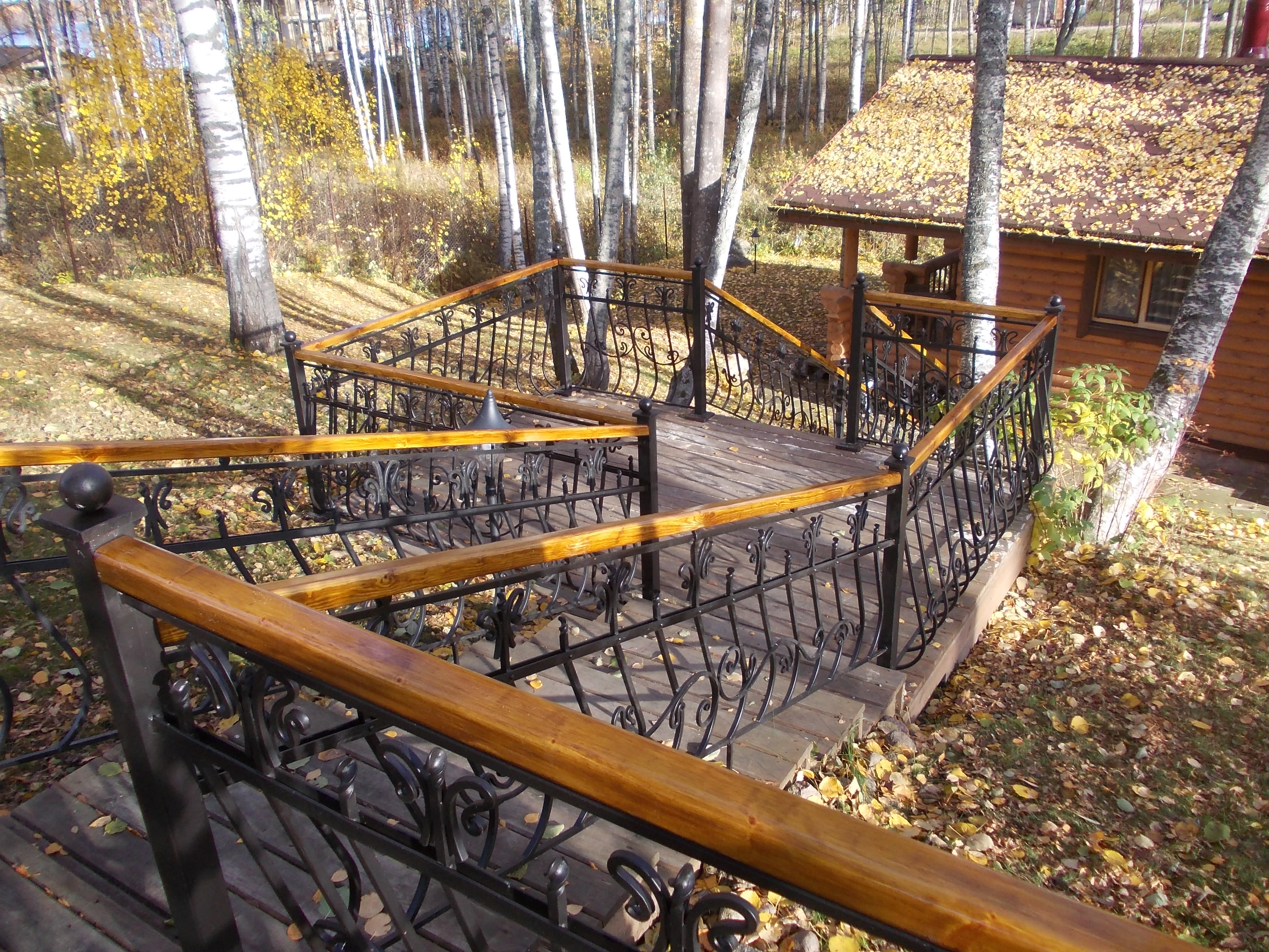

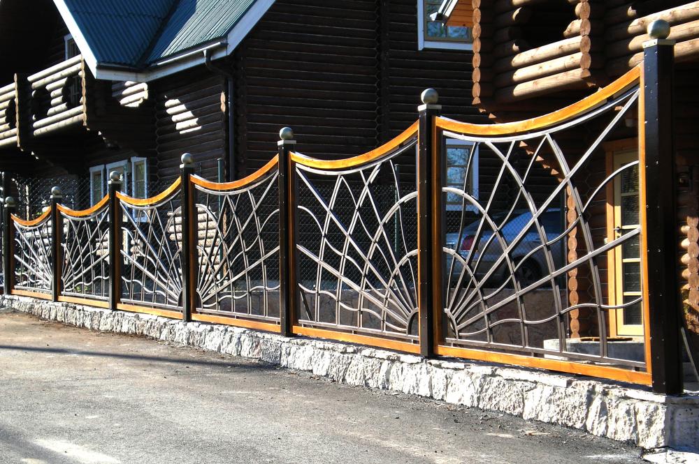

20-25 years ago I preferred large orders. Fences, gates, balconies, stairs. I work alone, so now I try to do small projects. Chandeliers, furniture, flower supports. The salary is much higher and less effort is required.

Thats some nice work! How did you finish all those railing? Blast and powder coat? And when you say you find the salary higher with less effort, are you referring to doing furniture/flower supports compared to fences and gates. Or were you referring to architectural smithing as a whole compared to the little nick knack stuff.
By paint. Primer, paint, 2 layers , patina and varnish (indoor) on top.
By benefit. This is just my opinion. Our cost calculation is usually like this. Material cost multiplied by 10. For small jobs, it can be multiplied by 15-20.
An important point, I work alone and I will soon be 60. I no longer want to lift weights. :D
