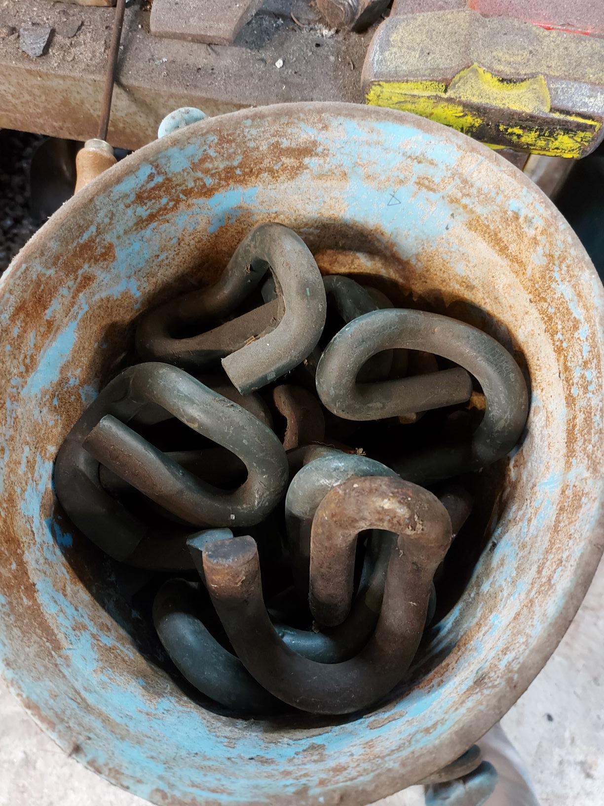

Tom May Posted February 21, 2021 Share Posted February 21, 2021 I have several of these railroad fastener clips. (the ones that are kind of twisted like a pretzel). They seem to be the right diameter to loosely fit my pritchel hole, and they already have a sort of "spadey-looking" wide end where the clip meets the rail. Are these things springy enough to make a good holdfast? Quote Link to comment Share on other sites More sharing options...
Frosty Posted February 21, 2021 Share Posted February 21, 2021 Yes, they're a medium carbon steel and make nice springy hold fasts as well as other tools where tough is more important than hard. I have a few of the rectangular rail clips I keep on hand to make things like drifts. They're darned good stock. Be aware you CAN make them brittle normalizing after doing much forging is a really good idea. Frosty The Lucky. Quote Link to comment Share on other sites More sharing options...

BartW Posted February 24, 2021 Share Posted February 24, 2021 Hello; For this part of the world; pandrol E-clips are available in 2 crossections; 18 and 16 mm round (E2039 and E2055 in the pic below). There are also Butterfly clips, which have 2 sprins sides, but are generally thinner. I got buckets of 'm; good trading stock Now I can't get them new; but when they work on track; they remove these clips and trow them away ! ... They apparantly only install new ones. The one I have are colourcoded; the greens are 16mm, the 18 are red. The steel in them is usually a variant of 9260; which is a great steel for tooling; mediocre for knives. Tough stuff. Doesn't want to move under the hammer. Don't forge it too high, it suffers from grain growth like O-1. Normalising is also a good idea. Testing for cracks is also a great idea after forging. Not that great for tongs. For a holdfast it would be great steel; just make sure to NOT quench the tip in water even if it gets red-hot. Quote Link to comment Share on other sites More sharing options...

BartW Posted March 1, 2021 Share Posted March 1, 2021 just measured, these guys are 20mm round, the other bucket I got is 18mm round. the butterfly clips are 16 mm. These green ones I had analysed, and the composition was really really similar to 9260 steel. Quote Link to comment Share on other sites More sharing options...
