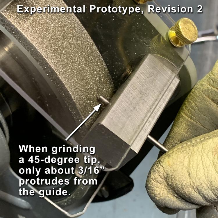

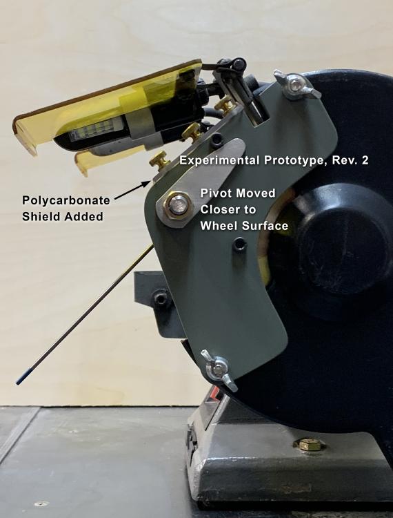

Updated material to "Experimental Jig for Sharpening Tungsten Electrodes
Revision 2. In this revision I moved the electrode guide pivot closer to the wheel and also drilled the guide holes closer to the wheel. These changes place the electrode closer to the wheel surface and reduce the distance that the electrode extends past the electrode guide (as shown below). One person contacted me with a similar suggestion. I think these changes could make grinding results more consistent. I do not know what effect these changes might have on the possibility of kickback or breakage. I haven't experienced any problems yet, but I haven't ground very many electrodes with the different versions of this device, and there is always a chance of electrode breakage or kickback. I would have to do a lot more testing before I would feel confident about the device's safety and effectiveness.
I also installed a clear polycarbonate shield over the electrode grinding area (as shown below). I thought this might offer some additional protection in the event of damage occurring to the electrode. I attached the shield with thumbscrews for easy removal for cleaning or replacement. Even when using the bench grinder's original polycarbonate shield along with the new shield that I installed, I still wear eye protection when grinding electrodes (or anything else for that matter), as well as keeping myself clear of the end of the electrode when feeding it into the grinder.
As stated before, this is an experimental prototype and a work in progress, so I do NOT recommend copying this design. More changes will probably be upcoming, if or when time permits me to do further experimenting and testing. Feel free to PM me or leave a comment.
Disclaimer: The device described here is an experimental, prototype device. I do not warrant the safety, efficacy, or applicability of the device described here. Any use of this design or device is entirely at your own risk. Use all appropriate personal protective gear when using this or other tools.
This post is not intended to be instructions for grinding tungsten electrodes. It is only a description of an experimental prototype device in its early development stages.
Thanks for reading, and please check back for further updates. Please PM me if you have any questions or comments you'd like to discuss offline.
Al (Steamboat)
I was thought that it was safer to place the electrode on the top of the grinder, and not the bottom. Since it could get launched into your finger/leg this way (and one of my classmates found that out the hard/panful way.)
Deimos, thanks for your feedback. I assume that you are talking about how an electrode is oriented relative to the rotation direction of the grinding wheel during the grinding process.
Most welders that I've observed grind tungsten electrodes pointing against the rotation of a bench grinder wheel, and most of the instructional material (that I've seen) also shows it done that way (see example links below). I think that visibility might be one factor in the choice of direction, and there could be some other factors involved.
However, I personally do not like to grind electrodes manually (i.e., hand-held, without an electrode guide of any kind). For one thing, when grinding against the direction of wheel rotation, I've observed that the danger of electrode breakage and kickback increases as you increase the electrode point angle, since it changes the geometry between the wheel and the electrode. When manually grinding against the wheel rotation, I have only felt reasonably safe when grinding long, sharp low-angle points, like maybe 20 degrees, with the electrode almost tangential to the wheel. I wanted to see if I could come up with a single electrode guide device that would allow me to produce consistent results at any given point angle, while only having to make one adjustment, and with good visibility for good control. Hence my experimenting with this prototype. I haven't fully met that goal yet, but I think that I at least have a good starting point. There are a number of existing electrode grinding devices on the market at a wide range of prices, but I wanted to see if I could build a decent one on a shoestring budget...and I like to build stuff, so the time invested in not an issue.
My current experimental idea is that by employing an electrode guide and reducing the distance between the electrode guide and the grinding wheel surface (i.e., allowing very little of the electrode to protrude from the electrode guide), the electrode might be better supported, and with the shorter electrode extension, it seemed to me that the wheel would have less leverage to try deflect the electrode, thus reducing the chance of breakage and/or kickback, even though it would not completely eliminate the possibility of breakage or kickback. Does that sound correct? In the photos below, you can see that only about 5/8” (16mm) of the electrode extends from the guide when grinding a 20-degree point, and only about 3/16” (about 4.8mm) of the electrode extends from the guide when grinding a 45-degree point. Also, my prototype idea uses a diamond wheel, which should maintain a relatively smooth surface with normal use, and it cuts fast, so only very light pressure is required to grind the electrode tips, which I "think" should equate to less heat and stress to the electrodes. Again, that’s just my idea, and I’m only an amateur who likes to build things and get feedback from people who know more than I do. I'm not a professional in any related area, and I will not guarantee the safety of this device in any way.
sharpener-revision-2-grinding-20-degree-tip.thumb.jpg.96b5c778b770964637252511ccba898d.jpg
sharpener-revision-2-grinding-45-degree-tip.thumb.jpg.5f31a6445c1bf8b2d510bf2352bdf6c7.jpg
To try to further reduce the chance of breakage or kickback, I do the following:
  • I check the surface of the wheel for damage, making sure it's still smooth.
  • I give the wheel a spin and make sure it’s running true.
  • I adjust the electrode guide to the desired angle and tighten it securely before turning the grinder on.
  • I feed the electrode in slowly and gently, applying only very light pressure while rotating the electrode.
Important: I wear personal eye and face protection in addition to viewing the grinding through the polycarbonate shield on the grinder and the shield on my prototype attachment. I also wear gloves, my leather blacksmithing apron, and a dust mask, and avoid having any part of my hands or body directly behind the end of the electrode in case of kickback. I think I previously mentioned that I don't grind thoriated electrodes.
Kickback is always a possibility, whether you are grinding an electrode on a wheel or shaping a knife blade on a belt grinder. However, so far, I’ve ground points to varying angles on several dozen electrodes using the latest revision of the prototype device, without yet experiencing any kickback or breakage, but that’s still a very small test sample size, so I will not guarantee that kickback or breakage can't happen.
Deimos, you also might want to re-read my mention in an earlier post in this thread regarding why I added stops to the electrode guide to prevent electrodes from being ground pointing downward through the guide in the direction of wheel rotation.
I'll probably be making many more changes to this prototype in the future, as time and opportunities for experimentation/testing allows. As I already mentioned, this experimental prototype is a work in progress, and I do NOT recommend that anyone copies and uses this device at this time.
Disclaimer: The device described here is an experimental, prototype device. I do not warrant the safety, efficacy, or applicability of the device described here. Any use of this design or device is entirely at your own risk. Use all appropriate personal protective gear when using this or other tools. This post is not intended to serve as instructions for grinding tungsten electrodes. It is only a description of an experimental prototype device in its early development stages.
Thanks for your feedback.
Al (Steamboat)
