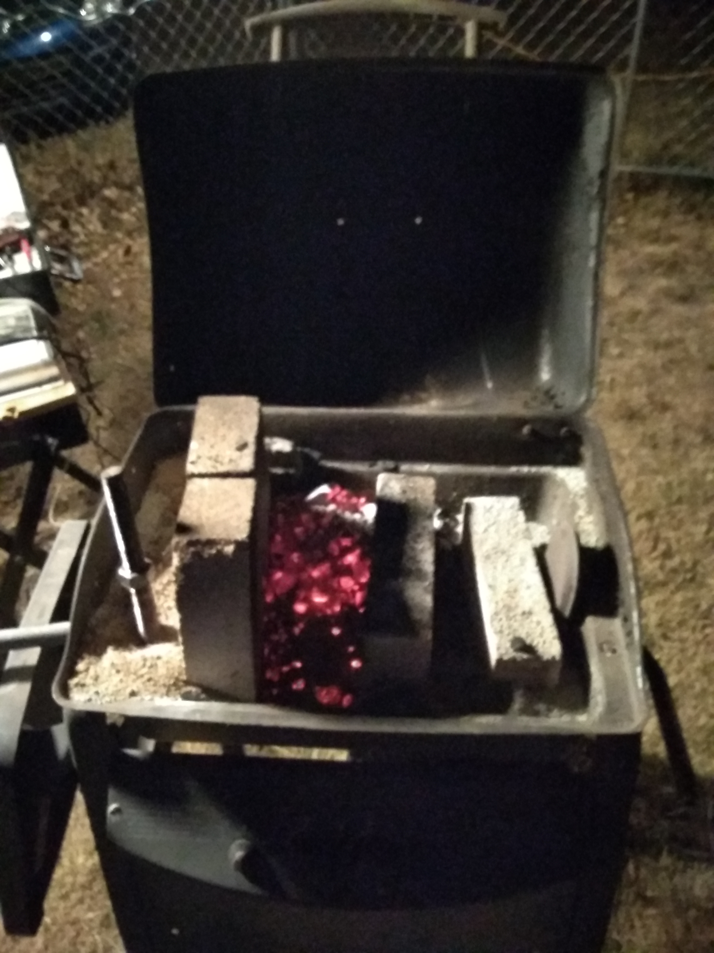

Paul TIKI Posted November 16, 2020 Author Share Posted November 16, 2020 Ya'll should probably give me 50 lashes with a wet noodle as I forgot pics, but.... My son and I got the grill forged built up and fired up. The body is one small propane grill with the guts torn out. Soft firebrick used as the bulk of the fire pot then packed around with sand and unscented cat litter.. Side blast with about a 3/4 inch steel pipe (ganvanization removed) for a tuyere. Air supply is a nice Buffalo Forge hand crank blower. Had a lot of issues with getting the temps up to where I wanted them. This time I used actual lump charcoal for fuel. Very few fire fleas (yay), but it just did not seem to want to get hot. I noticed a good improvement when we shifted a brick on the side of the fire pot opposite when the tuyere closer and built up the pile of charcoal higher, but it was still tricky. We also noticed that we didn't quite align the hole for the tuyere pipe quite right and it was angled slightly up. This was allowing debris and ash to block the pipe and we would be doing fine, move something, and then much less heat. So my guess is tuyere placement, and maybe too small a pipe with a lot of air leakage maybe? I don't think we got anything near hot enough for more than just simple deforming metal. So some tinkering before the next fire, and I promise I'll get some pics. Link to comment Share on other sites More sharing options...
Paul TIKI Posted November 18, 2020 Author Share Posted November 18, 2020 here is a pic of grill forge. had to make a few adjustments, but it's working better. Link to comment Share on other sites More sharing options...
wirerabbit Posted November 18, 2020 Share Posted November 18, 2020 Paul, take some measurements of the H,W, and D of firepot along with the vertical and horizontal location of your tuyere too. I'm having great success with my set up and we can at least compare. My tuyere is 1" pipe. I'd try that as your first mod. See if that doesn't get some more air into the pot. I have noticed that when I have had trouble getting things hot, I had an obstruction in the tuyere. Softbrick (IFB) will slag and melt into blockages. My 2800s are melting down around the tuyere. Also, lump charcoal from the store does have foreign matter mixed among the charcoal which will melt into blockages. I have pulled out pieces of limestone, melted brick, plastic and a chunk of what I think is a mica-type stone. Link to comment Share on other sites More sharing options...
Paul TIKI Posted November 18, 2020 Author Share Posted November 18, 2020 4h by 4w by 8 long for the firepot. The pipe is down angled at about 15 degrees and is 3/4 inch pipe (I think), which may be part of the problem. I know charcoal doesn't need a ton of air and I had too much in my other build. Another potential problem is the way the blower is hooked up. from the Tuyer back it goes from 3/4 inch pipe to a funnel to a standard flexible dryer duct and then to the blower. It just kind of sits there so there is a lot of room for air to escape and not go through to the fire. I'm thinking a liberal application of duct tape will fix that. I need to be careful because I'm trying to think in terms of modularity. The duct was originally acquired for use with my son's hand crank Buffalo blower and what I come up with needs to be able to come apart so I can switch between air sources. Time to get creative with that. I may have had better luck if I just stuck to the hand crank, but I'm out of shape and didn't want to work quite that hard. I inspected the Tuyere after everything cooled down and there was no blockage except a bit of ash which blew out with a puff of air down the duct. Didn't look like there was any debris in the bottom of the fire pot. Yesterday, I did not use briquttes, just regular lump charcoal broken down to about walnut sized chunks. I used about 3 lbs worth over the course of 3 hours farting around yesterday. I'd go test some stuff today, but there is a wind advisory. Playing with fire not recommended outside. Link to comment Share on other sites More sharing options...

Buzzkill Posted November 24, 2020 Share Posted November 24, 2020 On 11/18/2020 at 3:45 PM, wirerabbit said: Softbrick (IFB) will slag and melt into blockages. My 2800s are melting down around the tuyere. Just curious why you would use relatively expensive IFB for this type of forge. Were you trying to protect the tuyere from heat? Standard fire brick is much cheaper and in general is probably better suited to this application. Link to comment Share on other sites More sharing options...
