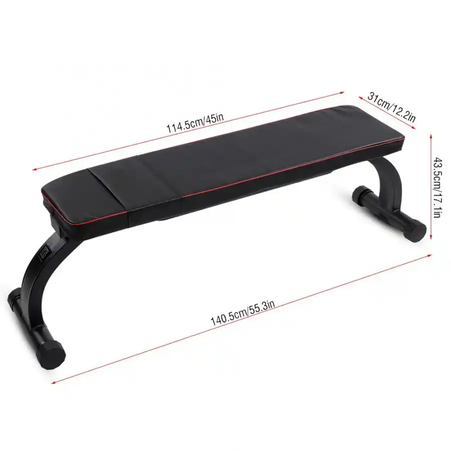

hello, if it were possible, I would need some advice some suggestions to make a gym bench, it should be light robust aesthetically pleasing to handle compact not bulky to store in a corner when not needed.
measures:
12 inches wide 30 cm
long: 48 inches - 120cm
high from the ground: 17 inches - 43 centimeters
what material do i use? how do i make it? thank you
gym weights barbells dumbbells, the person who will use it is 180 cm tall weighs 90 kg I think he will have to lift 40 kg of barbell. a simple structure to make but sturdy, thanks
i think iron frame wooden floor. I think it is the best solution, which can support a maximum load and a capacity of 200kg. thank you. what better structure conformation, with 4 upright feet type chair or type H upside down? what material do you suggest box-shaped metal pipes or L or T type profiles? what section to support the load, crossbars of reinforcements diagonal braces? thank you sorry if I'm petulant.
