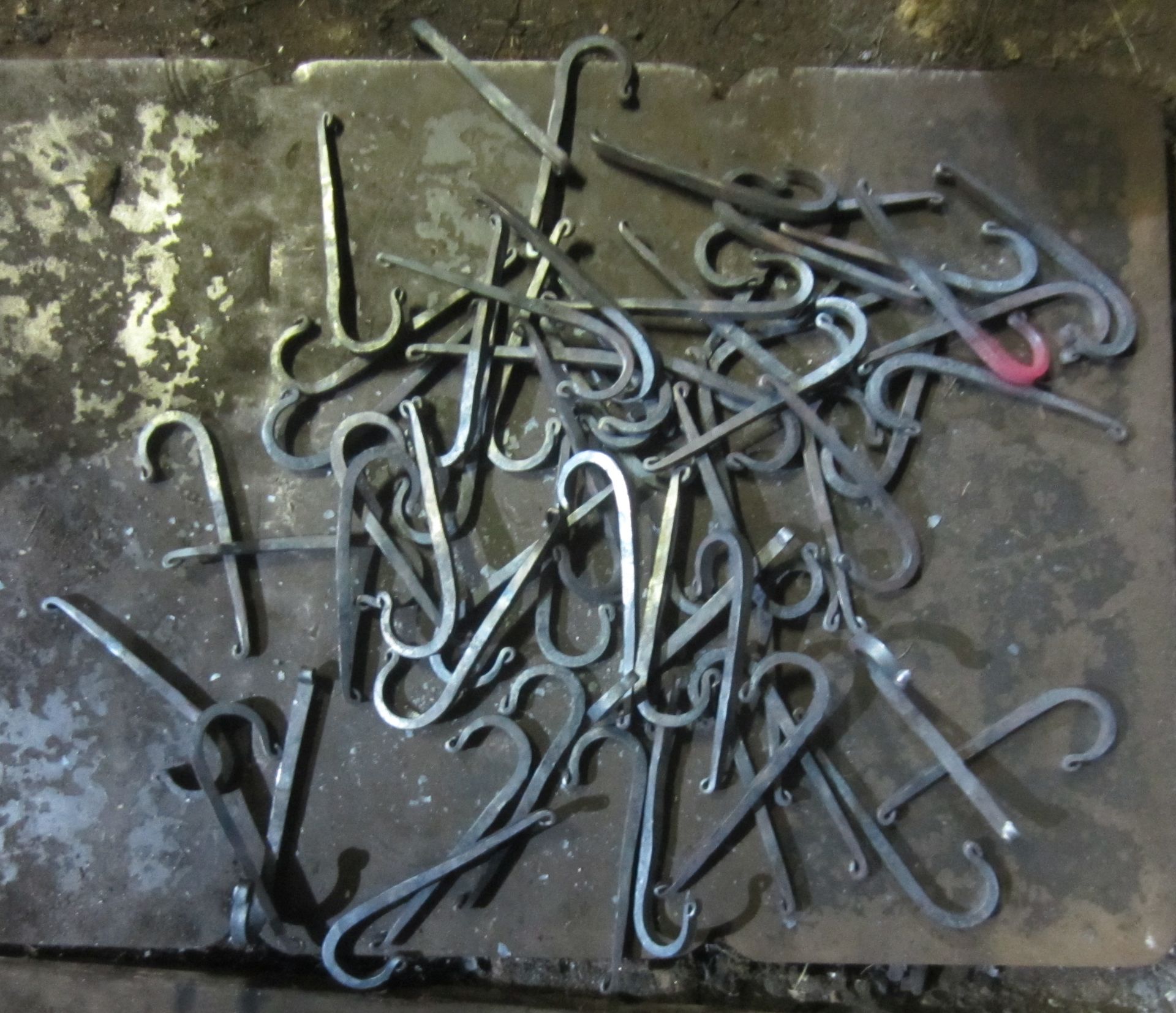

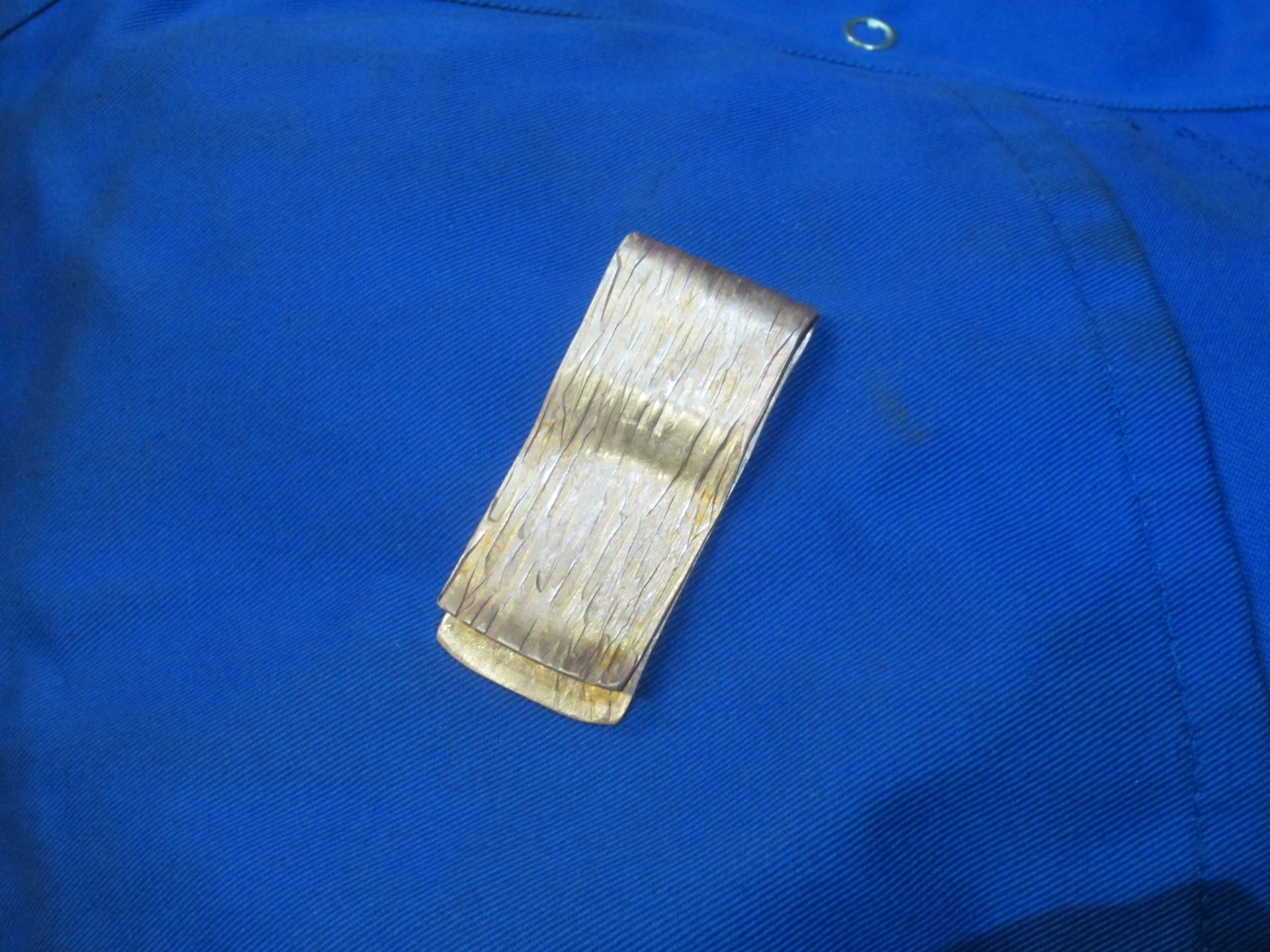

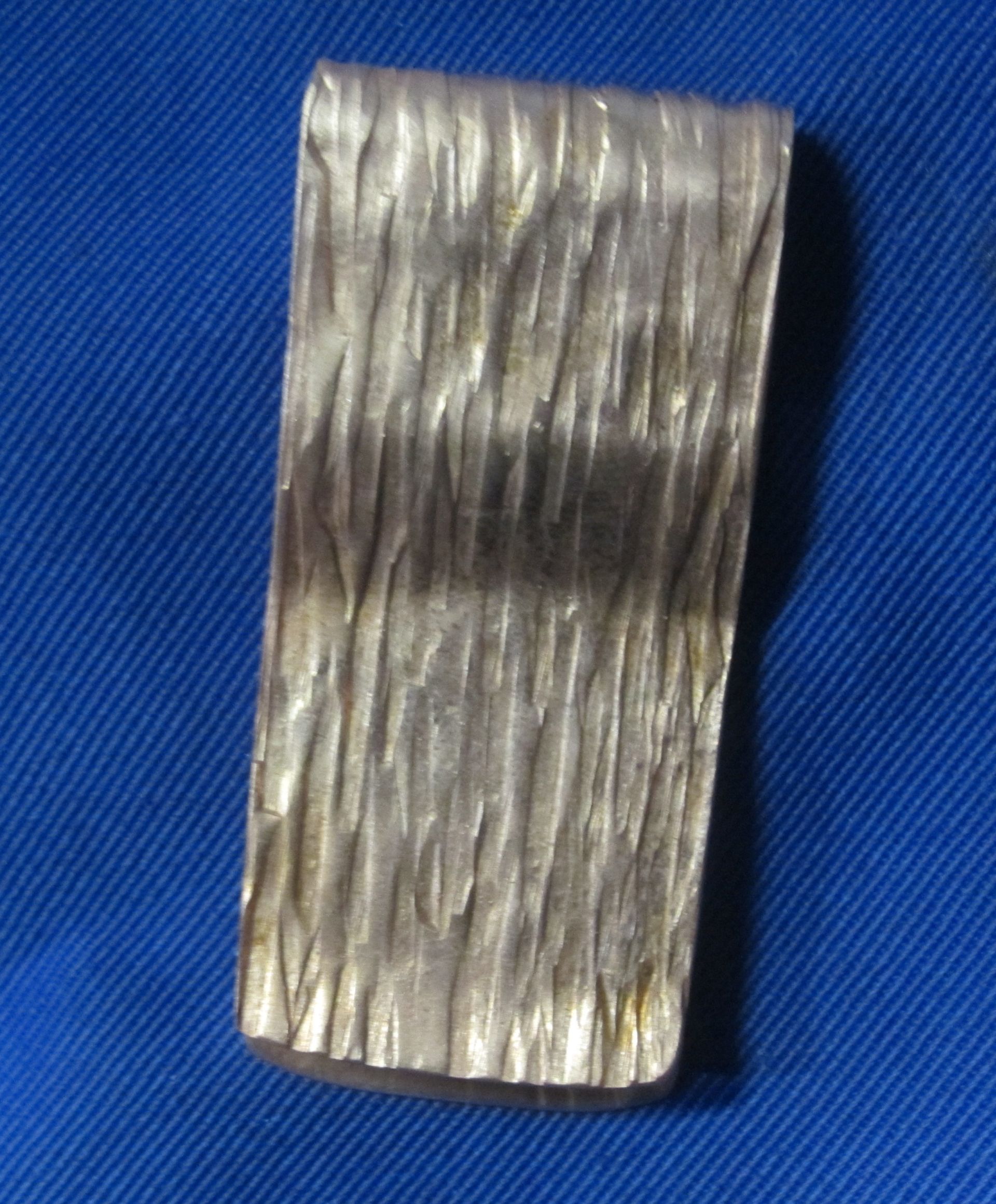

Gergely Posted October 18, 2017 Share Posted October 18, 2017 Hi, Did some welding on a tractor rim. Went to the GP for redressing my thigh. Pounded out 60 pieces of half done S-hooks for tomorrow's interactive demo. Tried a money clip prototype, made of copper. A costumer suggested it, I want to make them of copper, SS and old woodsaw blades - let's see which is the best. (For sure copper was very comfortable to work with. No heat needed, shaped nicely, got enough workhardening to hold well.) Bests: Gergely Quote Link to comment Share on other sites More sharing options...

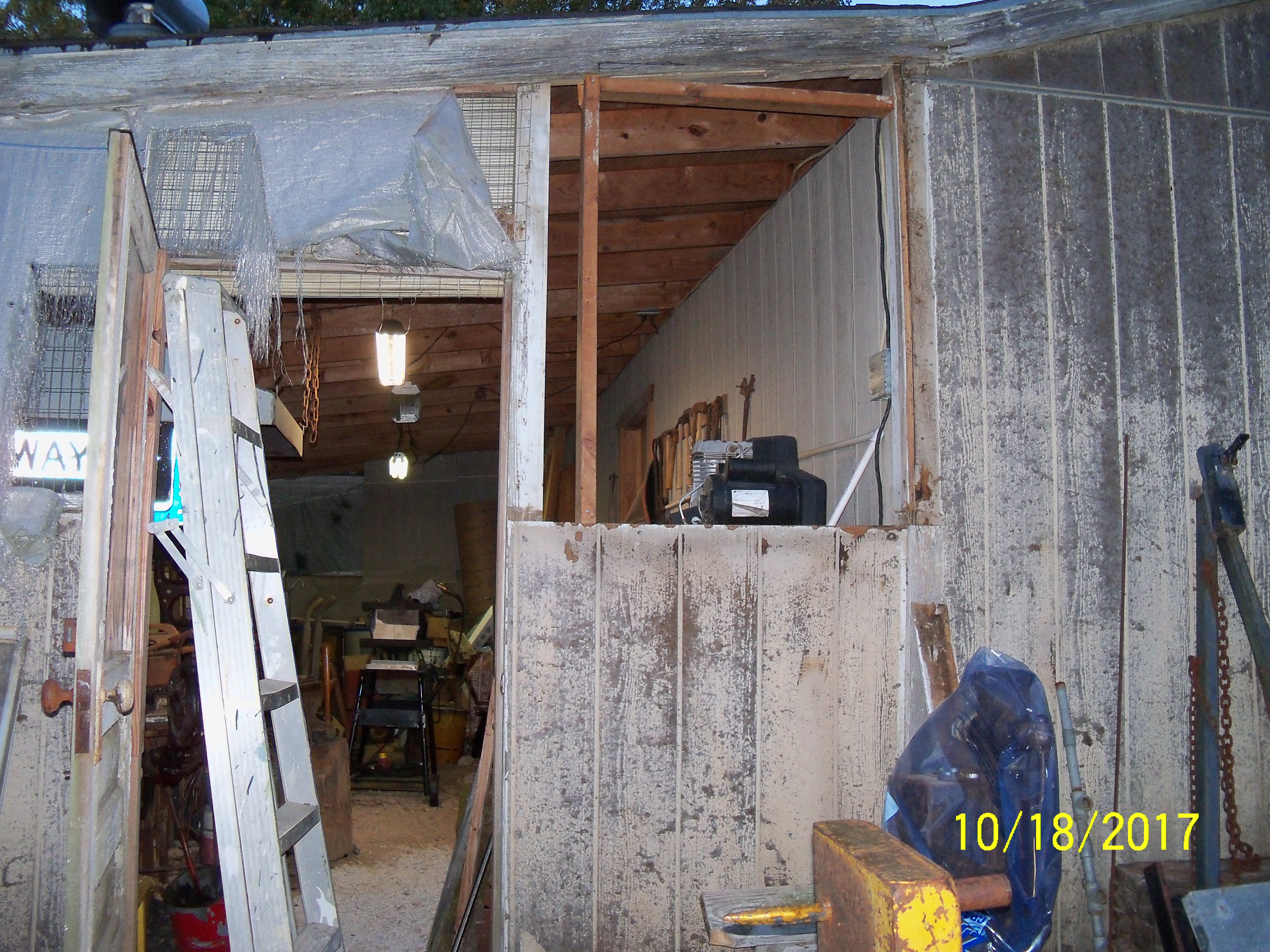

Irondragon Forge ClayWorks Posted October 19, 2017 Share Posted October 19, 2017 I made a spring fuller for the anvil or power hammer. Then framed up a window opening to replace the torn up chicken house curtains. Quote Link to comment Share on other sites More sharing options...

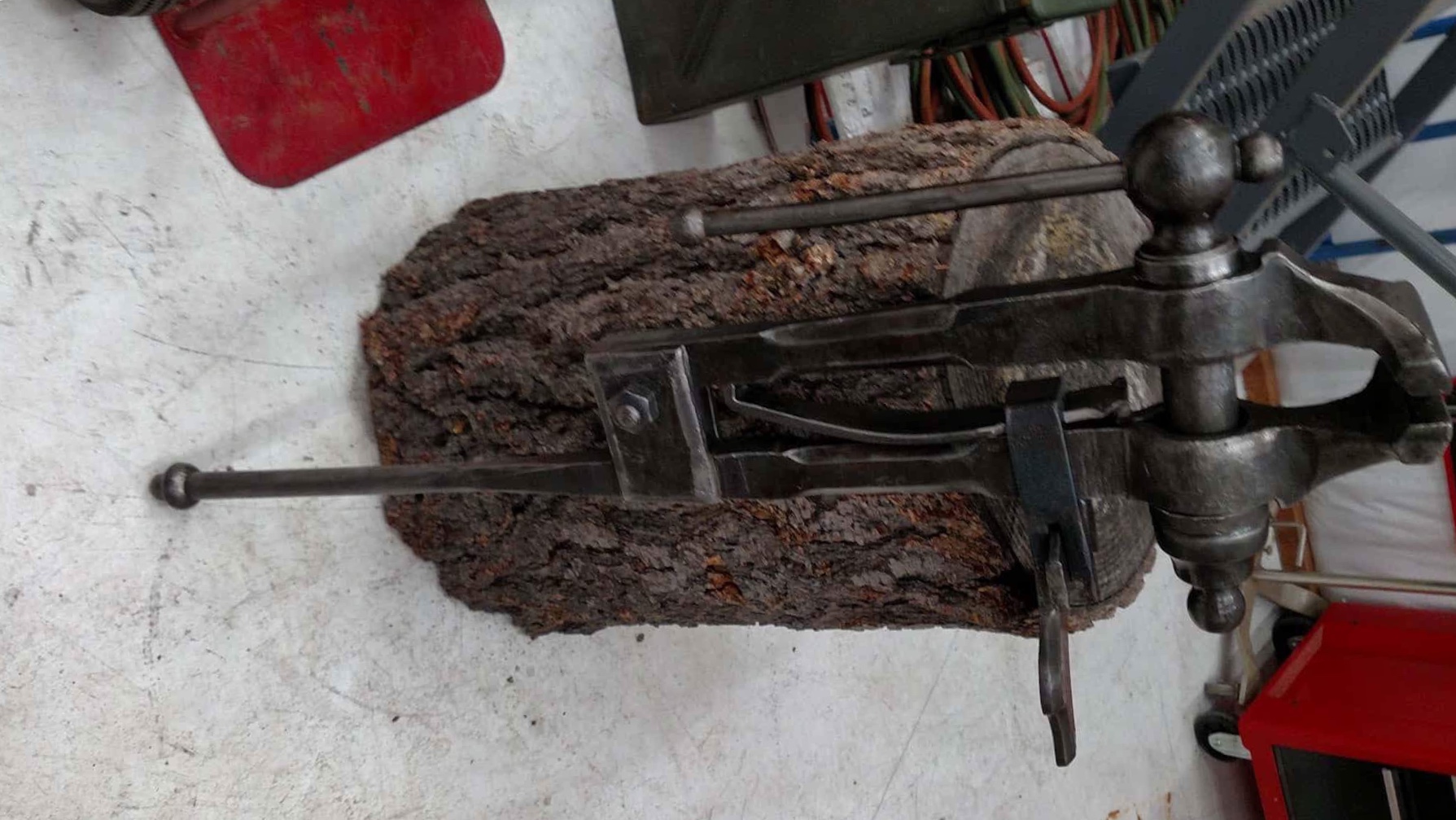

GrumpyBiker Posted October 19, 2017 Share Posted October 19, 2017 Mounted my post vise. Quote Link to comment Share on other sites More sharing options...
Reeltree Posted October 19, 2017 Share Posted October 19, 2017 Are the vise jaws above the table top, hard to tell in the pic Quote Link to comment Share on other sites More sharing options...
HammerMonkey Posted October 20, 2017 Share Posted October 20, 2017 I finished rehab on a 5” post vise. Quote Link to comment Share on other sites More sharing options...
GrumpyBiker Posted October 20, 2017 Share Posted October 20, 2017 16 hours ago, Reeltree said: Are the vise jaws above the table top, hard to tell in the pic Just enough so I could go 90° Towards the table. If I set it any higher it'd interfere with using my assembly table for large objects. Everything in my shop has to be a compromise as it serves primarily as a wood shop for my furniture making. Taking on this blacksmithing hobby is to add forged items to my furniture. Drawer pulls & handles. Corner banding & accents. Quote Link to comment Share on other sites More sharing options...

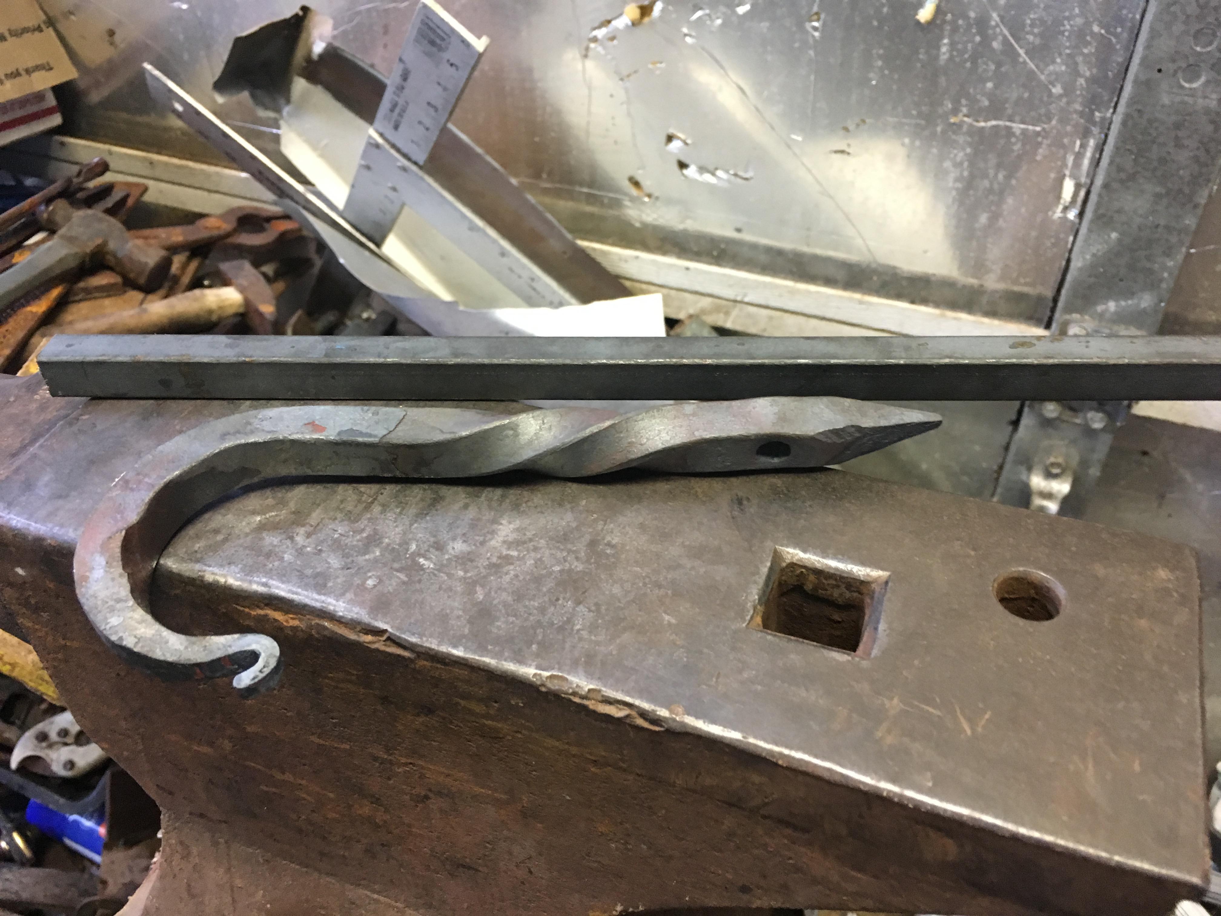

Michael Cochran Posted October 22, 2017 Share Posted October 22, 2017 Finished working in my truck today and got everything out back together. The guy that came out to help yesterday came back so he could get some forge time. I obliged and lit the fire and off we went. He wanted to make a knife, I assured him it's not the best beginner project. None the less we took a stab at it and it wasn't long before he got frustrated and I talked him into trying something else. We made a hook for him to have something to show off and get his gears going. Started with 1/2" square simple because that's what I had on hand (would've rather used 3/8" or 5/16" instead but currently out of stock) and I did a taper on the top end and he did the hook side all by himself. We put a half twist in it and punched a hole for hanging. I think the punching was the best part because he just couldn't believe you could do that so easily. I'm gonna have to adjust and/or make some tongs and get some more steel before he comes back so we have some more projects we can do. Quote Link to comment Share on other sites More sharing options...
