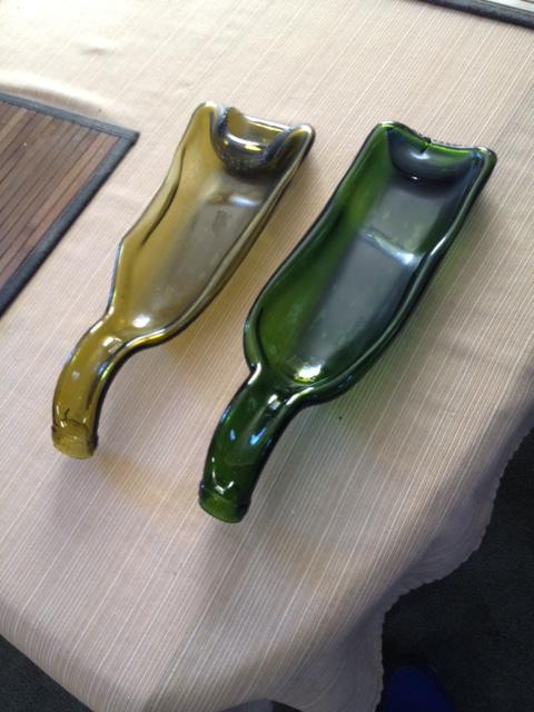

John in Oly, WA Posted August 29, 2017 Share Posted August 29, 2017 Just doing a bunch of miscellaneous projects in the shop the last couple of days - Made a quench tank from an old outdated oxygen tank. As a bonus I'm making a bell from the top piece. Slumping wine bottles into dishes in my heat treat (multipurpose ) oven. Finished my "ultimate" tongs. And varnishing a violin. Link to comment Share on other sites More sharing options...

Michael Cochran Posted August 29, 2017 Share Posted August 29, 2017 1 hour ago, John in Oly, WA said: Slumping wine bottles into dishes in my heat treat (multipurpose ) oven. Those are cool. If I had a heat treat oven I'd probably have to do that kind of thing for my wife and inlaws more than I could use it for my own projects. Link to comment Share on other sites More sharing options...
John in Oly, WA Posted August 29, 2017 Share Posted August 29, 2017 Thanks. Funny you should mention that. In this case it's for my aunt. She brought over 18 wine bottles (All EMPTY! What's up with that?! ) and asked if my oven got hot enough could I melt them into trays. I should get a bumper sticker for my heat treat oven - "I'd rather be heating knives" LOL Link to comment Share on other sites More sharing options...
Michael Cochran Posted August 29, 2017 Share Posted August 29, 2017 Tell her to leave a little in one next time lol. My father in law saw some of the old glass coke bottles that were slumped and had a thermometer attached at a "junk store" a couple years ago and asked if I could do that. Of course he still thinks I melt metal to make what I want. What's really bad is he's not the only one who's made comments along those lines. Link to comment Share on other sites More sharing options...

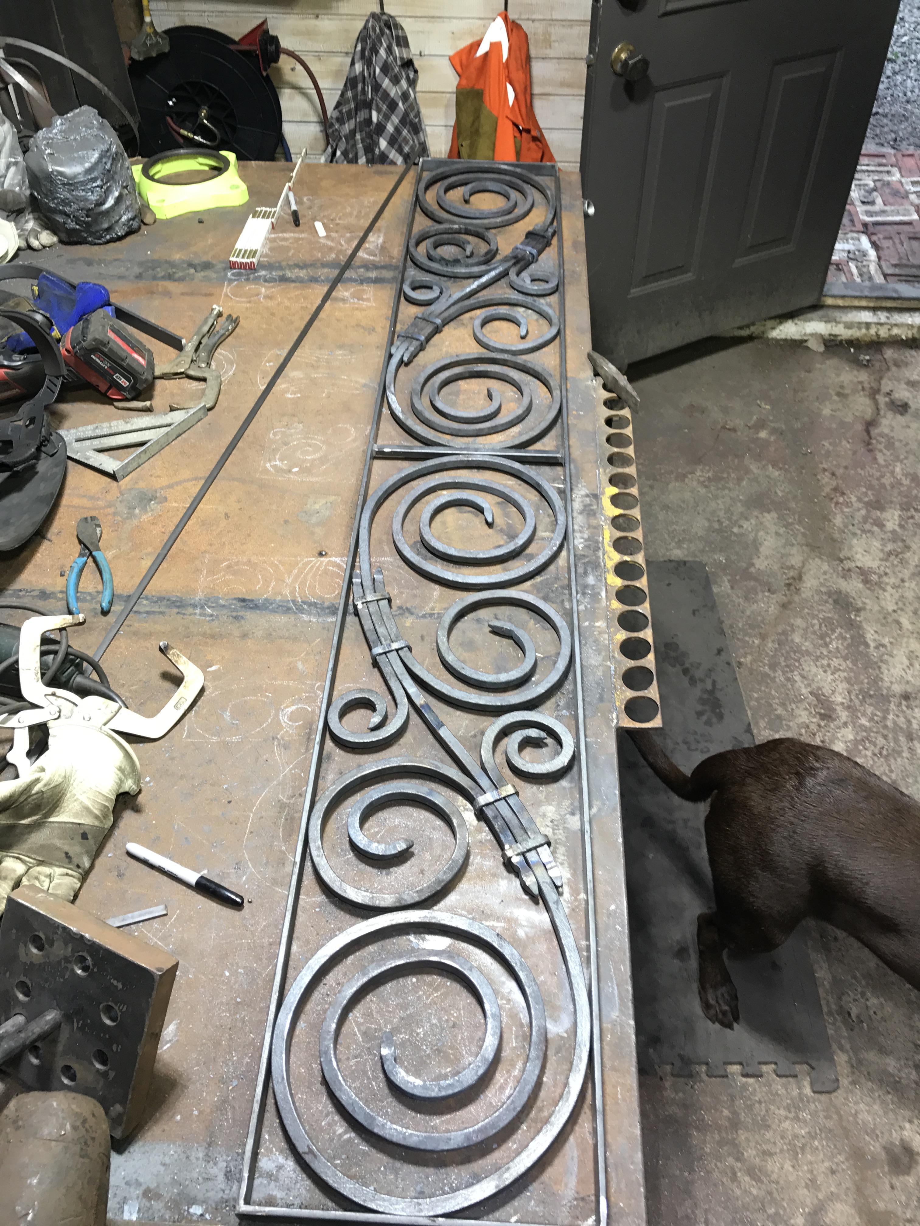

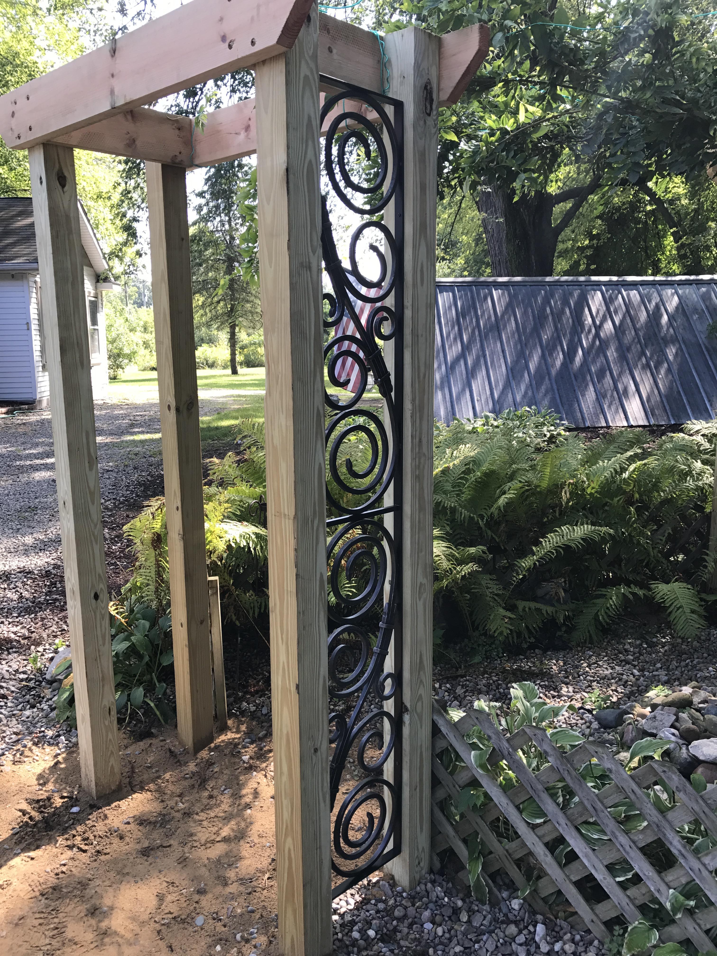

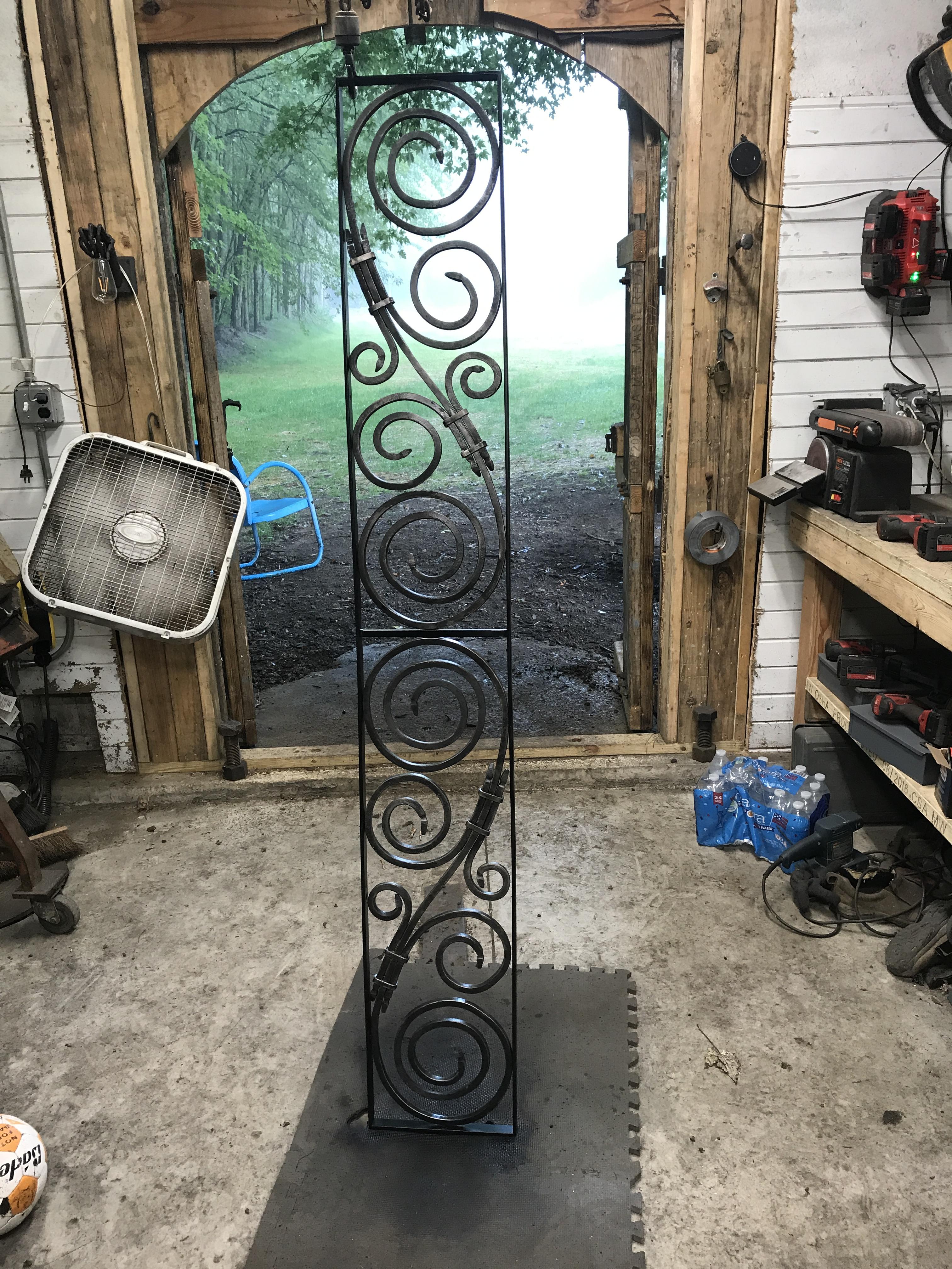

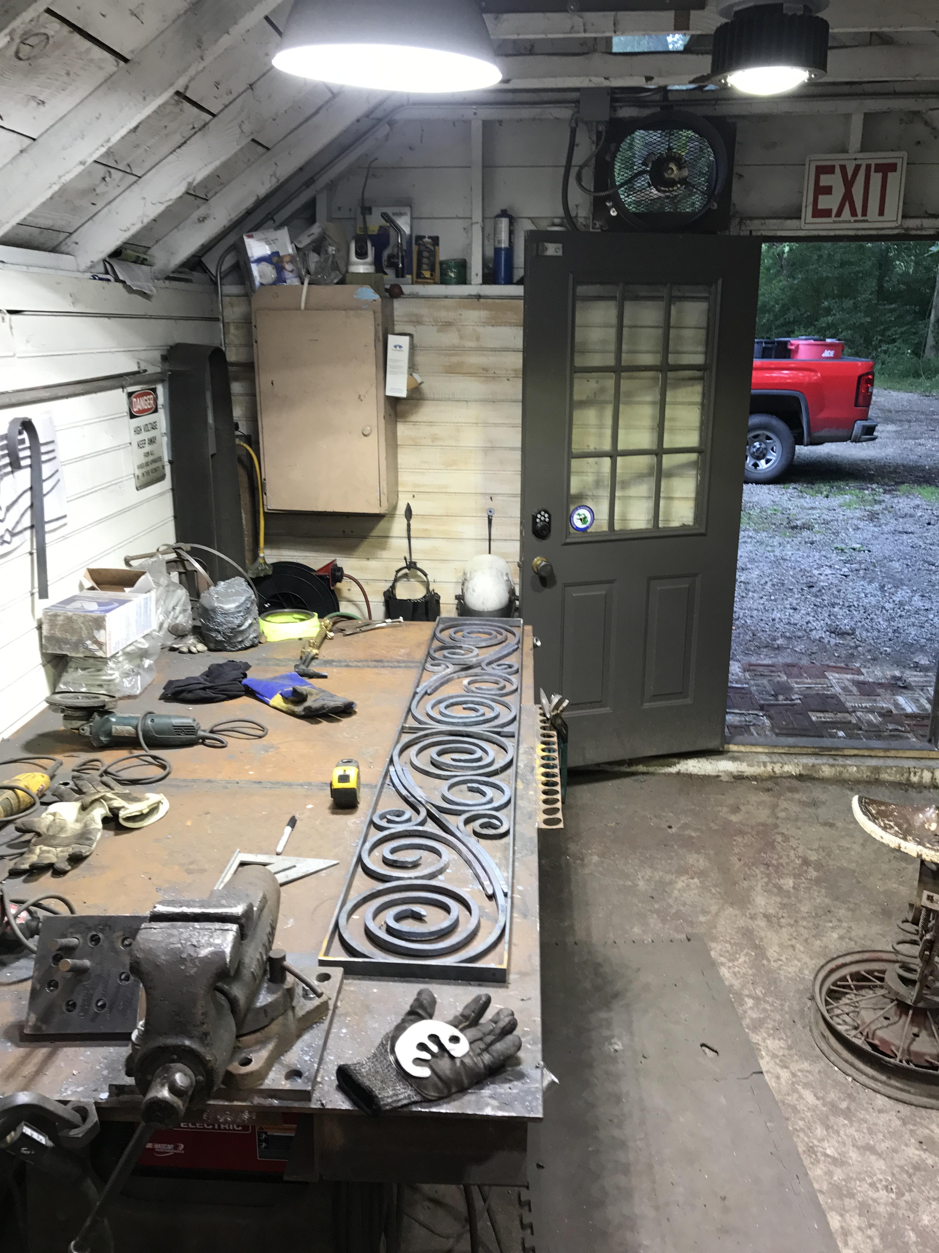

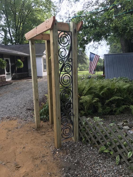

58er Posted August 30, 2017 Share Posted August 30, 2017 First attempt at something architectural. Not sure on outcome but wife loves it and I must say, I enjoyed it. Made second half of trellis today. John, what technique did you use to forge the violin?? wood you share?? hehe. Get it??? wood Link to comment Share on other sites More sharing options...
Buzzkill Posted August 30, 2017 Share Posted August 30, 2017 1 minute ago, 58er said: Not sure on outcome but wife loves it I'm not showing it to my wife or I'd have another project to do. Nice work! Link to comment Share on other sites More sharing options...
John in Oly, WA Posted August 31, 2017 Share Posted August 31, 2017 Nice trellis panels. Very low temp forging on the violin. Heated until the seams could be parted. Cold work on the front and back plates thinning the material. Welded back together with hide glue. The varnish - also low temps. Turpentine to 575F for 60 minutes after the exothermic reaction subsided, cooled until brittle, heated up again, add linseed oil, back up to 575f for another 30 minutes, cool to 340f, add fresher turpentine to thin. Link to comment Share on other sites More sharing options...
ausfire Posted August 31, 2017 Share Posted August 31, 2017 Nice trellis, 58. The collars look great. What's the thing on the glove?? Link to comment Share on other sites More sharing options...
