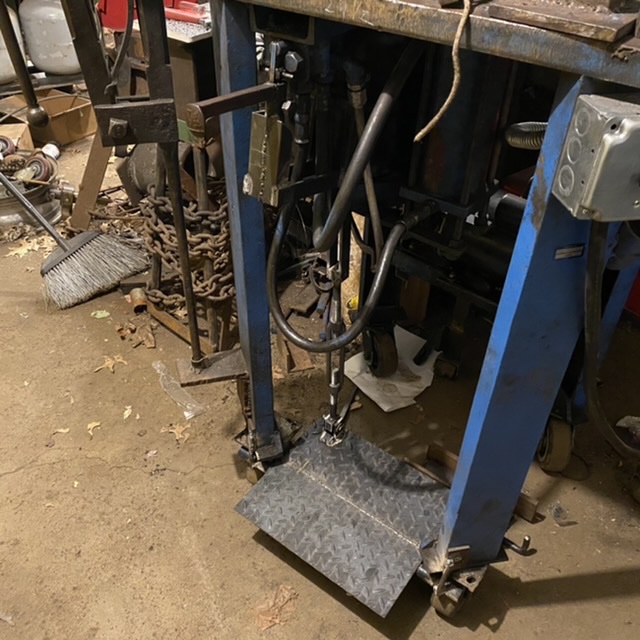

JHCC Posted November 30, 2020 Share Posted November 30, 2020 Lots of fabrication today: designed, built, and installed a foot pedal for The Pressciousss. I wanted to take the existing hand lever and add some arms pointing towards the back, but the valve was in the way. So, this complicate arrangement came into being: The vertical linkage includes a turnbuckle, just above the pivot that attaches it to the pedal. And here it is in action: Heel goes down, dies close. Toe goes down, dies open. Quote Link to comment Share on other sites More sharing options...
