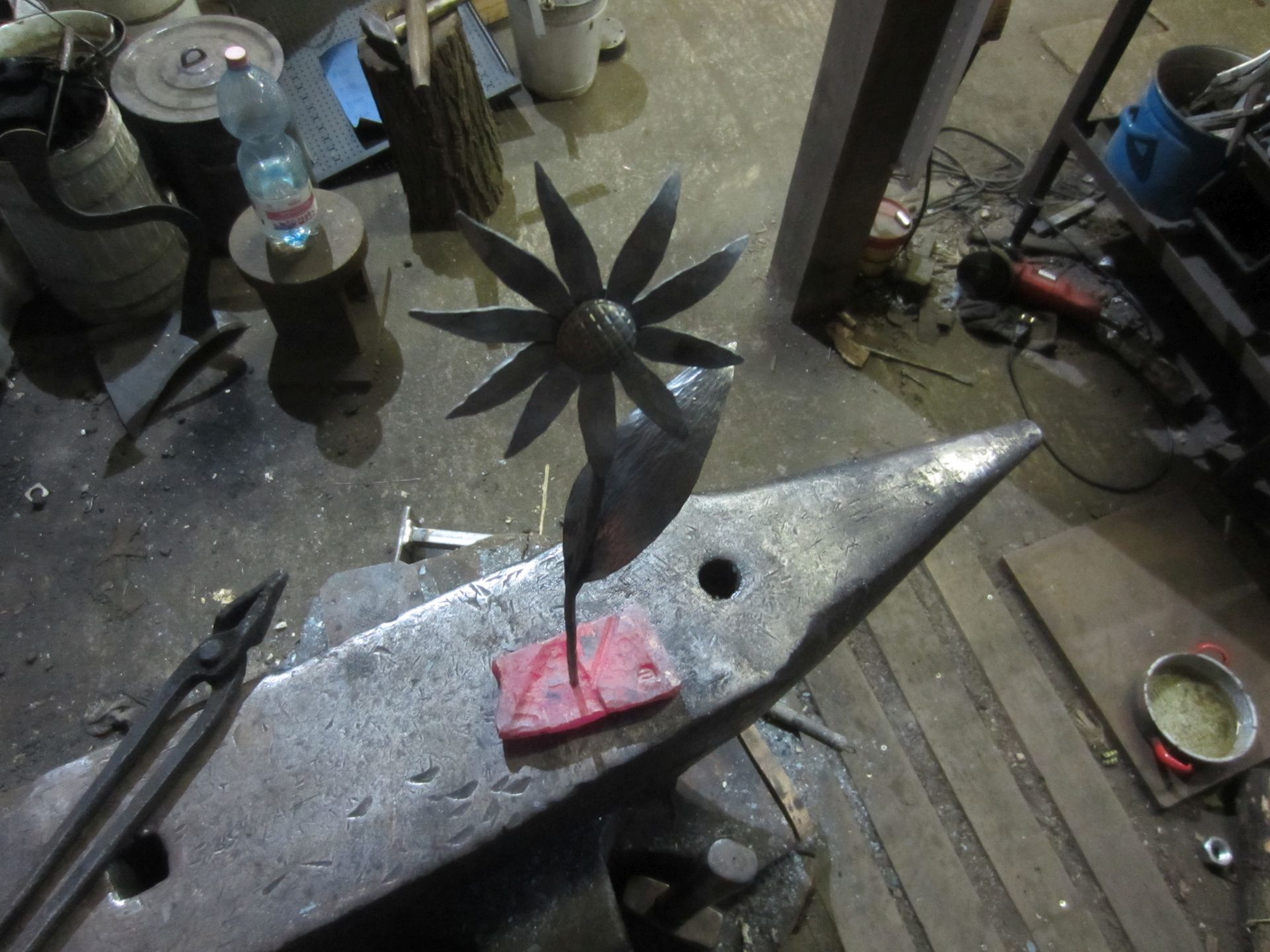

Gergely Posted August 23, 2017 Share Posted August 23, 2017 Hello Jim, Real nice looking cone. And I love that table you have the drill on! I finished this flower. Its base was the most fun to forge: it's made of 60mm / 2 3/8" x 20mm / 3/4" flat stock. Last couple of weeks I mostly forged small stuff so I really enjoyed banging heavy metal. Quote Link to comment Share on other sites More sharing options...

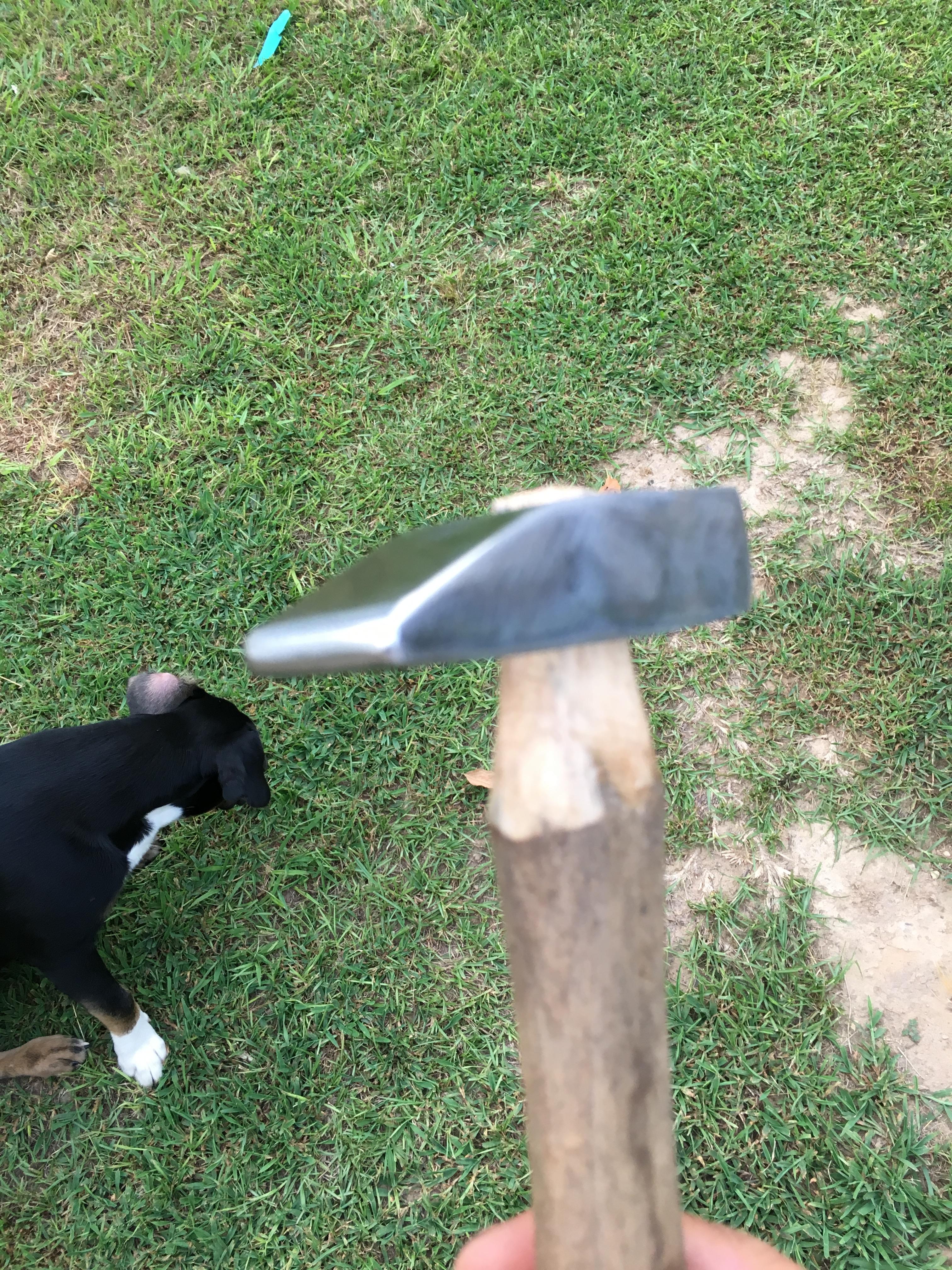

Mark Ling Posted August 24, 2017 Author Share Posted August 24, 2017 Thank you very much Mr. Coke! Nice cone top. Some one tried to give me a cone mandrel that had the first four inches cut off....only problem was the van already had an anvil and swags block, 5 people, and luggage. Maybe next time we're there I'll get it. I like that flower Gergely, especially the base. neat hoe. For the handle, what about a wheelbarrow handle? That's what came to my mind first. Forged a claw hammer out of some axle. Littleblacksmith Quote Link to comment Share on other sites More sharing options...
Dylan Sawicki Posted August 24, 2017 Share Posted August 24, 2017 That's a nice hammer LB, how long did it take? it looks like it would be pretty simple to make. Quote Link to comment Share on other sites More sharing options...
Tubalcain2 Posted August 24, 2017 Share Posted August 24, 2017 SWEET hammer Mark. Now you just need figure out how to do a waffle face. I like my framing hammers to have hachet style handles, but that is just me. Quote Link to comment Share on other sites More sharing options...

Mark Ling Posted August 24, 2017 Author Share Posted August 24, 2017 3 hours ago, Dylan Sawicki said: That's a nice hammer LB, how long did it take? it looks like it would be pretty simple to make. Thank you. Well, it took longer than it should have, about three hours. It wasn't the one striking who made it take long, he was doing excellent with a 12lb. It was that thinks we're a little wonky and not right. So we had to go back and forth from trying to get things in line and straight. I think if we didn't have to deal with the wonkyness than it would have taken about 1-1/2 -2 hours, that includes grinding (though all that was ground was the face) and handling. it was pretty simple. Started with some 1 1/4" axle, flattened to half round (like you would a hammer eye punch), then punch on the high side. Drift it open, and using a top fuller take down the swell created from punching and drifting, then using the top fuller, fuller fro. O e side on either side of the eye, creating a set down. Then using the too fuller draw out the claw, and cut off the excess. Take a set hammer or flatter, and move to the face and forge it down square (it had been oval from the original flattening of two sides). Then drift the eye open again because from fuller I get the set downs it will have crushed the eye, and now spread the cheeks some. Now fuller all the way around next to the face as if you were making a rounding hammer. Split the claw and bend it, that's about it. If you type in to YouTube "forging a claw hammer" there are a couple of videos of Alec making one the same way, and one of him and his Freind, who I know, is making one, that one I found the best. 2 hours ago, Tubalcain2 said: SWEET hammer Mark. Now you just need figure out how to do a waffle face. I like my framing hammers to have hachet style handles, but that is just me. Thank you Elijah. Waffle face I think wouldn't be too difficult. Just an angle grinder with a cut off wheel, or maybe even a chisel. Interesting, like with a curve in them? I prefer hammer handles like this, but, that's just me. Littleblacksmith Quote Link to comment Share on other sites More sharing options...

BubbaNash Posted August 25, 2017 Share Posted August 25, 2017 That claw hammer is fantastic! i would use that any day. been looking through here, you are quite impressive! Quote Link to comment Share on other sites More sharing options...
Mark Ling Posted August 25, 2017 Author Share Posted August 25, 2017 2 hours ago, Melw45 said: Lbs I like your hammer. I showed it to my wife she said it was pretty. Good job! Mel Thank you very much, glad to hear the wife likes it too! 1 hour ago, BubbaNash said: That claw hammer is fantastic! i would use that any day. been looking through here, you are quite impressive! Thank you very very much sir. I really needed to hear something like this right now. Littleblacksmith Quote Link to comment Share on other sites More sharing options...
