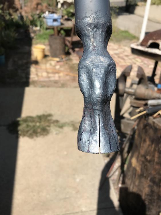

671jungle Posted August 28, 2020 Share Posted August 28, 2020 Did some work on a 1 1/4” pipe. Ran out of juice before finishing. Middle tentacles need a bit more drawing out to be longer than the sides and then dictating the curl of each one. Gonna try for a snarling expression. I already know what I would do differently and thought about going at it with round stock. Link to comment Share on other sites More sharing options...
Daswulf Posted August 28, 2020 Share Posted August 28, 2020 Cool jungle. I had started an octopus out of a single pipe. Unfortunately it is still awaiting more work under a pile of scrap by my forge lol. Link to comment Share on other sites More sharing options...
ThomasPowers Posted August 28, 2020 Share Posted August 28, 2020 Part of a lovely headboard for a kids bed! (I think there was one in the original Chas Addams cartoons...) Link to comment Share on other sites More sharing options...
671jungle Posted August 28, 2020 Share Posted August 28, 2020 2 hours ago, ThomasPowers said: Part of a lovely headboard for a kids bed! (I think there was one in the original Chas Addams cartoons...) Daswulf, I would love to see it once its underway again. Especially since your creations are mostly animal from i have seen. Link to comment Share on other sites More sharing options...

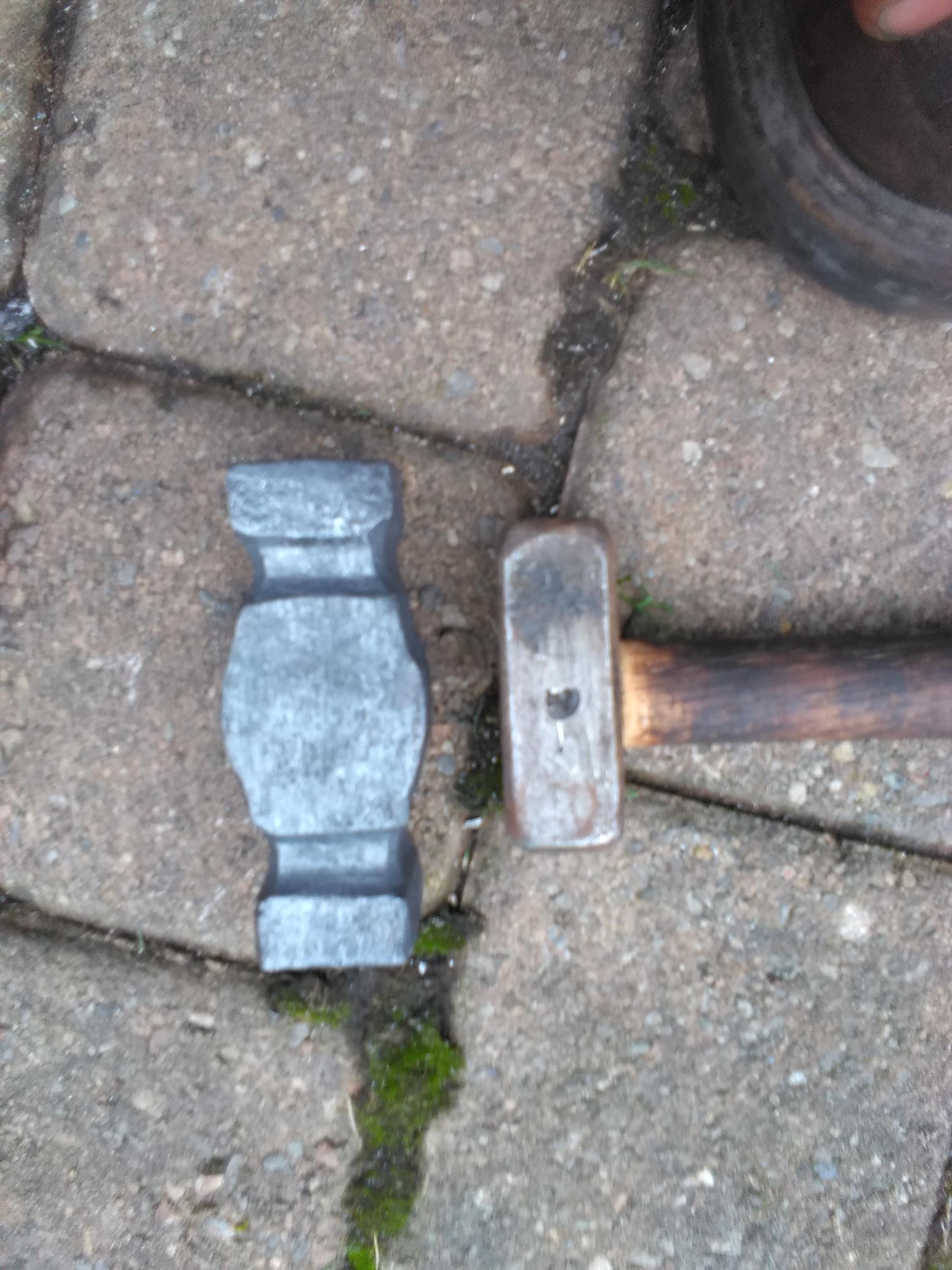

DennisCA Posted August 28, 2020 Share Posted August 28, 2020 Kept removing material from the hammer head, now at 1250 grams and I think I will stop here. Made a new shaft for it, haven't made a smithing hammer shaft but I looked at what others prefer and also some videos with smiths talking design, so I made a slimmer handle. Not yet attached permanently, still want to do more shaping. Link to comment Share on other sites More sharing options...
JHCC Posted August 28, 2020 Share Posted August 28, 2020 Very nice indeed. Link to comment Share on other sites More sharing options...
Frazer Posted August 29, 2020 Share Posted August 29, 2020 Dennis, that is turning out very nice indeed. I'm sure it took a belt or two to slim it down 250g.. Today I made some significant progress on a few ongoing projects. First, the pull handles I made several months ago finally had the doors to mount them on. There is still a third door they haven't been installed on yet. I need to make longer bolts than the ones I provided initially. That door ended up being thicker than the other two. The exterior handle of the third pair isn't curved like these are. The handles on the inside had to be low profile to fit in the 3/4" gap between the door and the trim. I also made some progress on hammer number 2. A 1.25# rounding hammer made from some RR track. The eye will need to be a bit longer (more of an oval) for the handle I'll be using, along with a few other aesthetic adjustments, but progress is progress. For reference, the tiny hammer is the first hammer I made, weighing in at a staggering 7.375oz (210 grams). The other is a 3# rounding hammer that I did not make. In hopes that some might have stopped reading by now I saved this for last.... I've had a post vice sitting in the corner of the shop since I bought my anvil... ~9 months ago.. I have just been using a bench vise since it was easier to mount at the time and I was lazy. Yes, yes, I know shame on me. Well, I cleaned it up last week and the more I saw of it (without the thick layer of rust) the more I liked it. The tang mount and number of pieces that were used in it's construction suggests it is likely pretty old. The screw box and threads are all forge brazed together. When it was made and by who I don't know. She purtied up real nice though.. Shame my flip phone can't show it off well enough for gratuitous before & after shots. The stand is surprisingly solid as is, but I'm going to be adding some cross bracing. I don't trust that one piece of angle iron in the back. The other chunk of steel attached to the vise was my first improvised anvil. Some piece of RR scrap I acquired when first trying to set up my shop, but it only got used as such twice before I went to the scrapyard and found something better. Now I use it when A.) I need something heavy B.) I need a weird shape or bend somewhere. There are a lot of useful surfaces that... thing? Link to comment Share on other sites More sharing options...

DennisCA Posted August 30, 2020 Share Posted August 30, 2020 Thanks for the compliments, I finished the shaft last night and wedged it, the hammer is now ready to start acquiring a patina. Wiped everything down with BLO. Link to comment Share on other sites More sharing options...
