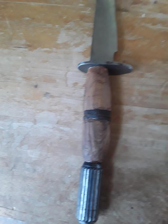

Virusds Posted July 4, 2020 Share Posted July 4, 2020 Happy fourth of July to all u fello amaricans! Yesterday I finished this knife. It is a weird shape that's for sure but I like it. The guy who ordered it told me he just wanted a presentable, useful knife. So I hope he is pleased with this one. It is made from a lawnmower blade, quenched in oil, tempered in the oven for 2 hours at 400° farenheit. The handle is black locust, stacked leather in the middle, and Russian olive for the other half. It keeps an edge well and I polished this blade better that any of my previous ones. The pommel is kinda long but I like how long and thin the blade looks overall. Link to comment Share on other sites More sharing options...
Chris Williams Posted July 5, 2020 Share Posted July 5, 2020 What is the pommel? It is reminiscent of the splined part on the end of the output shaft of a washing machine gear box. If you hadn't said it was a lawnmower blade, I would have thought that you forged one of those shafts into the blade with the spline left as a design element. Link to comment Share on other sites More sharing options...

Frosty Posted July 5, 2020 Share Posted July 5, 2020 I don't usually comment on knives, I'm not a bladesmith but I must say I do NOT like the pommel it's really over long and isn't in line with the blade. Being so long it makes the misalignment stand out obscuring positive features. I hope the commissioner likes it. Frosty The Lucky. Link to comment Share on other sites More sharing options...

Chris Williams Posted July 6, 2020 Share Posted July 6, 2020 (edited) 4 hours ago, Frosty said: I do NOT like the pommel it's really over long and isn't in line with the blade. I wasn't trying to complement the pommel if I came across that way. As far as I am concerned, though, design details are up to the maker and/or commissioner. I did find it a curious feature and still do wonder what it used to be. Edited July 6, 2020 by Chris Williams Clarification. Link to comment Share on other sites More sharing options...

Frazer Posted July 6, 2020 Share Posted July 6, 2020 11 hours ago, Chris Williams said: wonder what it used to be. It's a spline shaft. Link to comment Share on other sites More sharing options...
