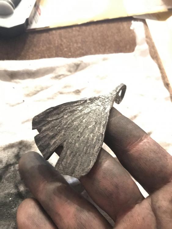

671jungle Posted February 7, 2020 Share Posted February 7, 2020 Ginkgo leaf from railroad spike Quote Link to comment Share on other sites More sharing options...
Frazer Posted February 7, 2020 Share Posted February 7, 2020 Jasent, that looks really nice! I think starting out with a thin round stock (like you did) would save me a lot of time, considering I started with a railroad spike.. Inefficient? Yes. Still fun? absolutely. JHCC, I knew I was forgetting something! Now where did I leave that thing.... Quote Link to comment Share on other sites More sharing options...

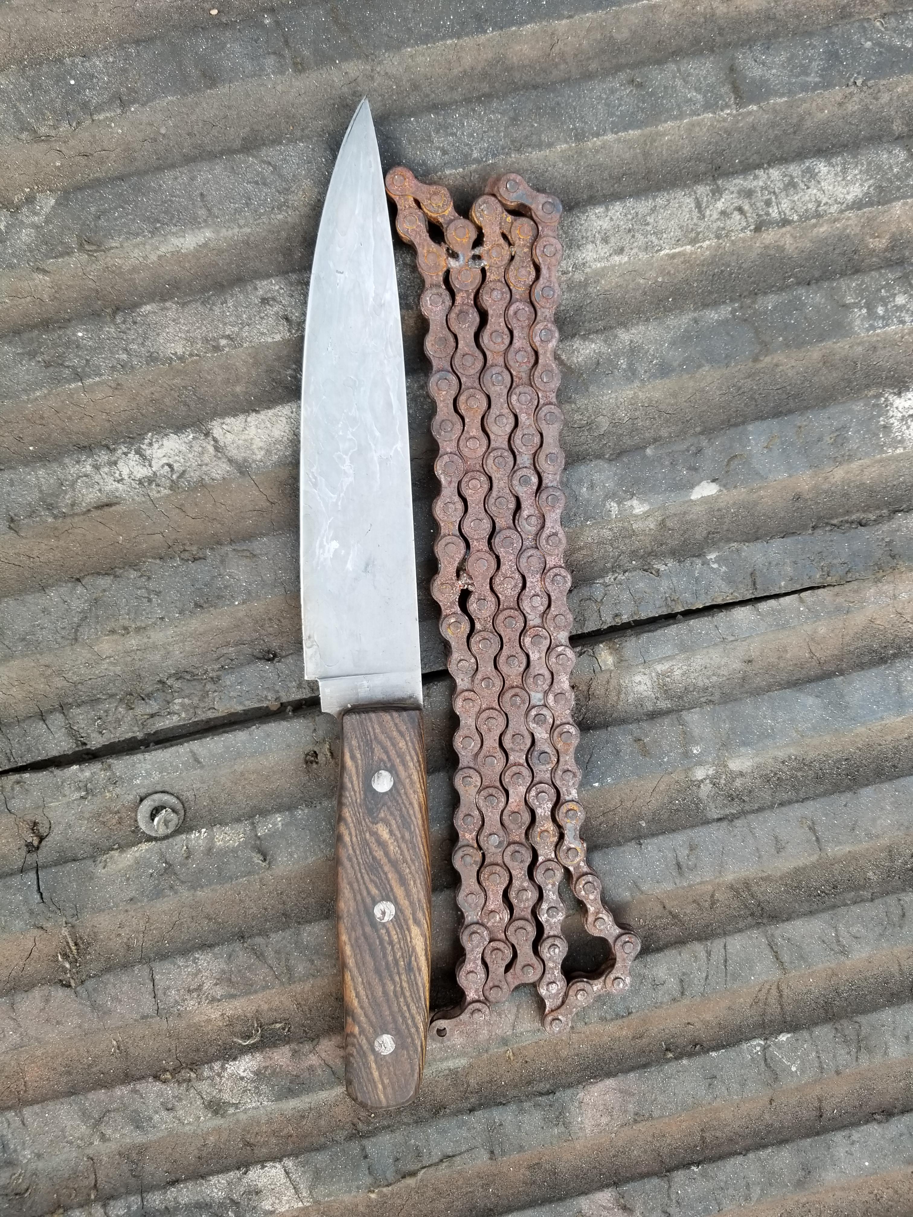

Dogsoldat Posted February 7, 2020 Share Posted February 7, 2020 Finished up my second Serbian chefs knife today. Piece of 5160 and mahogany, maybe, for the scales. Wood came from a box full of scraps of a recently passed friend. Came out much lighter than the first which has birch scales. First one has already gone to it's new home and second soon to follow. Quote Link to comment Share on other sites More sharing options...

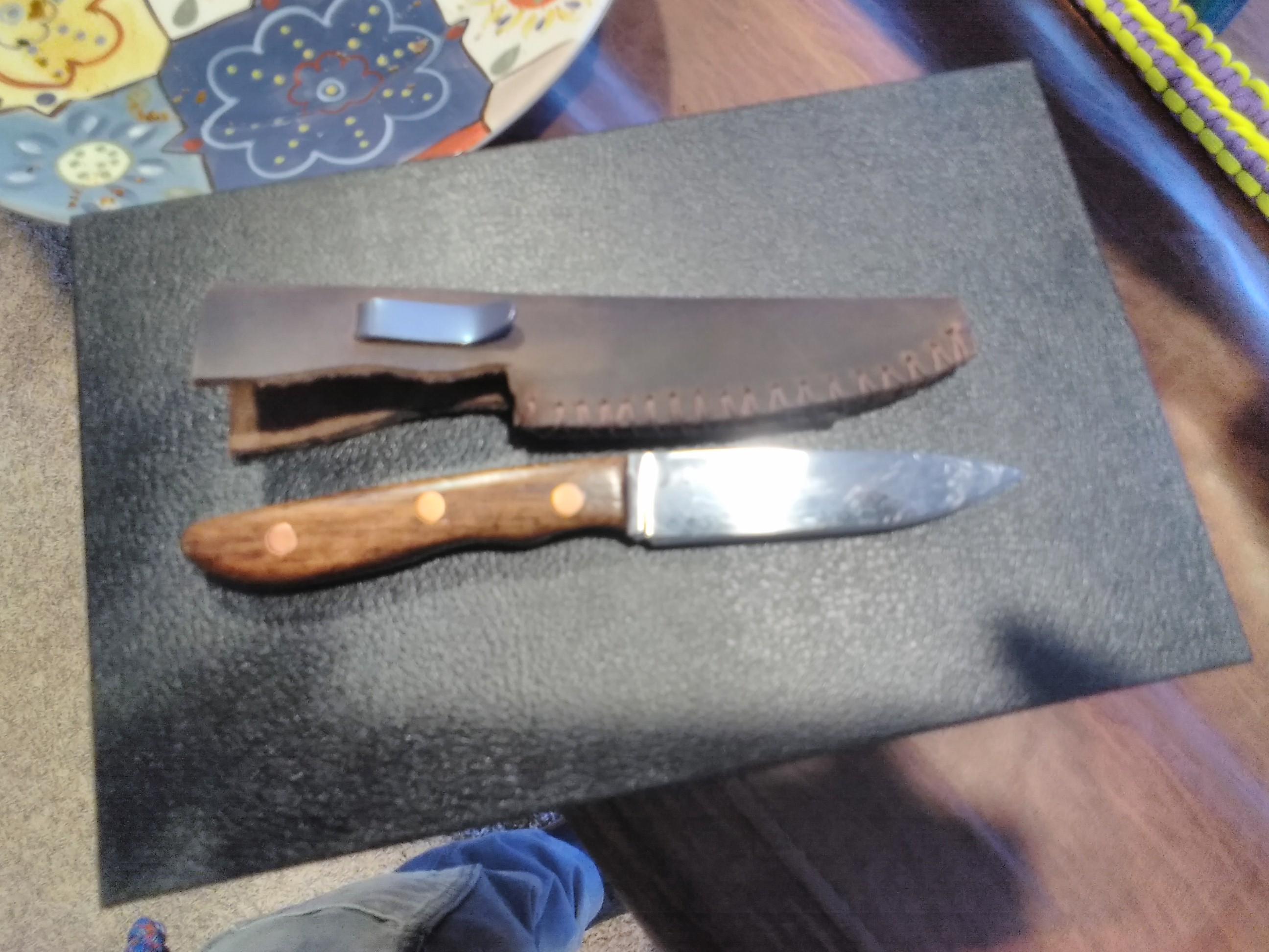

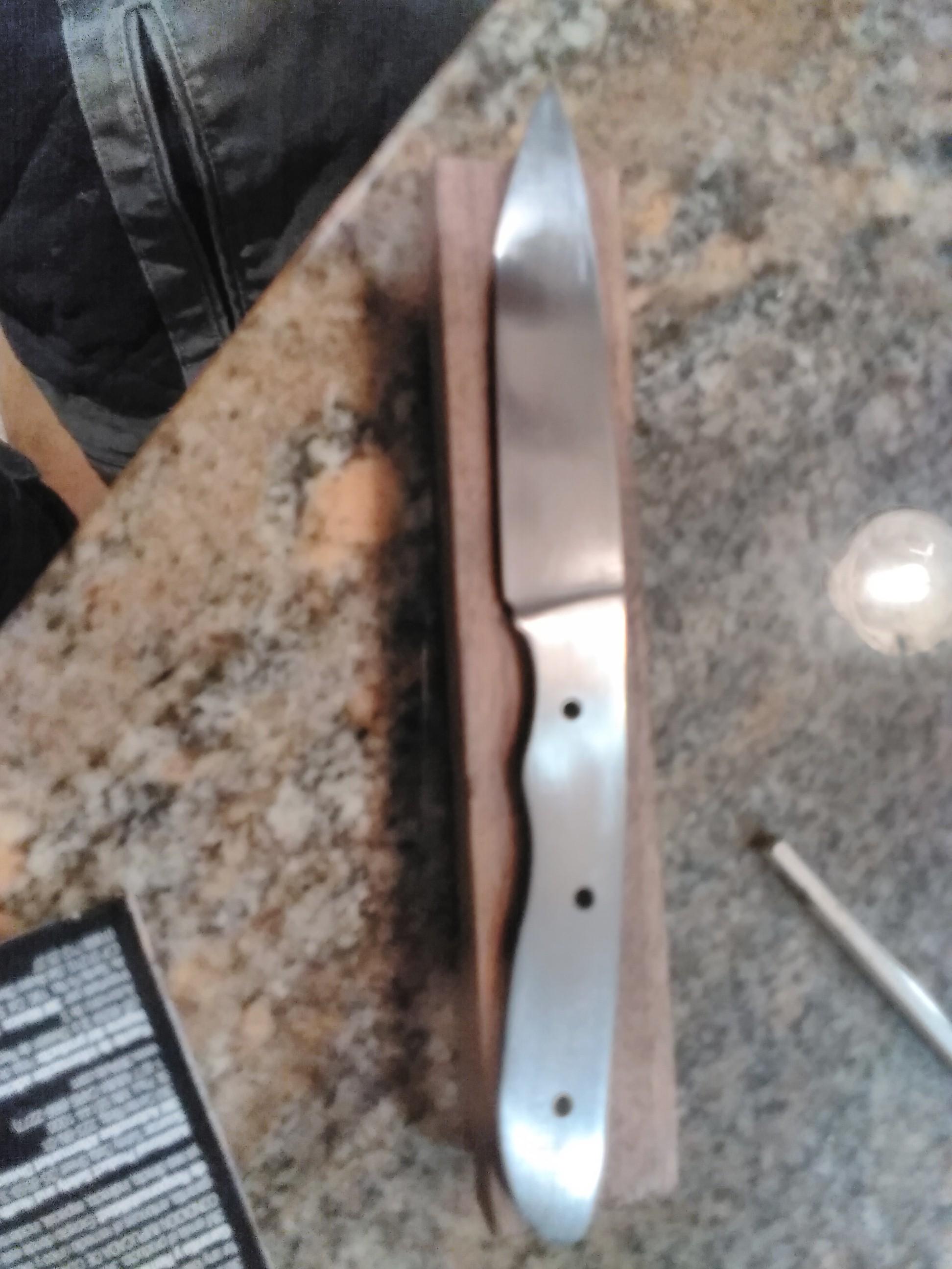

Frazer Posted February 7, 2020 Share Posted February 7, 2020 Finished this the other day. Every time I make a knife I am reminded of why I don't like making knives, so much file work and hand sanding (I don't have a grinder yet). I do however like to carry things that I make, so it's worth the time. Walnut handle, copper pins, started with an old Simonds square file I picked up from a tool thrift shop by me for $1. I love that place, very inexpensive second hand stuff. Full disclosure, I am not a bladesmith, but I do appreciate the handwork and time they put in to make nice blades like yours Michael. Heat treatment went well. It's about 6.25" overall length, pretty small to fit nicely in one of my leg pockets. I also finished this poker last week for my mom. Quote Link to comment Share on other sites More sharing options...

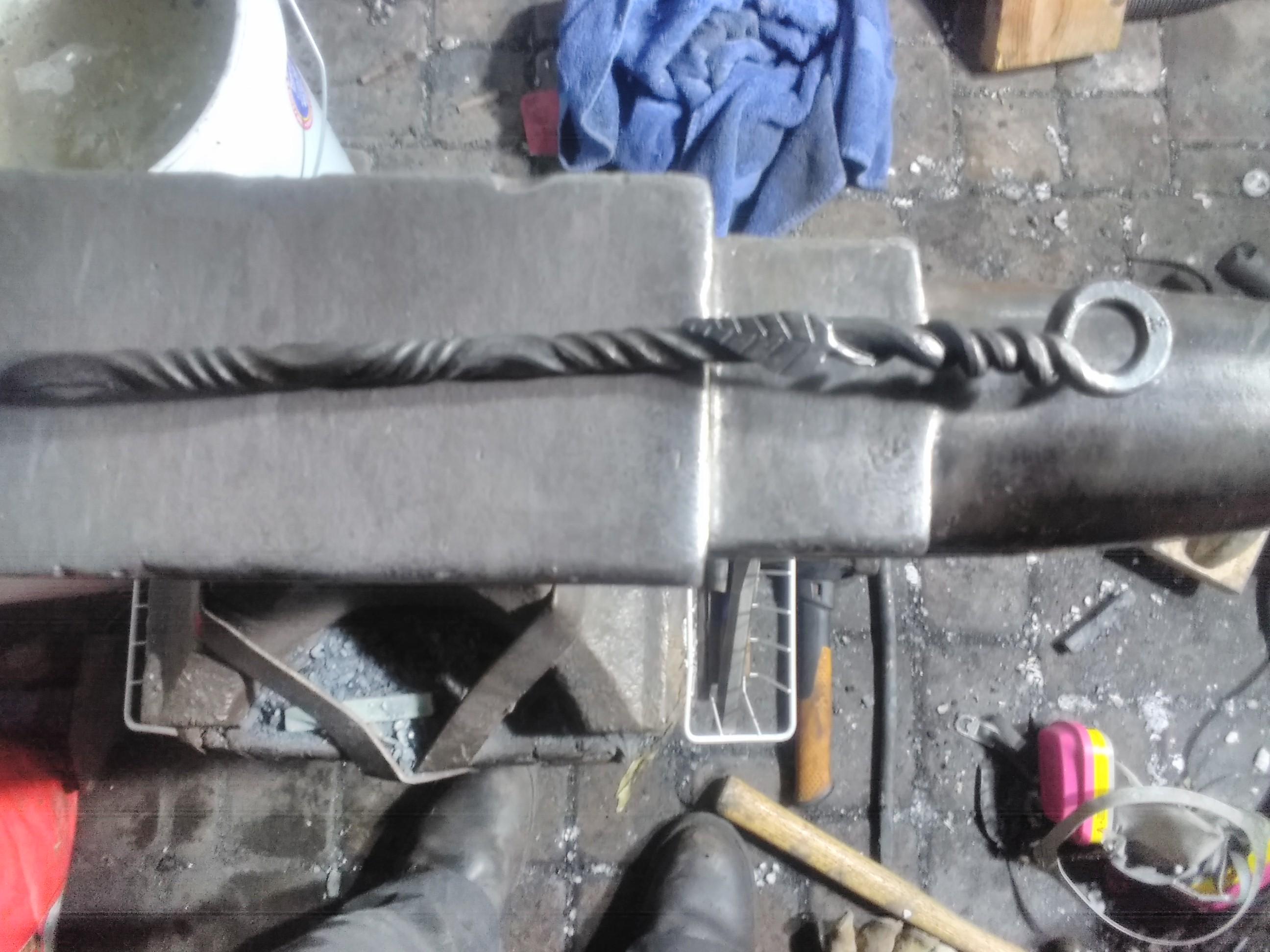

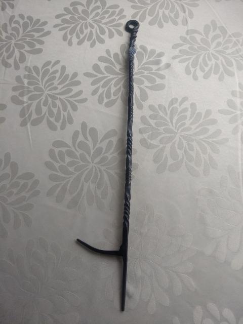

Virusds Posted February 7, 2020 Share Posted February 7, 2020 I love the knife. Im new to blacksmithing, only been doing it for a little over a year now, and i am still not very great at it. I like to make knifes more than anything so i really love that one especially knowing that it was ground down with hand tools. Also how did you make the pattern on the fire poker? I understand that you twist is right then left but the twist lines keep running through the entire peices and i was wondering how you accomplished that. Quote Link to comment Share on other sites More sharing options...
Frazer Posted February 7, 2020 Share Posted February 7, 2020 Thanks! It seems we are in the same boat then haha. Well minus the knife maker part, but that's just a matter of preference. You are likely far more patient than me. Unfortunately, there is no medal for doing things by hand. Simply for the sake of efficiency I'll get a belt grinder at some point, it has just been a lower priority considering I don't really need it all too often. For the poker, I forge with coal so I just heated up one section (about the size you see in the twists) at a time and like you said, alternated the direction of the twist. When heating the next section I tried to have just a little bit of the end of the previous twist at a dull red, so it kind of smoothed that transition from one direction to the other. Then I straightened everything with my handy dandy wooden hammer (a hand sized piece of 4x4) to protect the look of the twists. Also just a recommendation, cut yourself a little extra material than you think you'll need (I used a coil spring because I have a near infinite supply), square everything up and start making the poke-y end first, working back from there. The first time I tried it, I misjudged how much material I'd need and ended up making it too flimsy in trying to get the length I was looking for. Better to have a little extra on the end and cut it off than have too little and get stuck. To add insult to injury, I broke the leaf on the end off while working on the middle because I did things out of order. I always learn some ways not to do something along the way. Just important as when it goes well haha as I'm sure you know. Quote Link to comment Share on other sites More sharing options...
