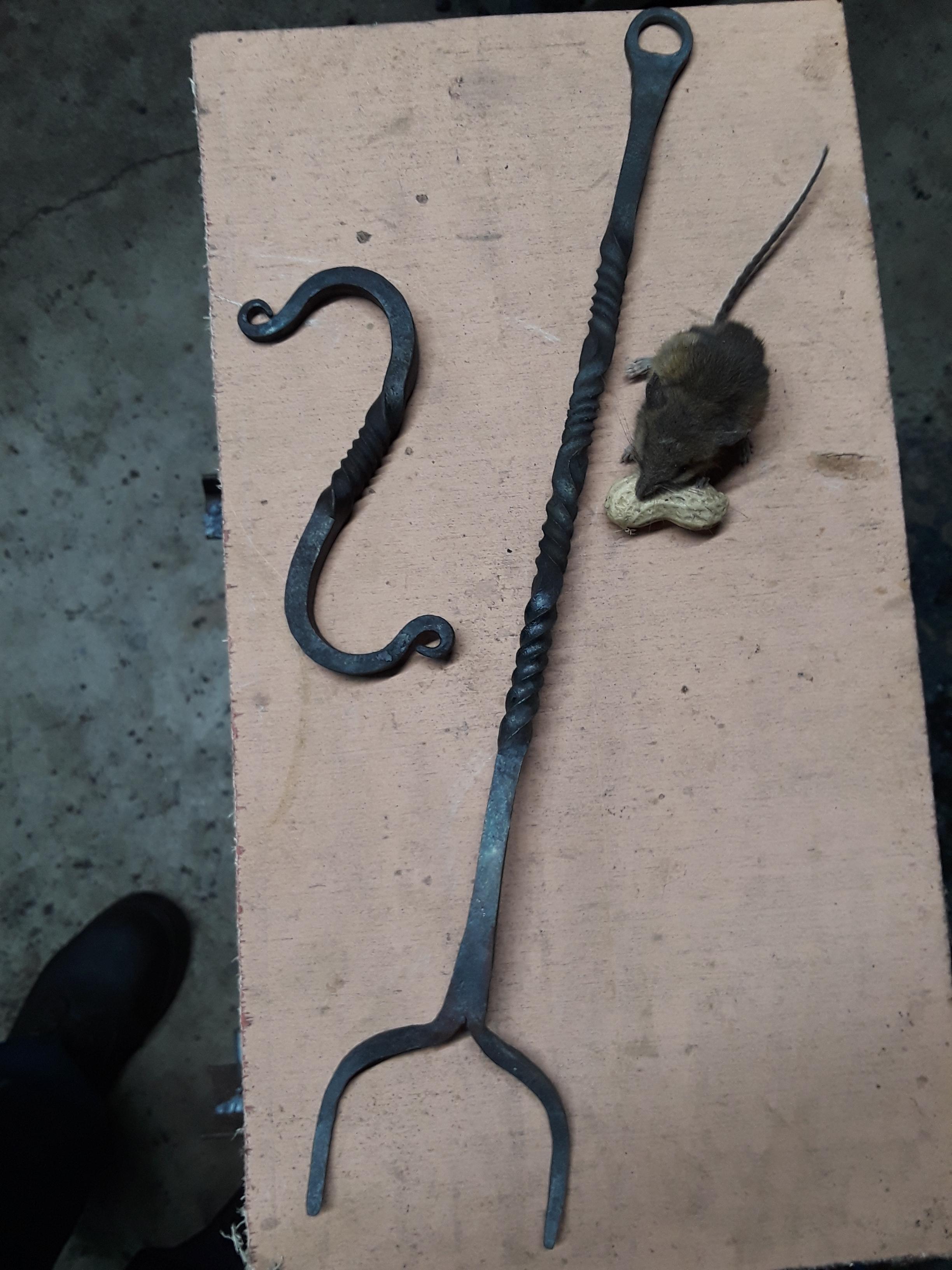

ADHD-forge Posted November 4, 2019 Share Posted November 4, 2019 made the trammel hook yesterday morning not very happy with top eye, but we learned something so progress was made Quote Link to comment Share on other sites More sharing options...
tjdaggett Posted November 4, 2019 Share Posted November 4, 2019 ADHD, that is gorgeous, hook and tripod both. That's a project in my future. Quote Link to comment Share on other sites More sharing options...

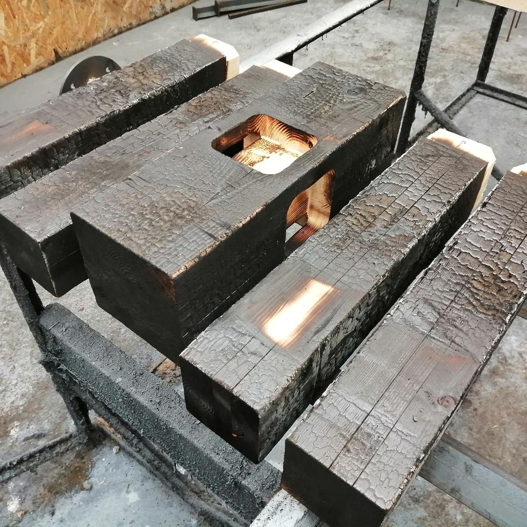

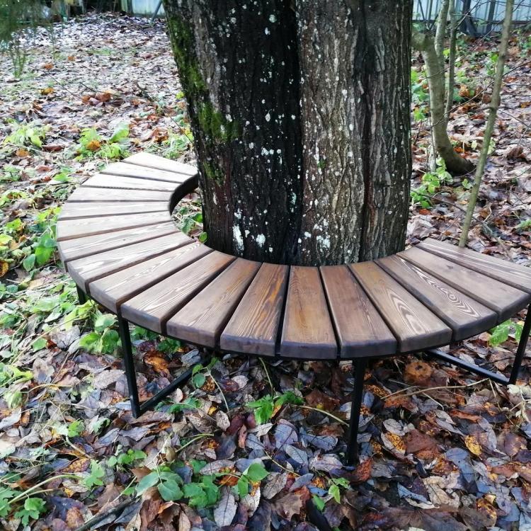

alexandr Posted November 4, 2019 Share Posted November 4, 2019 I continueto deal with the next project. Several chandeliers and furniture in the gazebo. Quote Link to comment Share on other sites More sharing options...

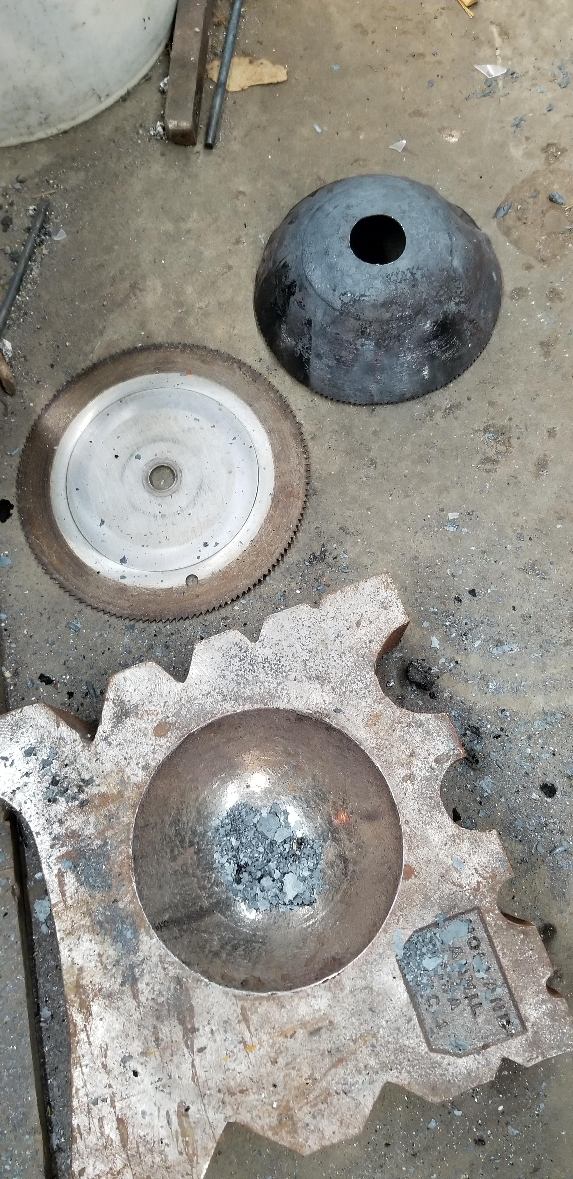

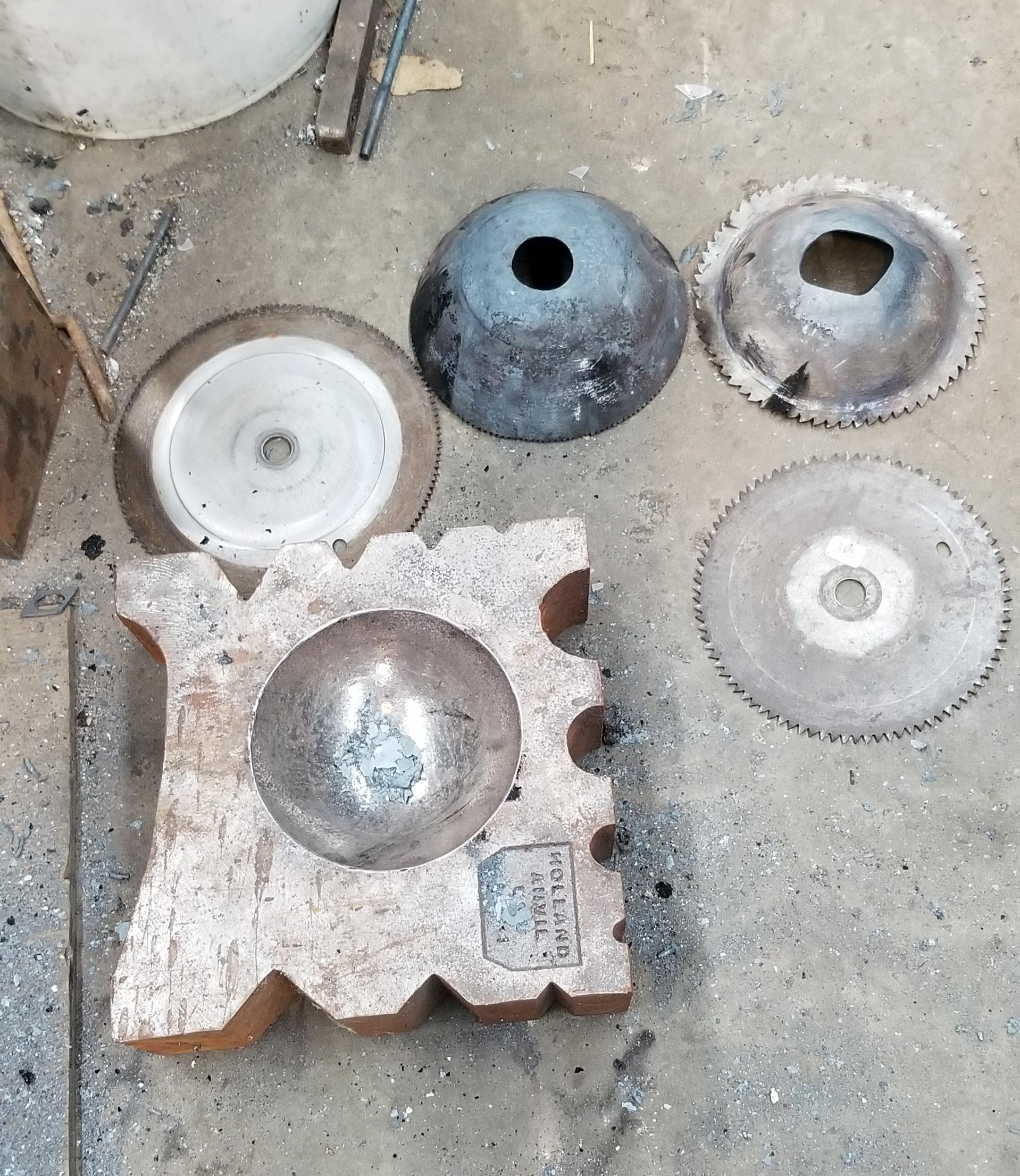

Daswulf Posted November 5, 2019 Share Posted November 5, 2019 Experimenting dishing saw blades to make a jellyfish upper part. ( had a guy throw money and an address at me at my last event this weekend wanting a jellyfish and to ship it to him. . Ok..... Btw, loving the swage block from Holland Anvil. Quote Link to comment Share on other sites More sharing options...
ThomasPowers Posted November 5, 2019 Share Posted November 5, 2019 BB, Stone County Ironworks used to hang their "best" doughnut clinkers on nails on the wall. (Back in the 1980's). I have a dirt/sand/small gravel floor that is gradually adding clinker to the mix... Das; one way to do spot heating on larger dished forms is to place the outer side over the hot spot and put a piece of coke inside the bowl over where you want it hot and it will preferentially heat there. (Pots & shield Bosses---I still tend to pick up sheet metal circles anytime I find them at the scrap yard.) Quote Link to comment Share on other sites More sharing options...
Daswulf Posted November 5, 2019 Share Posted November 5, 2019 Thanks for the tip Thomas. Quote Link to comment Share on other sites More sharing options...

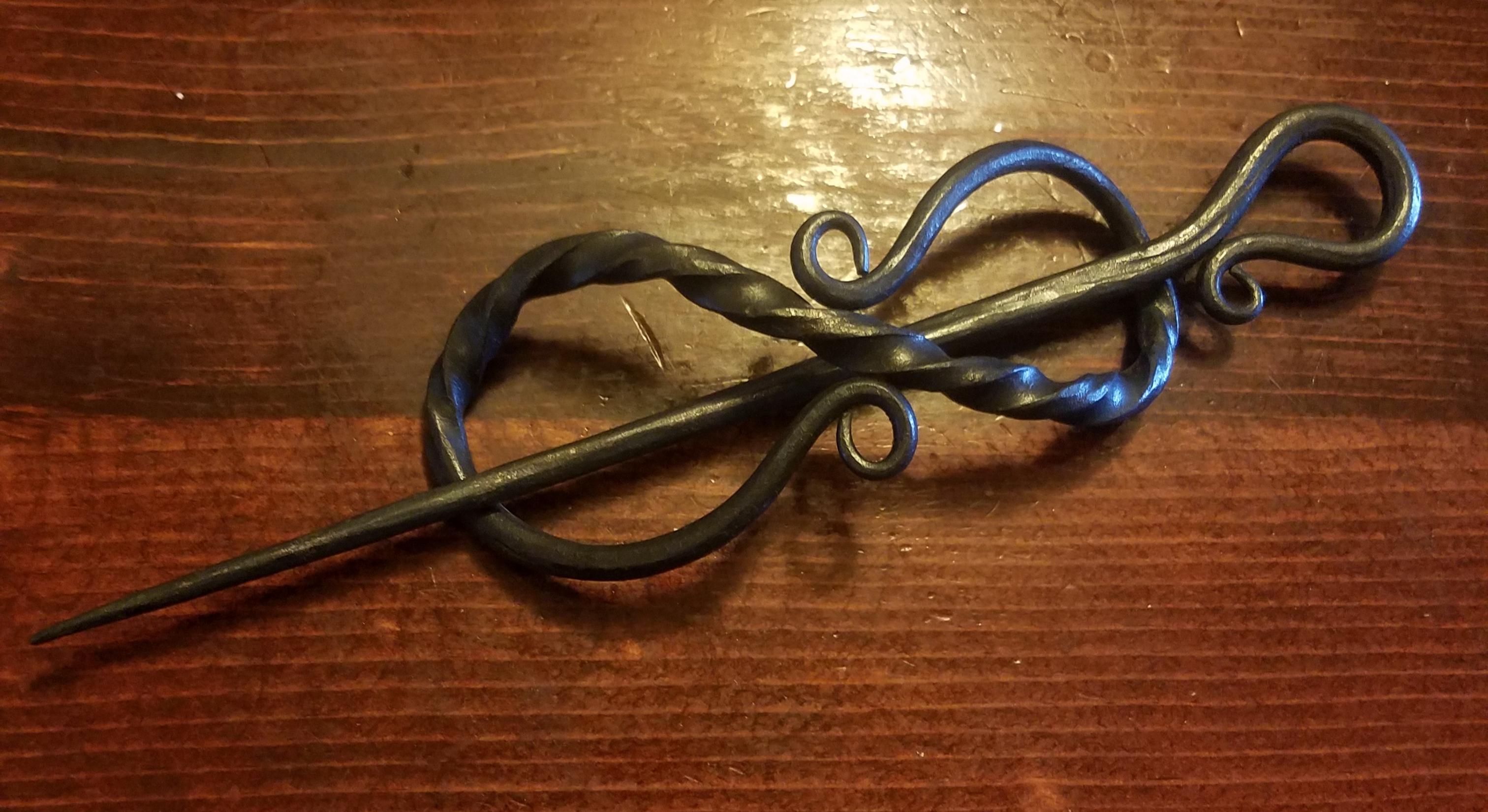

CrazyGoatLady Posted November 5, 2019 Share Posted November 5, 2019 Das, can't wait to see your jellyfish. That should make for an interesting build! Well, here's my thingy for today. Got to get some more stock because I'm getting low. This was made from some odd rectangular shaped stuff. Took it down to round. I didn't really have a plan, just needed some practice time. I think the pin is too long. Took advice from Goods, and made a more centered eye. One side of the clip is wider. Got some flats on the twist. Hammer work is not nearly as finished as I'd like. But this is my second one, so I'll get it eventually. If anyone has any advice, I'm open. Thanks for looking and great day everyone. Quote Link to comment Share on other sites More sharing options...
