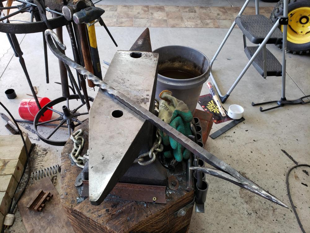

killbox21 Posted July 27, 2019 Share Posted July 27, 2019 (edited) Took a break from knife making and made a fire poker today. Edited July 27, 2019 by Mod30 resize large photos Quote Link to post Share on other sites
SFC Snuffy Posted July 27, 2019 Share Posted July 27, 2019 Nice! I like the texture down the length of it. Is that 1/2" HR? Quote Link to post Share on other sites
killbox21 Posted July 27, 2019 Share Posted July 27, 2019 Got a bunch of metal staircase spindles from a house that burnt down. 1/2 inch or 5/8 I'll measure later. It's pretty tough stuff to beat on. Quote Link to post Share on other sites
CrazyGoatLady Posted July 27, 2019 Share Posted July 27, 2019 You did a good job of it though. The texturing on it gives it a neat looking aesthetic. Nice work Quote Link to post Share on other sites
Chris C Posted July 27, 2019 Share Posted July 27, 2019 Nice poker.................beautiful anvil. Did I mention I like your anvil? Quote Link to post Share on other sites
killbox21 Posted July 27, 2019 Share Posted July 27, 2019 Thanks guys, I wish I could take credit for the texturing, but it was already on the square stock. I put the twist, loop, and poker part on though. Lol It is a great anvil Chris. Thanks Quote Link to post Share on other sites
CrazyGoatLady Posted July 27, 2019 Share Posted July 27, 2019 Haha ýou still did good Quote Link to post Share on other sites

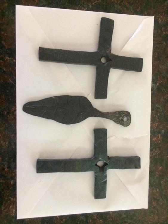

Fowllife Posted July 28, 2019 Share Posted July 28, 2019 Our son is home on leave and wanted to give working some hot steel a try. He made a pair of split crosses and a “leaf”. I think he plans on attaching some cord and giving them to his grandma before he goes back. It was nice to teach him a little of what I have learned over the last few months. Quote Link to post Share on other sites

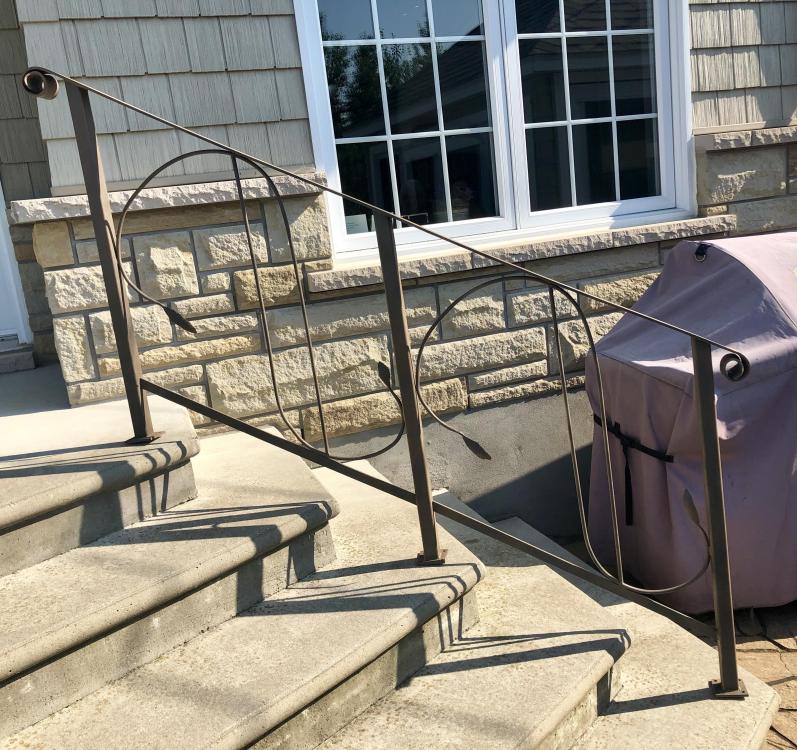

blacksmith-450 Posted July 28, 2019 Share Posted July 28, 2019 Finished it today ! Quote Link to post Share on other sites

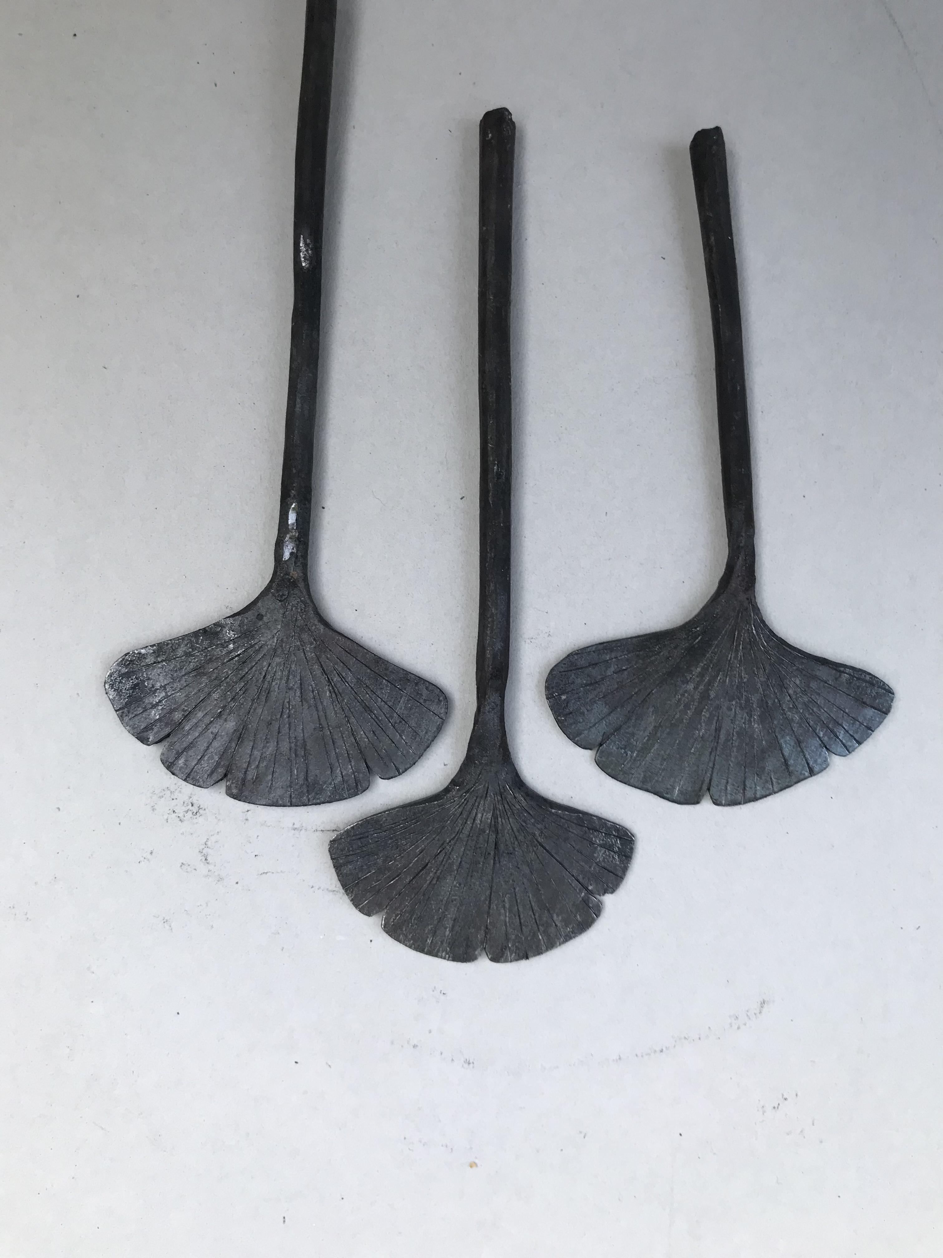

Goods Posted July 29, 2019 Share Posted July 29, 2019 Made a few more ginkgo leaves for a lamp project I’ve been working on... 18 down out of 51 needed. Also, finally finished the heat treatment on a hardy cold cut and started my first attempt at a basket twist. (Sorry about the image sizes, can’t seem to figure out how to reduce the size on this iPhone...) Quote Link to post Share on other sites
jlpservicesinc Posted July 29, 2019 Share Posted July 29, 2019 Love the ginko leaves.. also the other forged bits.. I'd suggest you make the cutting edge of the hardie narrower.. the extra width is great when you need the extra support of the cutting edge but it will make cutting a bar much more difficult. If you are cutting alloy or tool steels the extra reinforcement might be needed but for the most part a decent base metal with a full hardening and proper temper will do 99% of the materials used in a smithy. Quote Link to post Share on other sites
