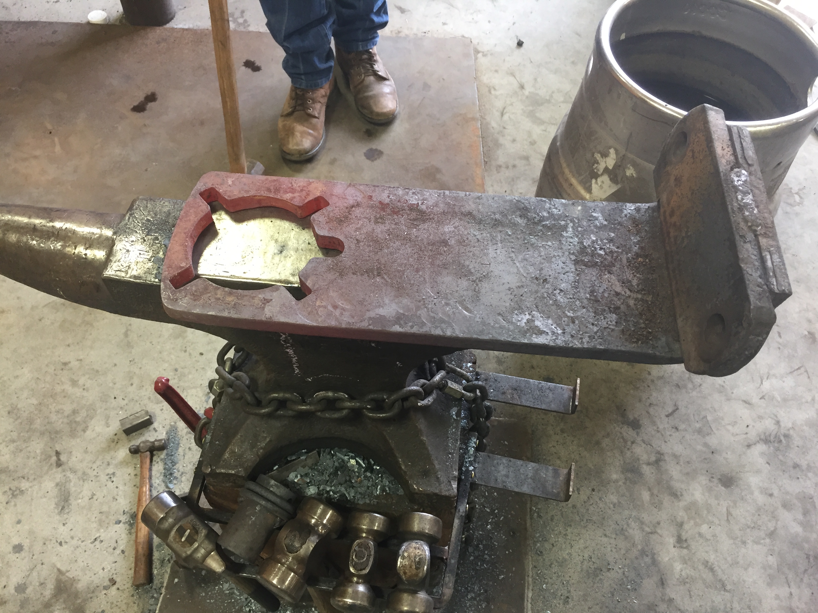

Ranchmanben Posted May 23, 2017 Share Posted May 23, 2017 LBS, that look really good! Tools like center puches are constantly used but I, nor many other smiths, think the embellish them. Nice thinking. Got to take a break from repairing a windmill today to do a little traditional blacksmith work on a modern tool. Straightened out a part for my neighbors plow that was getting re-disked. Largest piece of steel I've hammered on, 3/4"x 6"x not sure how long. It was bent along the entire length. Quote Link to comment Share on other sites More sharing options...

ThomasPowers Posted May 23, 2017 Share Posted May 23, 2017 Ranchmanben; was that piece heat treated any originally? (what was the carbon content of it, I've run across a lot of old implement steel that ranged from 1050 to 1080---back before some of the weird new alloys were used.) Quote Link to comment Share on other sites More sharing options...

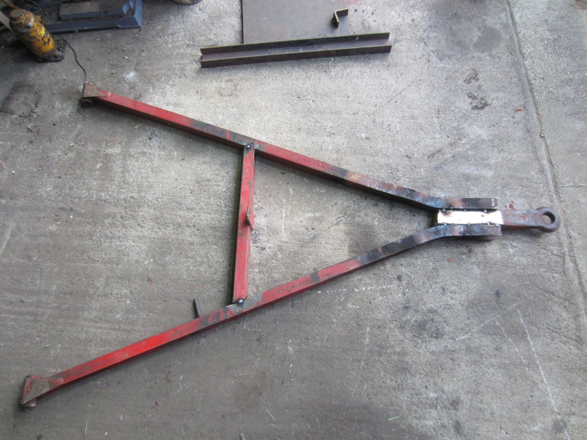

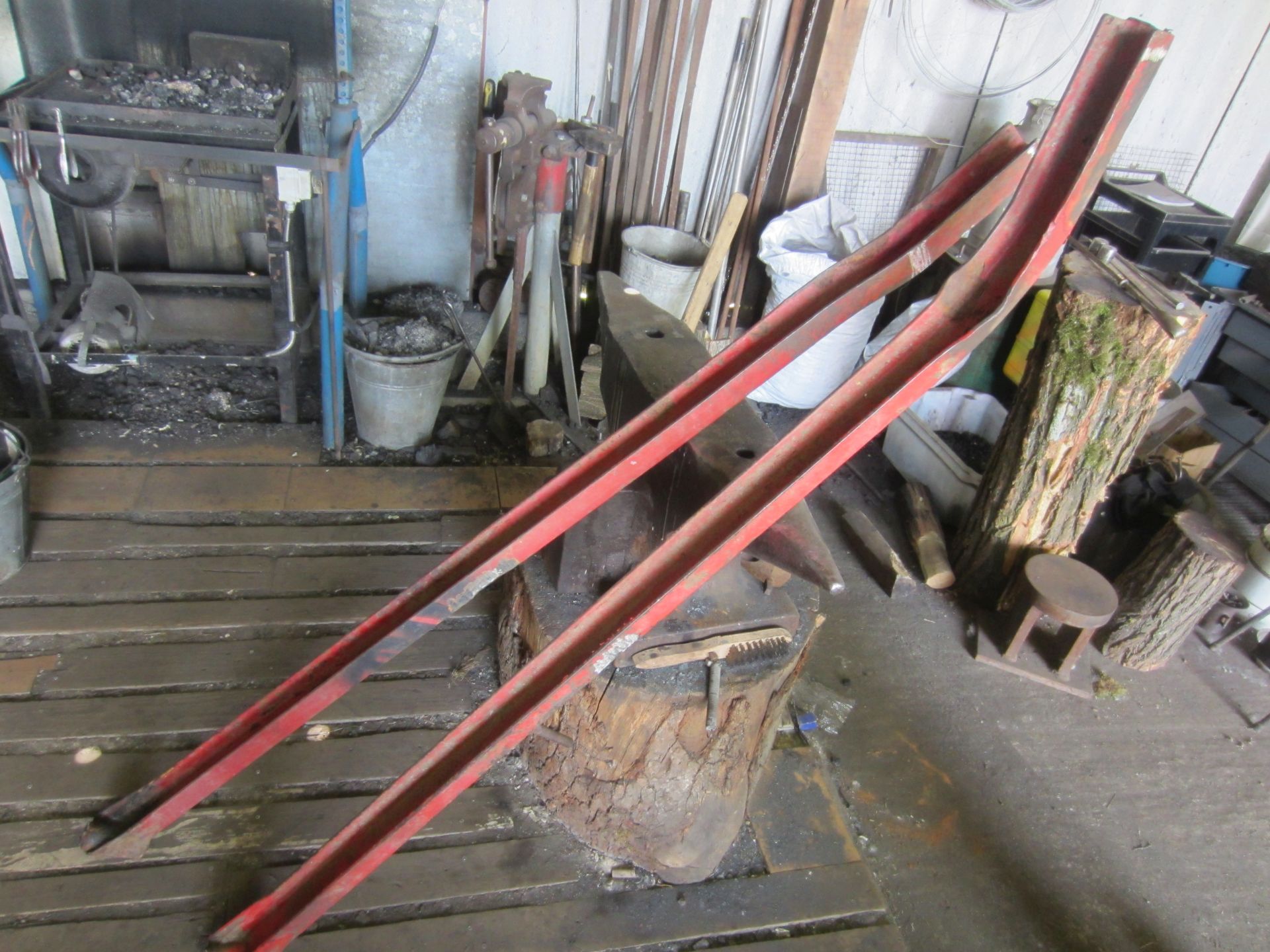

Gergely Posted May 23, 2017 Share Posted May 23, 2017 Not the best for your creativity but these things help pay the bills If anyone recognizes this part in the second picture, please tell me its name. Thanks! Bests: Gergely Quote Link to comment Share on other sites More sharing options...
JHCC Posted May 23, 2017 Share Posted May 23, 2017 Wagon tongue? Quote Link to comment Share on other sites More sharing options...
BIGGUNDOCTOR Posted May 23, 2017 Share Posted May 23, 2017 Tow bar. Quote Link to comment Share on other sites More sharing options...
Alan Evans Posted May 23, 2017 Share Posted May 23, 2017 3 hours ago, Gergely said: Not the best for your creativity but these things help pay the bills If anyone recognizes this part in the second picture, please tell me its name. Thanks! Bests: Gergely 2 hours ago, BIGGUNDOCTOR said: Tow bar. If it is attached to the trailer I would call it a draw bar, if attached to the towing vehicle I would call it a tow bar. Alan Quote Link to comment Share on other sites More sharing options...
Frosty Posted May 24, 2017 Share Posted May 24, 2017 I'd call it a draw bar, it's awfully light looking to be a tow bar. A tow bar has a lot more leverage working on it every time a turn is made. A wagon tongue would be another possible name for it. Frosty The Lucky. Quote Link to comment Share on other sites More sharing options...
Ranchmanben Posted May 24, 2017 Share Posted May 24, 2017 7 hours ago, ThomasPowers said: Ranchmanben; was that piece heat treated any originally? (what was the carbon content of it, I've run across a lot of old implement steel that ranged from 1050 to 1080---back before some of the weird new alloys were used.) I suspect it was mild steel and not heat treated. I did a spark test on it and compared it to a few samples and the Sparks were closest to some hot rolled mild steel. Also, the way it was bent in multiple places makes me think it was mild. After forging I let if cool off for 15 minutes or so before I quenched it. I guess I'll find out this fall, when he sows in wheat, if the repair worked. It wasn't a terribly old disk, 30yrs or so. Quote Link to comment Share on other sites More sharing options...
Gergely Posted May 24, 2017 Share Posted May 24, 2017 1 hour ago, Frosty said: I'd call it a draw bar, it's awfully light looking to be a tow bar. A tow bar has a lot more leverage working on it every time a turn is made. A wagon tongue would be another possible name for it. Frosty The Lucky. Thank you Gentlemen! I'd go with draw bar then . It's between the tractor and its trailer. Although it's big and heavy it wasn't made for sideways pressure, that's why it's deformed. (And heavy is a bit relative when there is a full loaded trailer connected to a tractor, isn't it?) Bests: Gergely Quote Link to comment Share on other sites More sharing options...

Daninghram Posted May 24, 2017 Share Posted May 24, 2017 Here they are called a "Stiff Hitch" Quote Link to comment Share on other sites More sharing options...

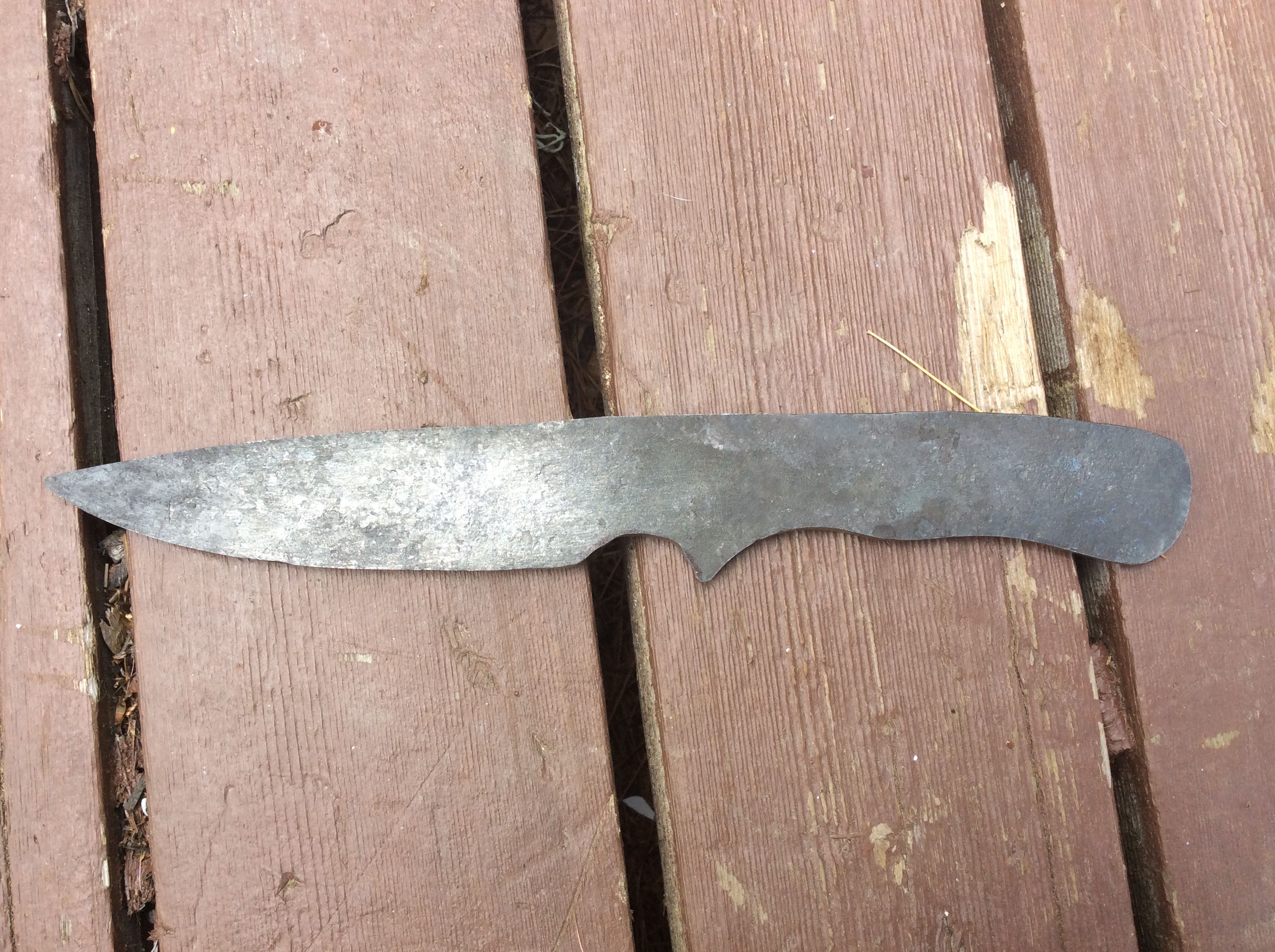

Dylan Sawicki Posted May 24, 2017 Share Posted May 24, 2017 Made some progress on a knife I've been working on. It's looking really cool so far. Now I just have to decide on wood African black wood or Cocobolo. Quote Link to comment Share on other sites More sharing options...
SLAG Posted May 24, 2017 Share Posted May 24, 2017 Mr. Sawicki,, If you have to make a choice between cocobolo and African Blackwood I strongly suggest that you use blackwood. Cocobolo is a beautiful wood but it will start to darken dramatically over a short time period. Some specimens can turn to almost black, over time, & often lose their figure. African blackwood starts black and stays black. It is an excellent wood and you'll not be disappointed. Regards, SLAG.. Quote Link to comment Share on other sites More sharing options...

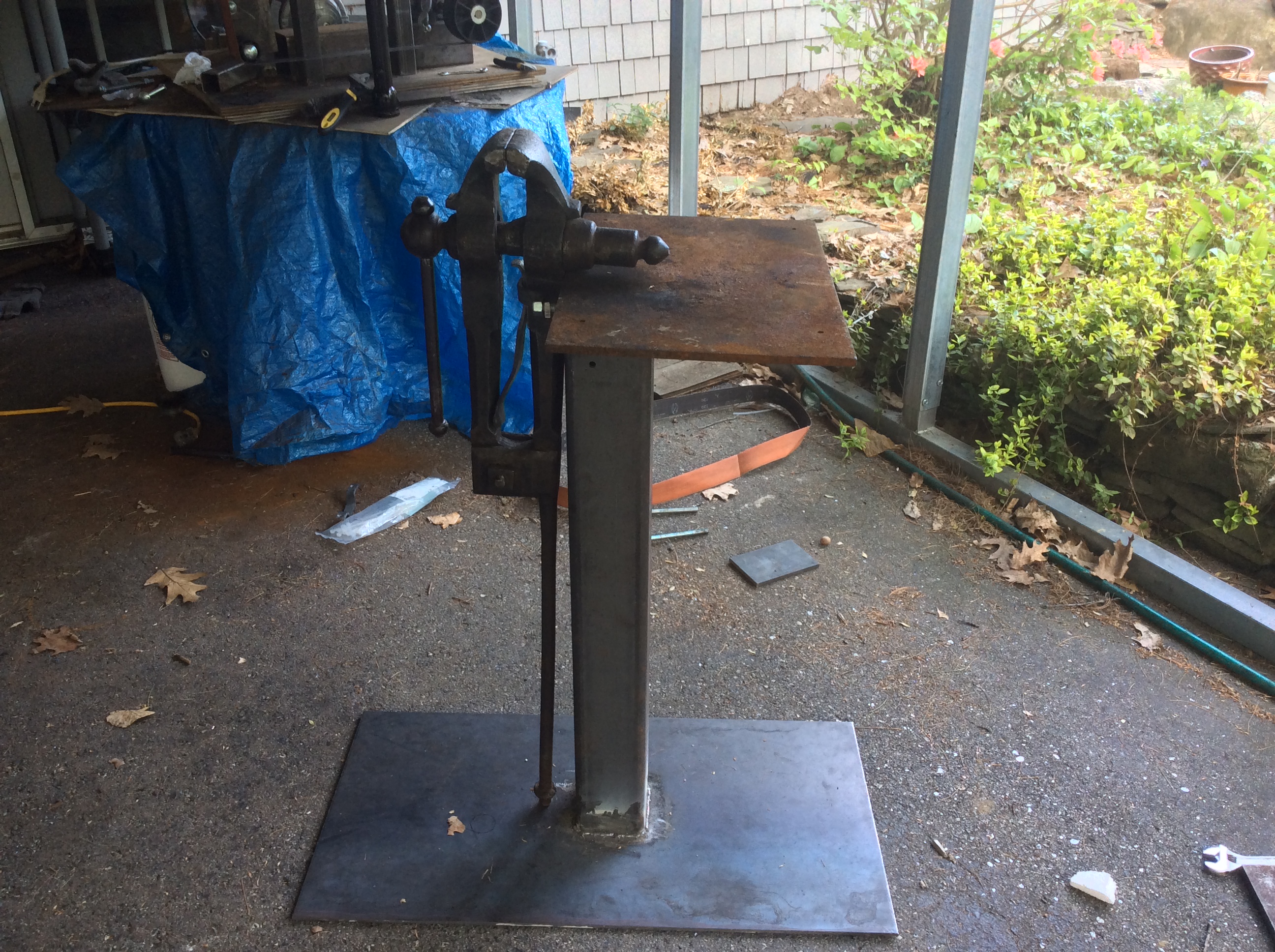

Dylan Sawicki Posted May 24, 2017 Share Posted May 24, 2017 Thanks for the tip SLAG I'll use the African Blackwood that I have. Got some work done on my vise stand its almost done just have to add the top plate. Quote Link to comment Share on other sites More sharing options...
BIGGUNDOCTOR Posted May 24, 2017 Share Posted May 24, 2017 Google "tow bar" and you will get tons of sites selling the units used to tow cars behind RVs. Same basic use as a draw bar. Being a machinist I think of draw bars as the item that draws the collet into a milling machine, or lathe. LB, congratulations! Quote Link to comment Share on other sites More sharing options...

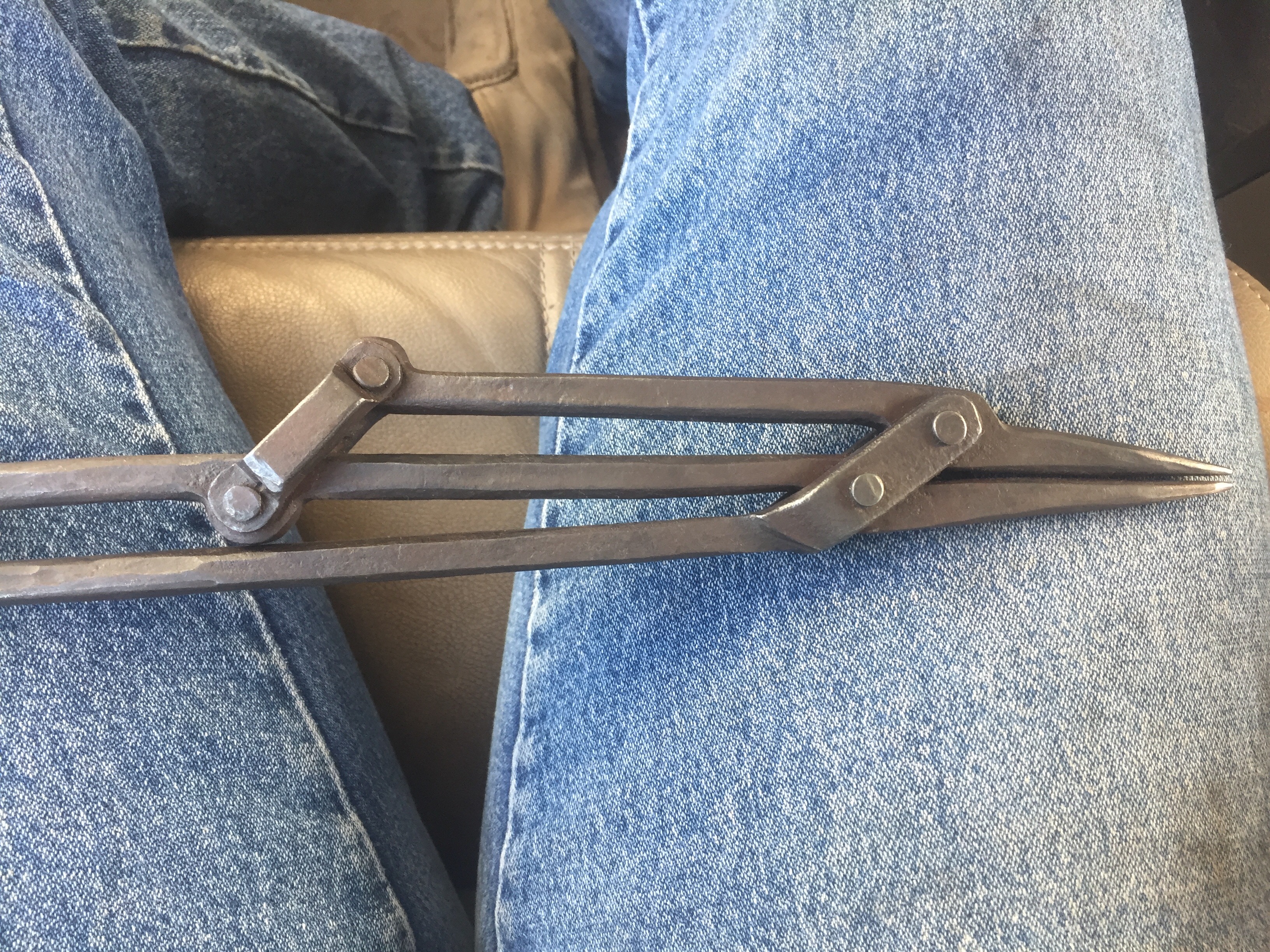

Ranchmanben Posted May 25, 2017 Share Posted May 25, 2017 Yep, more tongs. Quote Link to comment Share on other sites More sharing options...
Allen Gaskill Posted May 25, 2017 Share Posted May 25, 2017 Nice set of parallels. Quote Link to comment Share on other sites More sharing options...
