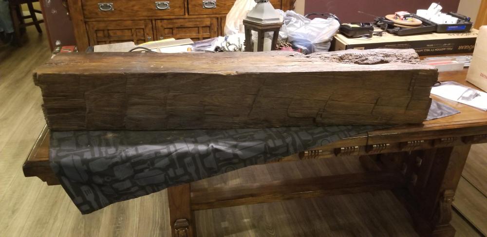

Daswulf Posted February 17, 2019 Share Posted February 17, 2019 Me too. I should be installing them tomorrow evening. Still trying to work out the details. It was a brick fireplace. They are having the beam installed tomorrow and mesh over the brick to be getting stone put over it. Here's the beam when I went for measurements. Front face. Top face. I'd have suggested resin to fill that big divot but they had already loaded it with linseed oil, and I didn't want to complicate things. Still a beautiful old beam. I can't wait to see how these look on it. Quote Link to comment Share on other sites More sharing options...
Cincinnatus Posted February 17, 2019 Share Posted February 17, 2019 Now I see what you mean about a pain without a brake! Once you see the beam you realize how big the brackets are. Quote Link to comment Share on other sites More sharing options...

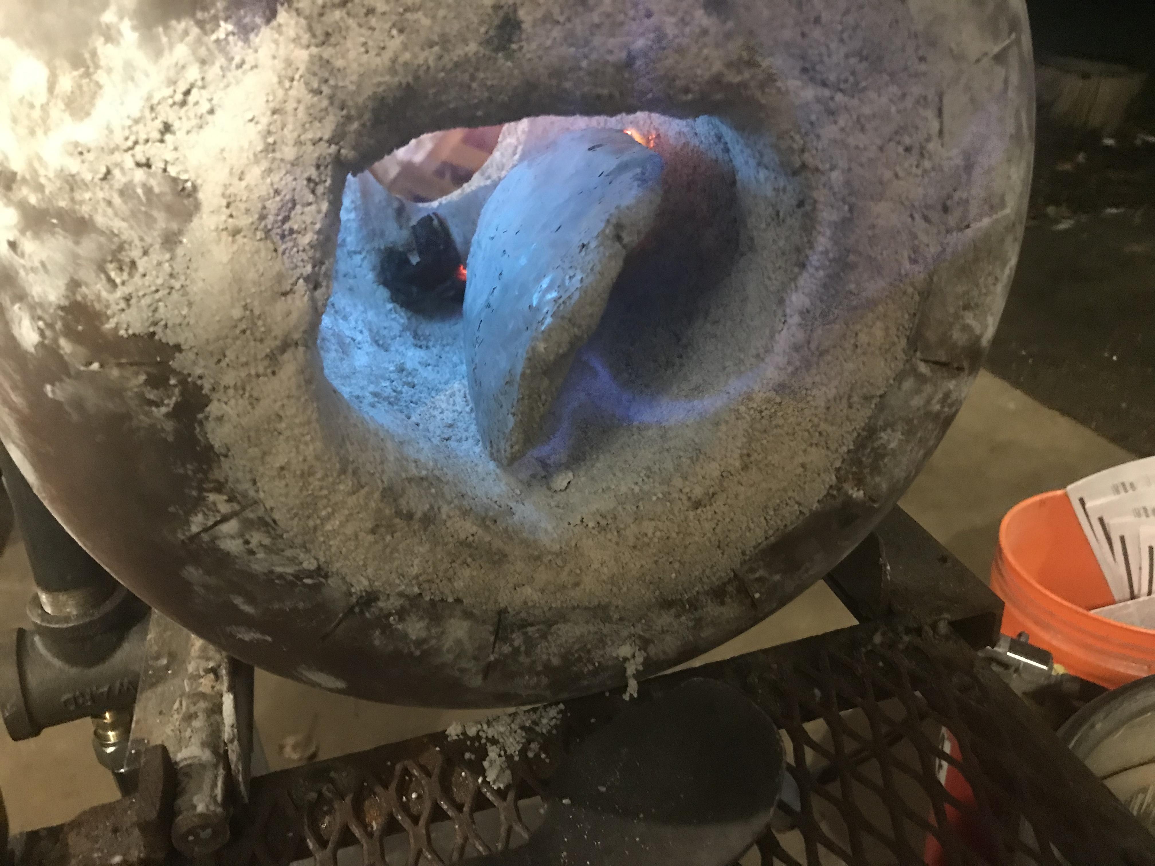

JHCC Posted February 18, 2019 Share Posted February 18, 2019 Got the gasser up to ~15psi without significant issues. Did have a few crumbs of Kastolite shedding off the inside surface, but what remains seems solid enough. I took the opportunity to turn four feet of 3/8” round into 1/4” x 7/16” for a project I’ve had in mind. Worked very well, despite my anvil being cold. Quote Link to comment Share on other sites More sharing options...

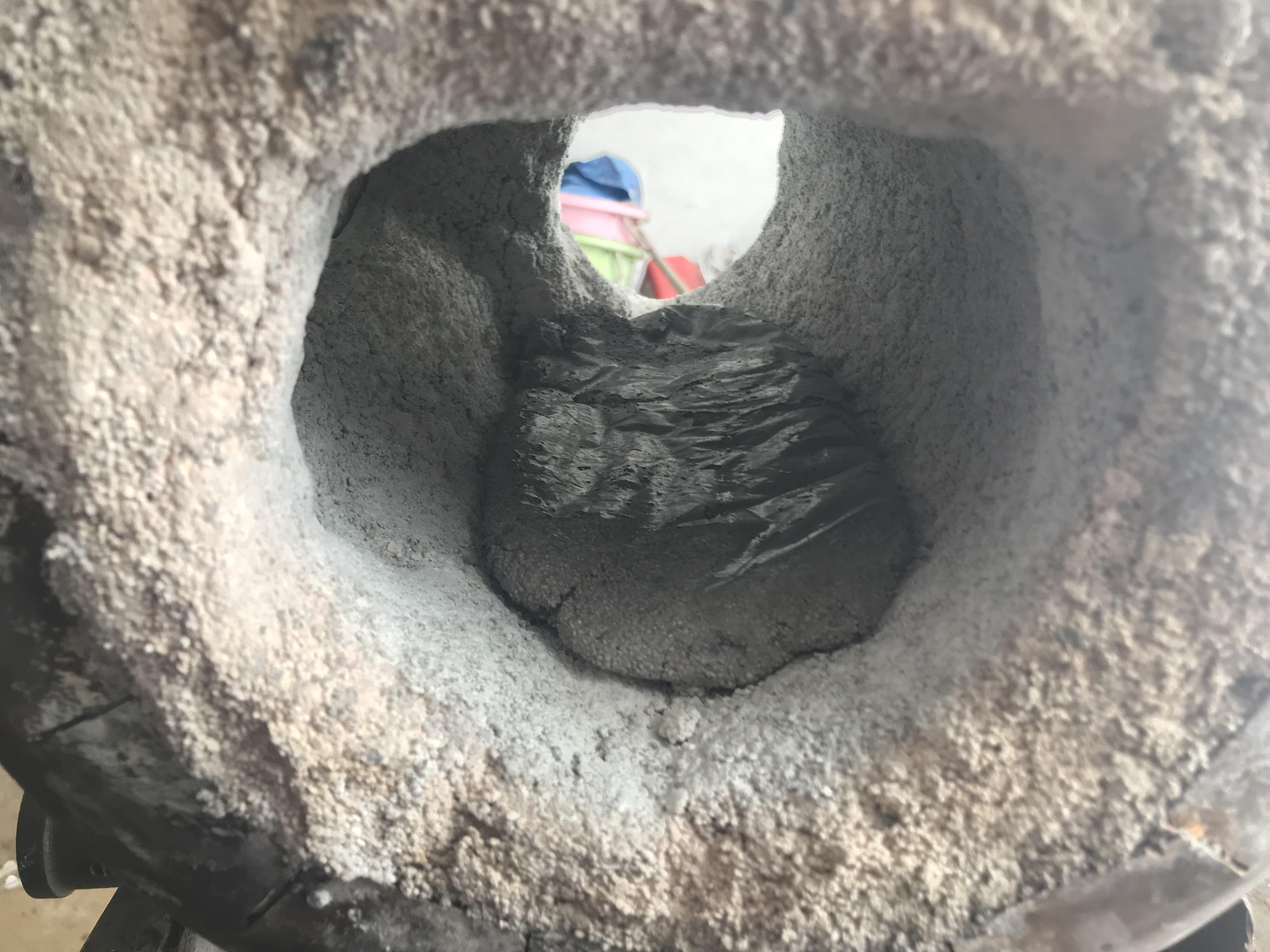

JHCC Posted February 19, 2019 Share Posted February 19, 2019 Looking good! (And a good place to hang the Christmas stockings!) I didn’t have any real shop time today, but did grab a minute to try something. I had the idea to make a little Kastolite “tile” as a replaceable floor for the gas forge, so I put a pound and a half of the dry mix in a gallon freezer bag with 4-1/2 oz. of water, kneaded it until mixed, and then plopped it in the bottom of the forge and pressed it into shape. When it’s hardened, I’ll take it out of the bag and fire it in the forge. If it works, I can use it as a consumable protection against welding flux. (Quite possibly a waste of time and material, but a fun experiment nonetheless.) Quote Link to comment Share on other sites More sharing options...
Daswulf Posted February 19, 2019 Share Posted February 19, 2019 Thanks John, that was one reason she wanted them. She had mentioned her idea initially to put a bar through the loops to hang stockings from. I made the bracket that holds the loop deep enough (with enough offset to hold the loops forward) to be able to push the loops back and install a bar through. With some loop hooks to slide on the bar it will hold a bunch of stockings nice and secure. She liked the idea and it will be a future commission. Thats a lot of loops... ugh.. I'm going loopy. Like the forge floor idea. If it works and I ever build one consider the idea borrowed. Quote Link to comment Share on other sites More sharing options...
Frosty Posted February 19, 2019 Share Posted February 19, 2019 Too late Das, you've been loopy since I've known you. Love the mantle brackets can't wait for the close ups. Good idea for making a forge floor John. It's not going to be a disposable, not really, Kastolite laughs at hot flux. I didn't do anything IN the shop today. It's been snowing a couple days for about 7". Does plowing snow from around the shop count? Frosty The Lucky. Quote Link to comment Share on other sites More sharing options...

JHCC Posted February 20, 2019 Share Posted February 20, 2019 Unwrapped the Kastolite “tile” for the forge floor: Quote Link to comment Share on other sites More sharing options...
Mudman Posted February 21, 2019 Share Posted February 21, 2019 Coming along nicely jhcc. Quote Link to comment Share on other sites More sharing options...

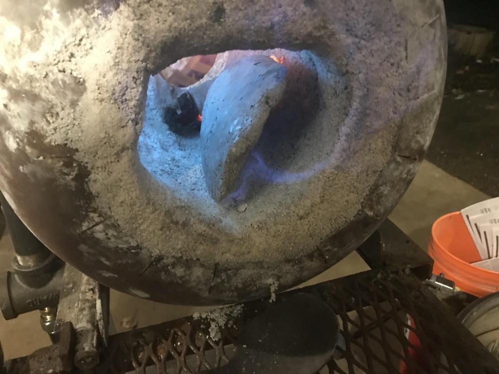

JHCC Posted February 22, 2019 Share Posted February 22, 2019 Fired the Kastolite “tile” in the forge. All done (still warm). Quote Link to comment Share on other sites More sharing options...
Frosty Posted February 22, 2019 Share Posted February 22, 2019 Good idea John, I like it. I never thought of forming Kastolite in a plastic bag that way and I routinely mash burgers in aluminum foil. Guess I need to think more outside the bun eh? Frosty The Lucky. Quote Link to comment Share on other sites More sharing options...
