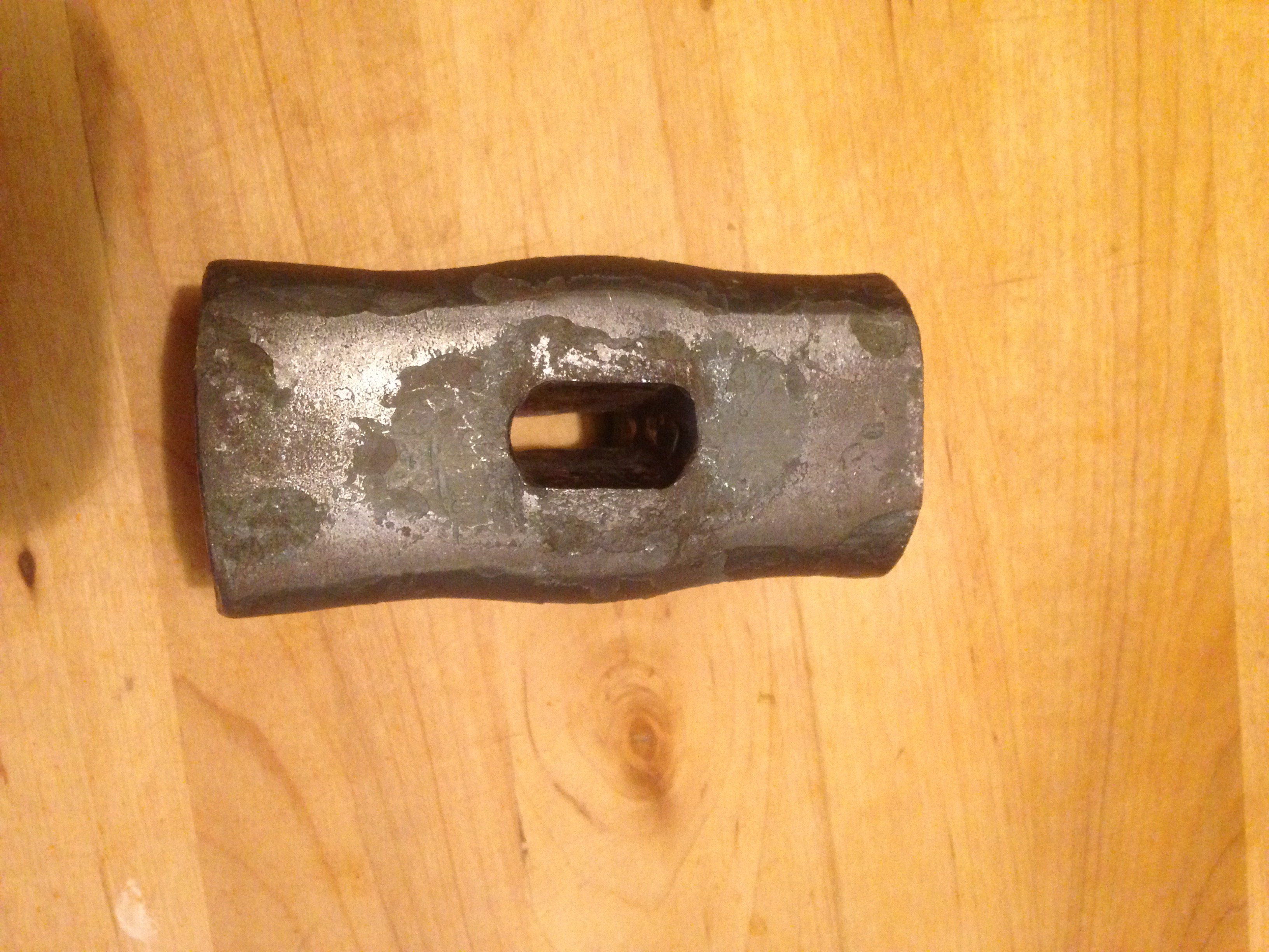

Judson Yaggy Posted May 6, 2017 Share Posted May 6, 2017 Mostly boring fab work this week but it pays the bills. Did have time today for a run of tongs, an array of various sized handles, and when my son got home from school we started on a new x pein hammer for him. Tongs start as 5" of 5/8" round. One heat (per piece) under the power hammer to rough the jaw and boss, one heat with hand hammer and anvil to refine the shape, third heat under the fly press to add a v-grove to the jaws, and a final heat to draw the reins. Pictured took me 1 hour 10 min. The hammer will probably finish as a 3.25# cross pein. Started as 2" round 4140, we are doing all the work by hand (my son as striker) at the anvil, no power hammer, as a learning exercise for him (and for me too if I'm going to be honest about it. I work alone in the shop so often that I forget the flow of work done without power tools!) Quote Link to comment Share on other sites More sharing options...
