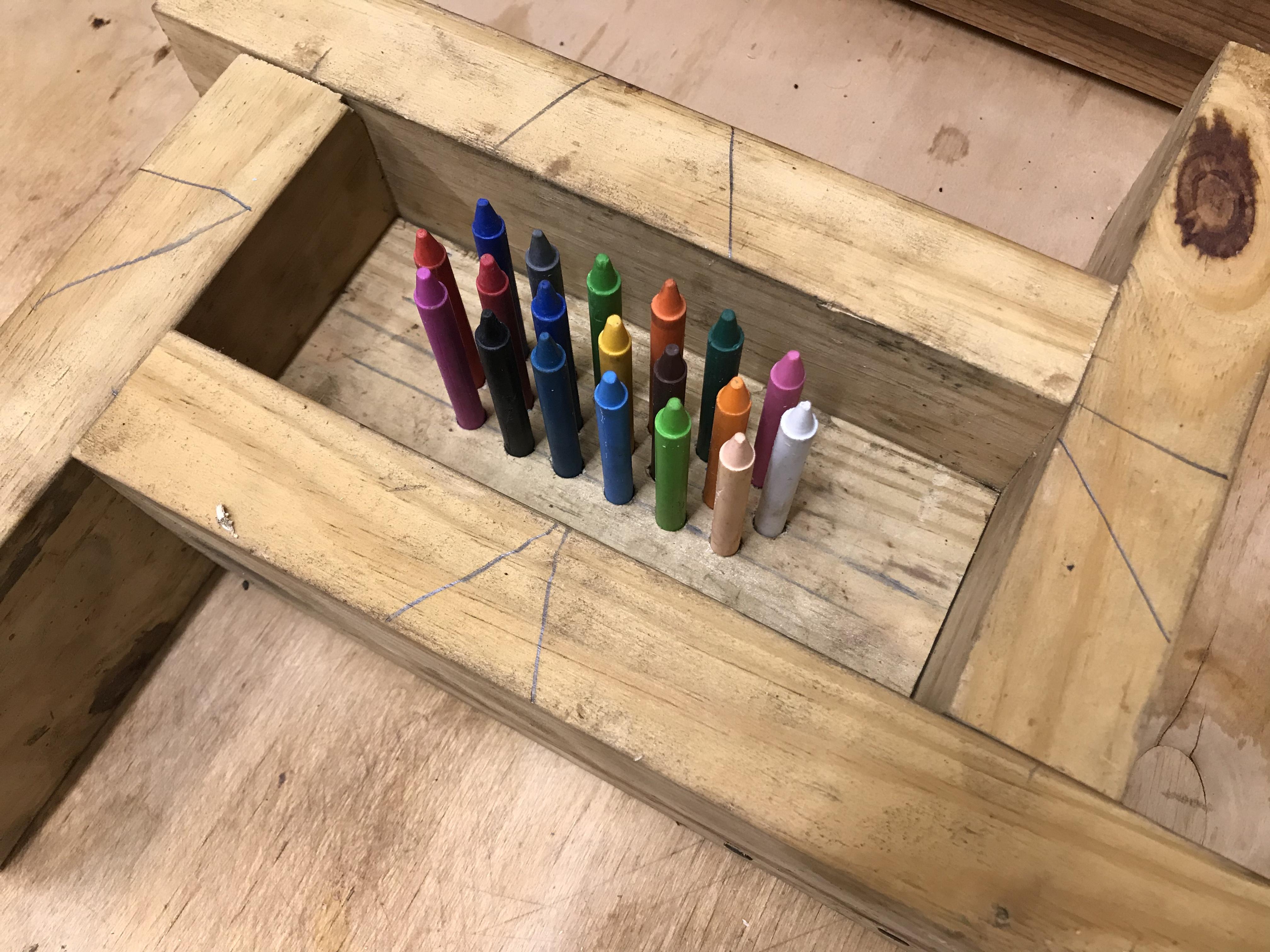

JHCC Posted February 2, 2019 Share Posted February 2, 2019 On 2/2/2019 at 12:07 AM, pnut said: I should be more specific. What did you use for the holes in the castable? Crayons. Here’s the mold before the pour: I took the twin precautions of peeling off the paper wrappers and coating them with cooking spray before adding the refractory. Quote Link to comment Share on other sites More sharing options...
pnut Posted February 2, 2019 Share Posted February 2, 2019 The cooking spray as release agent sounds like a great idea. Does the refractory create a weak exothermic rreaction or does it dry by a different process. I realize it can't be producing too much heat as the crayons don't melt. The reason I ask is that a slight exothermic reaction would make the crayons warm and easier to release from the refractory. I'm assuming that since you sprayed them there's no exo-reaction but you know what they say about assuming. Quote Link to comment Share on other sites More sharing options...

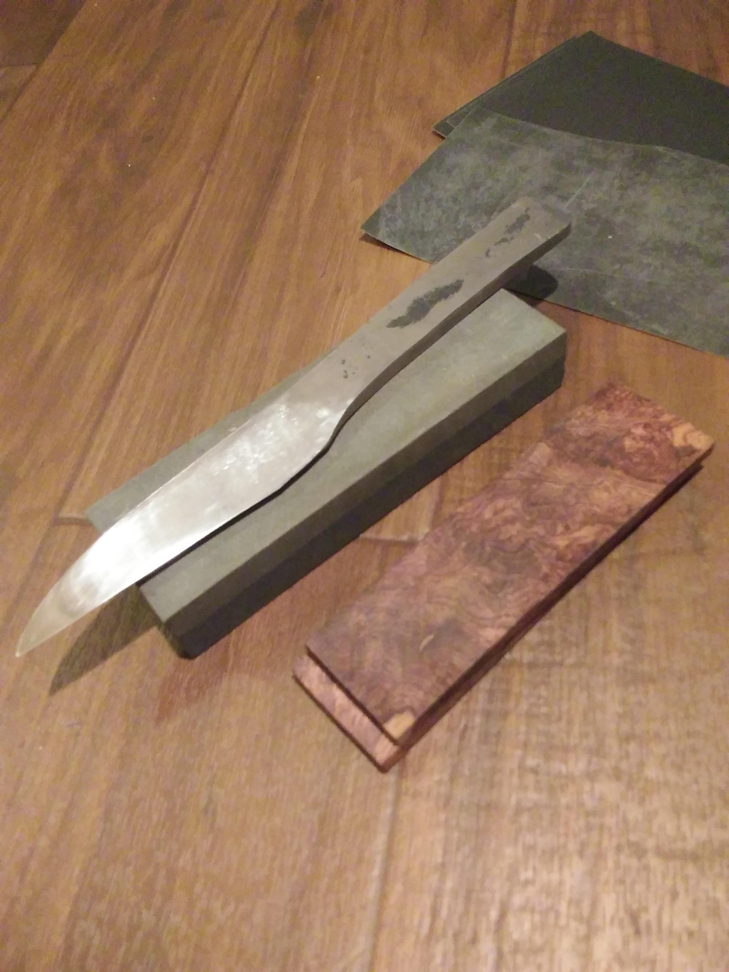

Sly Posted February 2, 2019 Share Posted February 2, 2019 A mini seax type i intend to give as a gift. Iv been putting 15-20 mins each day after my 12 hour graveyard shift... Sharp enough to shave my beard and my tan right off but the finish is gonna take away. Its cru forge v and it thinks the abrasives are a joke but ile keep whittling away at it. Hondoran rosewood scales, gonna do simple cutlers rivets and i still have to make a wax mold for the bolster and melt some copper... Debating skipping that though. Once the blade section is done ile tape it drill the holes and work the tang down on the belt sander. Quote Link to comment Share on other sites More sharing options...

JHCC Posted February 2, 2019 Share Posted February 2, 2019 If there is any exothermic reaction from the curing, I doubt it's enough to make a difference. Even if there is, I suspect any heated components would have cooled to ambient in the recommended 16-24 hour curing time before removing the mold. Quote Link to comment Share on other sites More sharing options...

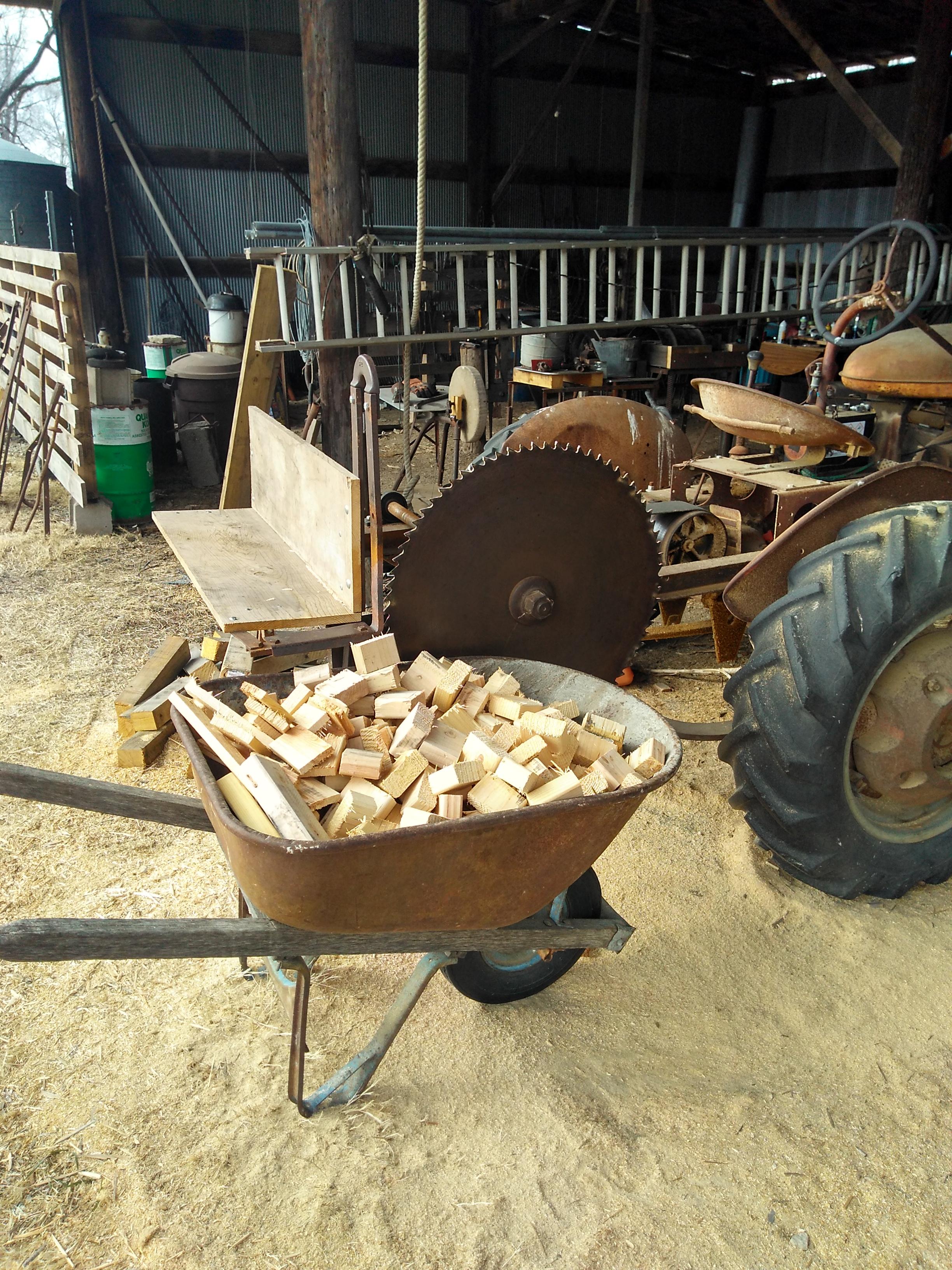

Laynne Posted February 2, 2019 Share Posted February 2, 2019 Step 1 in my charcoal process. Quote Link to comment Share on other sites More sharing options...

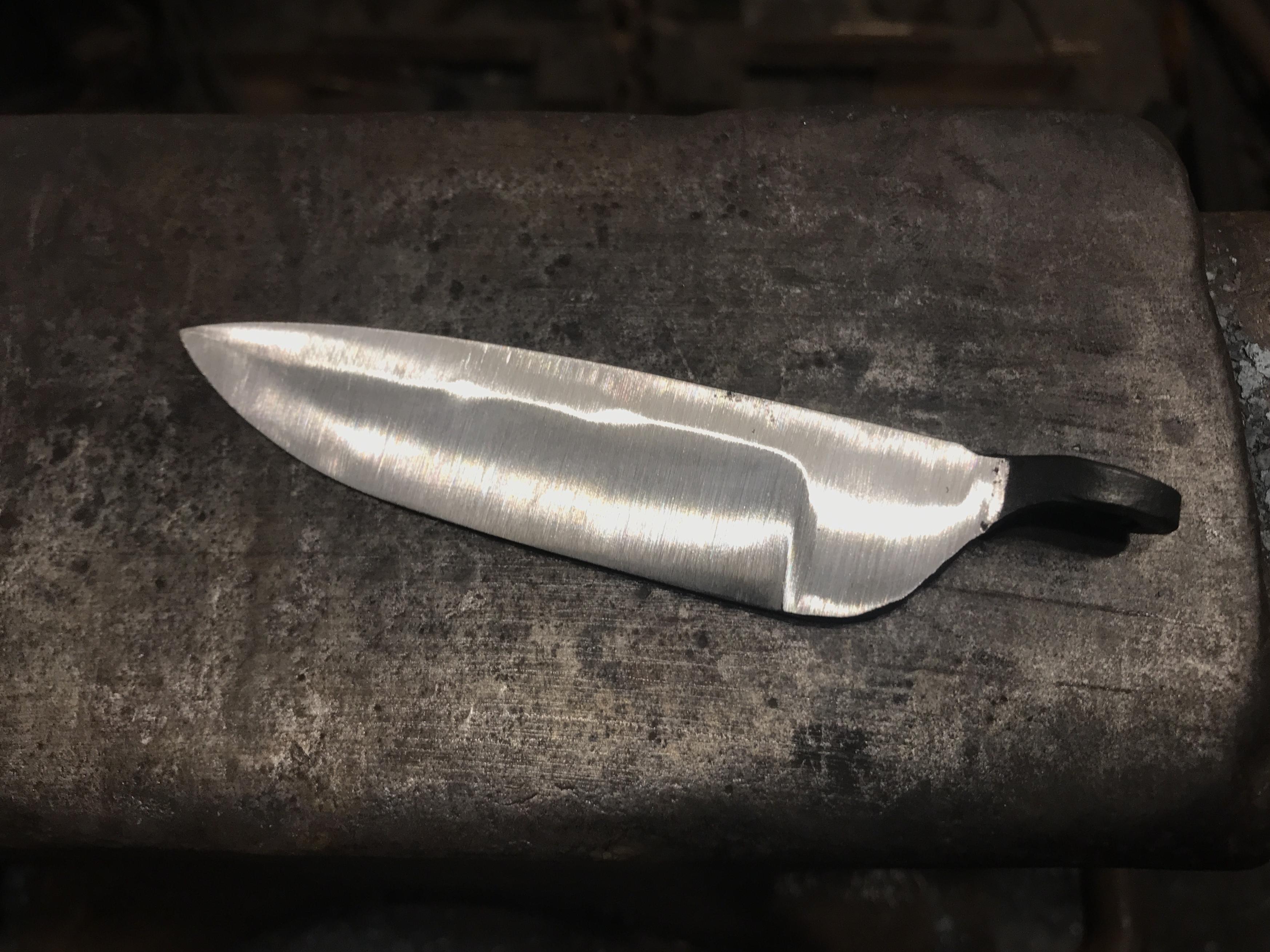

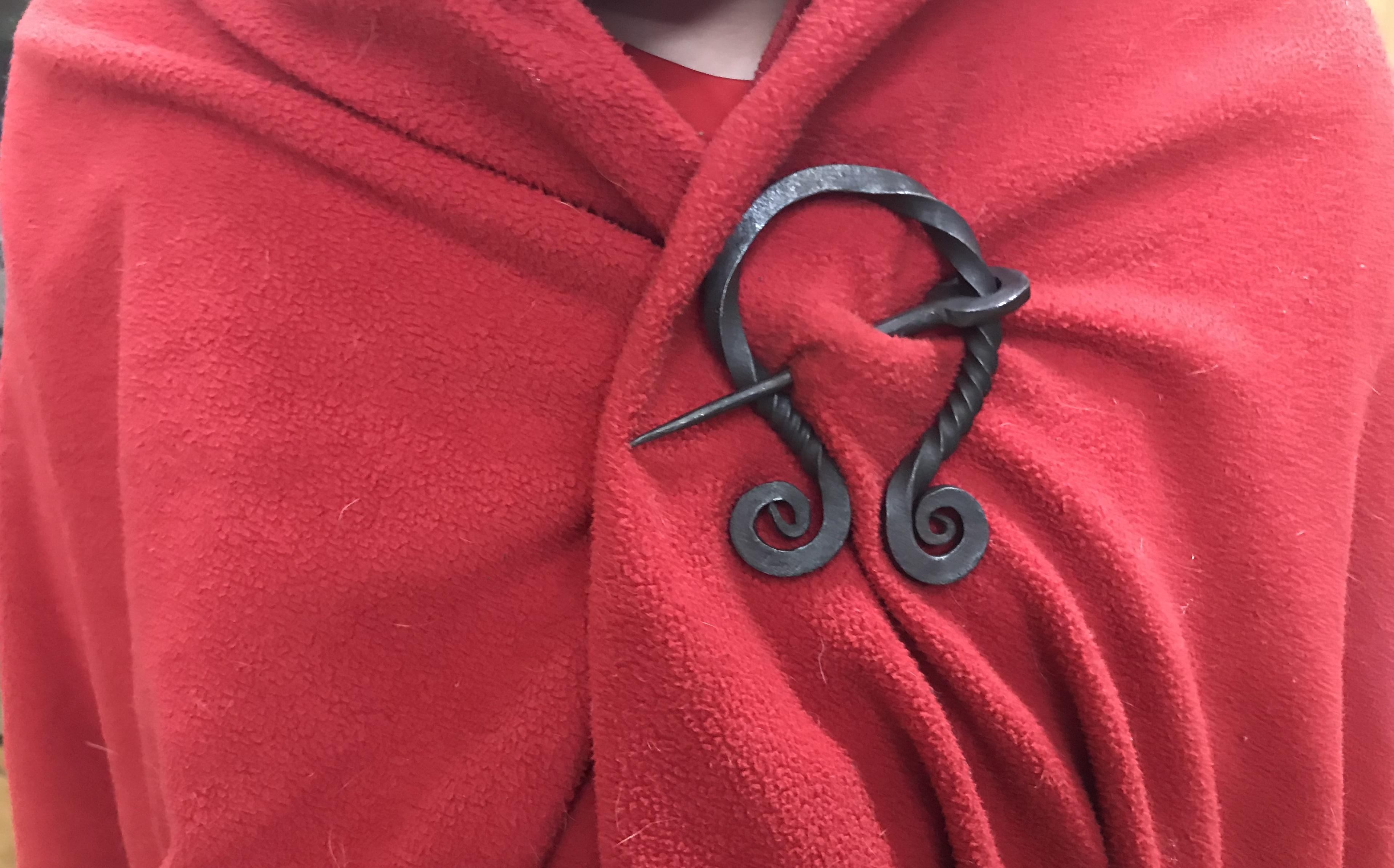

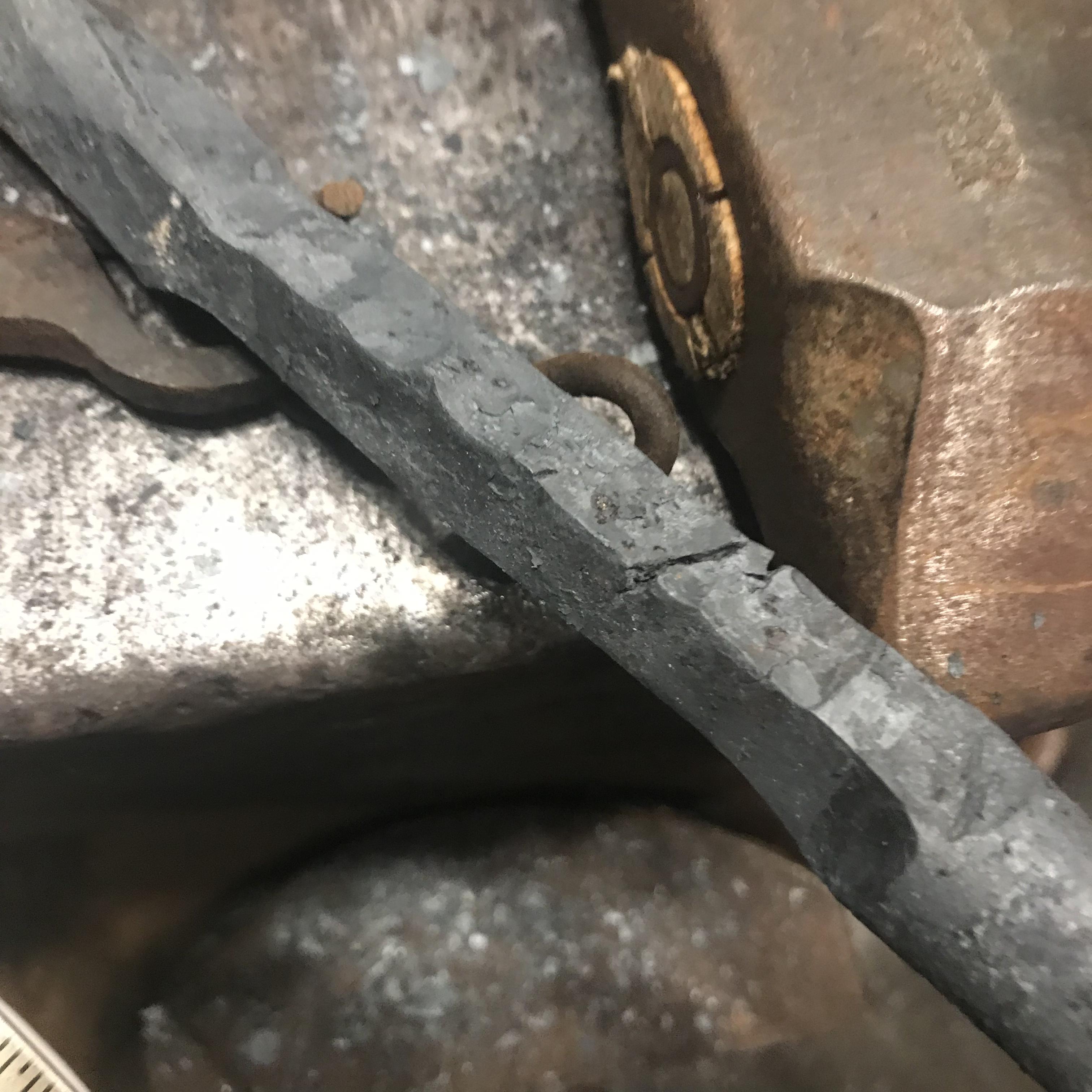

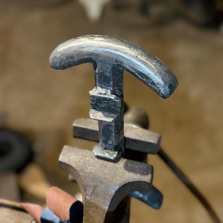

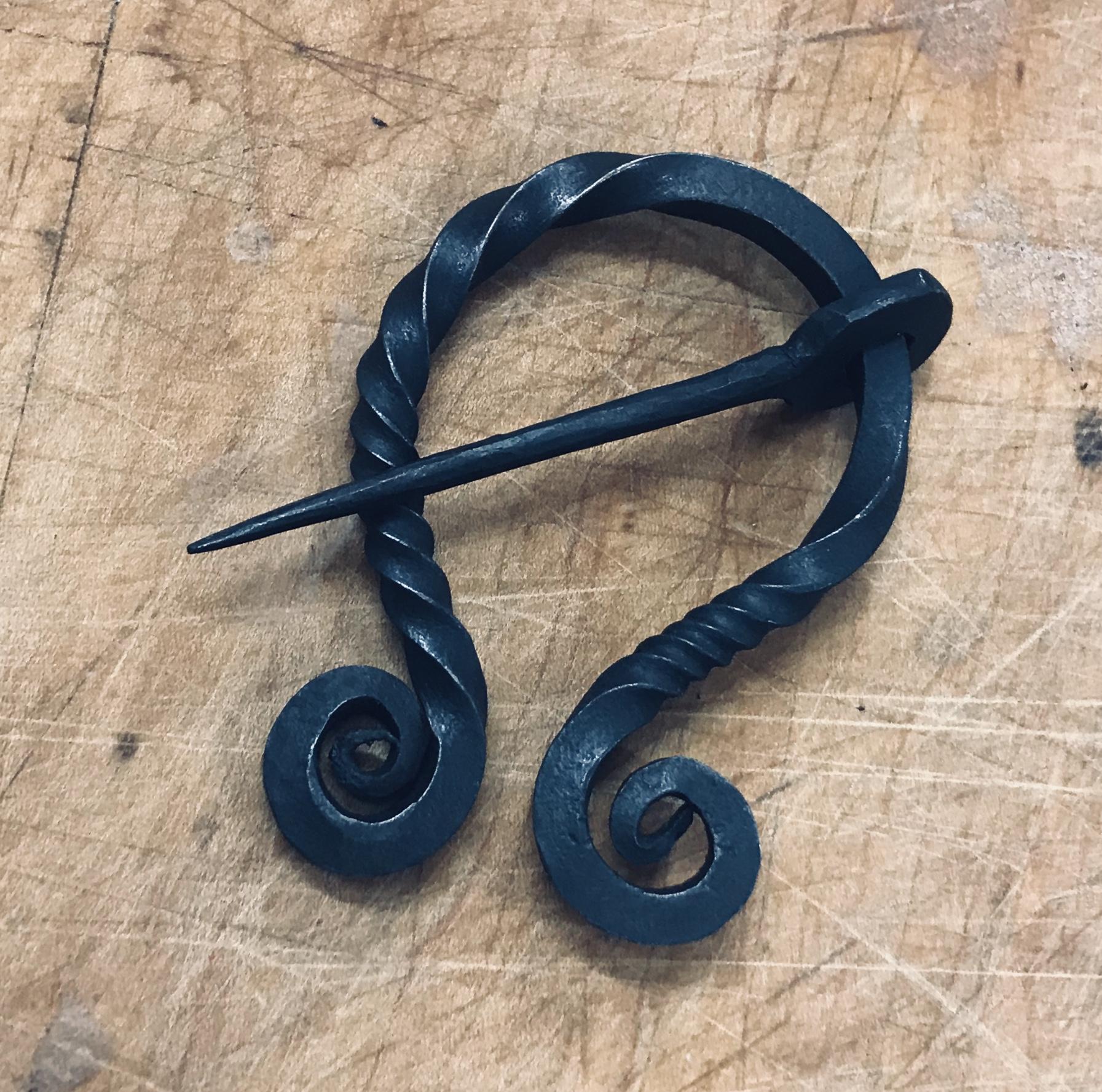

JHCC Posted February 3, 2019 Share Posted February 3, 2019 In addition to forging a couple of bits and pieces for the shop (some more successful than others), I made an annular brooch for Lisa to use as a shawl pin: Also did some bladesmithing, forging the parts for a folder with a 1080 blade. I also started making a blacksmith’s knife out of O1 and learned a valuable lesson about its working range. Change of plans! (I think there’s enough to do a hidden tang.) Quote Link to comment Share on other sites More sharing options...
MaxwellB Posted February 3, 2019 Share Posted February 3, 2019 Very nice JHCC. How heavy is that? I'd be afraid of making something like that too heavy, dragging the fabric or even tearing it. Quote Link to comment Share on other sites More sharing options...

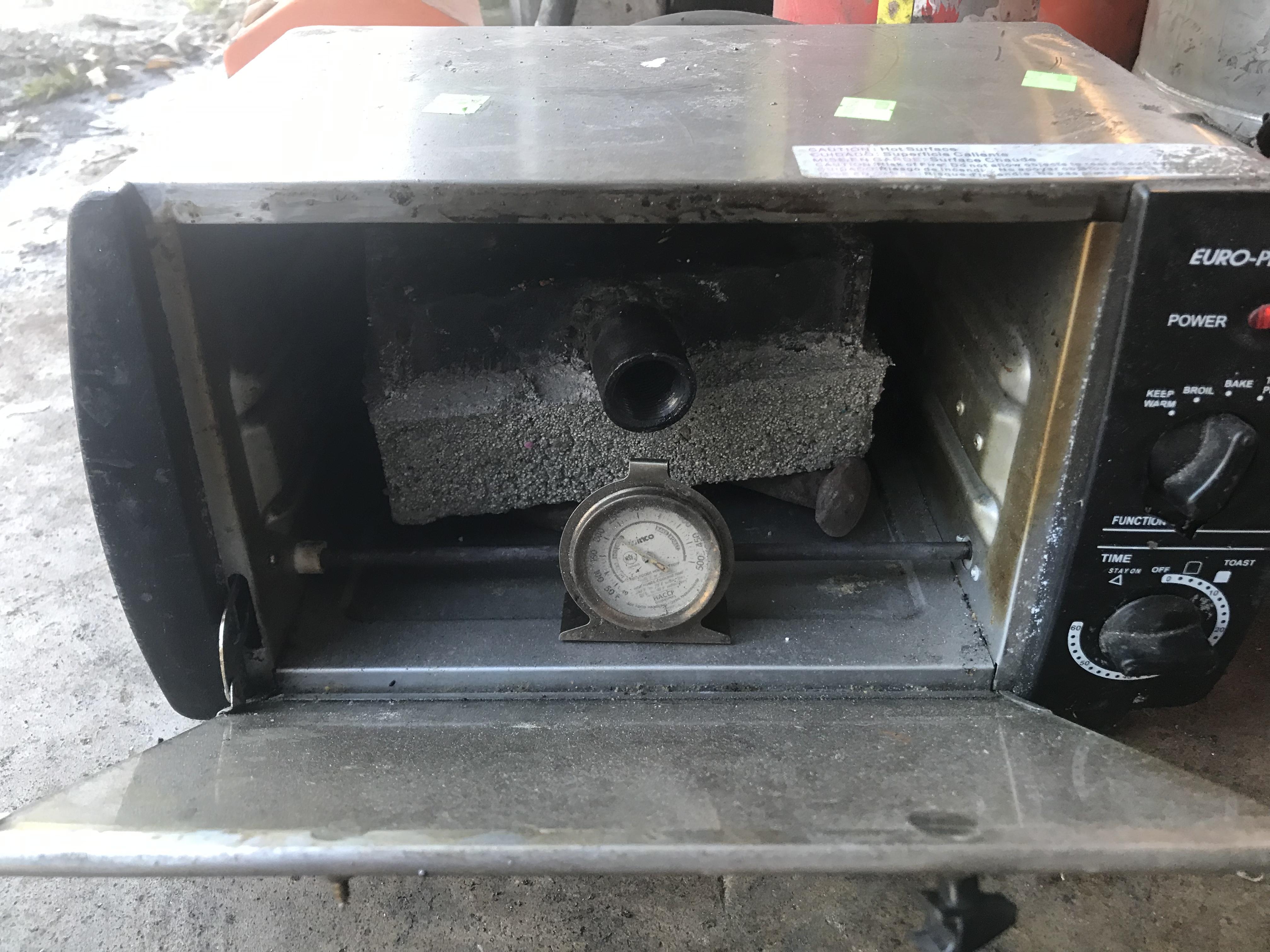

JHCC Posted February 3, 2019 Share Posted February 3, 2019 Unmolded the ribbon burner. The crayons did not release, so I drilled them out. Currently sitting in the toaster oven to get rid of the remaining unbound moisture and melt out any bits of wax. Quote Link to comment Share on other sites More sharing options...

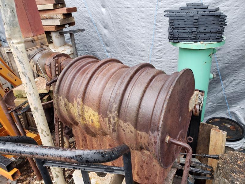

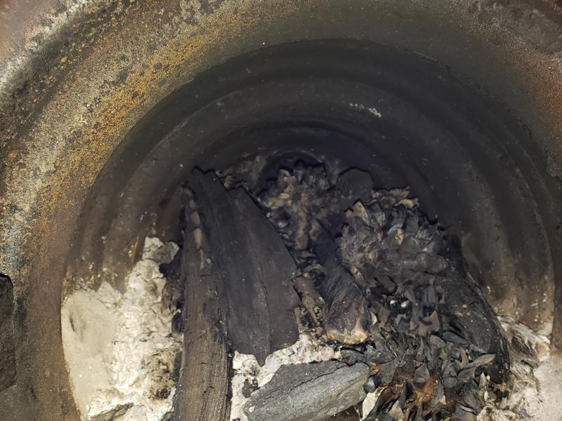

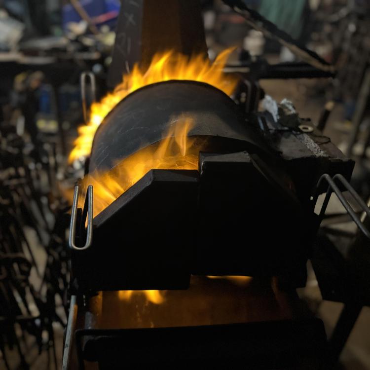

Anachronist58 Posted February 4, 2019 Share Posted February 4, 2019 On 2/2/2019 at 3:03 PM, Laynne said: Step 1 in my charcoal process. Love that PTO Saw!! On 2/2/2019 at 9:50 PM, JHCC said: I made an annular brooch Beautiful work. And looking forward to more on that ribbon burner! On 2/3/2019 at 3:20 AM, Mudman said: I don't trust my 120v flux core welder I have been called worse. I enjoy a good faux pas. What make and model is your welder? There are "tricks". Alas, I must leave home again for the job in Santa Barbara, but over the last few days....... Made charcoal via the Aerobic Method. The pine cones, although not completely charred, are good as-is for forging. It has been raining, but this unit burns wet wood (To clarify for you Wise Guys, I can put soaking wet wood against the chamber walls. It will dry out and ignite without impeding the central burn). The seals, fore and aft, allow me to quickly stop combustion: Installed a pop-up canopy on the shop tent: And added a leg vise to the receiver hitch. This Thread runs so fast, who can keep up with it? Welcome to the Forum, Predator Ink! Robert Taylor Quote Link to comment Share on other sites More sharing options...
jlpservicesinc Posted February 4, 2019 Share Posted February 4, 2019 Robert the more I see of how you operate, the more I like your style.. I the box underneath for the initial heat? Quote Link to comment Share on other sites More sharing options...
Anachronist58 Posted February 4, 2019 Share Posted February 4, 2019 Thanks, JLP, That box was originally intended to be an ash dump, or to install the tuyere at a lower level. Been running the thing off and on for about 20 years (hobbyist level, and it used to heat my shop). I rerun my ashes in it, and it is amazing how little ash has accumulated. This was never (consciously) meant to be a forge, and I have no idea what possessed me to install a tuyere pipe (which is a scrap 4340 steel Boeing 737 thrust reverser piston tube) in the thing in the first place. Maybe I was tired of using a blow pipe in a previous incarnation. As my appetite for forging has grown, my project list has outgrown this unit. I will keep it for melting iron ore from the mountain that I live on. Still trying to find time to track down that spec for square tubing sans the internal weld seam........ any takers? Quote Link to comment Share on other sites More sharing options...

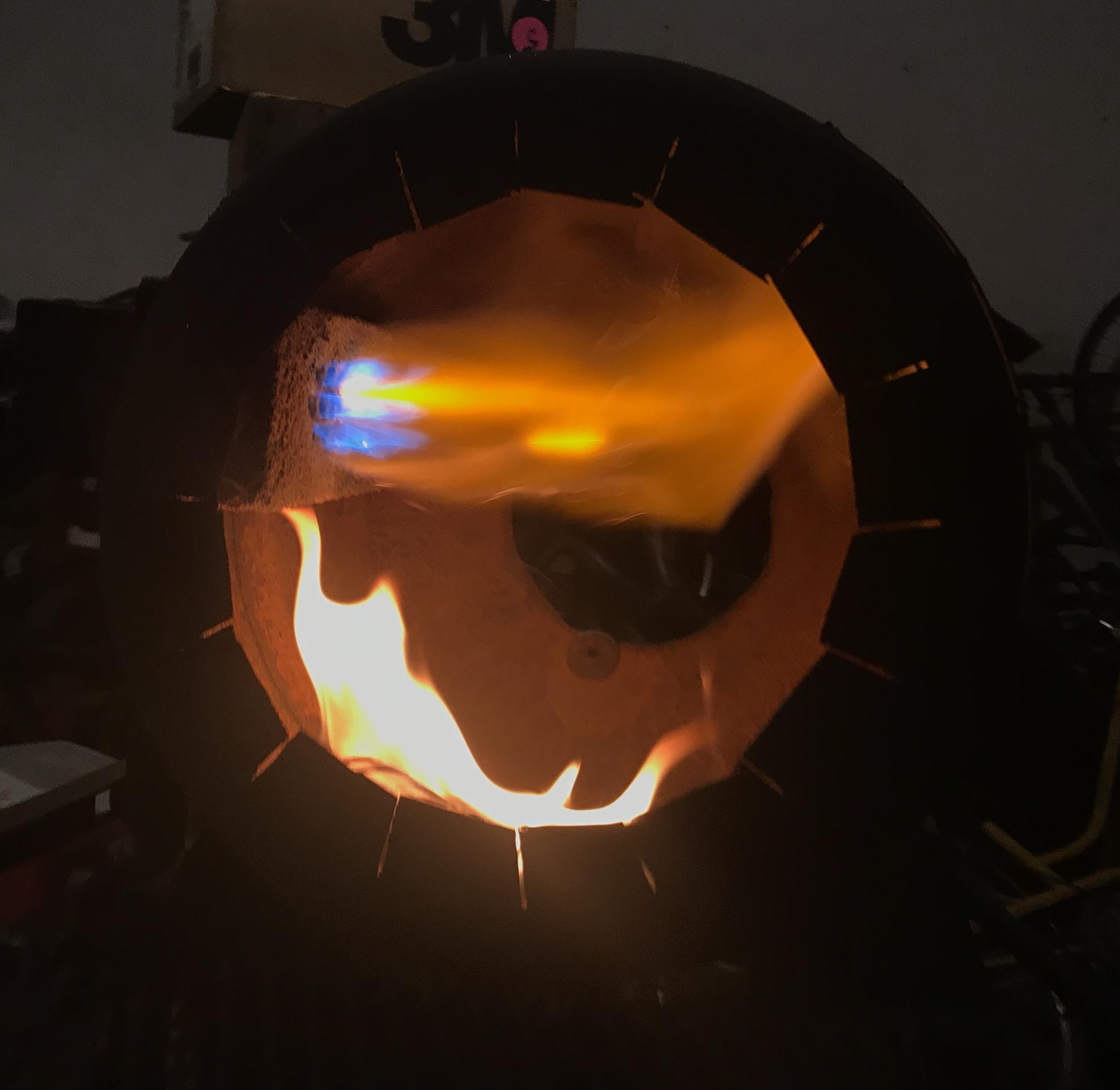

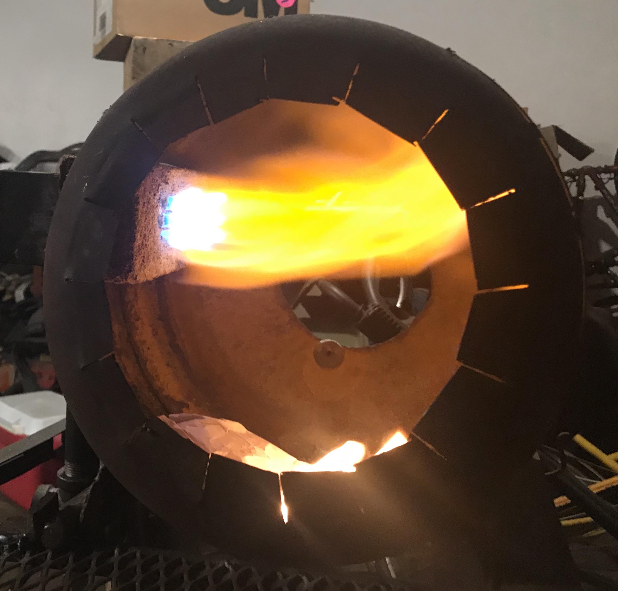

JHCC Posted February 4, 2019 Share Posted February 4, 2019 Did some basic grinding on the blade for a folder: And test-fired the ribbon burner (in an as-yet-unlined forge): (The flame on the bottom is from the lighting paper.) Quote Link to comment Share on other sites More sharing options...

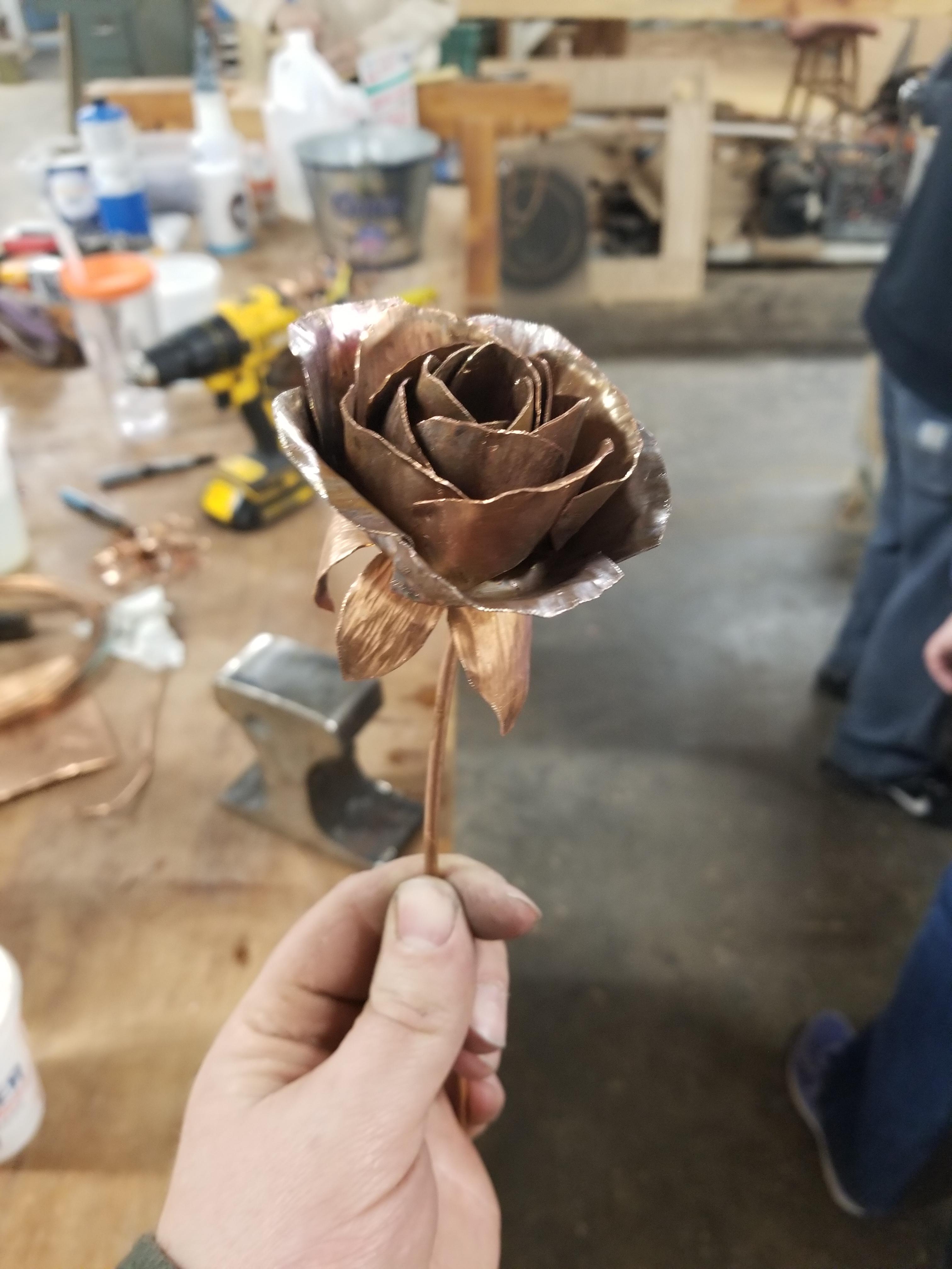

HojPoj Posted February 4, 2019 Share Posted February 4, 2019 Wife and I took a workshop on making a copper rose. Earlier in the day I gave my nephew from Florida a quick intro to making a hook. My sister got in on the action as well, it would seem. Quote Link to comment Share on other sites More sharing options...
Daswulf Posted February 4, 2019 Share Posted February 4, 2019 Haha nice Hoj. Rose turned out great. You can also get some cool heat colors with copper but its tricky to get it even. Might take some experimenting. Quote Link to comment Share on other sites More sharing options...
